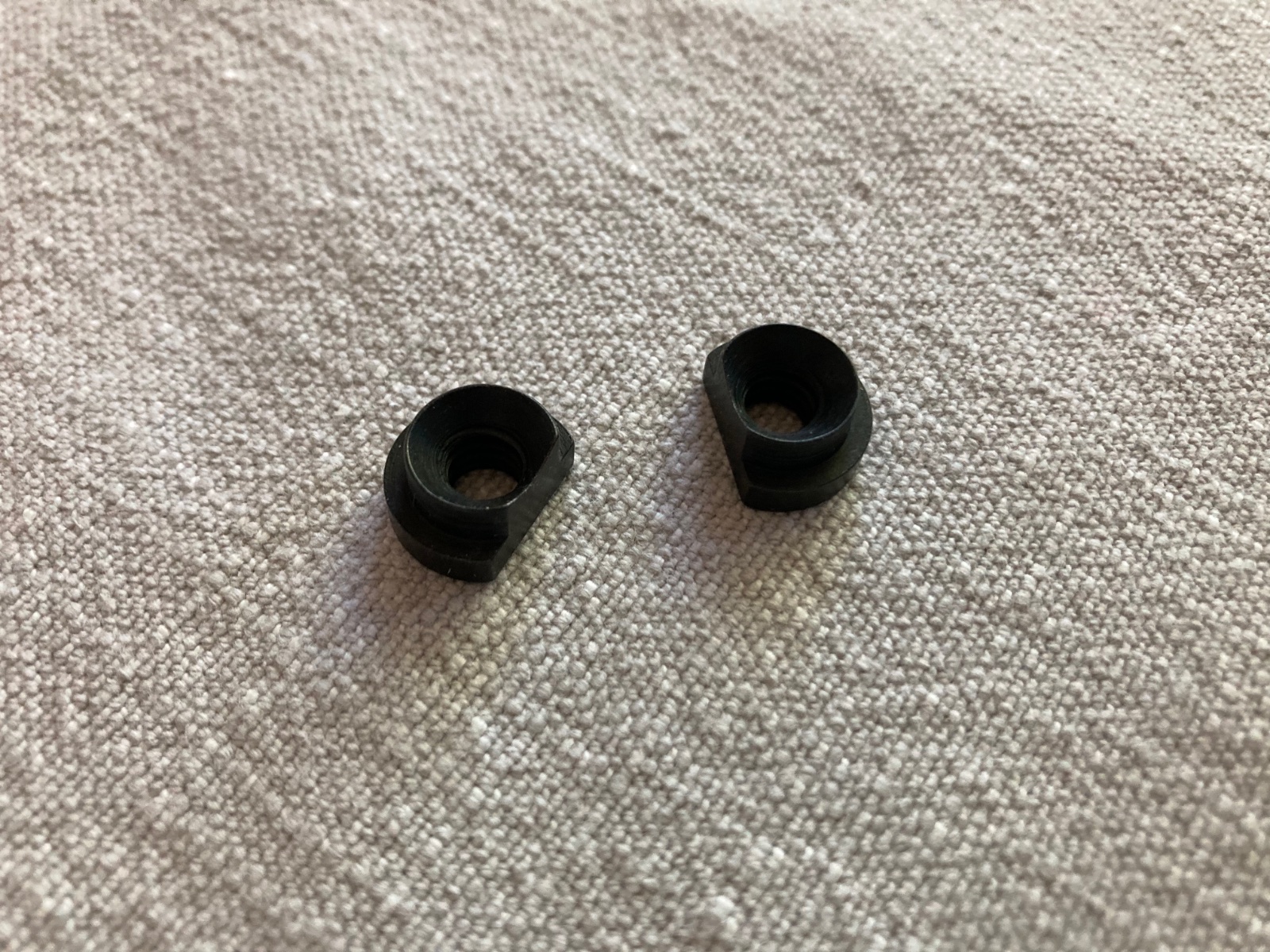

My stash of leftover “clinch” nuts (D shaped nut inserts that swedge into the sheet metal) says #10-32 and 1/4”-20. These are leftover from my ‘ol 27 roadster
