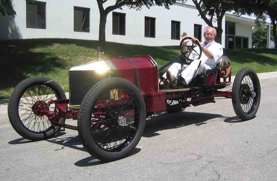

Re: You tell me
Post by Atomic Amish » Wed Sep 13, 2023 12:11 pm

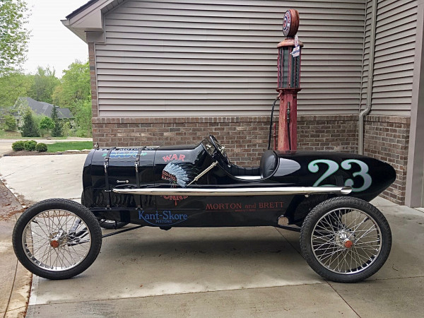

To Wayne's point: This is my ideal T.
pride of the company.jpg (84.54 KiB) Viewed 21275 times
Barnstormers VSC- Si vestri 'non prius novissimo
Celeritate Est Vita
Former Antique Vehicle Mechanic- Greenfield Village
Former Docent- Ford Piquette Avenue Plant

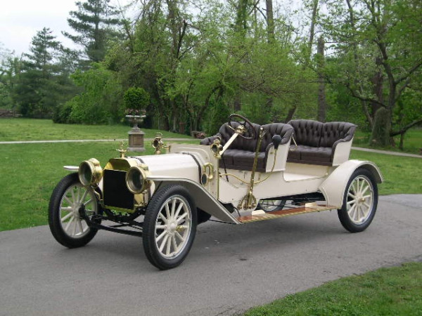

jiminbartow
Posts: 2481
Last Name: Patrick
Location: Bartow, FL
Re: You tell me
Post by jiminbartow » Wed Sep 13, 2023 1:02 pm
On October 16, 2011, Mike Walker posted this picture in a thread about how to make a “1911 Torpedo long hood” Model T. Lotsa leg room. Rootlieb was mentioned in the thread. Jim Patrick
PS. I think it would look better and more proportional if the back seat were left where it is but the door opening to the back seat reduced in width. Also, the back seat could be raised a bit like the T’s of old to give the back seat passengers a better view. A brass windshield would also enhance its’ appearance.

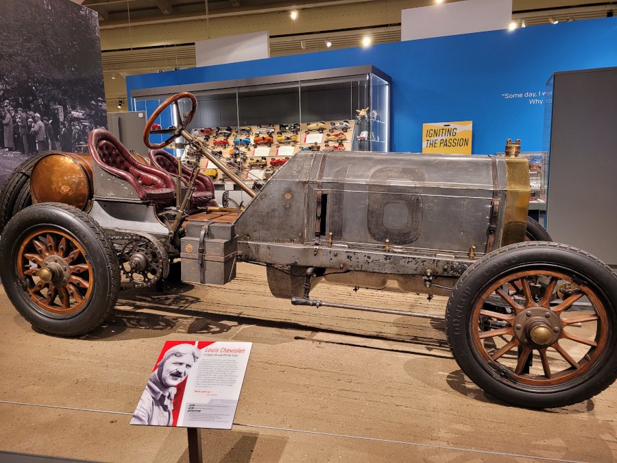

Sacrilege to go for the look of Louis Chevrolet's racer?

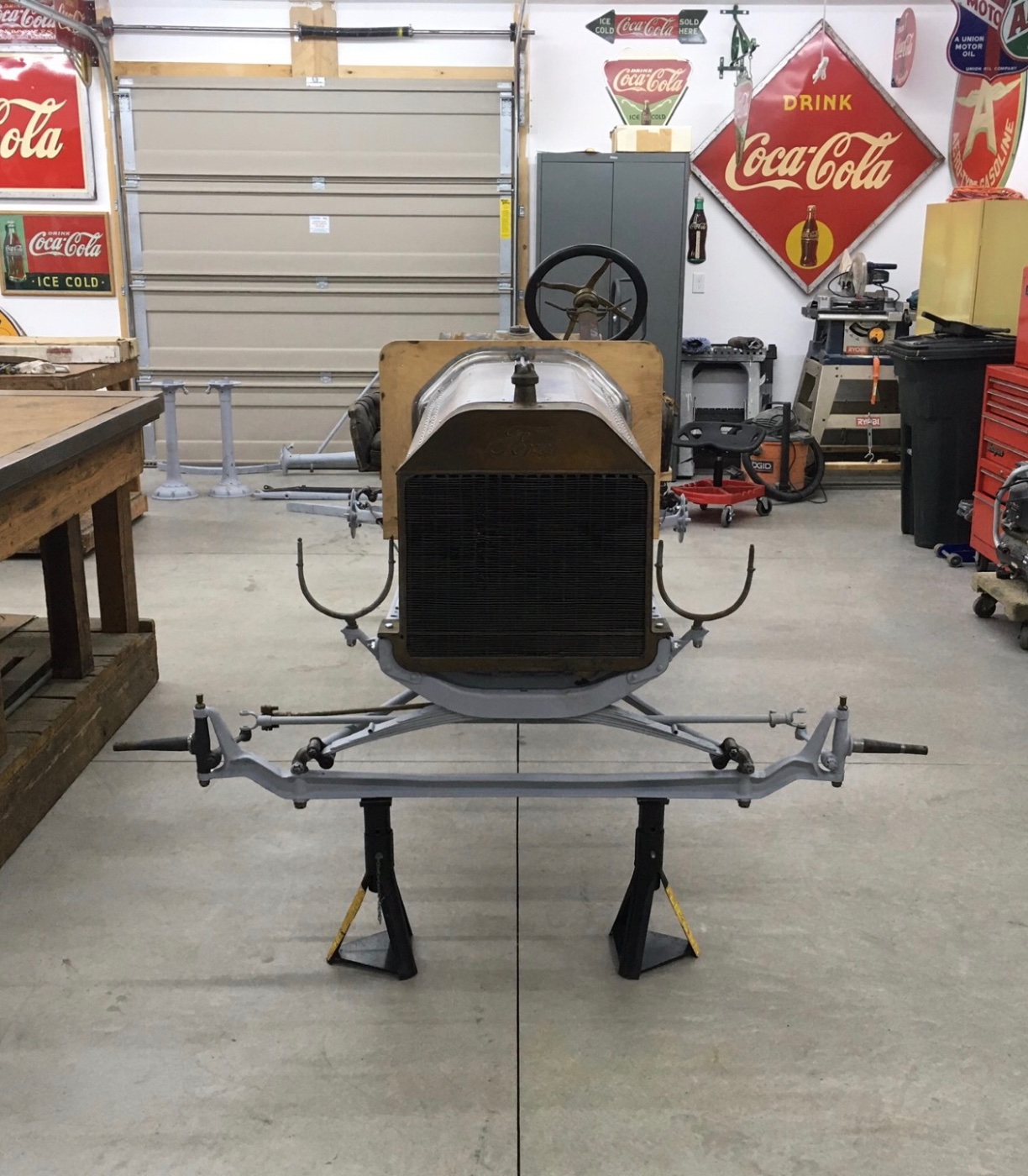

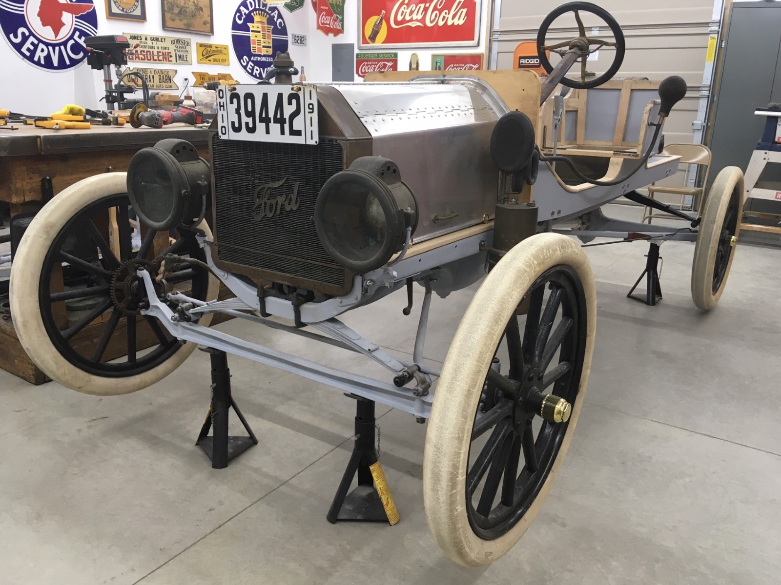

Posts: 3850
Re: You tell me
Post by Dollisdad » Sat Sep 30, 2023 9:09 pm

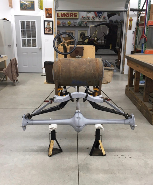

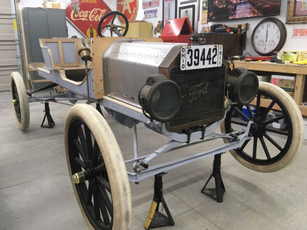

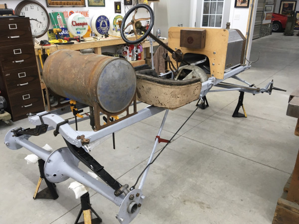

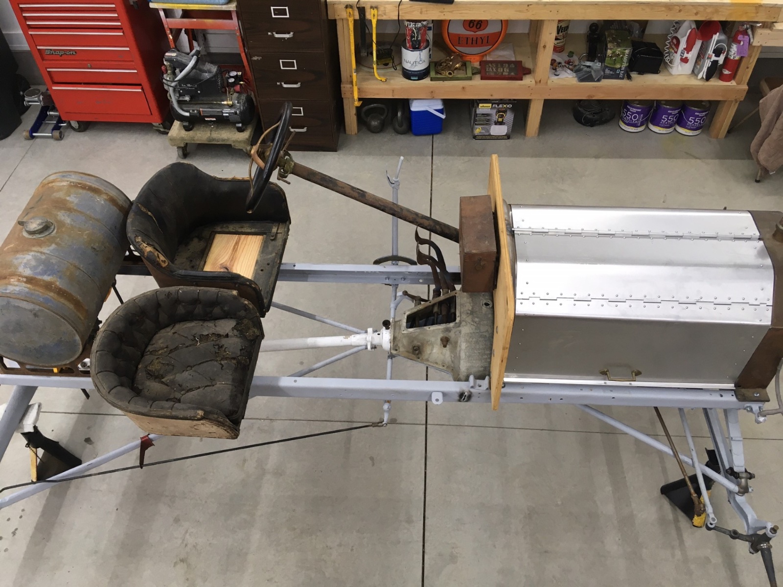

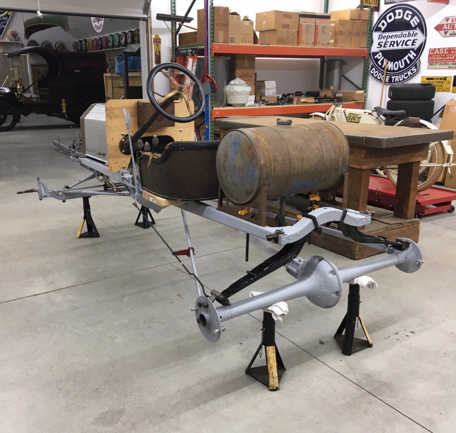

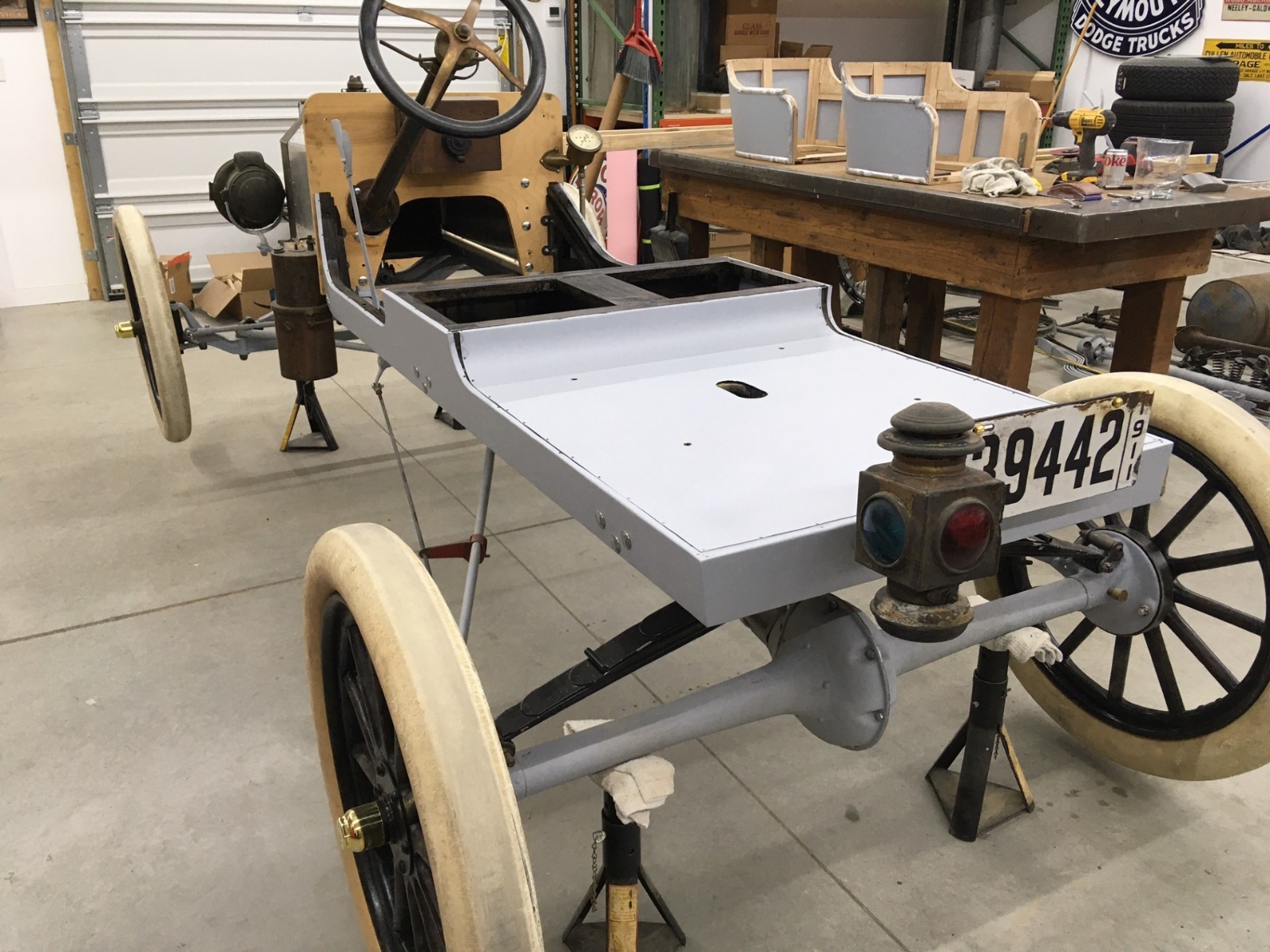

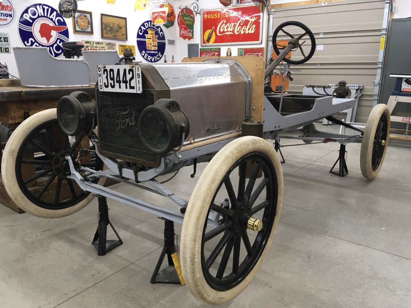

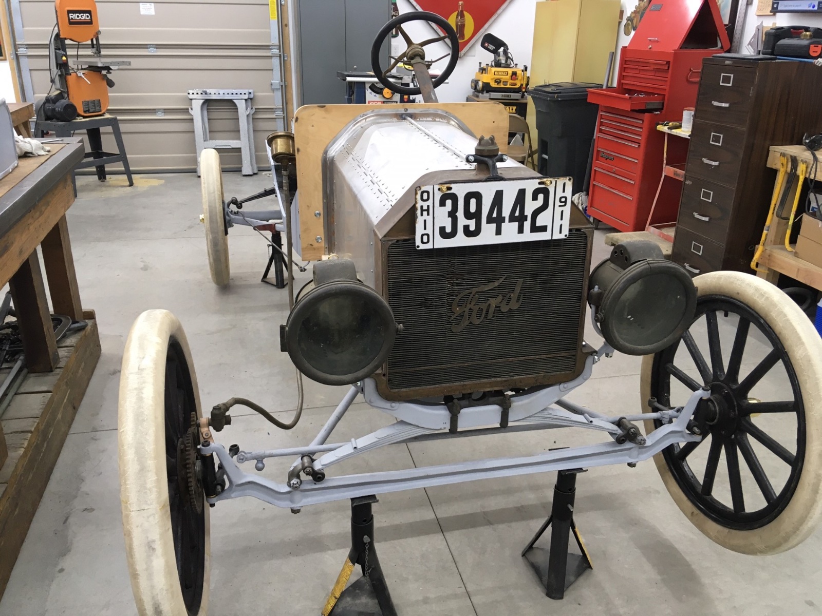

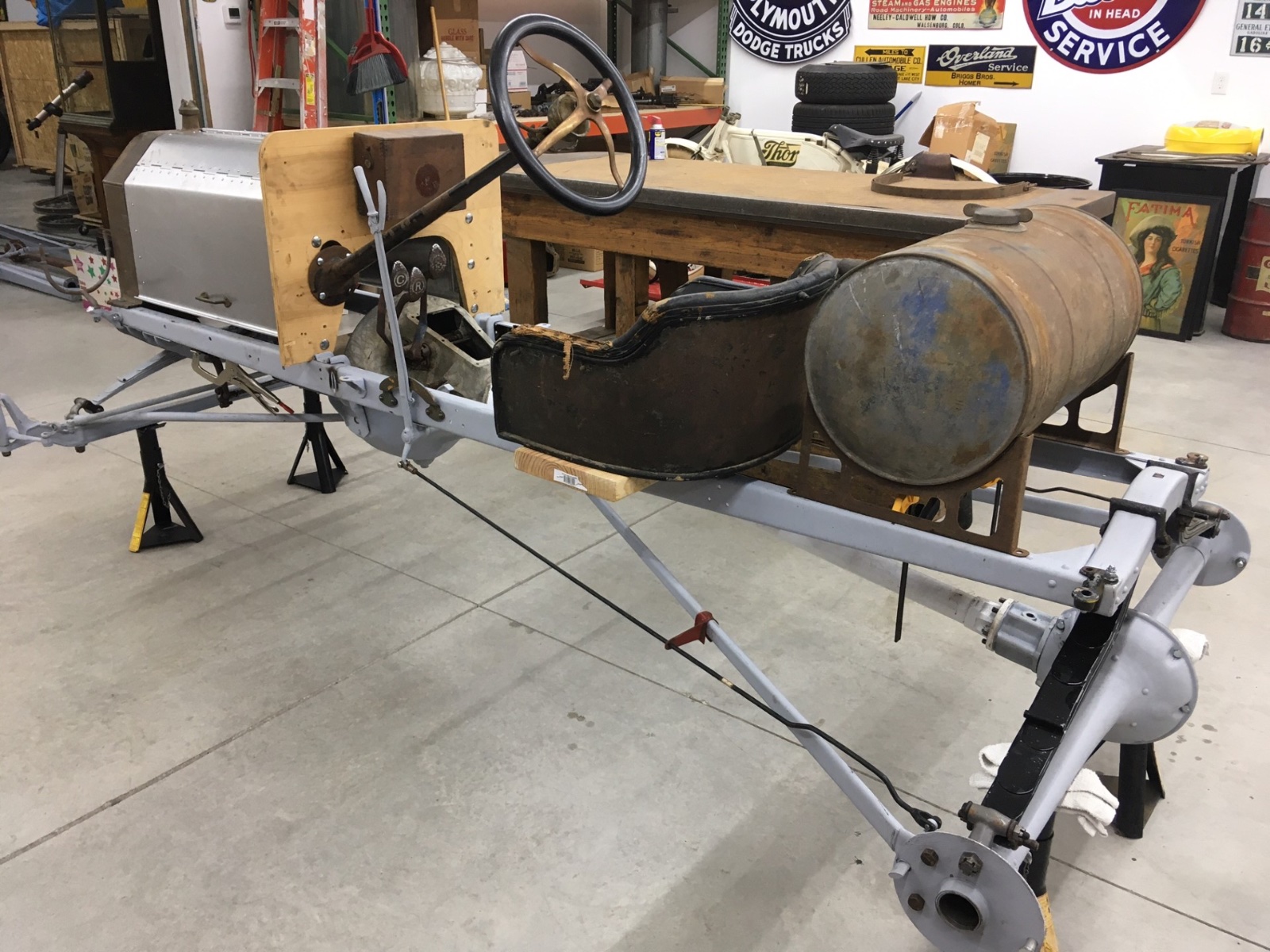

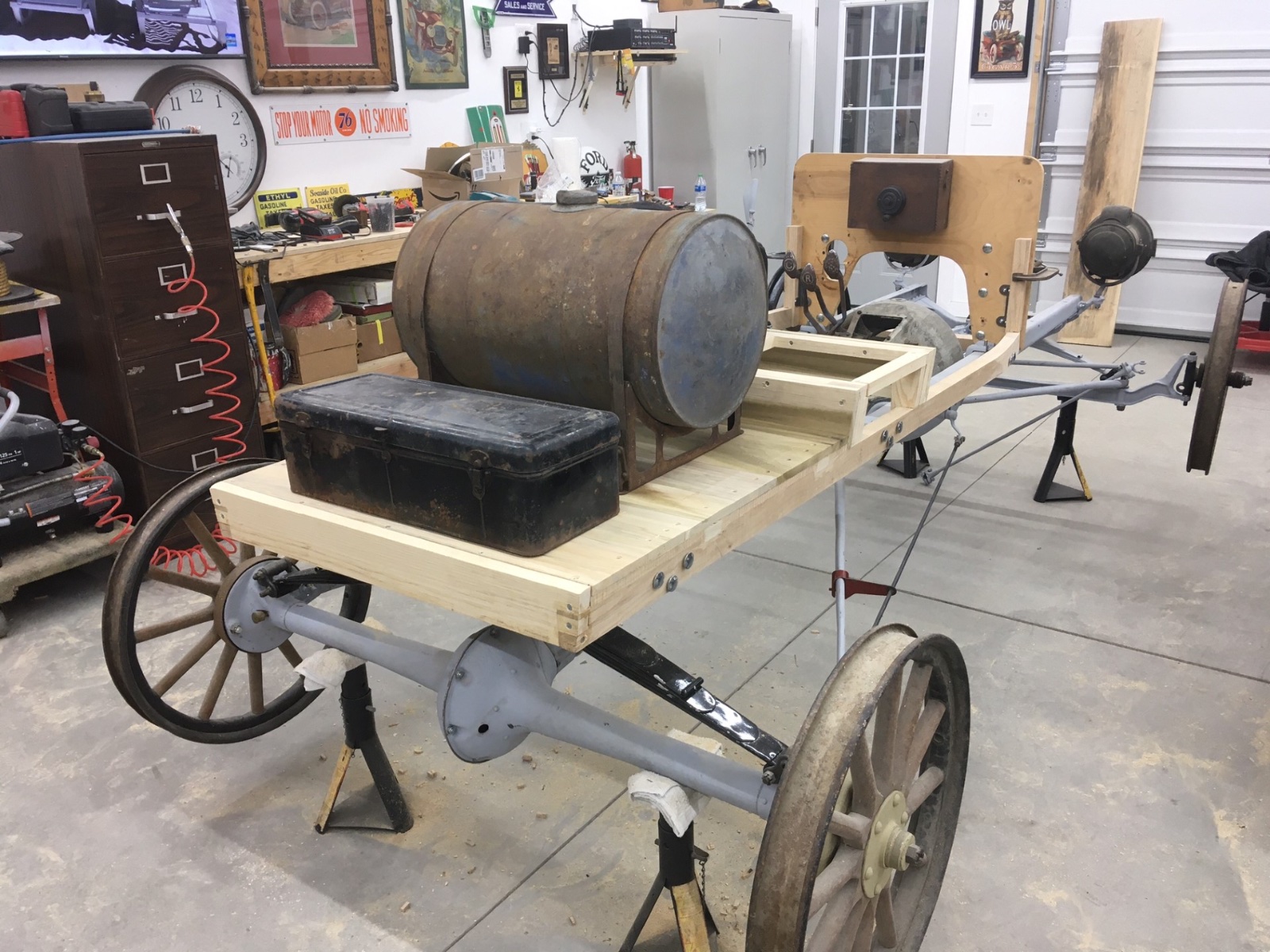

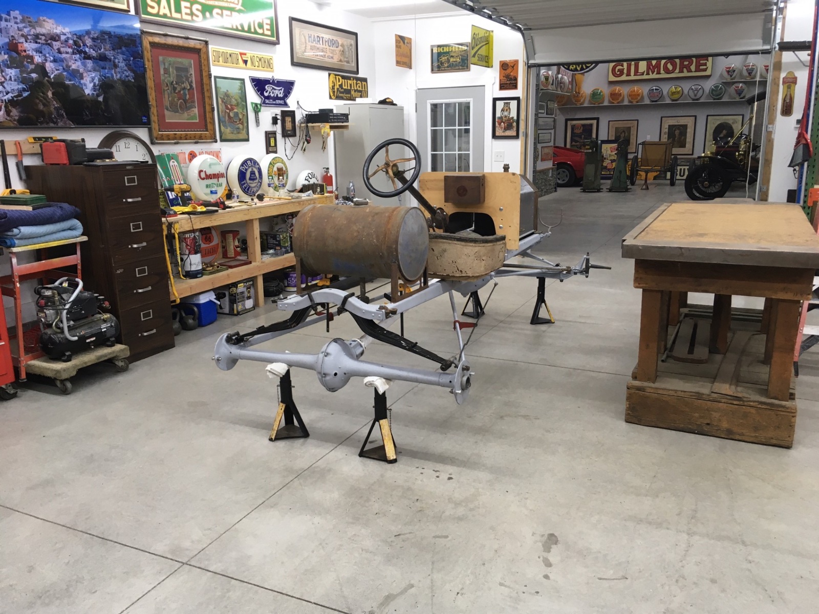

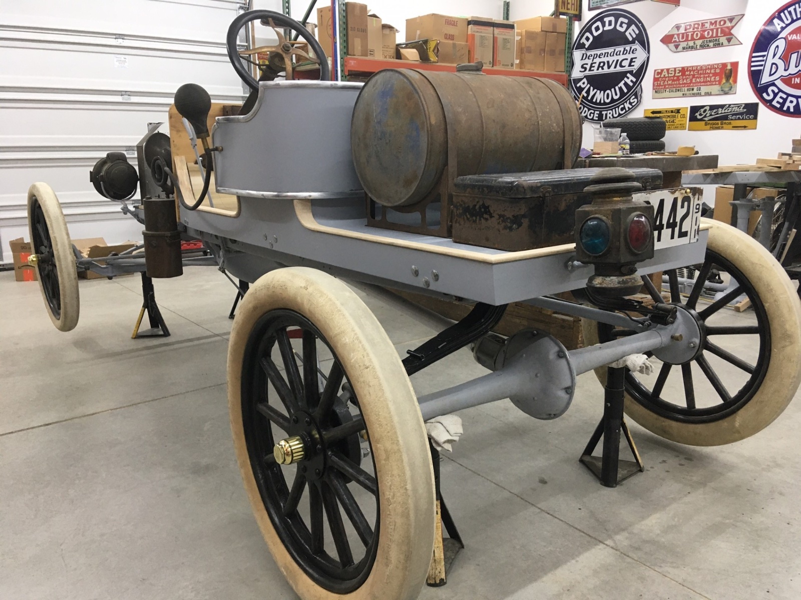

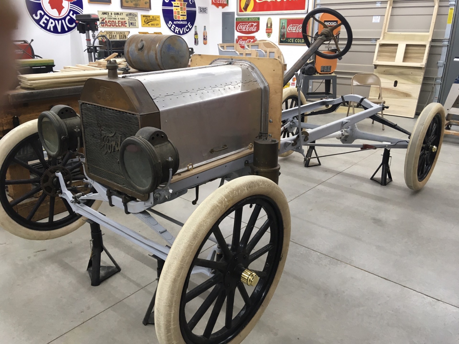

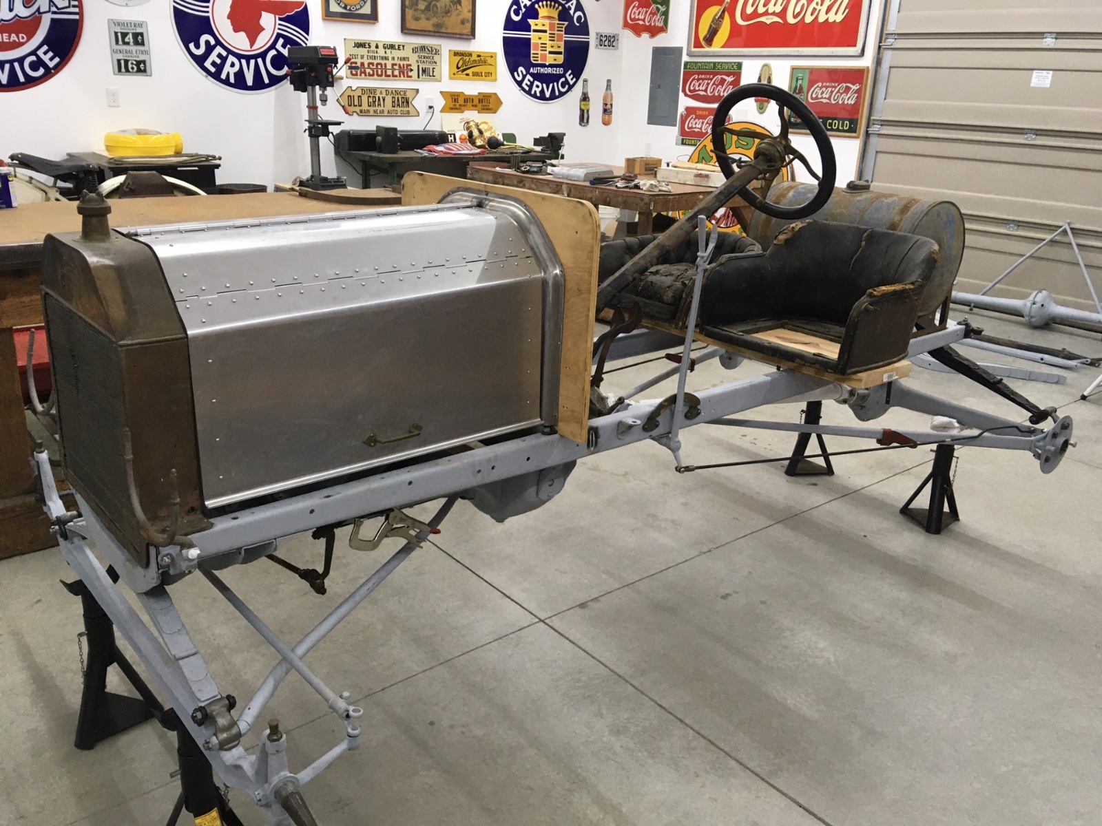

Well, I moved this to Ohio and have started to place some parts on the chassis to get a feel for what to do for a body. I like the basic feel of the spacing, but it needs a body platform of some type. Step in or step over. Flat dash or scuttle cowl. Tool box or ? on the tail end. Suggestions most welcome.
Posts: 3850
Re: You tell me
Post by Dollisdad » Sat Sep 30, 2023 9:10 pm
Posts: 3850
Re: You tell me
Post by Dollisdad » Sat Sep 30, 2023 9:11 pm
Posts: 4408
Re: You tell me
Post by Wayne Sheldon » Sun Oct 01, 2023 1:24 am
A simple floor/platform, cut down the firewall a little bit? I like it! Speedsters aren't supposed to be great travel vehicles, lack of luggage space an all? Although certainly Ed and Karen Archer would disagree with that!
What is the reason to be given for the long hood? You could have a six cylinder model T engine built for it? (Something I always wanted to do?)

Wayne, I originally built this car to fill a need I had.
But that use has changed. And with the first car having a 5” stretched wheelbase, the car to replace it, also needed the 5” stretch. So that is how this car came into being. I used two frames and put the 5” in front of the firewall because I didn’t want to alter the drive train. So a 5” longer hood was a simple fix.
Warwick, you can see I already have one done to that style.
Ed, I remember seeing the picture of the dark blue car and thinking “What a beautiful car!”. I have not seen the red one before.
Mack, before I learned anything about cars, my father taught me how to push a broom sweeping out his body shop. He would always say to me “If you want clean work, keep a clean shop! Must a heard that a thousand times.

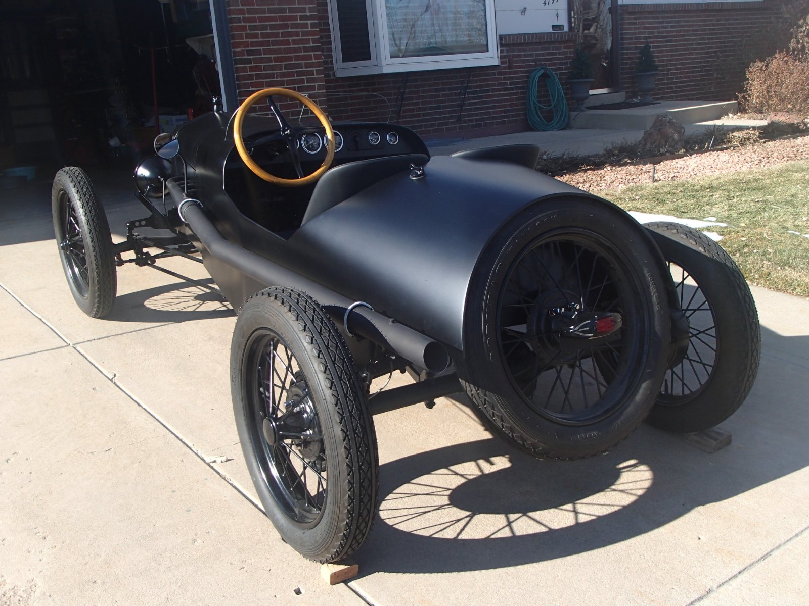

The deck design of Edsels car is similar to what I have in mind. Edsels car is a 09/10 with cowling on a quasi commercial roadster deck. I don’t believe it has a stretched hood but it’s hard to tell. It appears the steering wheel is reversed. I like the concept.

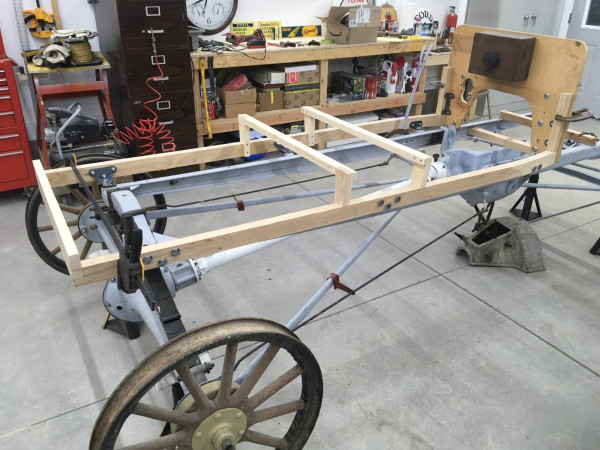

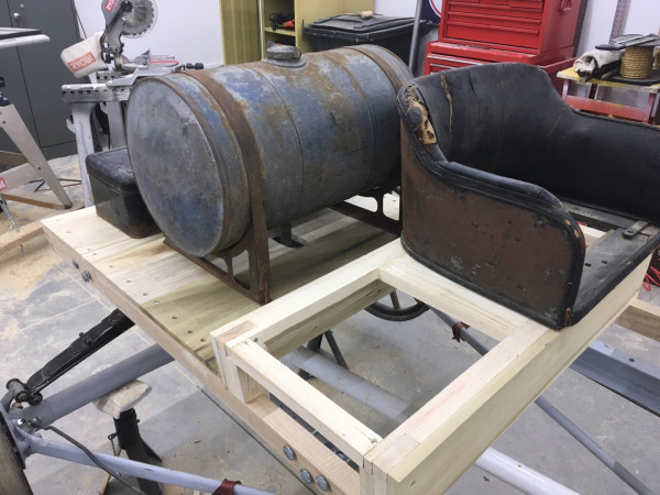

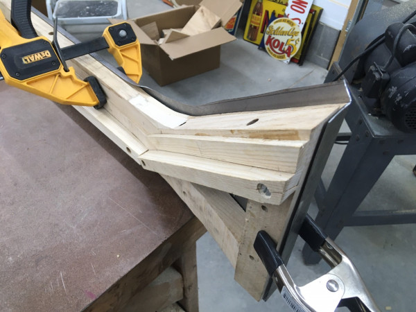

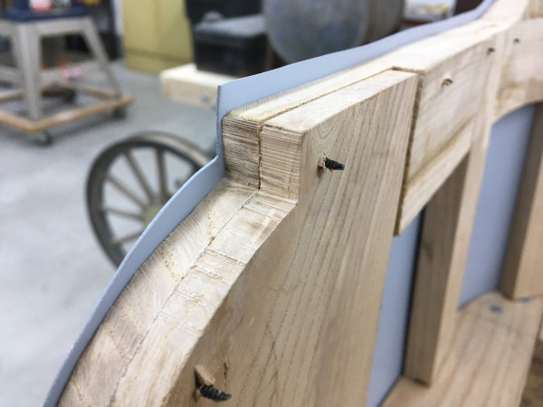

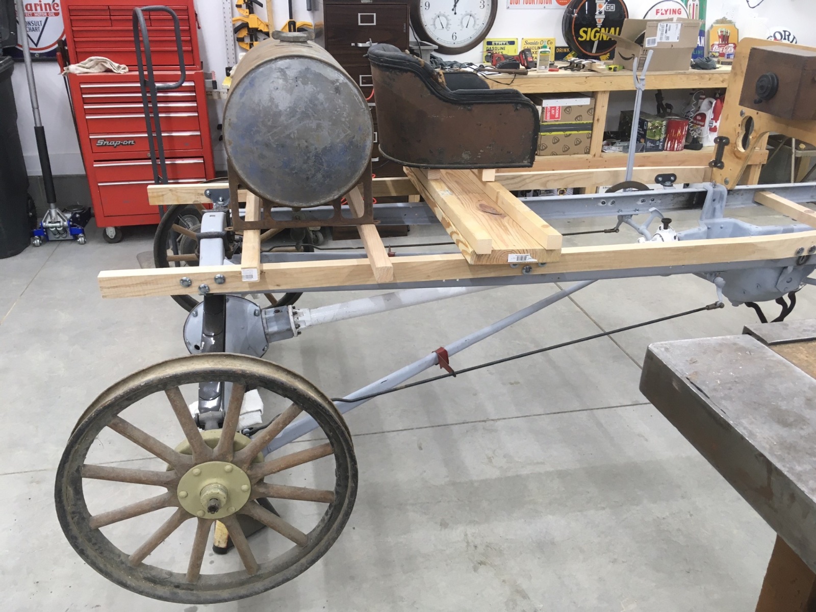

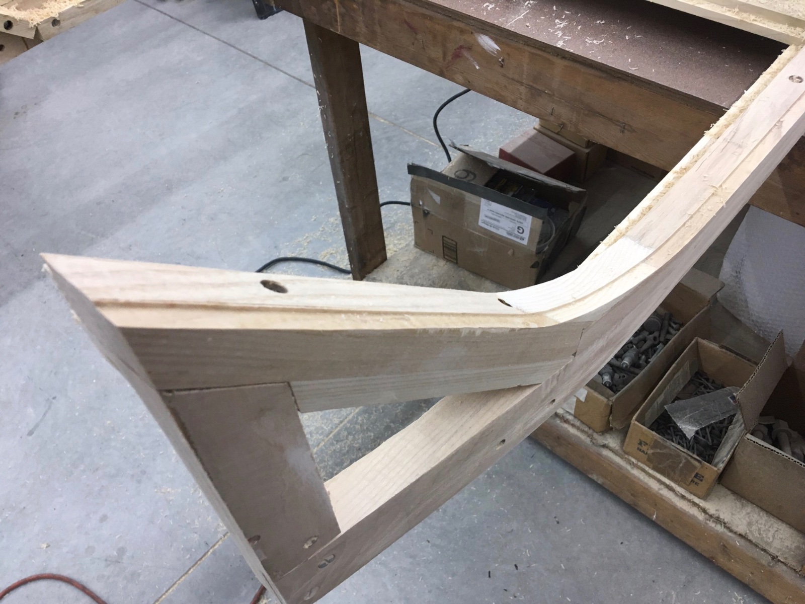

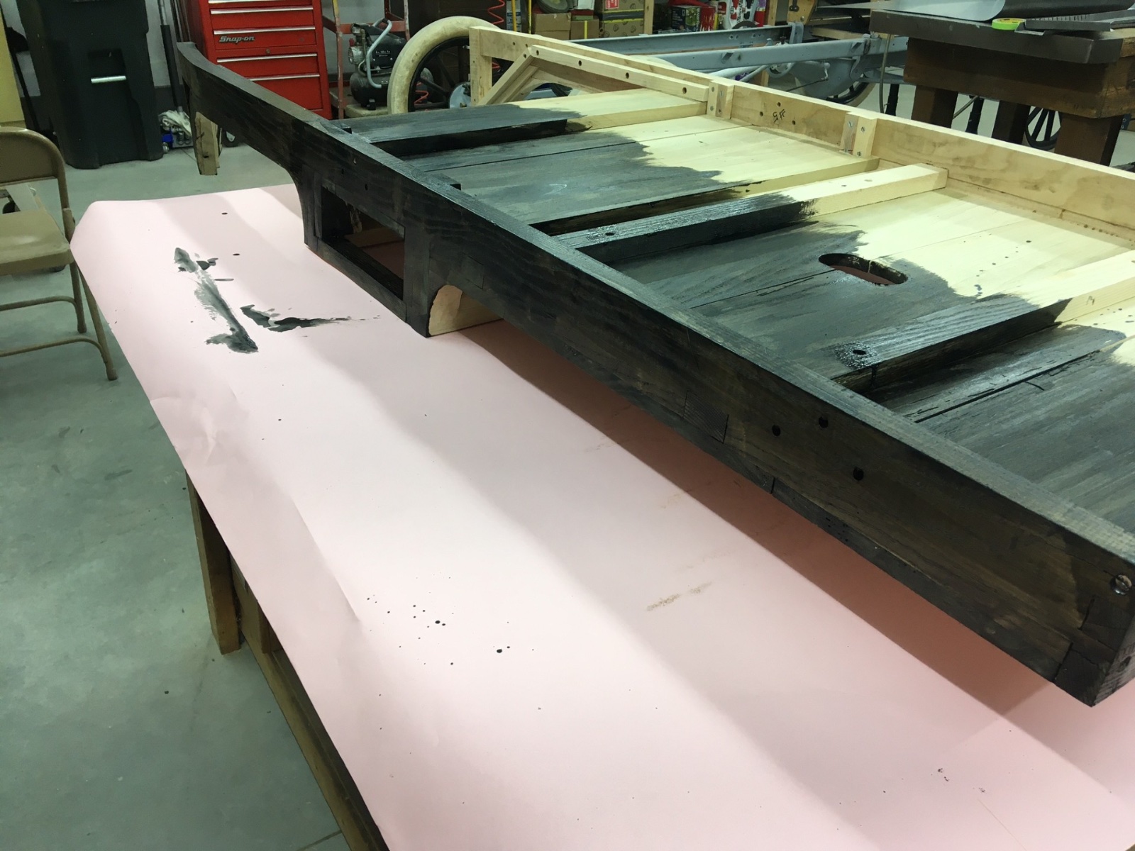

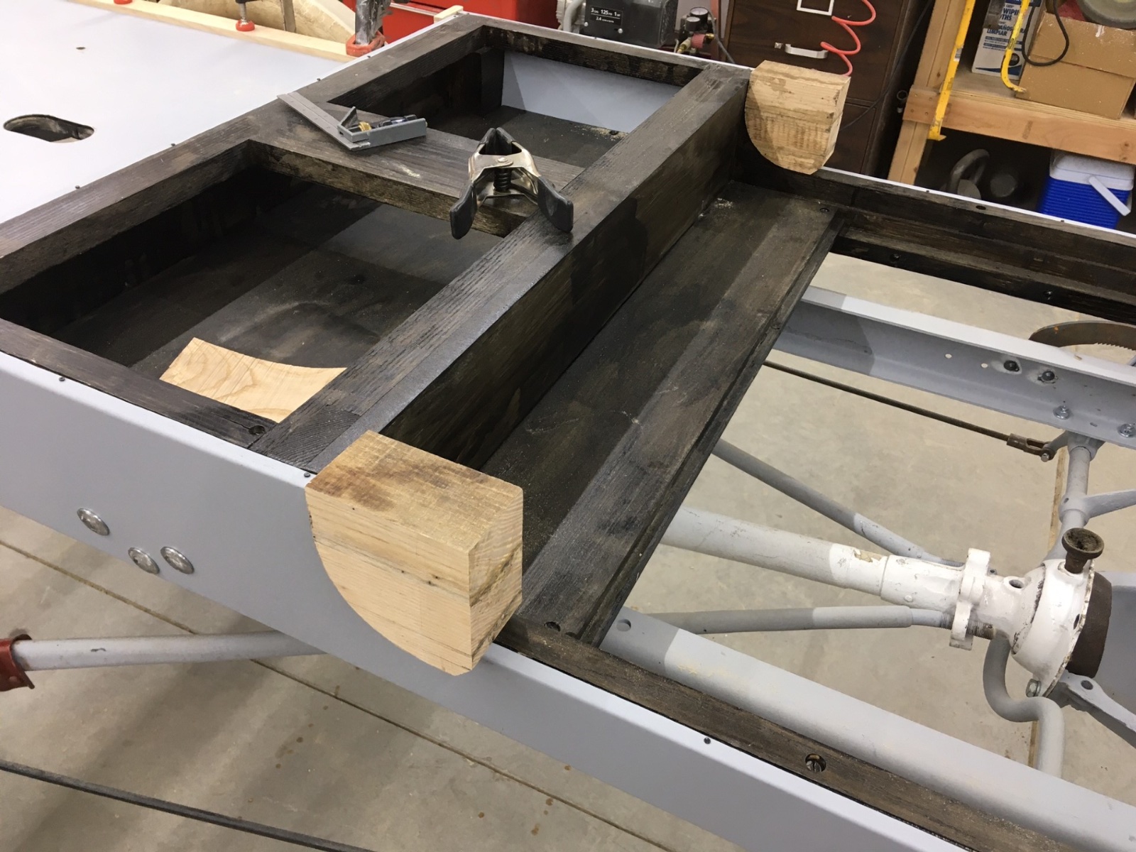

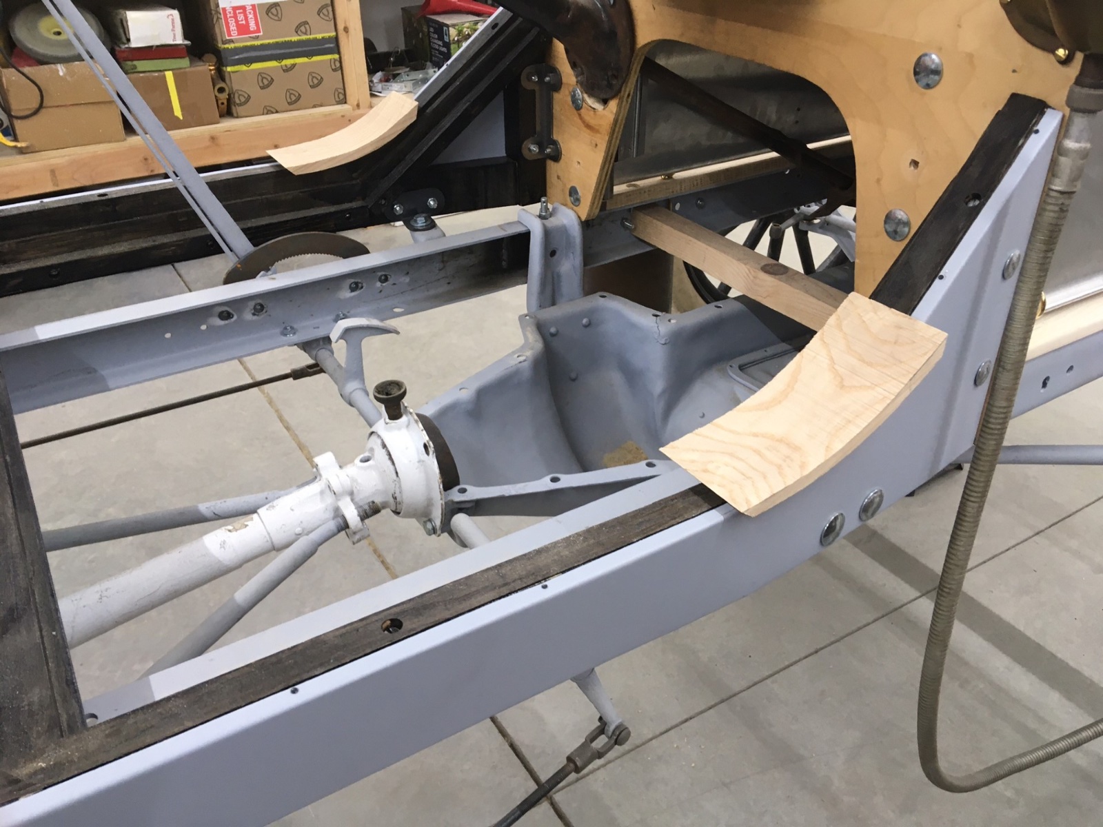

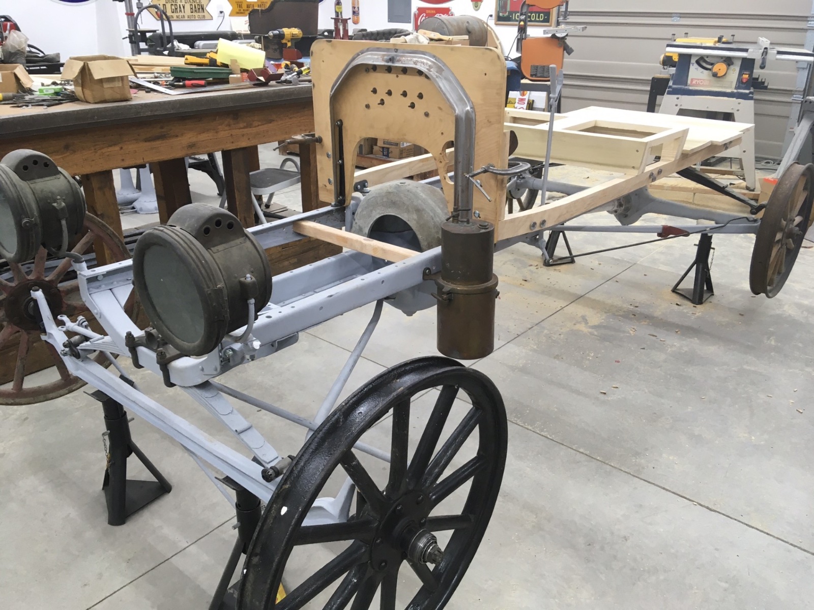

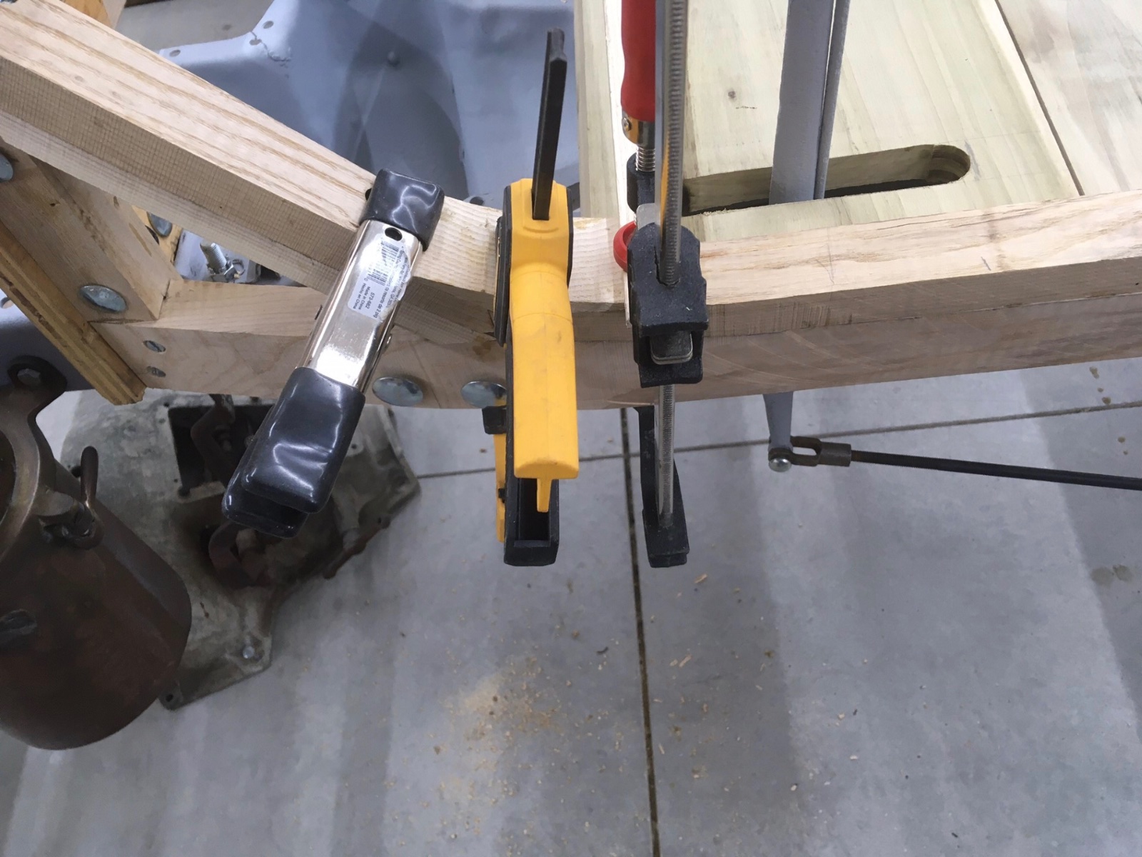

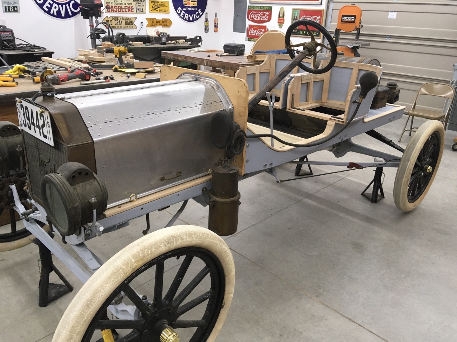

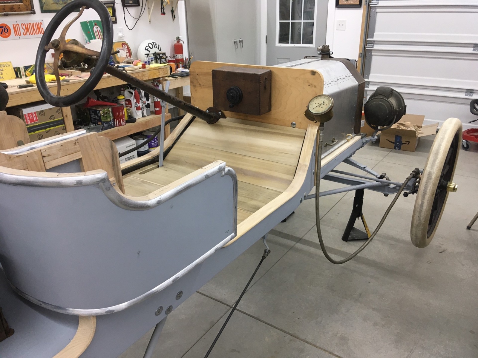

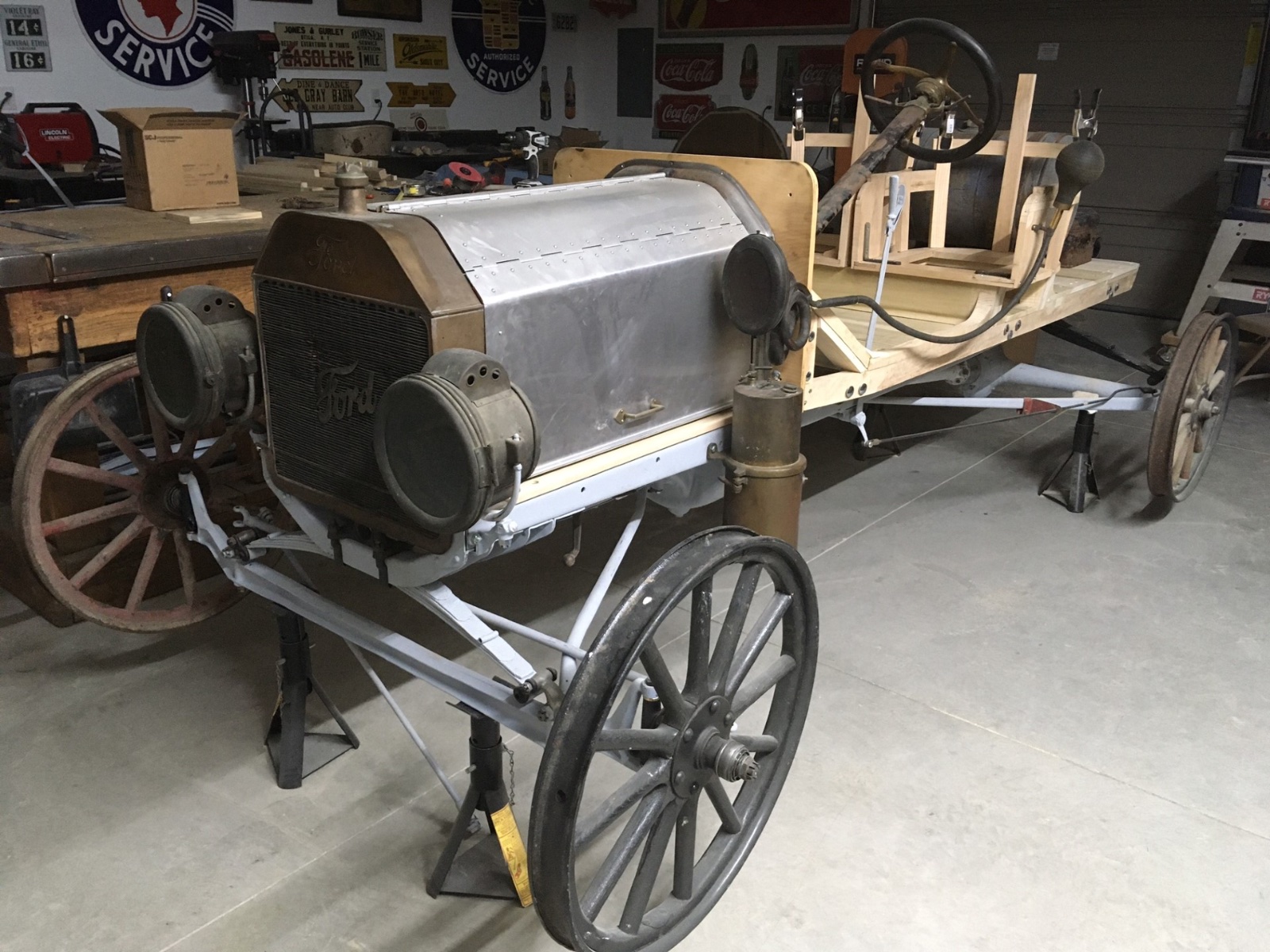

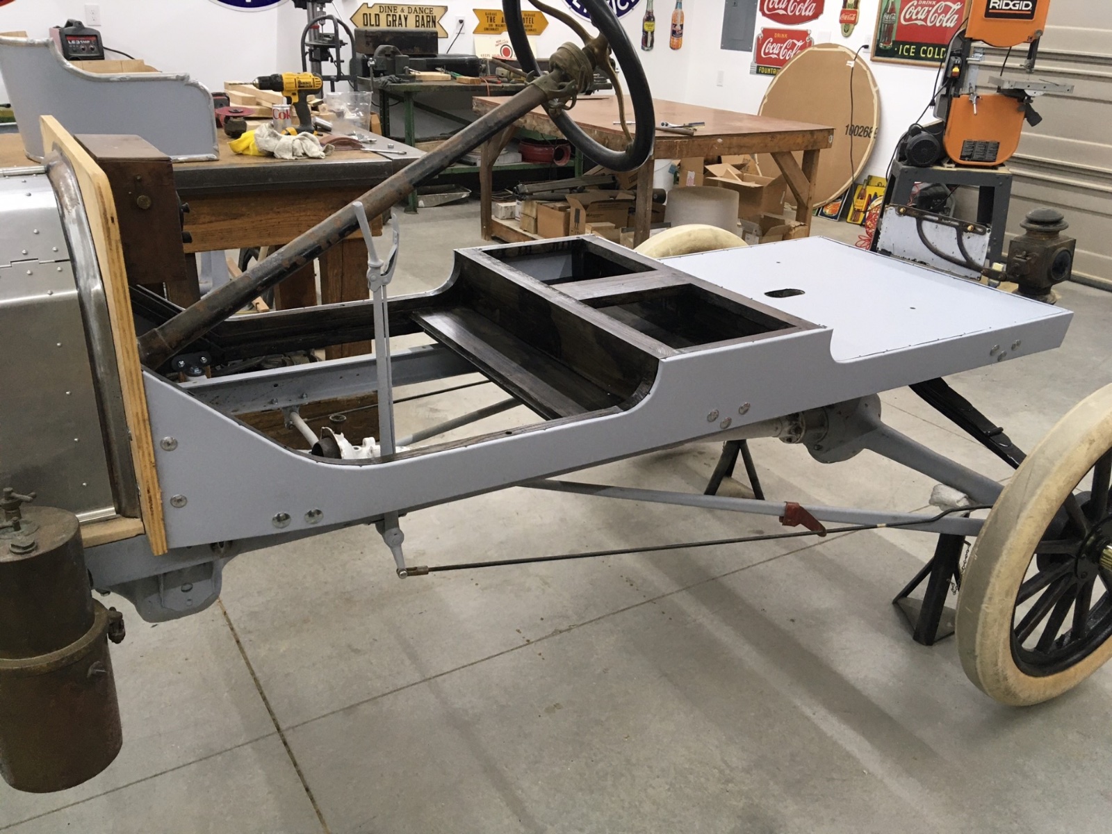

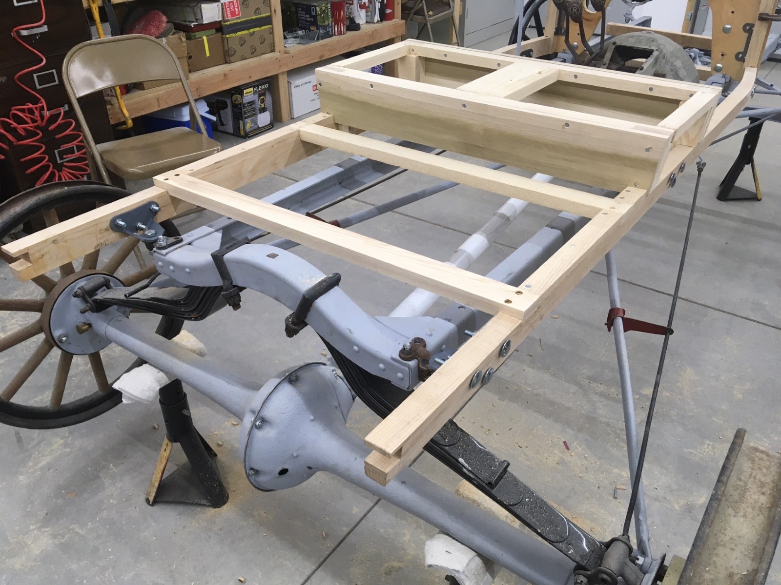

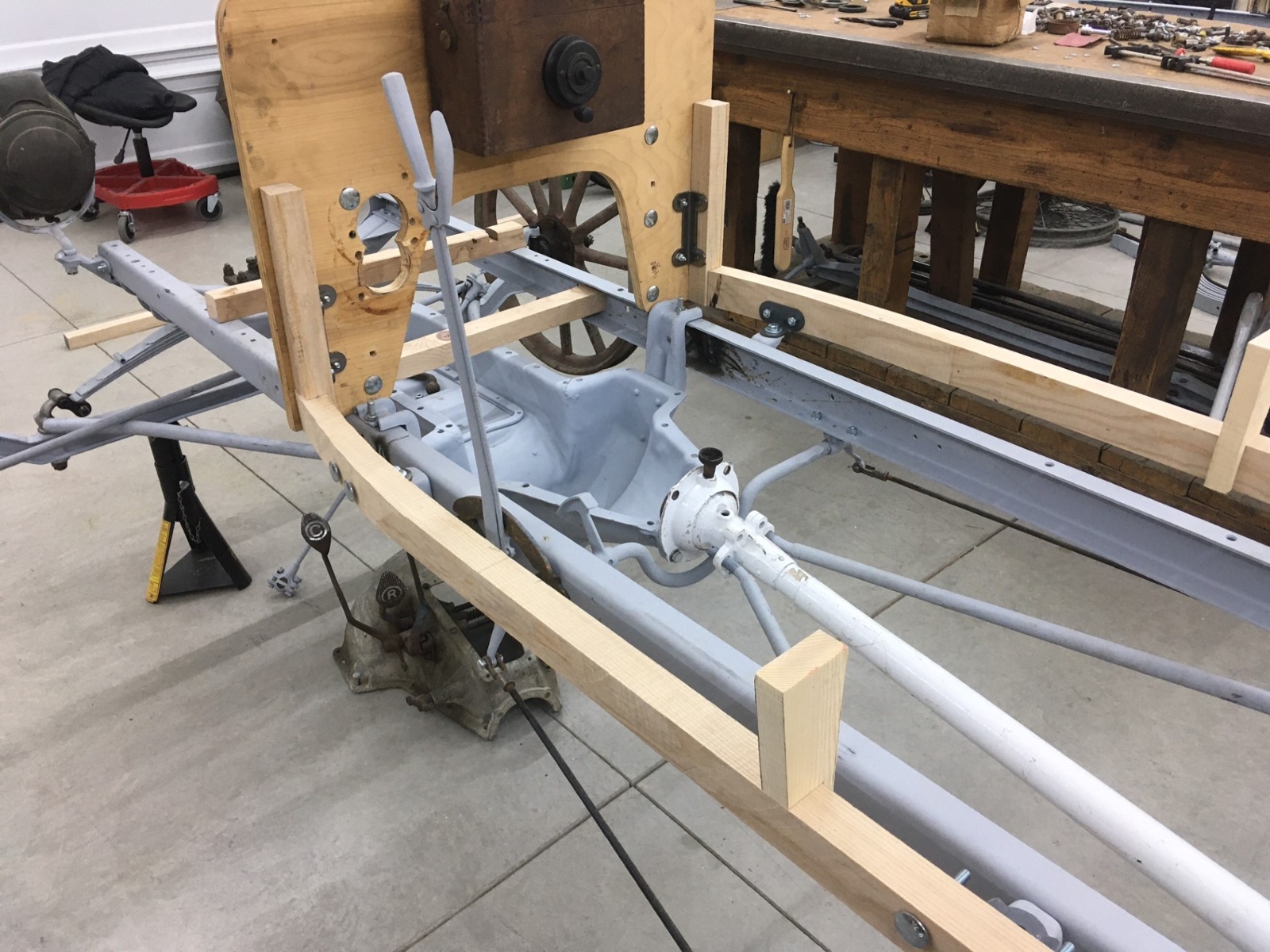

Post by Dollisdad » Thu Jan 11, 2024 12:47 am

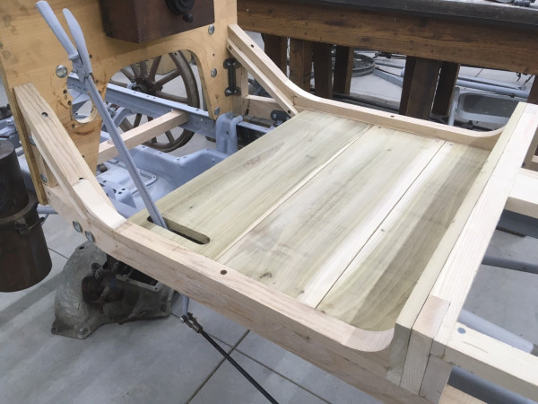

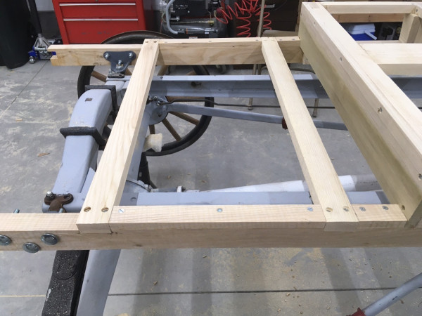

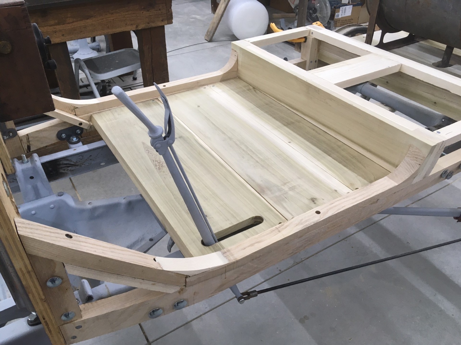

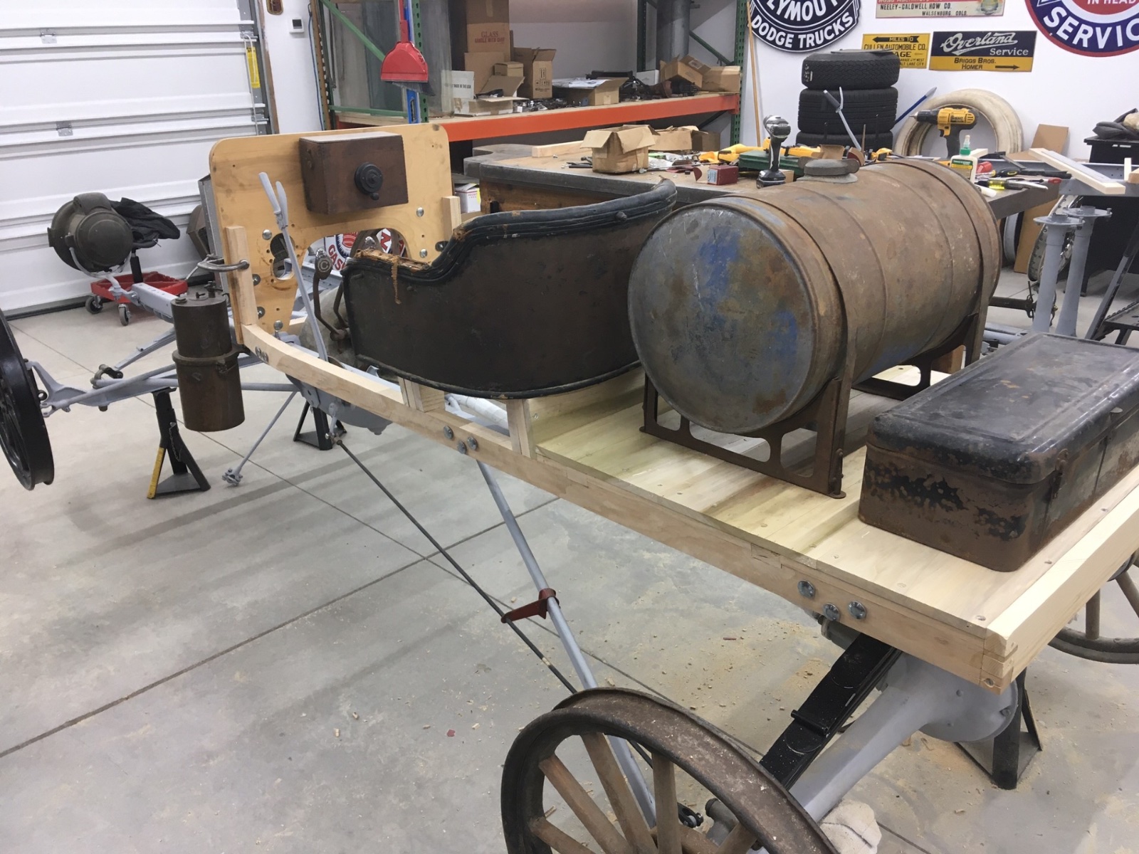

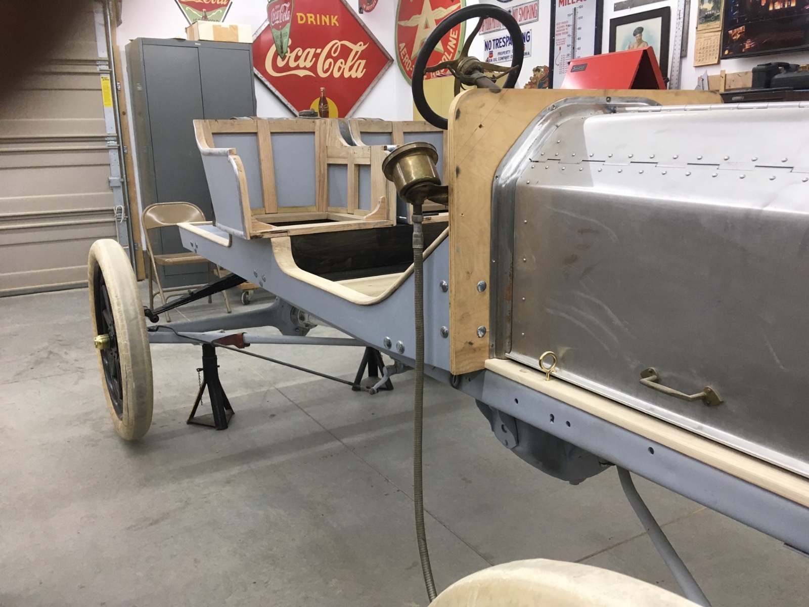

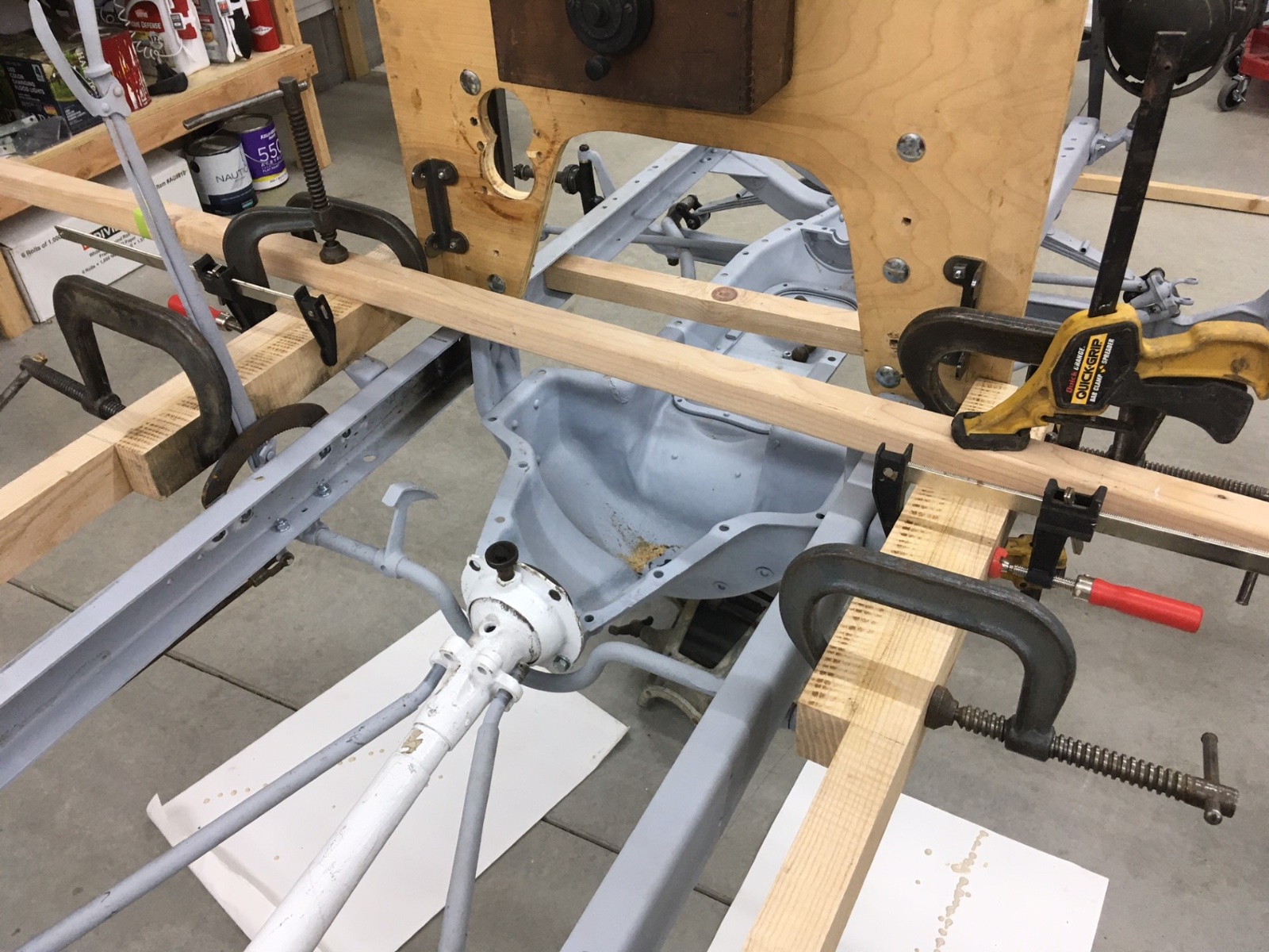

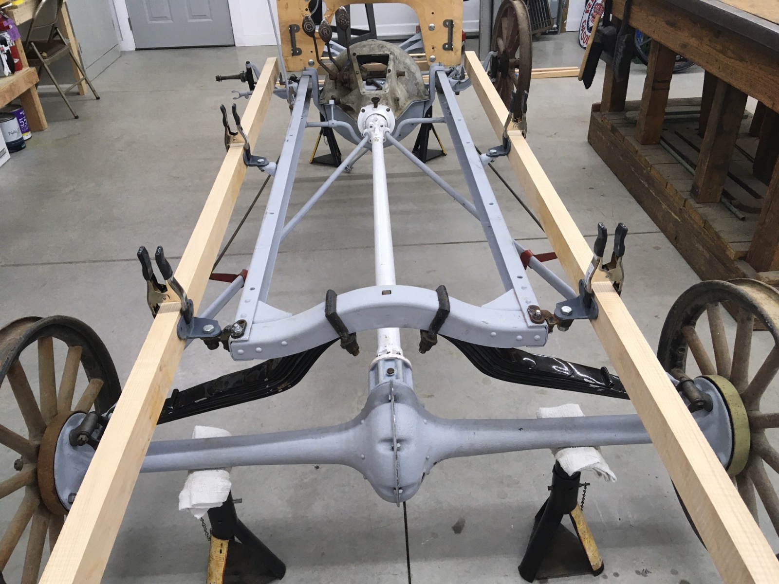

I decided to go along these lines.
So I ripped a pair of stringers 2 1/4 x 1 1/2.
Glued in pieces to reach the body to firewall brackets.
Cut curve in front and drill body mounts.

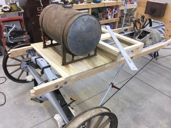

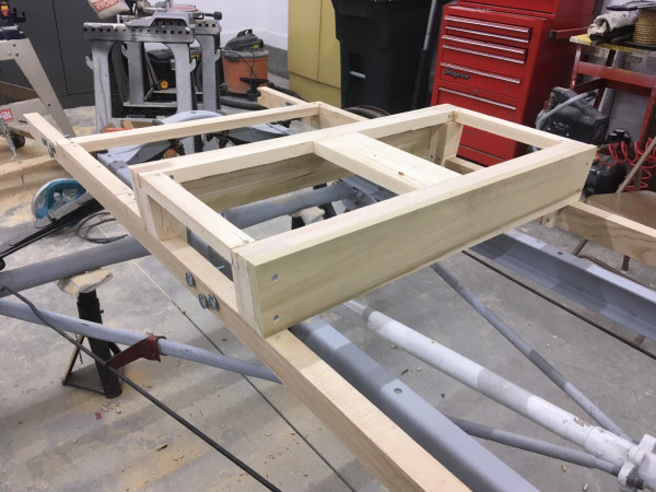

Posts: 3850
Re: You tell me
Post by Dollisdad » Thu Jan 11, 2024 12:56 am
Look at mock-up positions.
Start seat riser after cutting 7 degree taper along outside of stringers and riser.
Posts: 4408
Re: You tell me
Post by Wayne Sheldon » Thu Jan 11, 2024 2:16 am
Looks like you are heading in a good direction! Even if you hide a stock engine under that long hood, it would be a great speedster and a lot of fun!
It is a personal thing with me. I like to see earlier engines in early looking speedsters. And I tend to prefer them kept closer to their apparent era. But that is silly me.
But it is your car! Do what makes it most enjoyable to you.

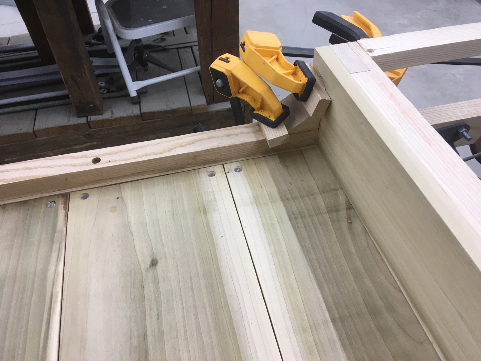

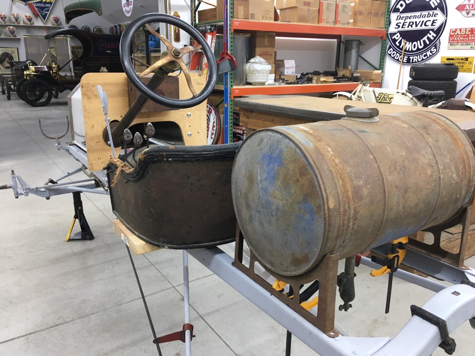

Posts: 3850
Re: You tell me

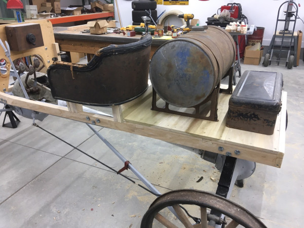

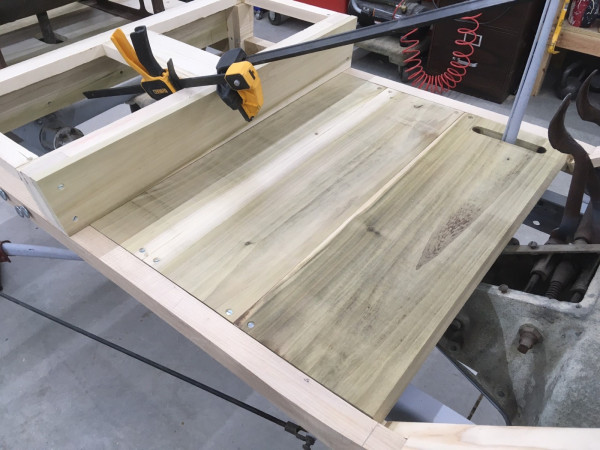

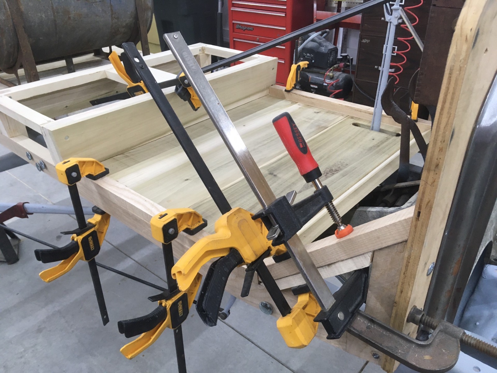

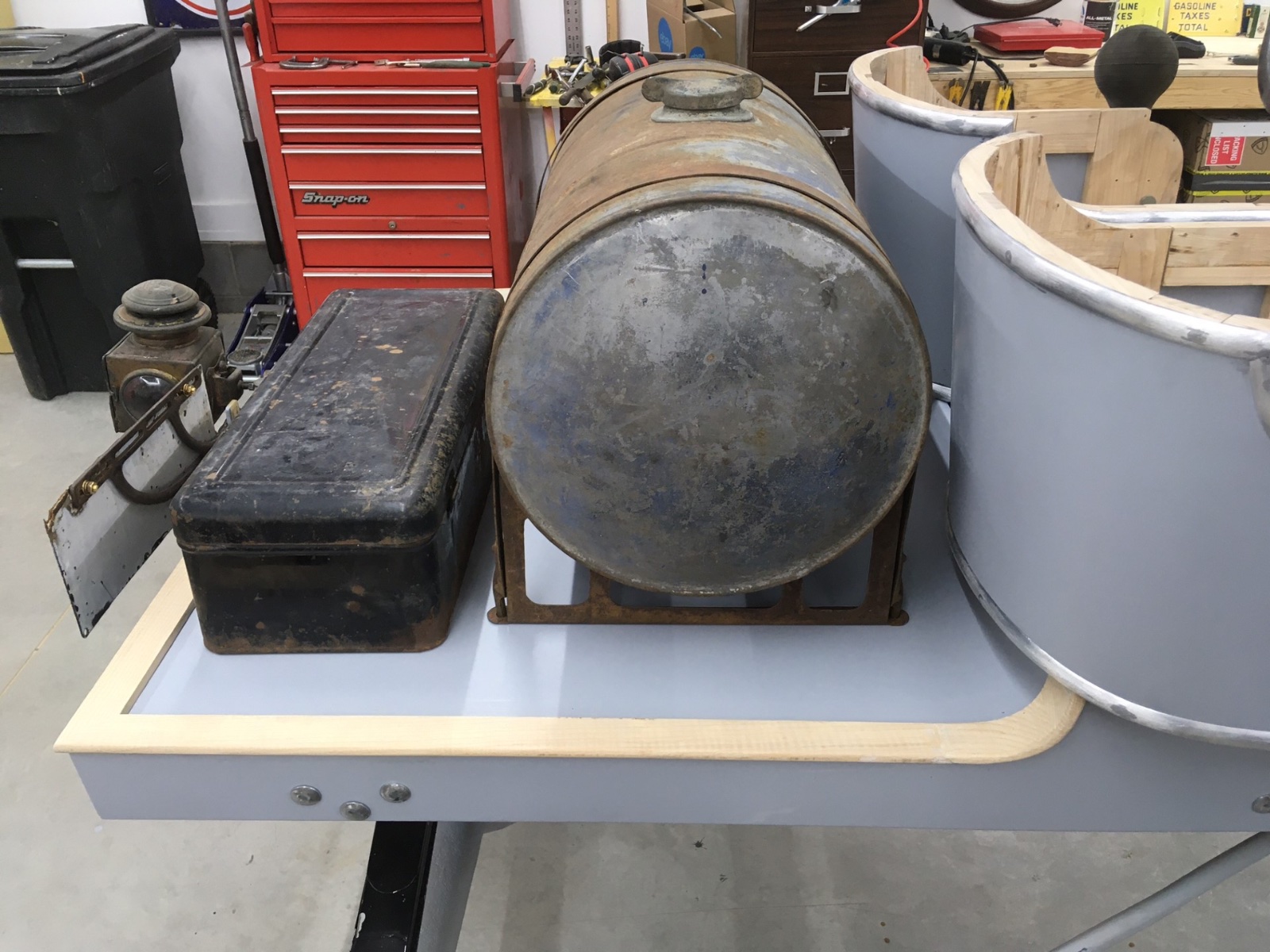

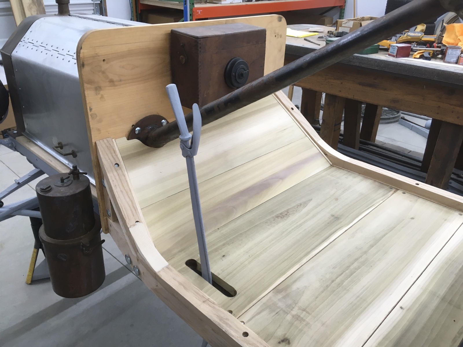

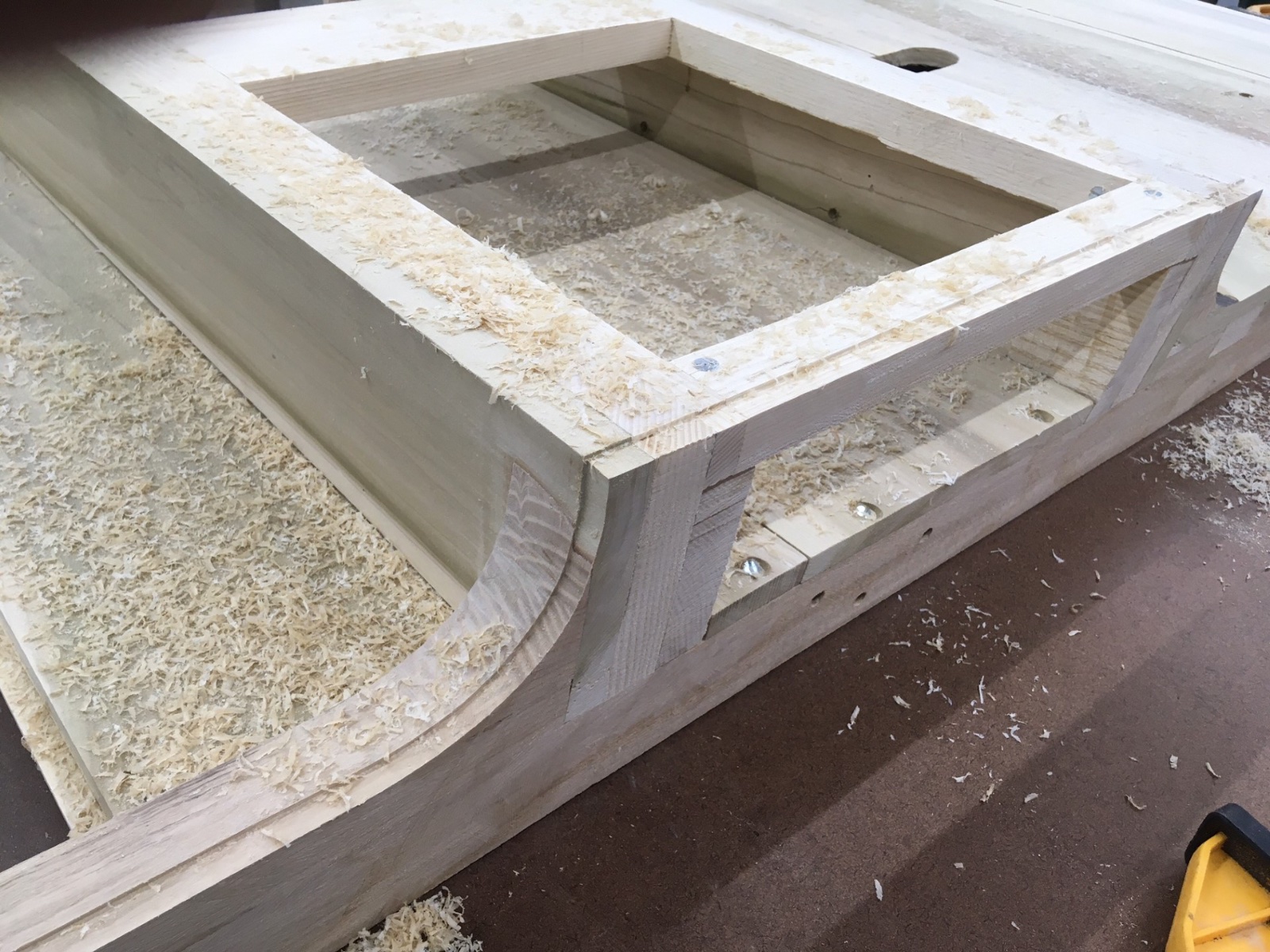

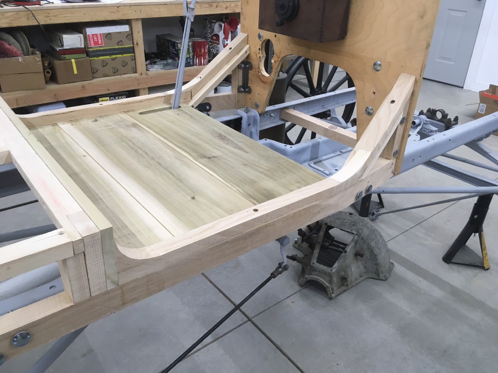

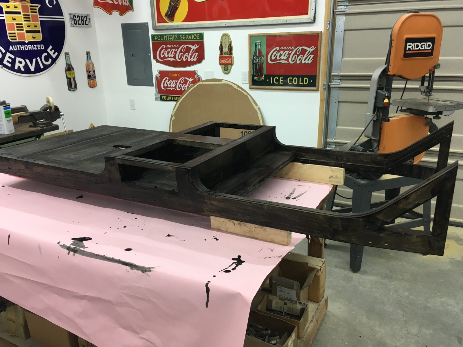

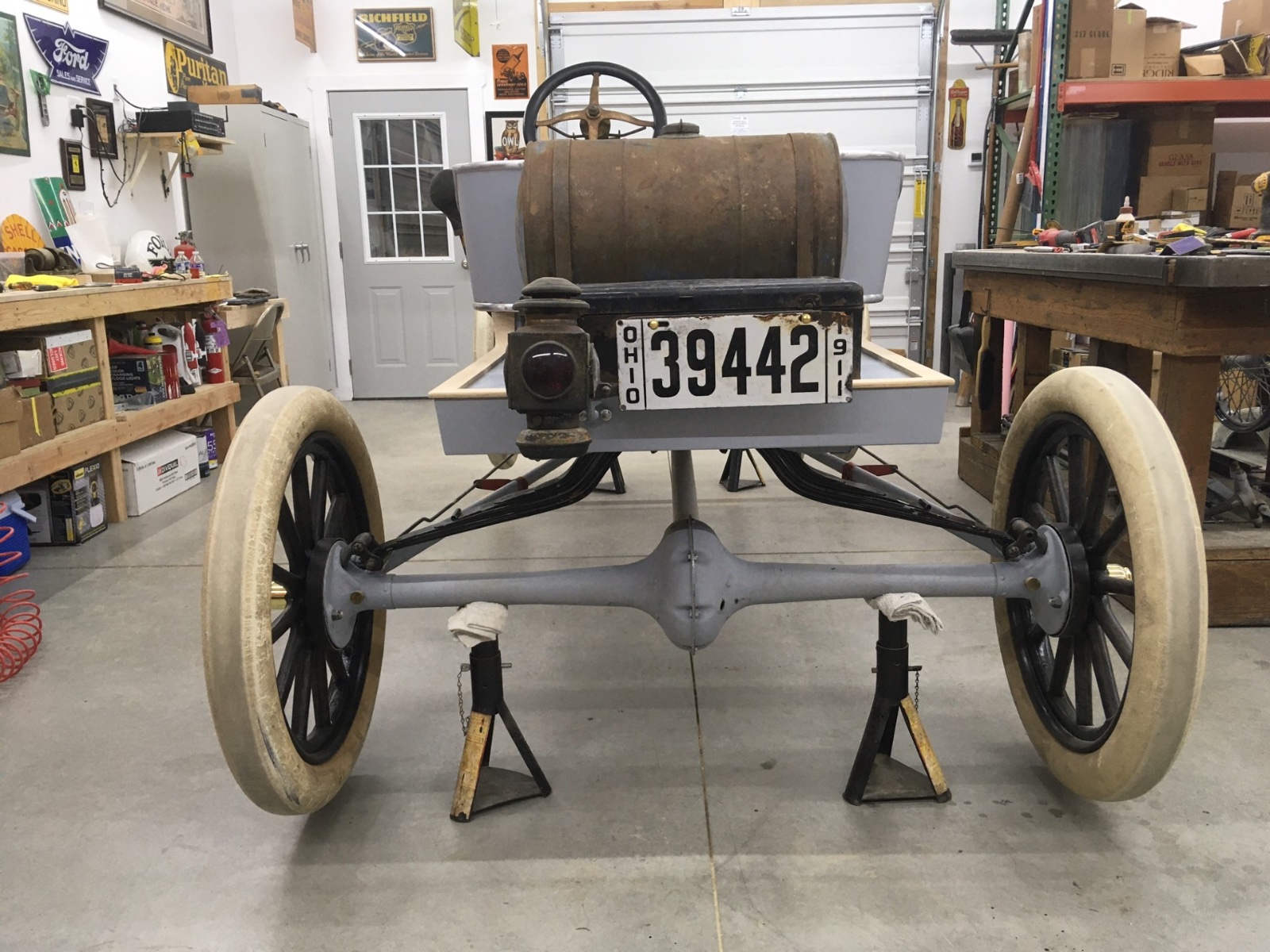

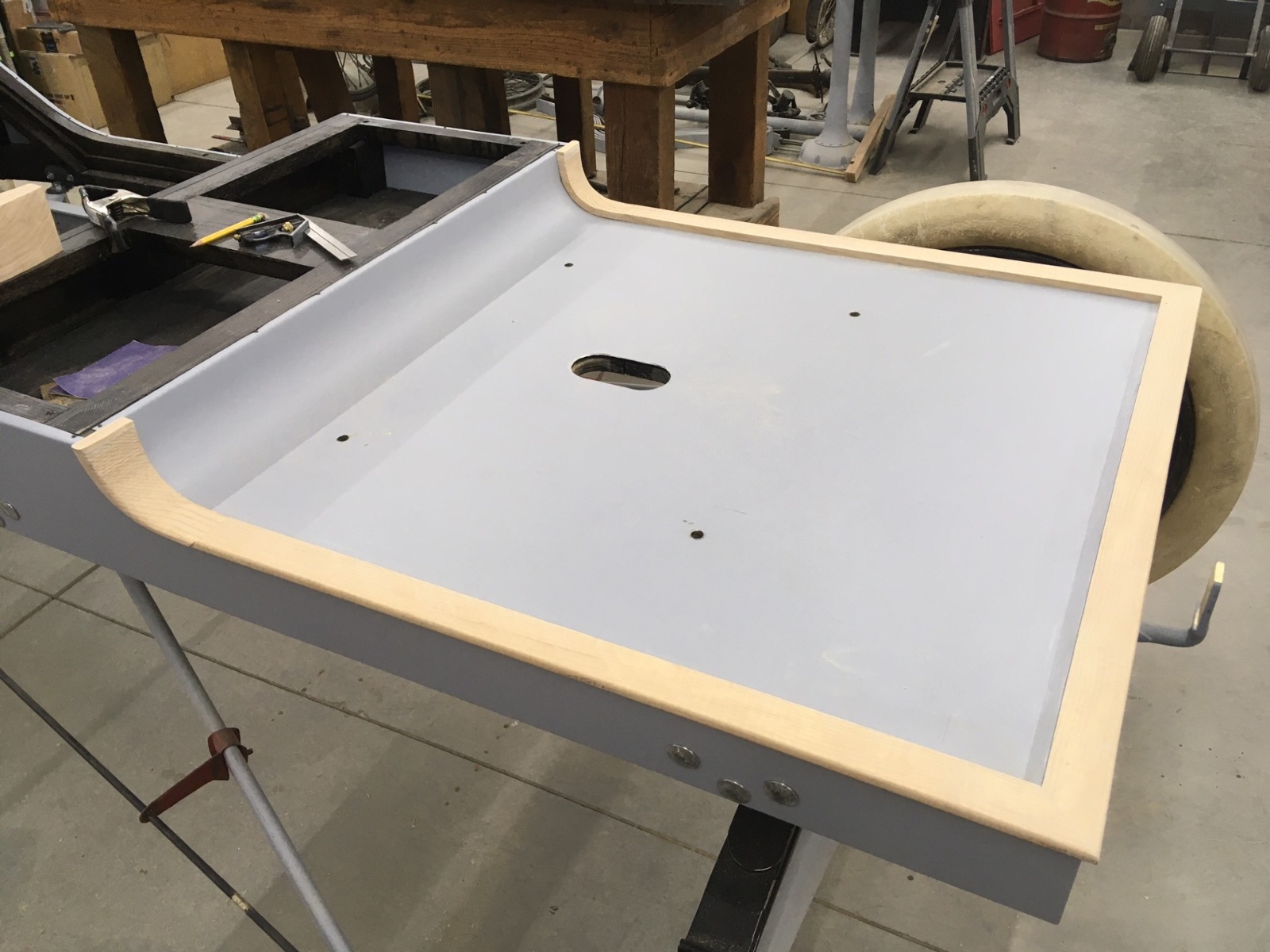

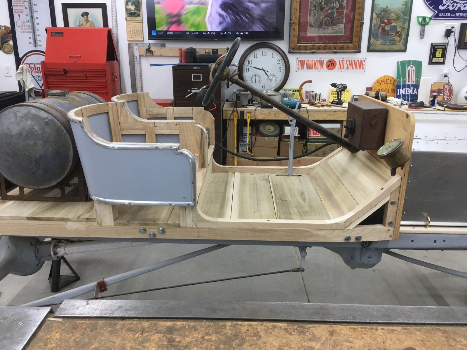

Post by Dollisdad » Sat Jan 13, 2024 11:14 pm
Set the supports for the gas tank.
And closed the ends of the seat riser.
Start to put floor on rear deck.

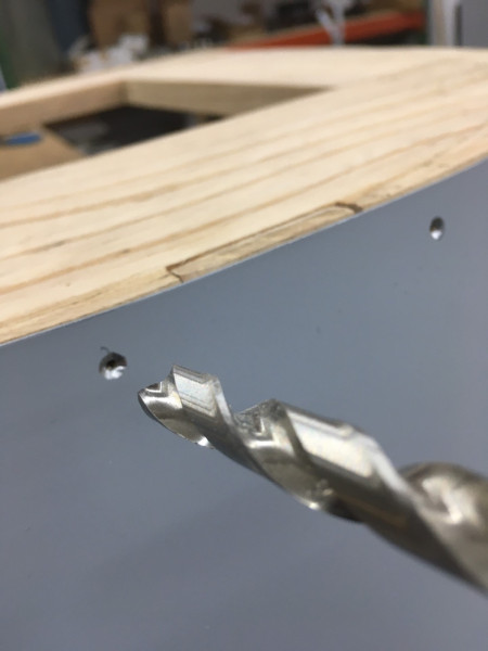

Posts: 3850
Re: You tell me

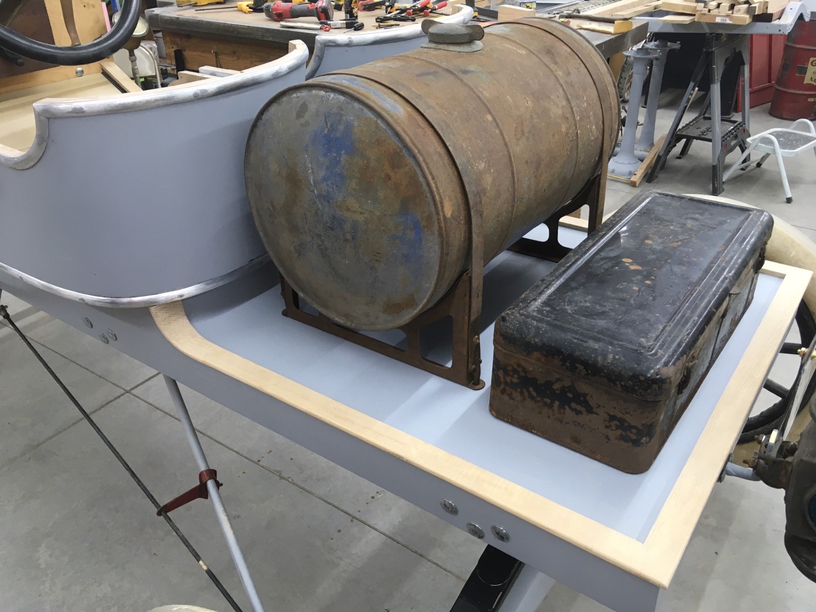

Post by Dollisdad » Sat Jan 13, 2024 11:23 pm
Drill mounts for gas tank.
Finish deck and end cap.
Drill mounts for tool box.
Posts: 3850
Re: You tell me
Post by Dollisdad » Sat Jan 13, 2024 11:25 pm
I think it’s getting there.

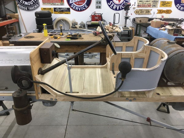

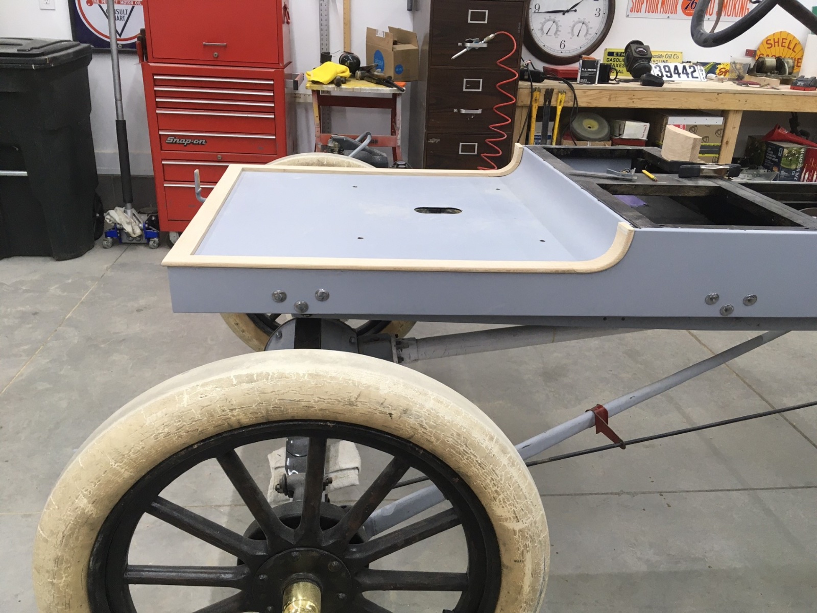

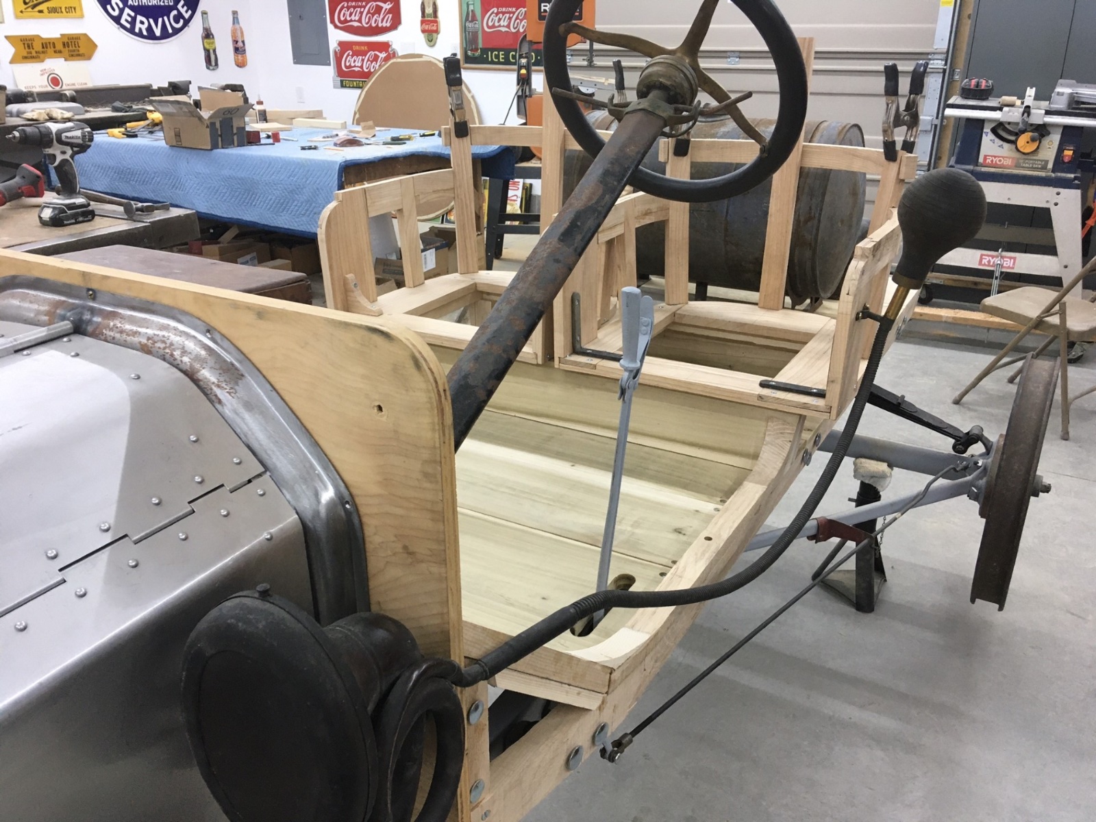

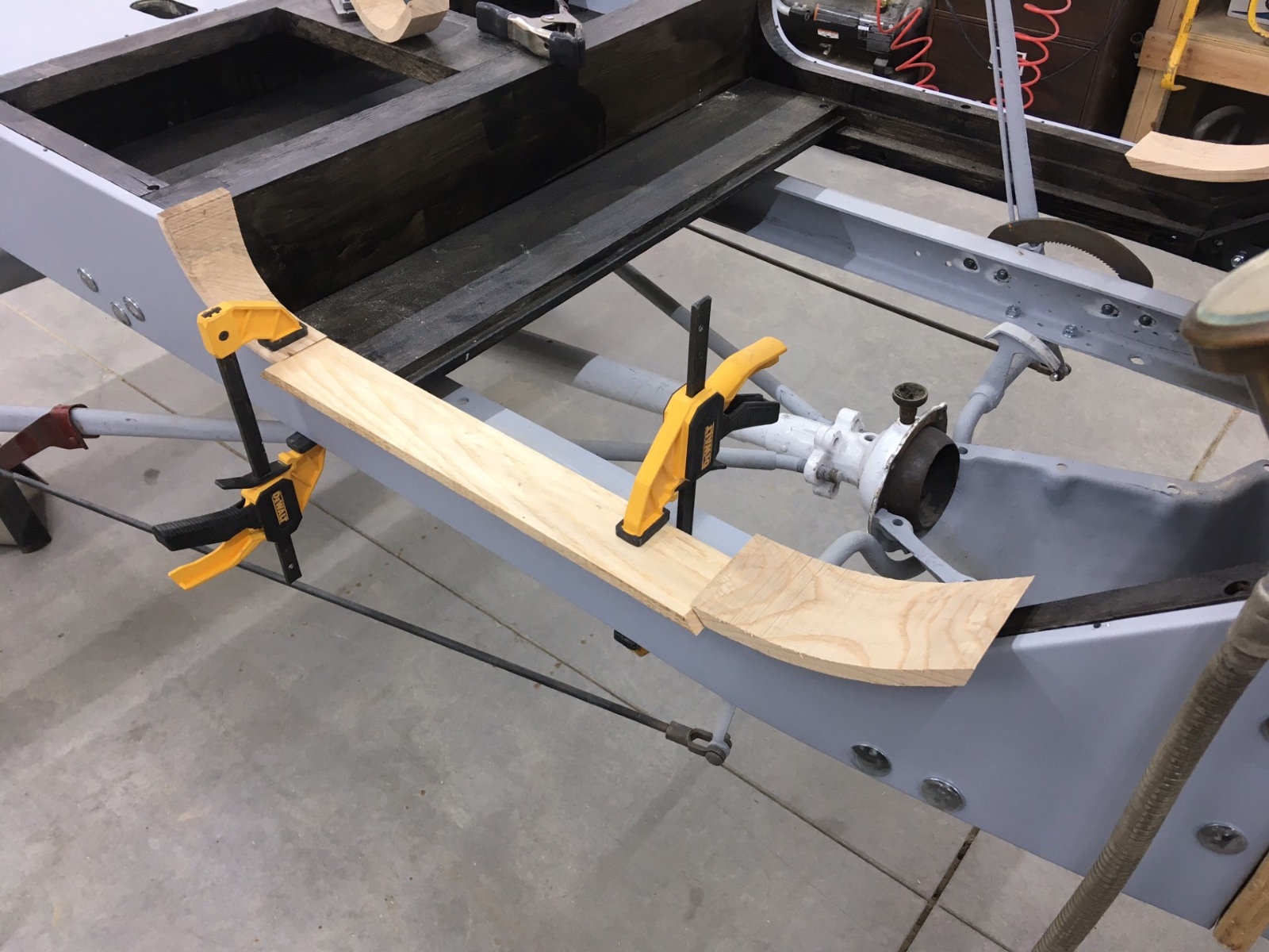

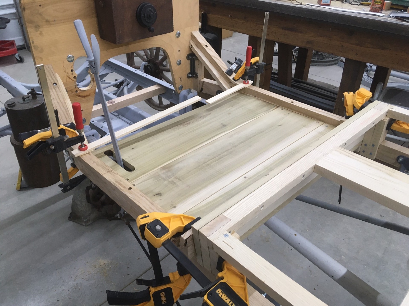

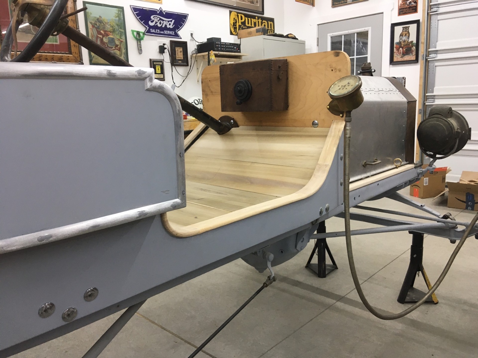

Posts: 3850
Re: You tell me

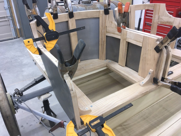

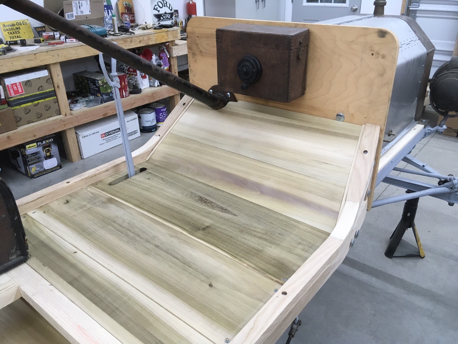

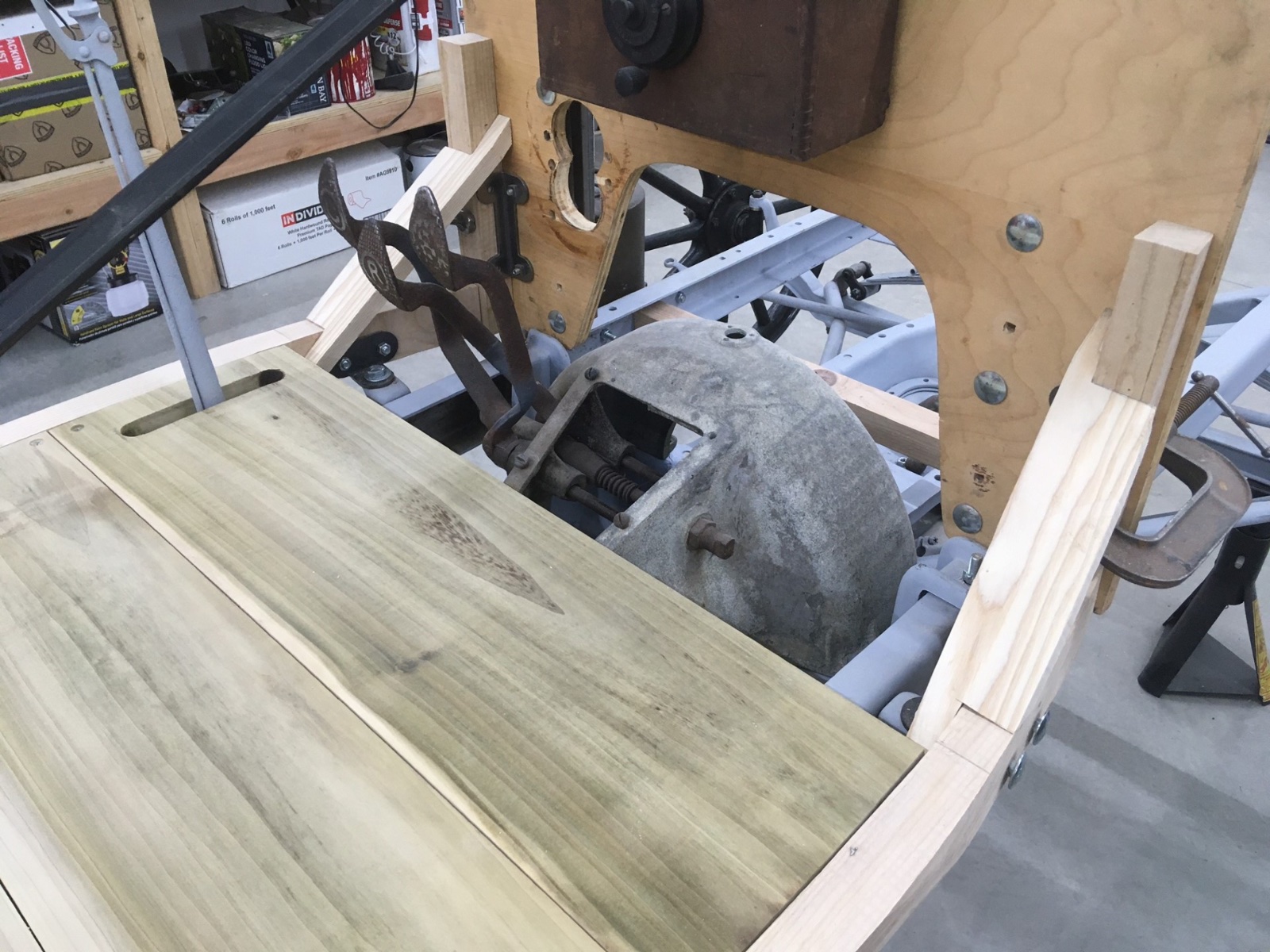

Post by Dollisdad » Sat Jan 20, 2024 1:44 am

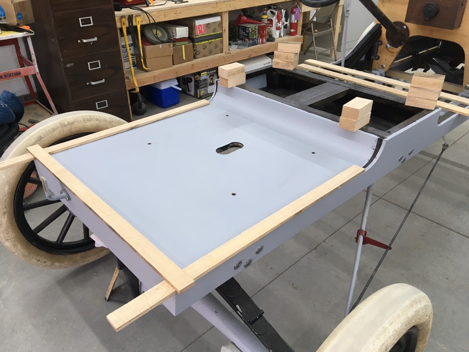

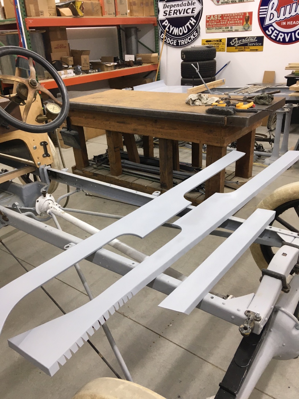

Set the floorboards.
Set the risers.
Set the sill caps.

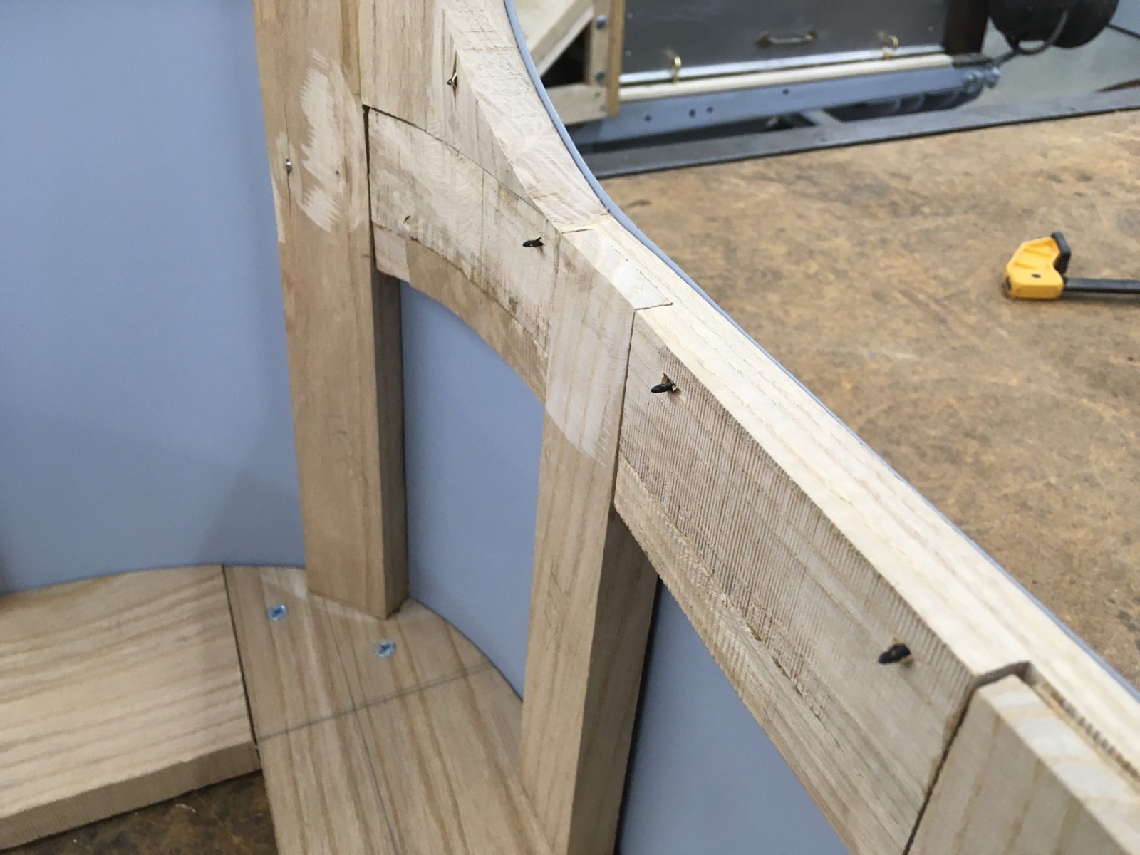

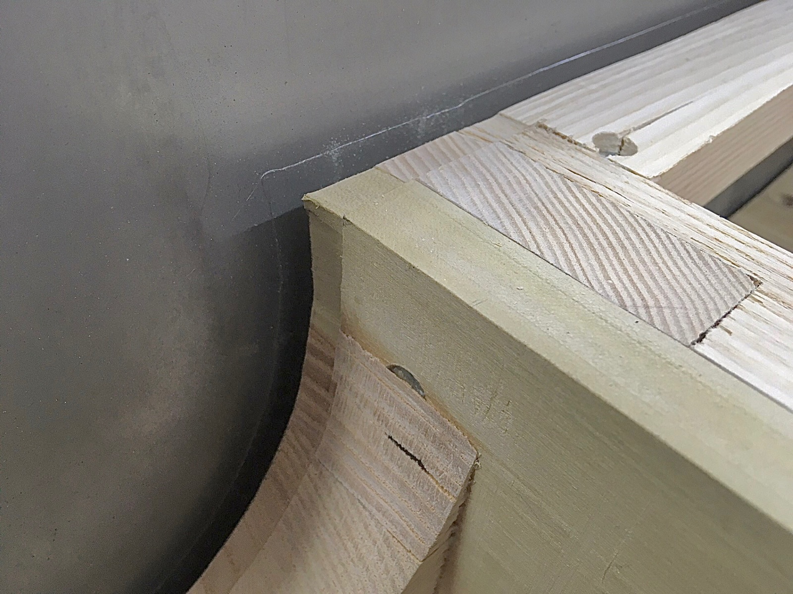

Posts: 3850
Re: You tell me
Post by Dollisdad » Sat Jan 20, 2024 1:56 am
Set the corners.
And forward sweepers
A little clean up,
Posts: 3850
Re: You tell me
Post by Dollisdad » Sat Jan 20, 2024 2:10 am
and I’ll make the upright floorboards when I get the pedals reshaped.

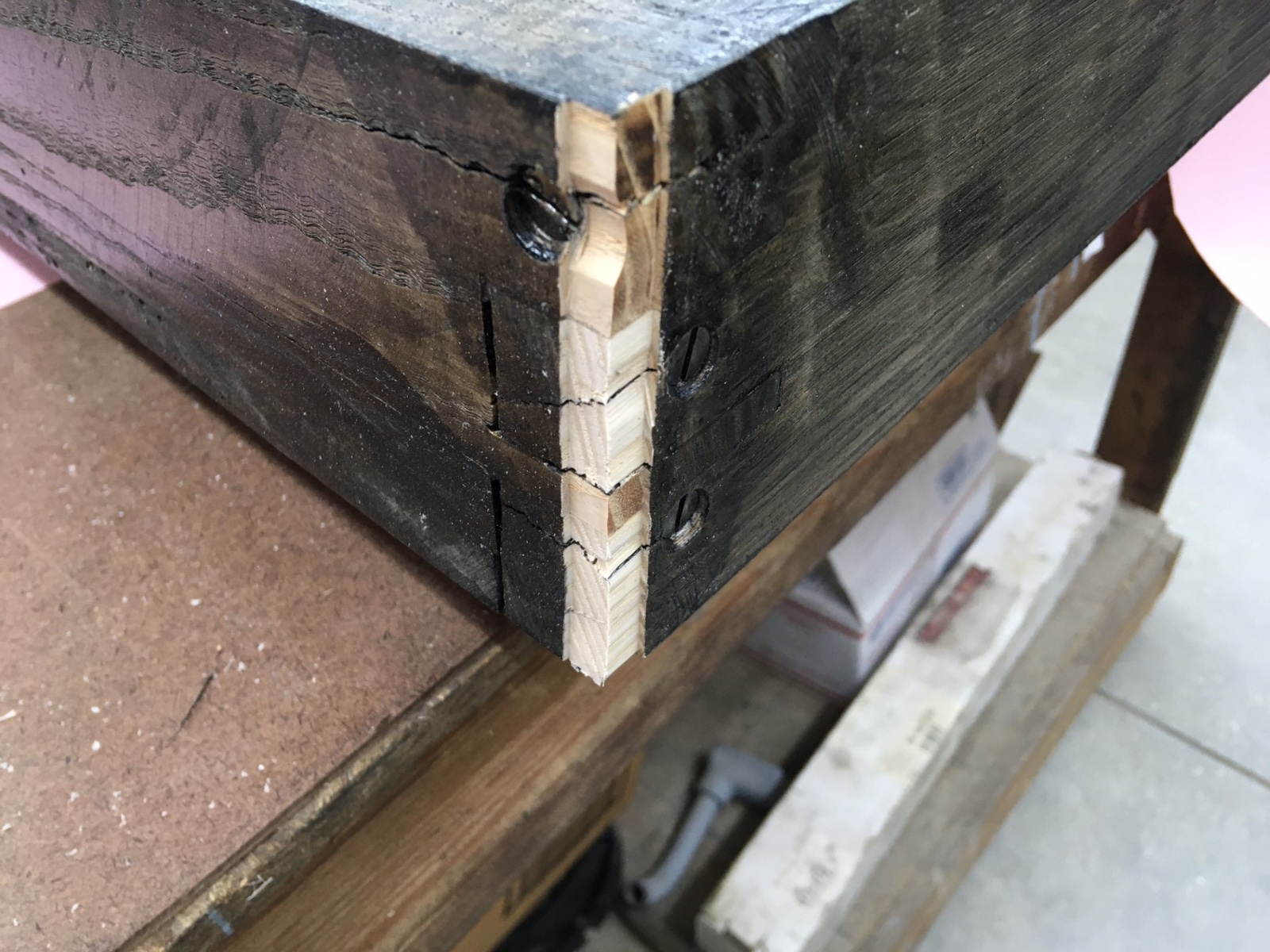

All the framework is Ash and the deck,floorboards,heel and back panel are poplar.

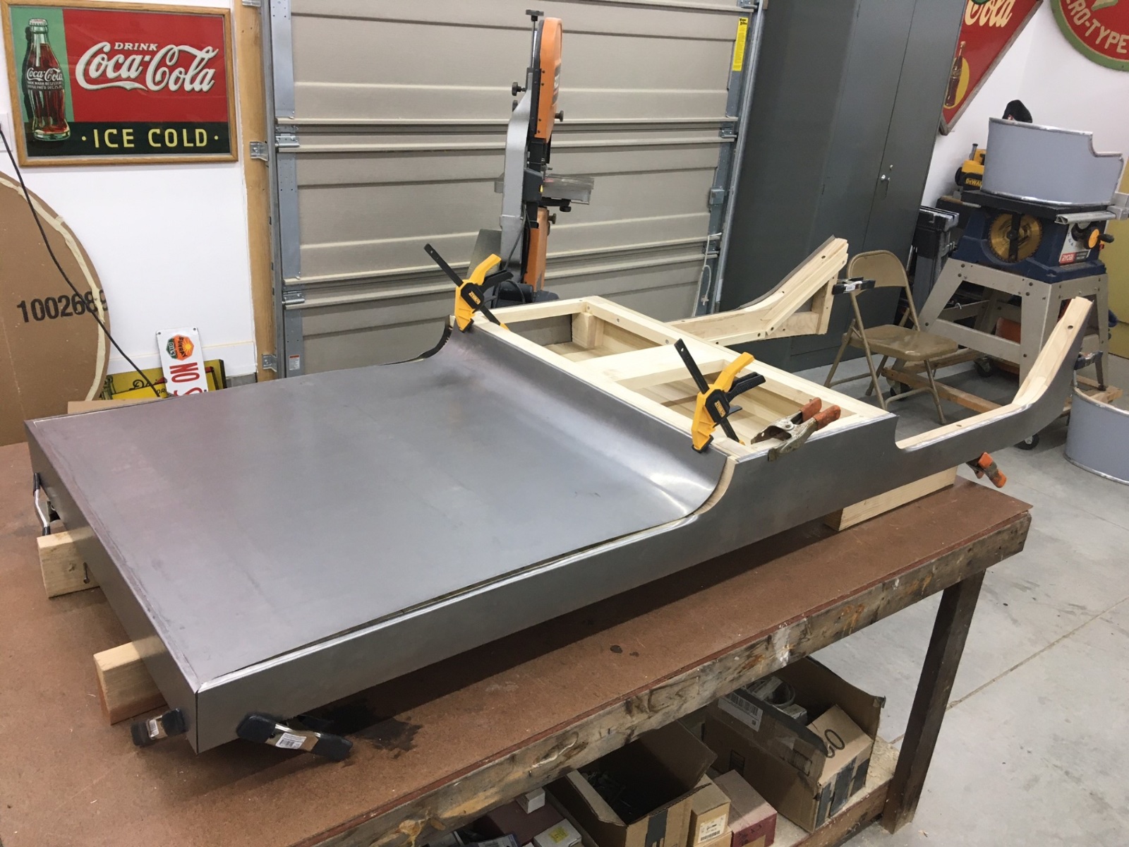

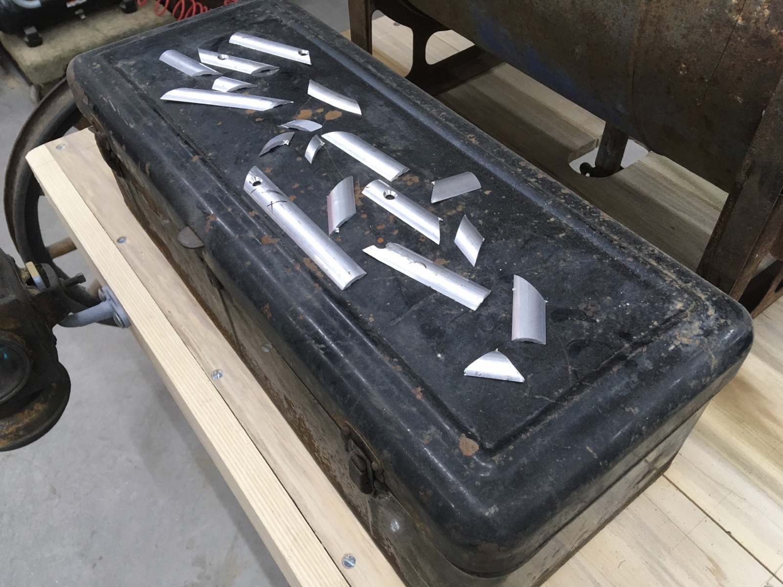

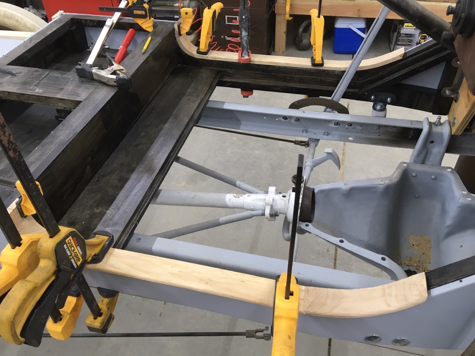

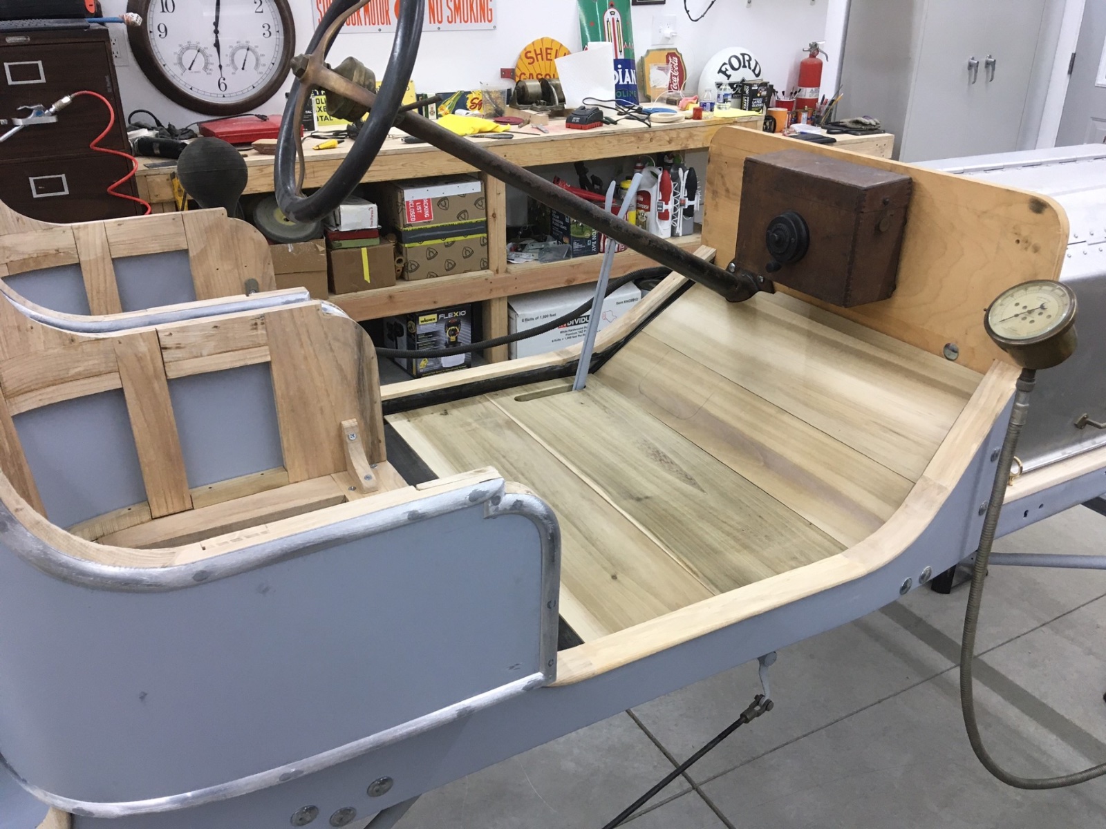

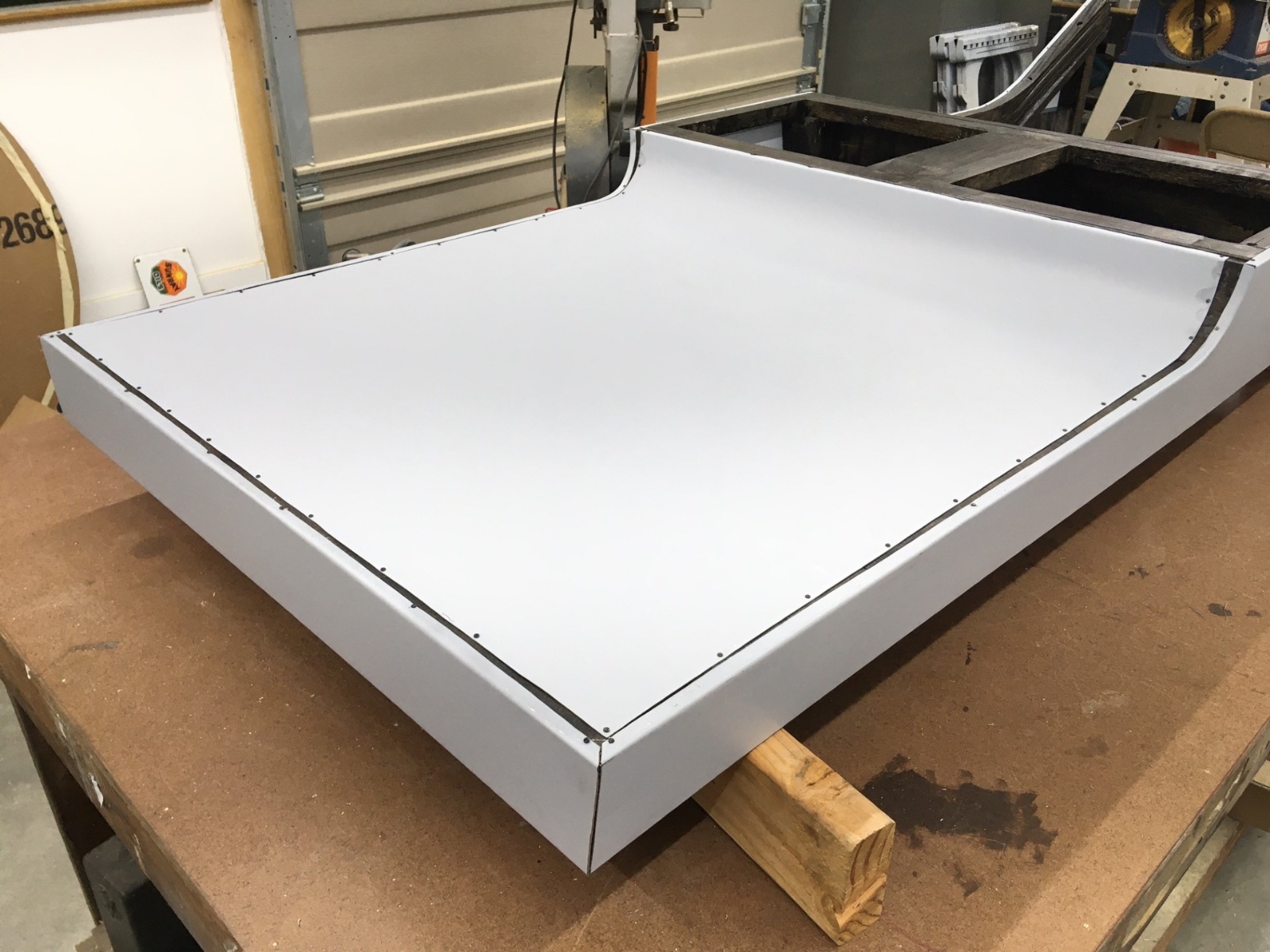

Posts: 3850

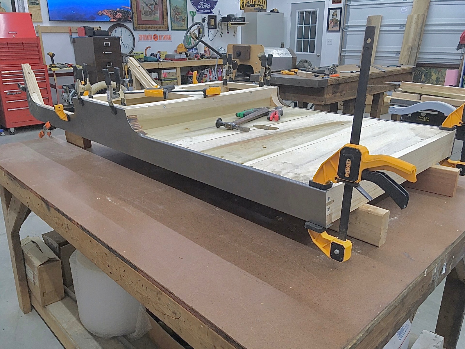

Re: You tell me

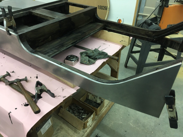

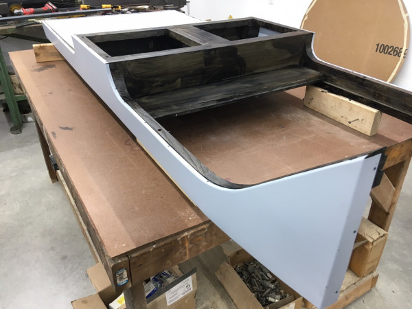

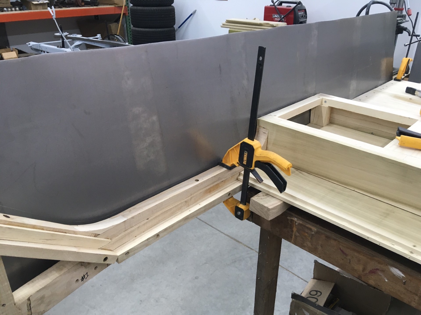

Post by Dollisdad » Tue Jan 30, 2024 11:43 am

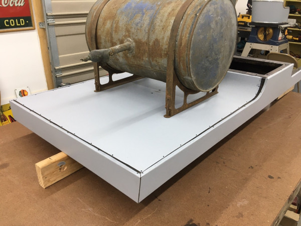

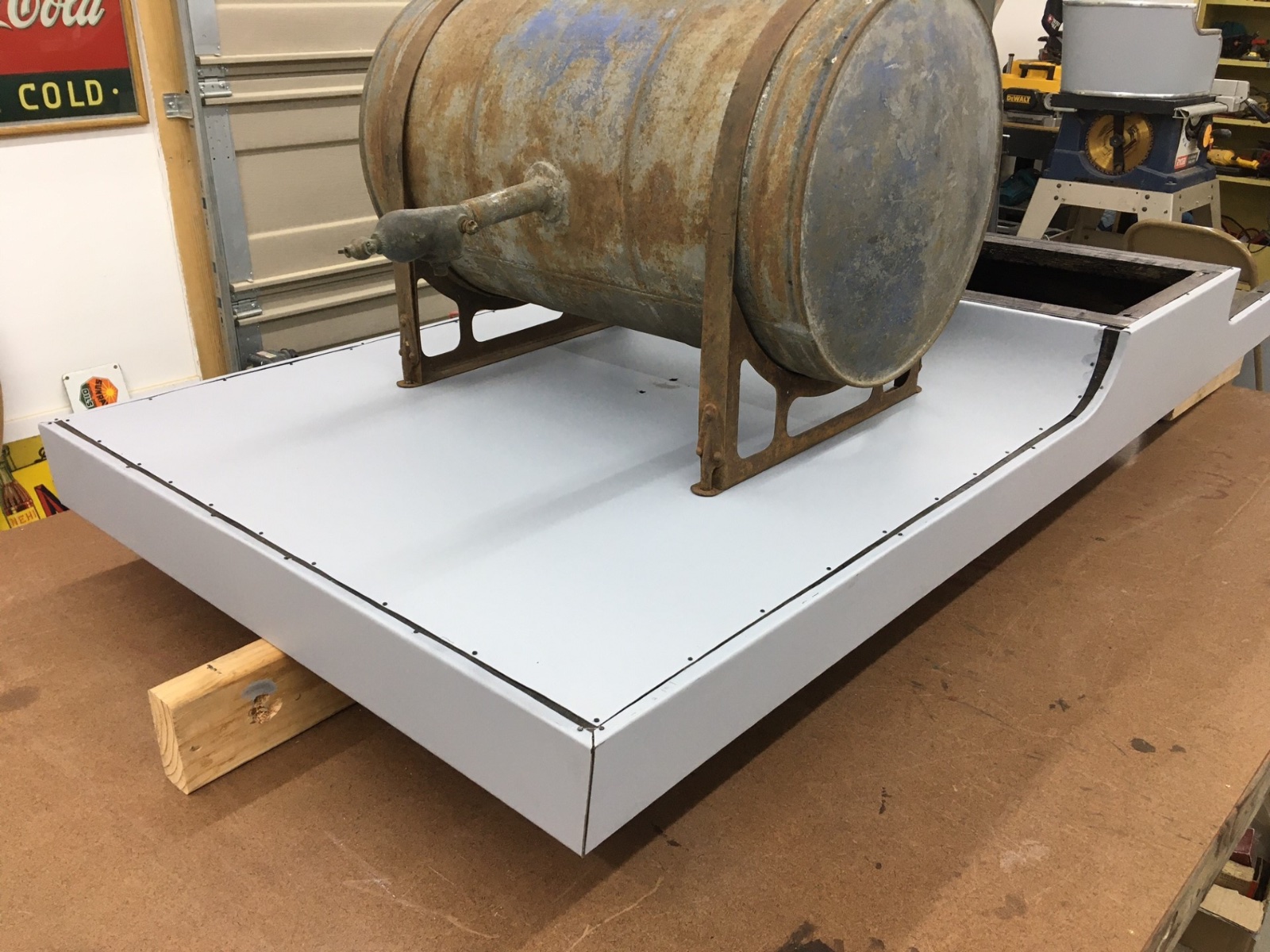

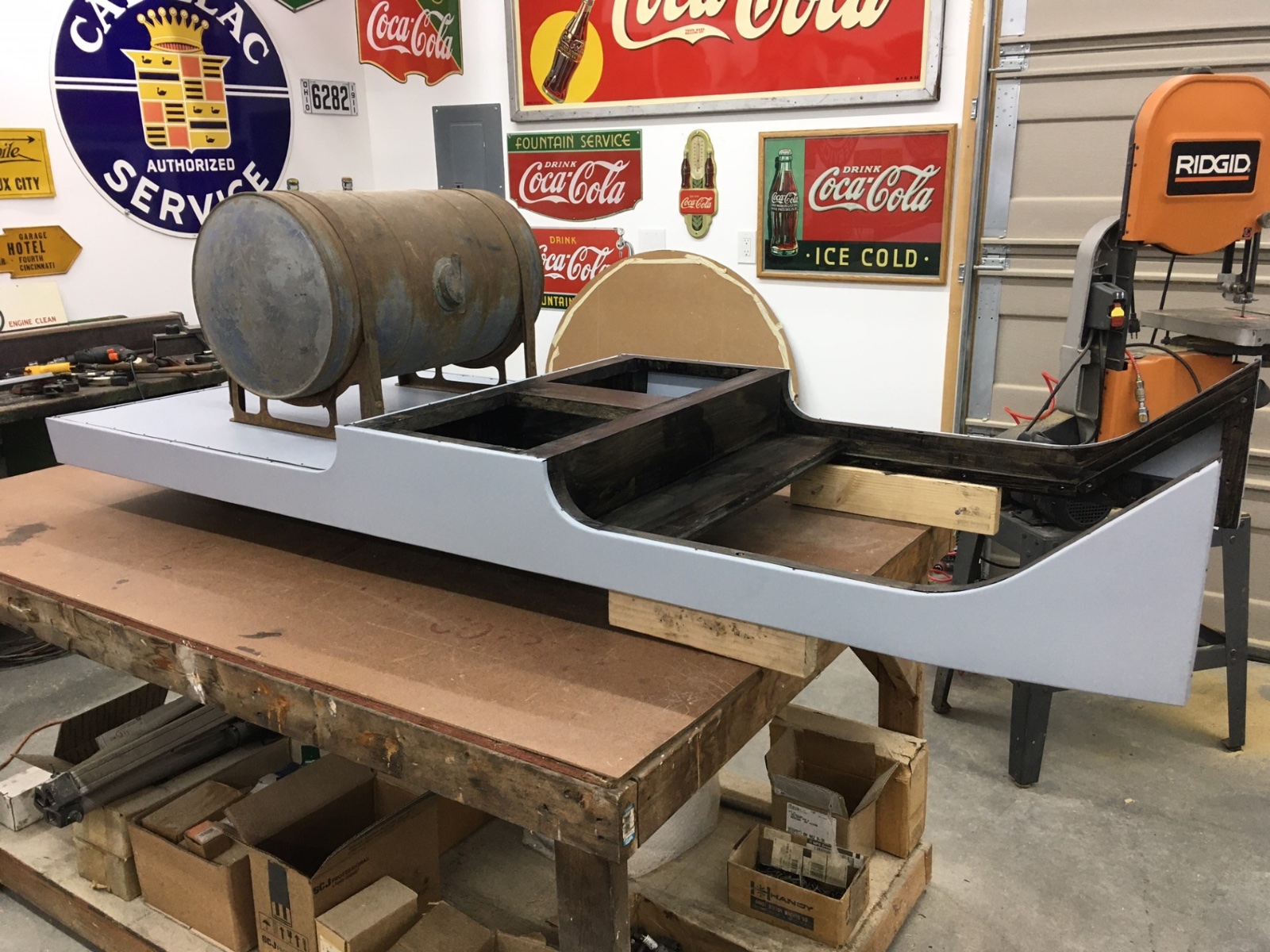

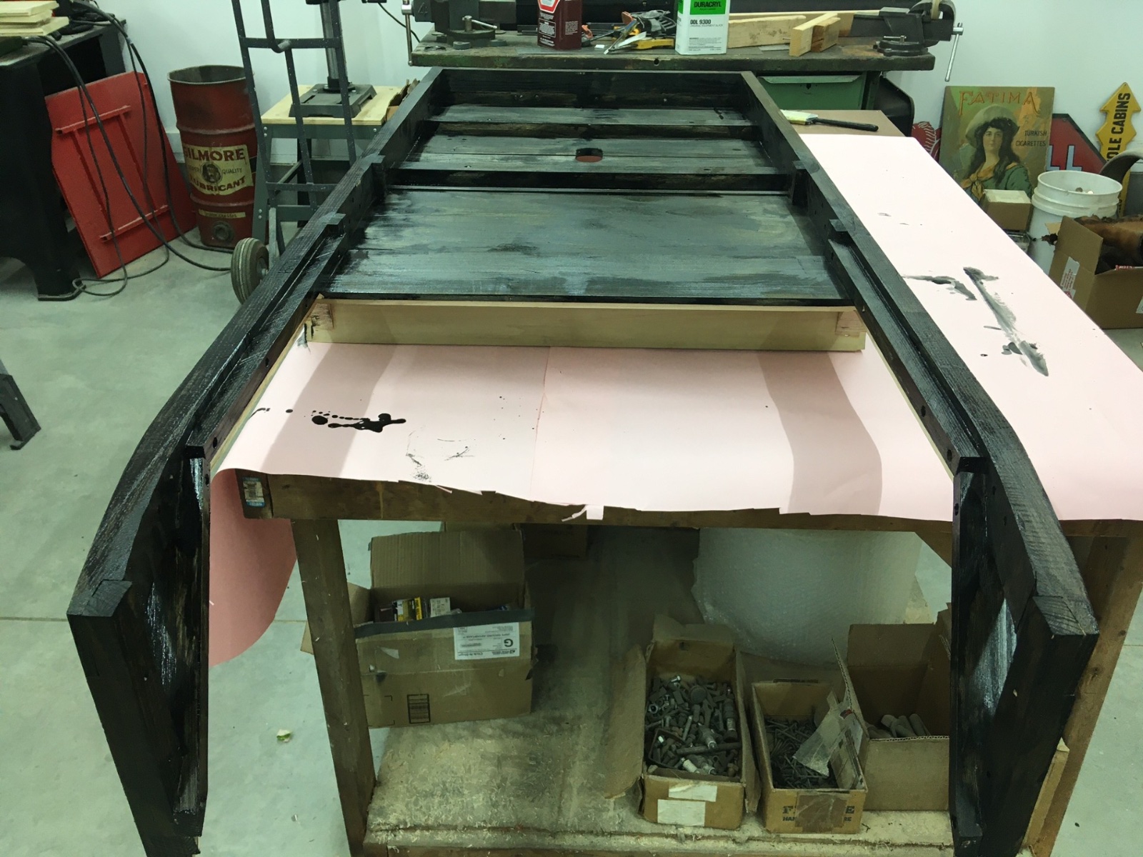

Floor and hood sills done.

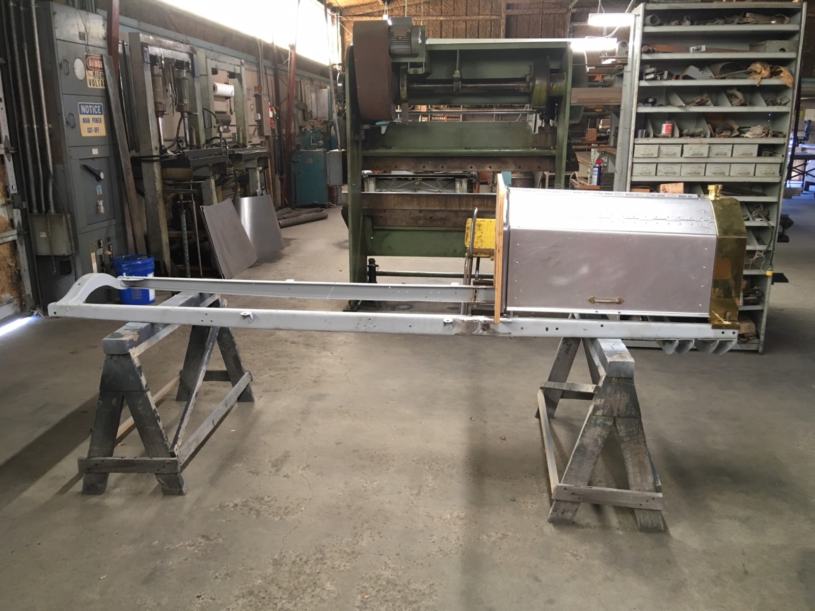

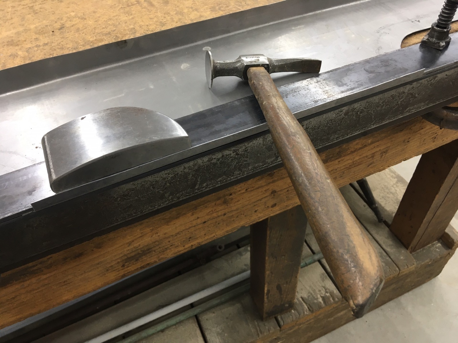

Now I need to find someone with a 8’ brake so I can start to skin the deck. In the meantime I’ll start to build the frame works for the seats.

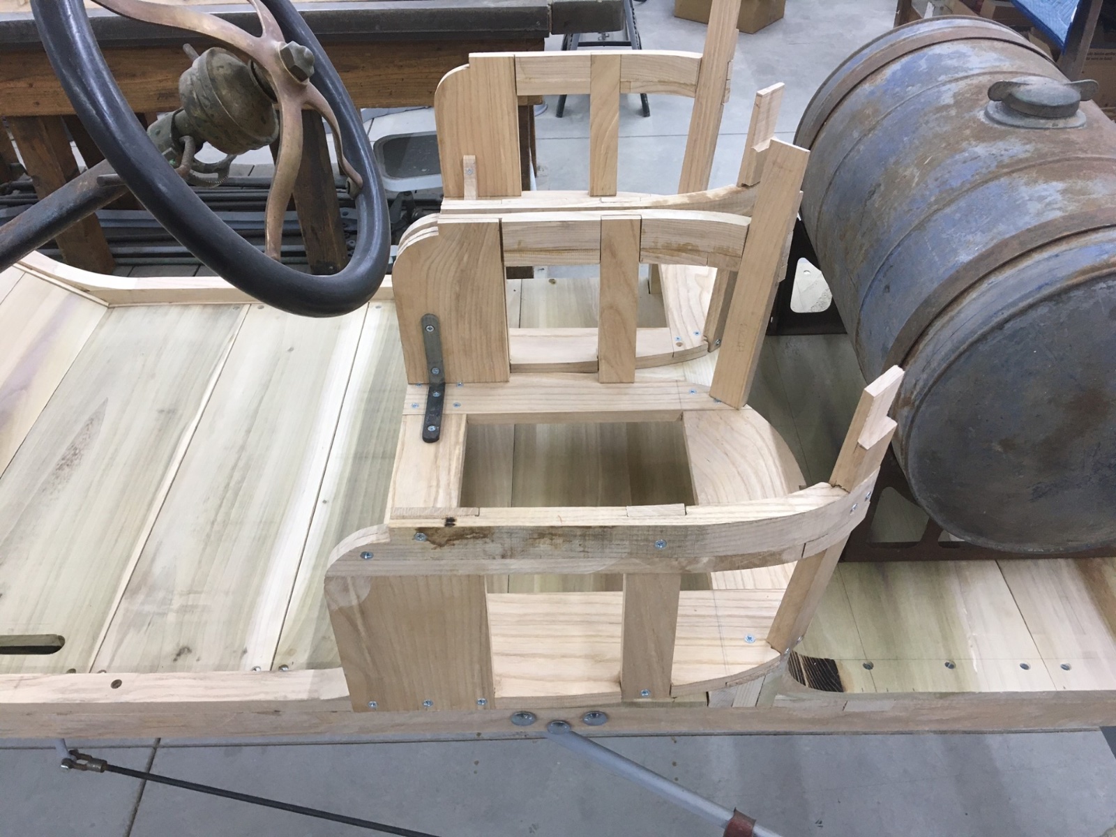

Posts: 3850
Re: You tell me

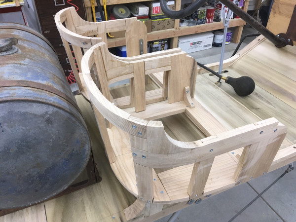

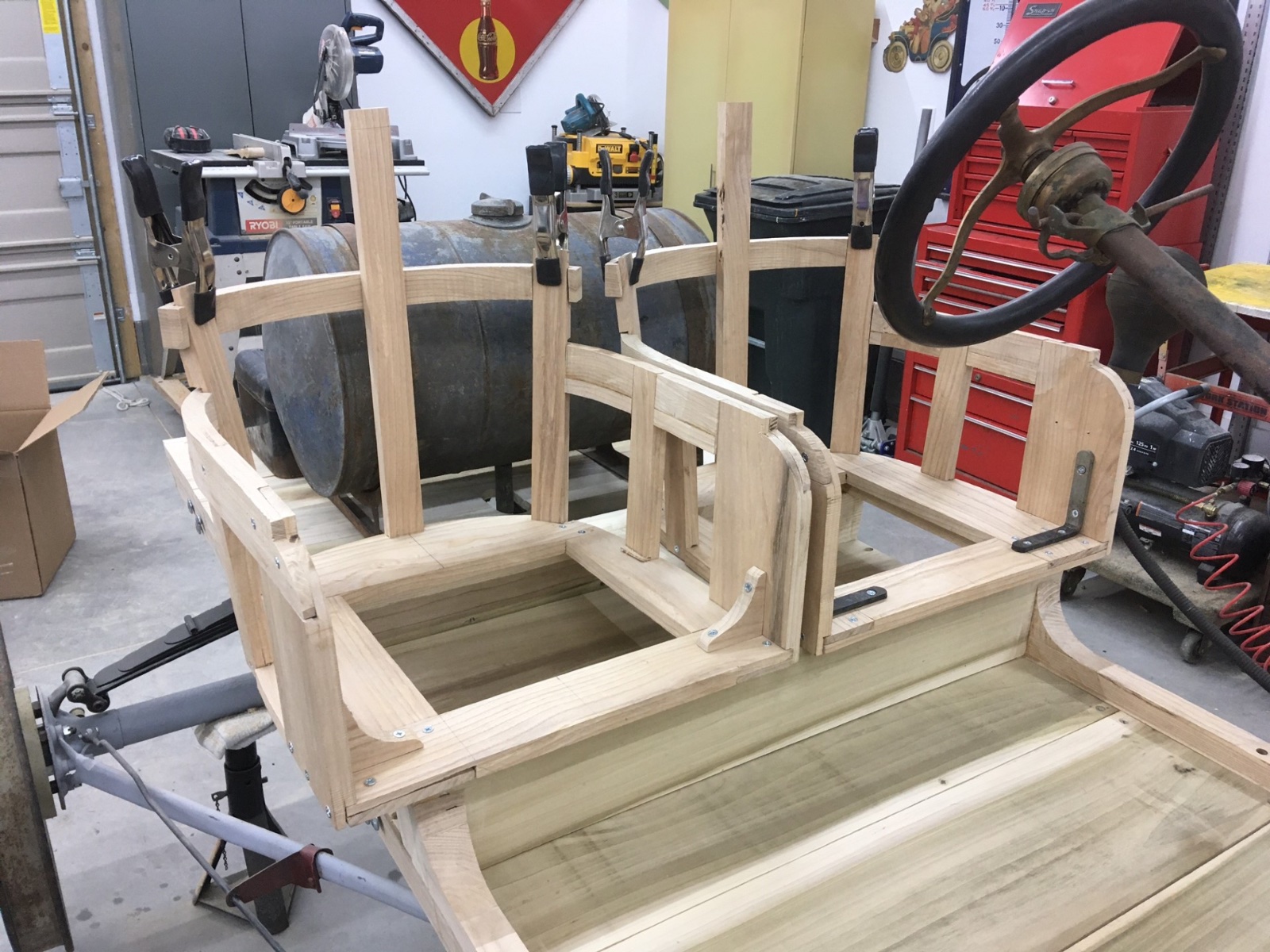

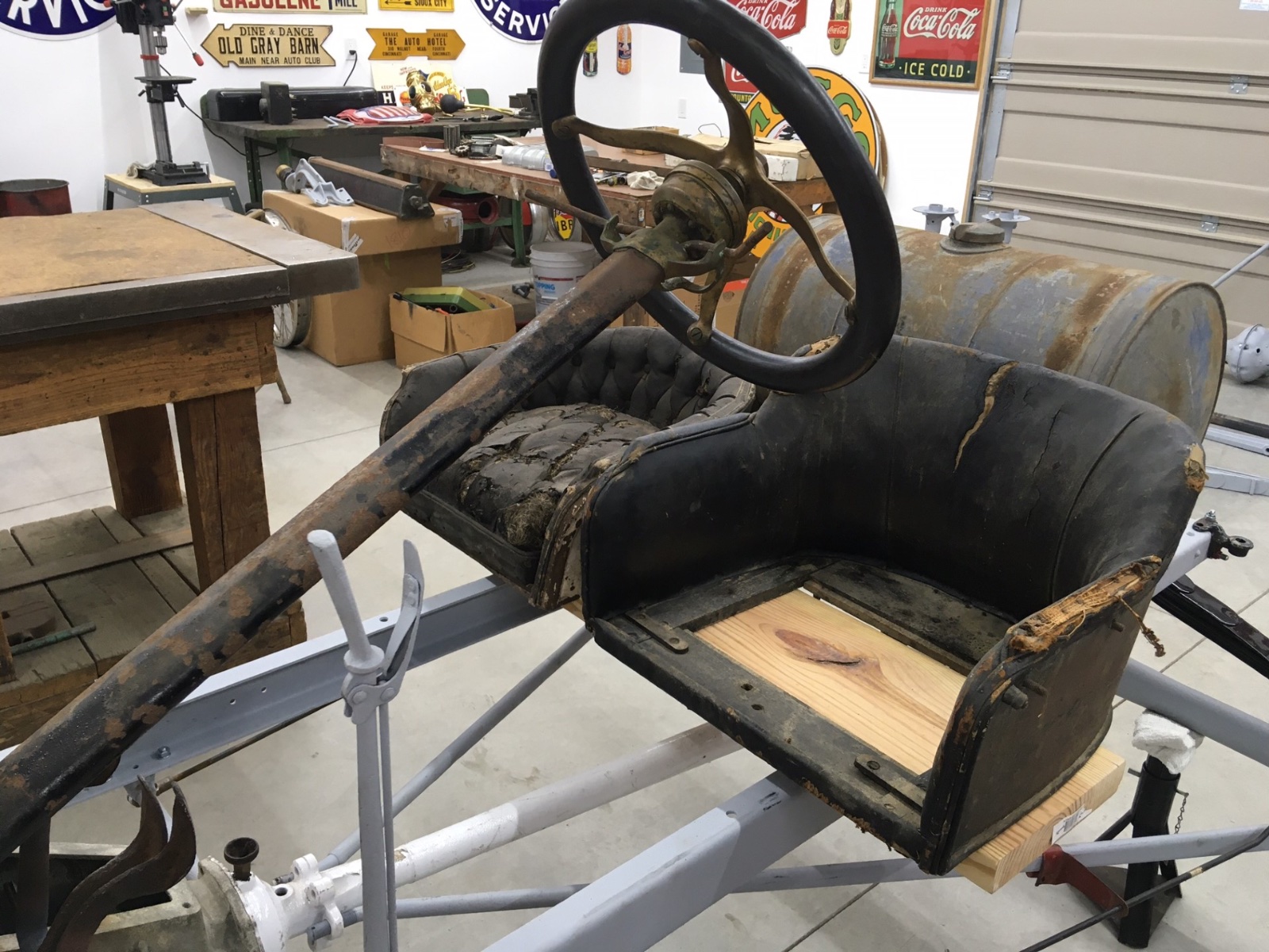

Post by Dollisdad » Thu Feb 08, 2024 6:33 pm

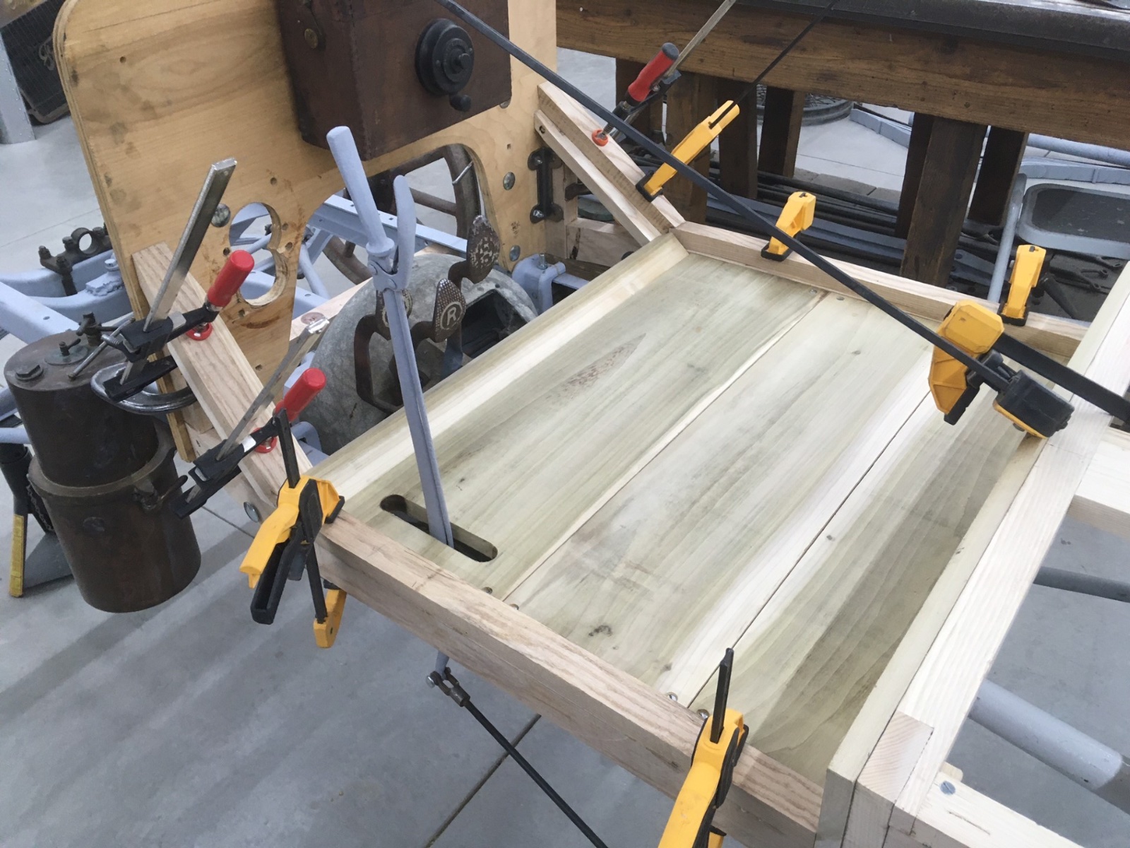

Making progress on seats

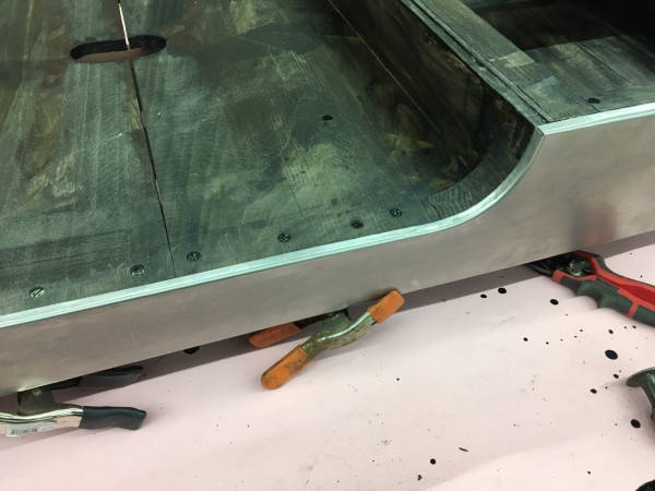

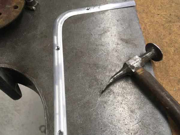

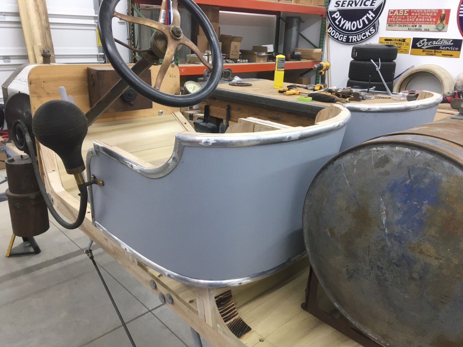

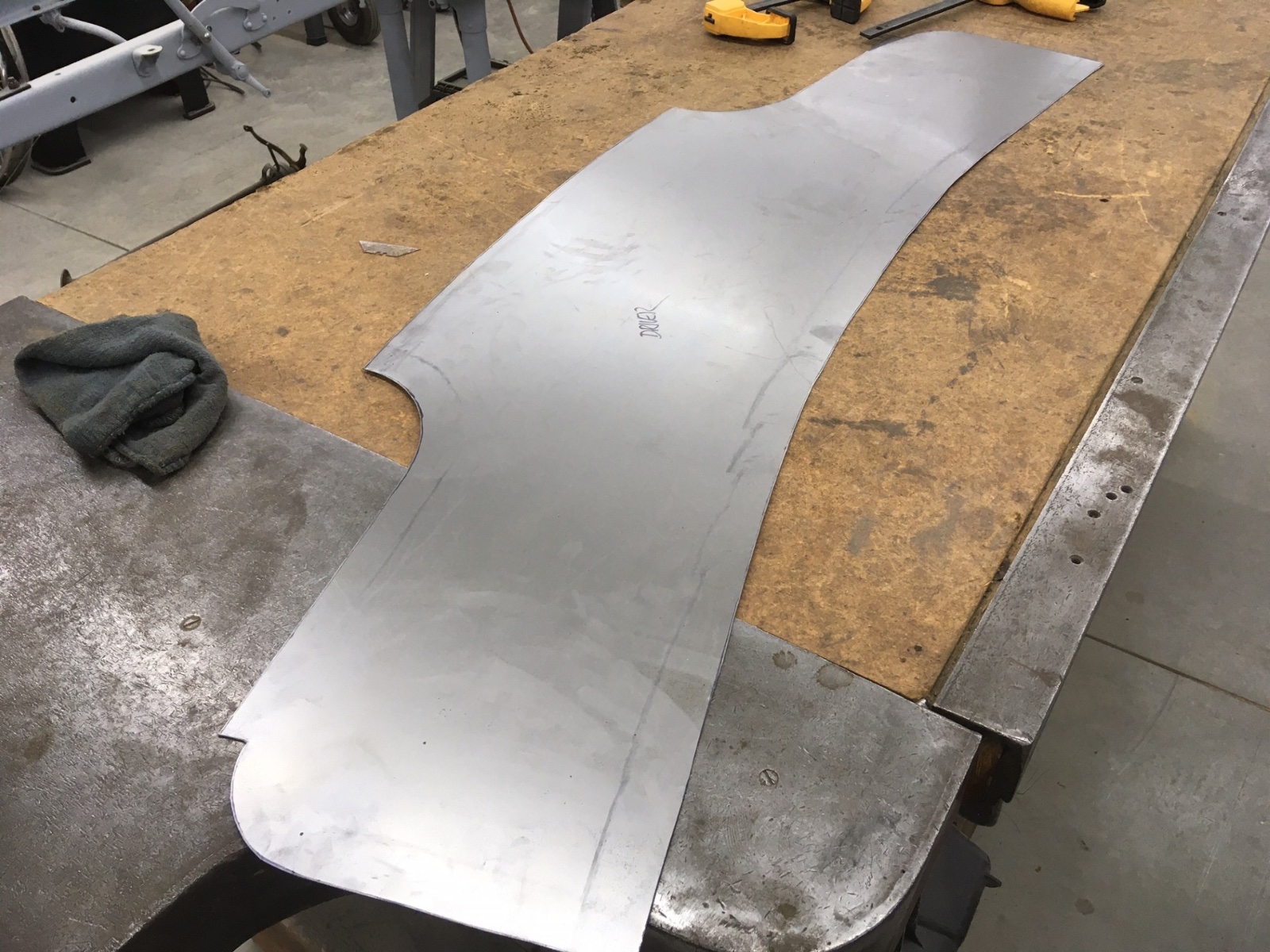

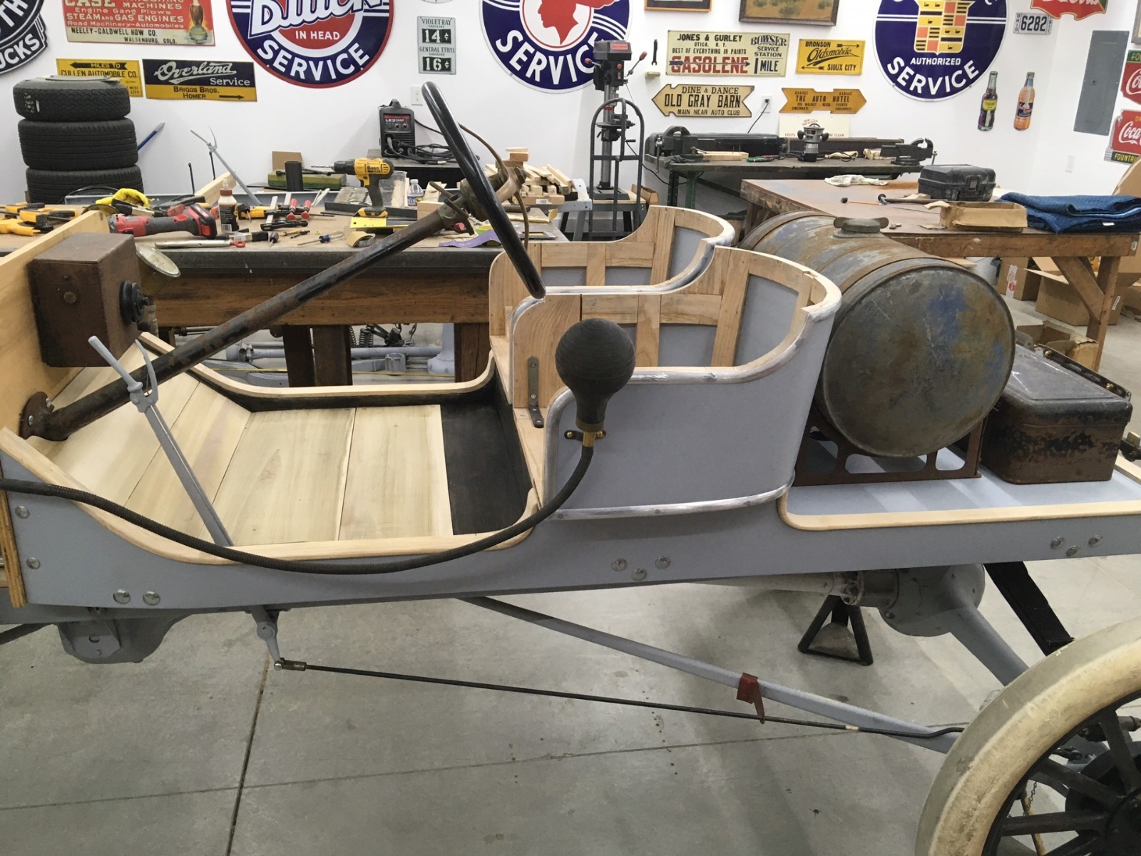

Posts: 3850

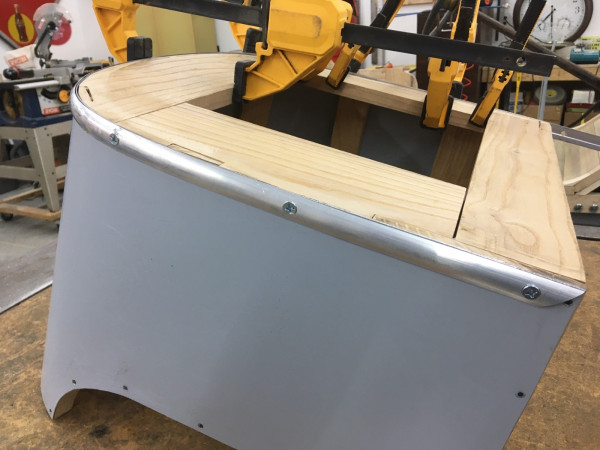

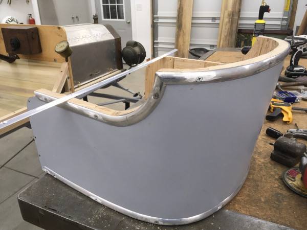

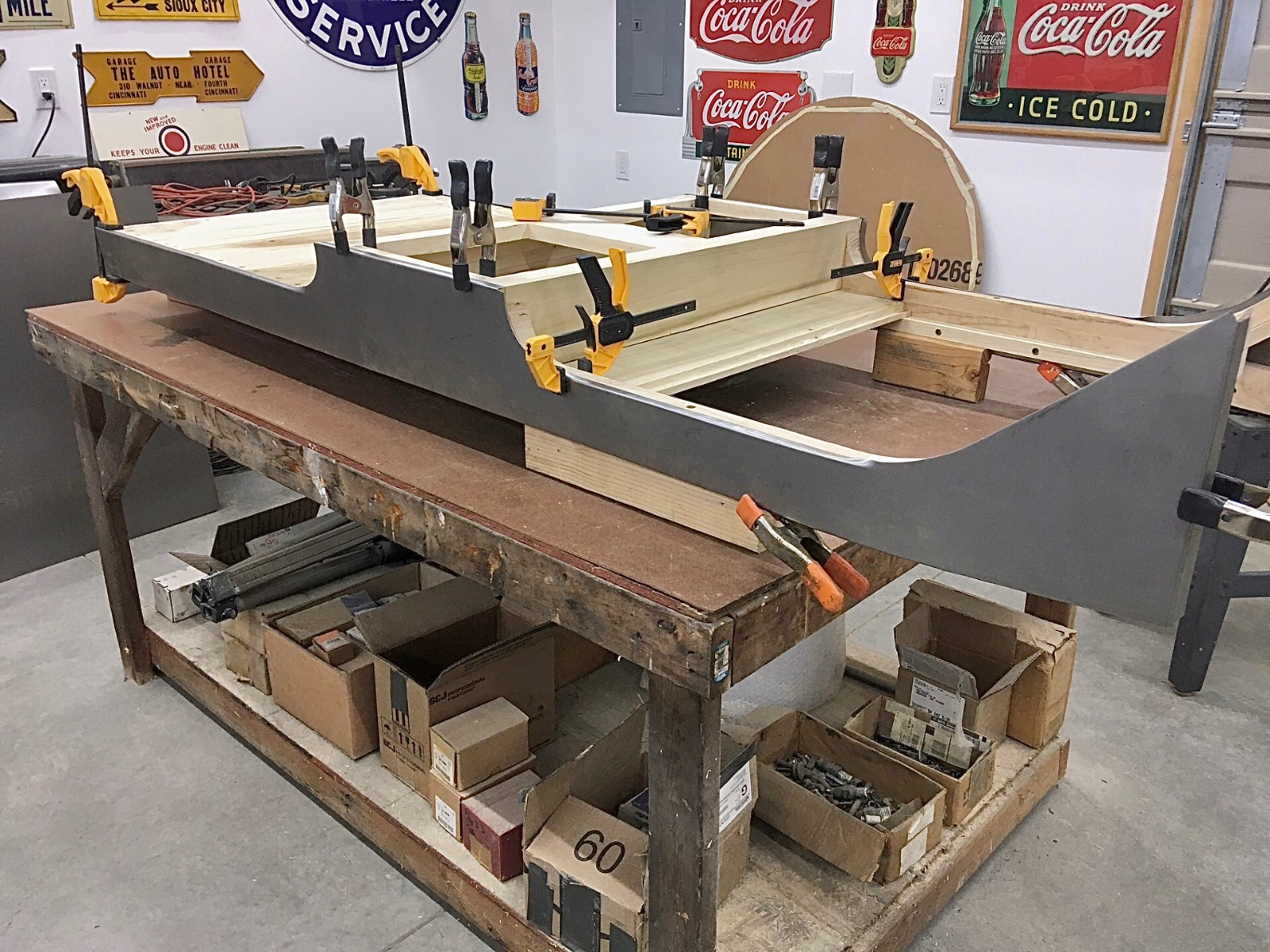

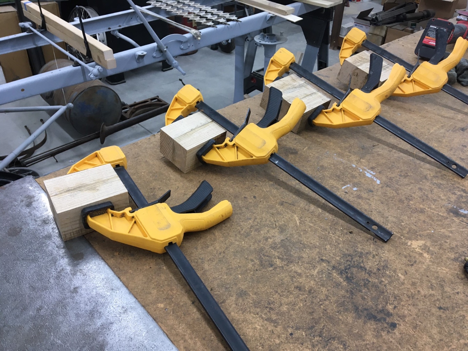

Re: You tell me

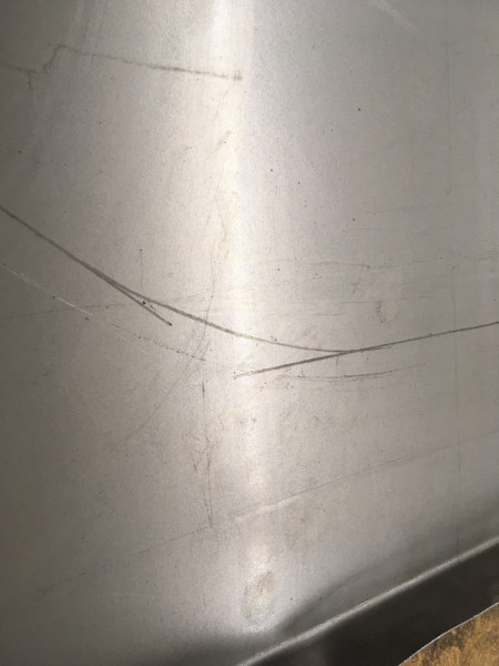

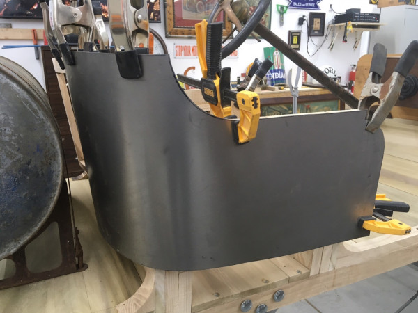

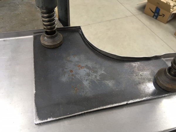

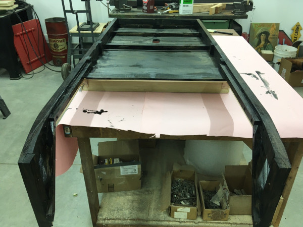

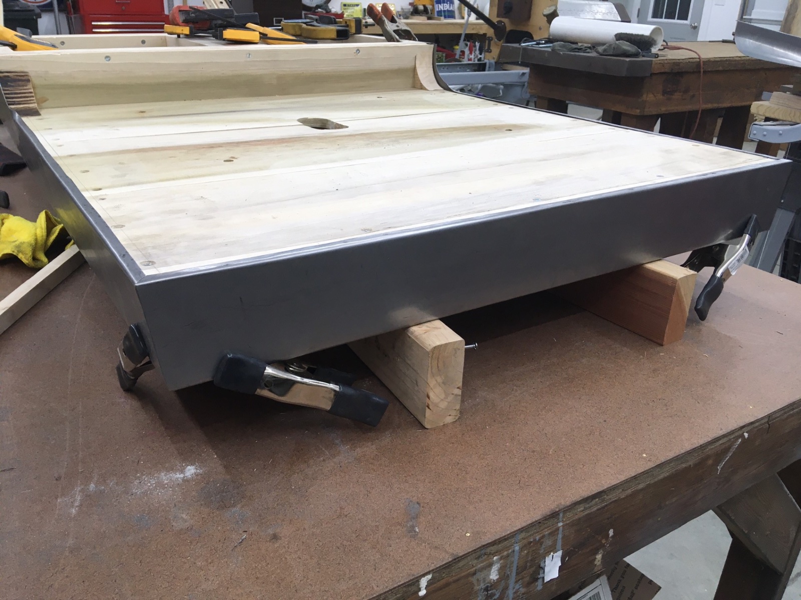

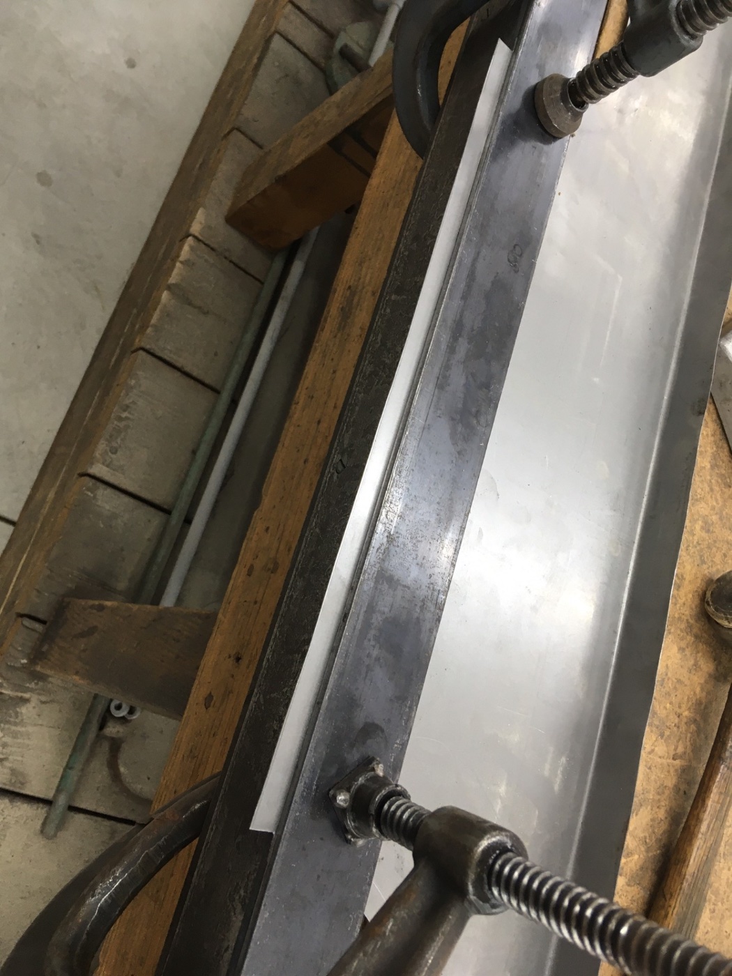

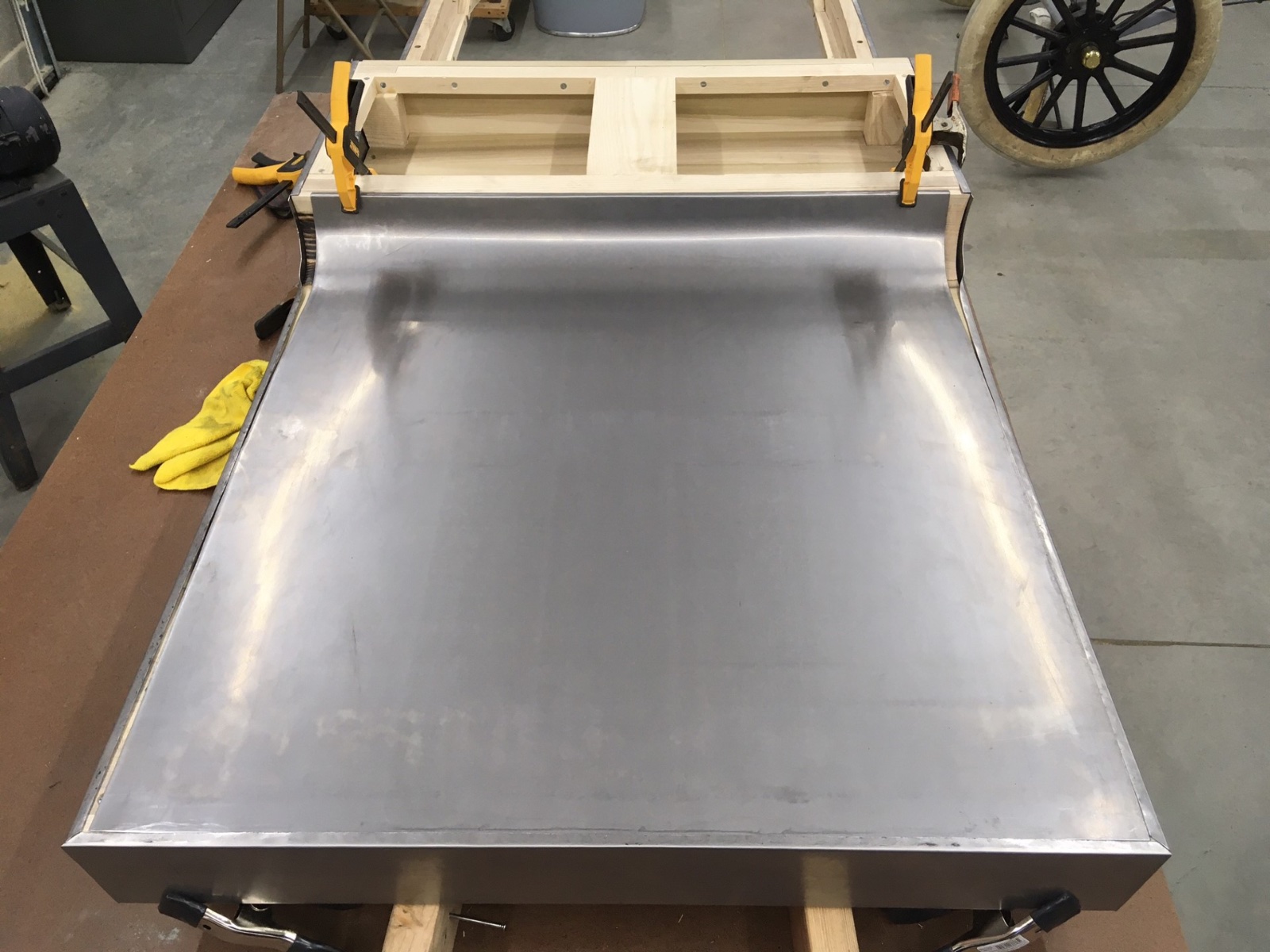

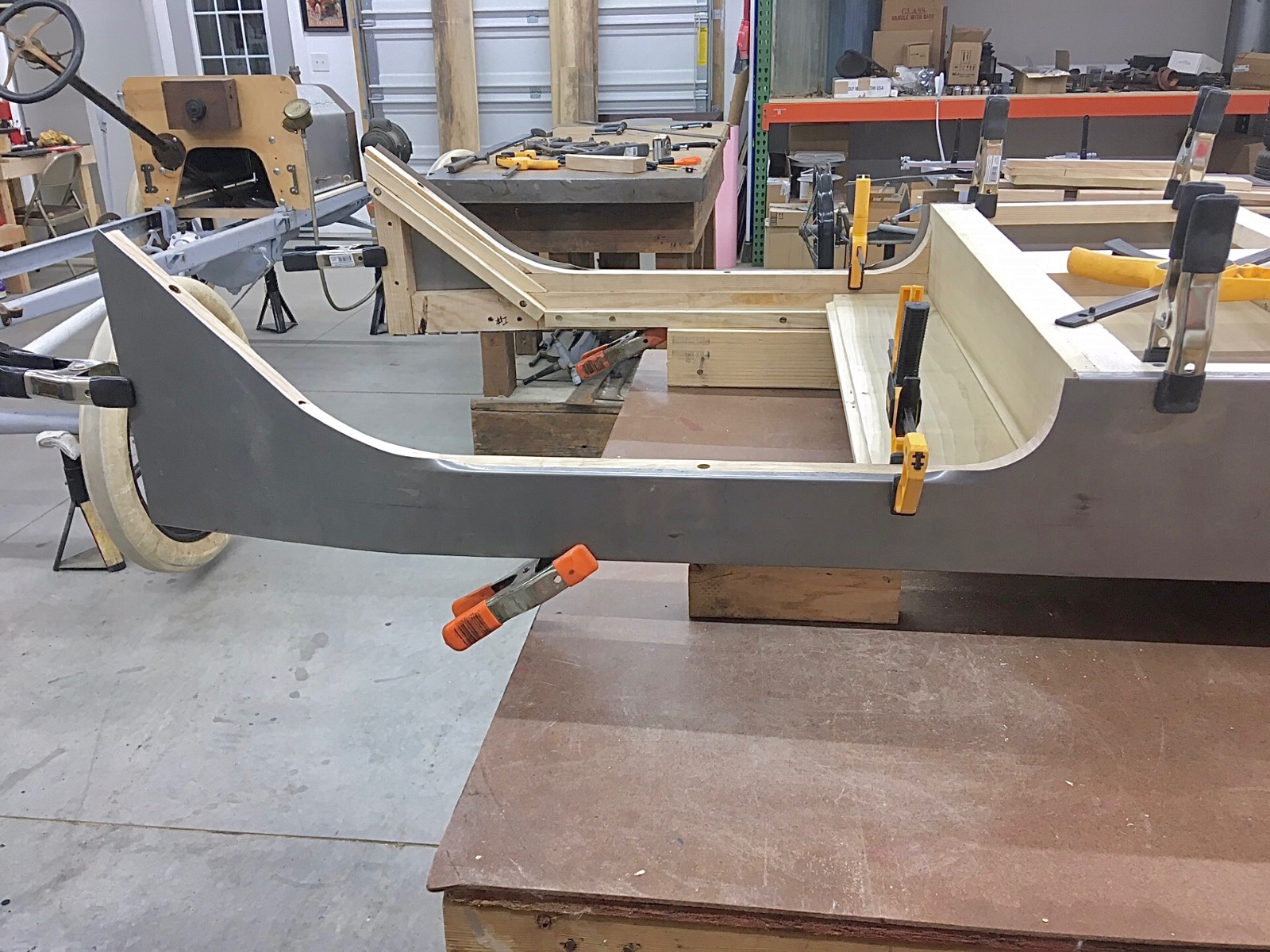

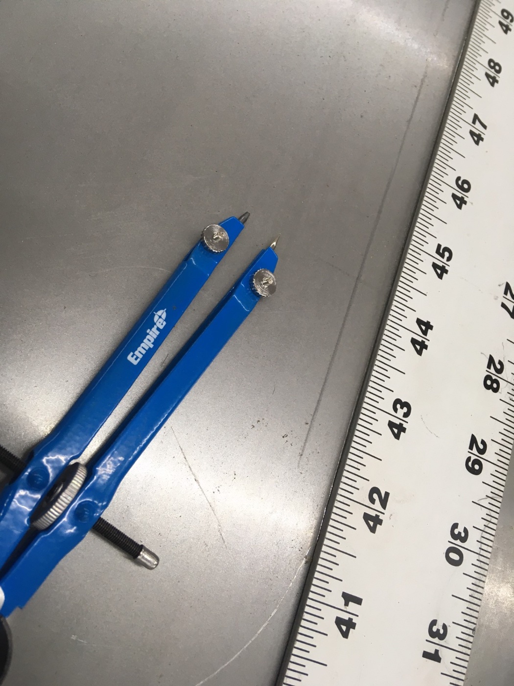

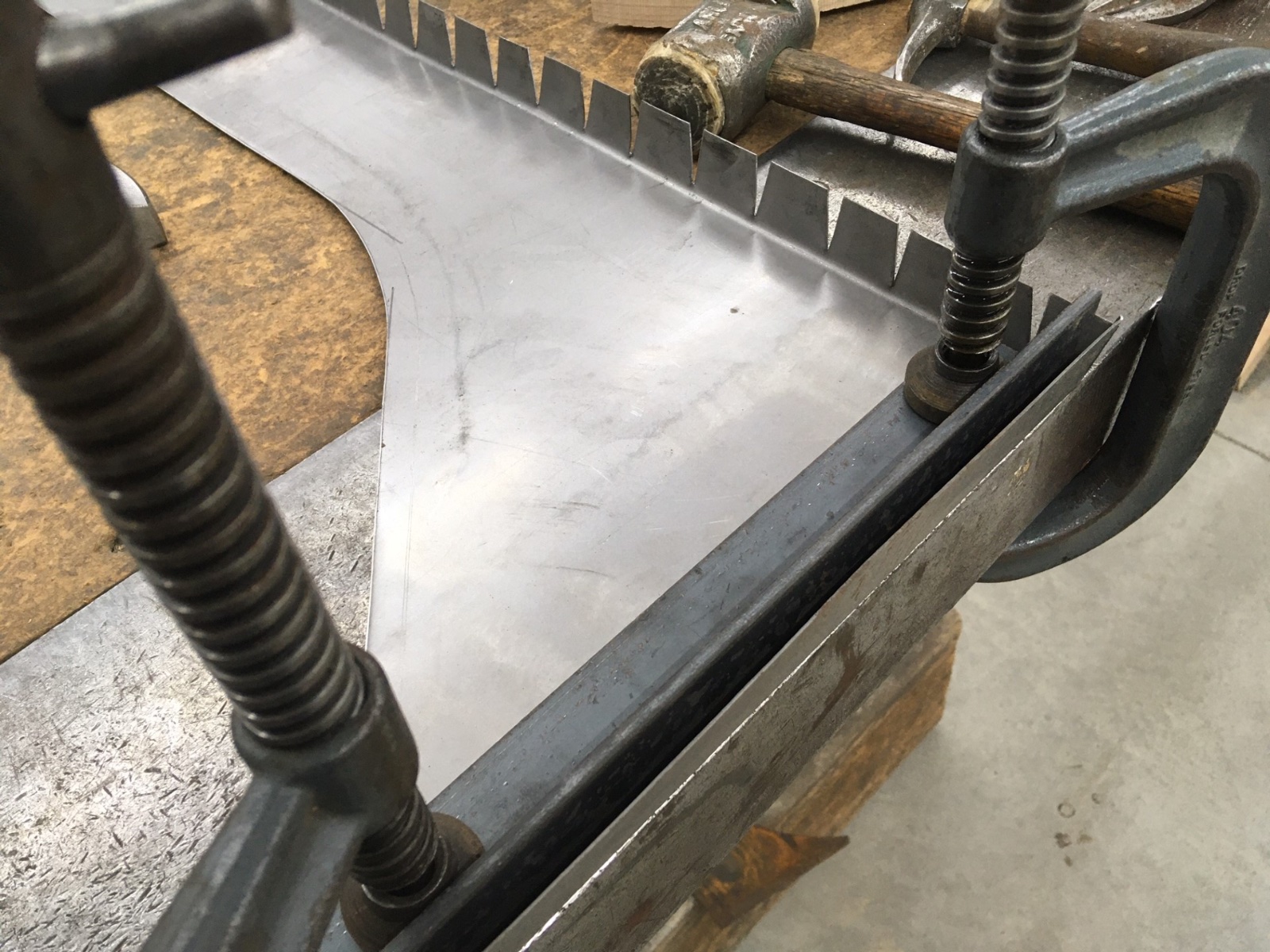

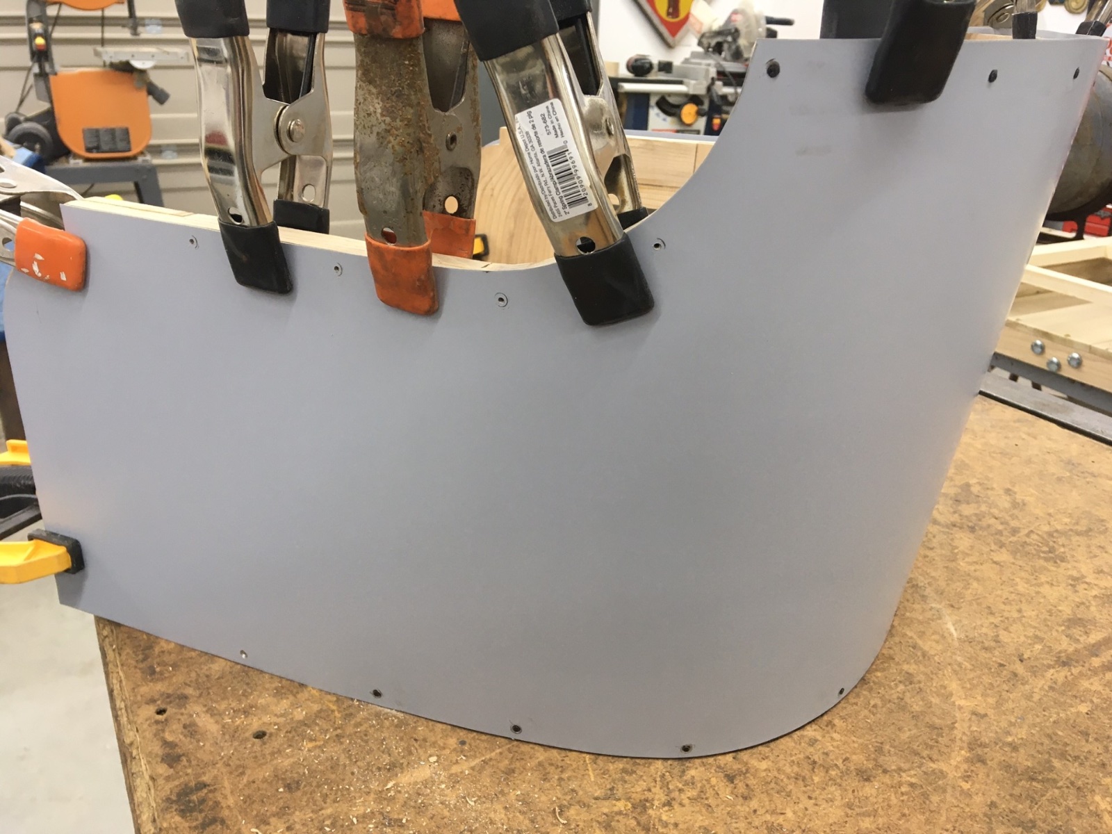

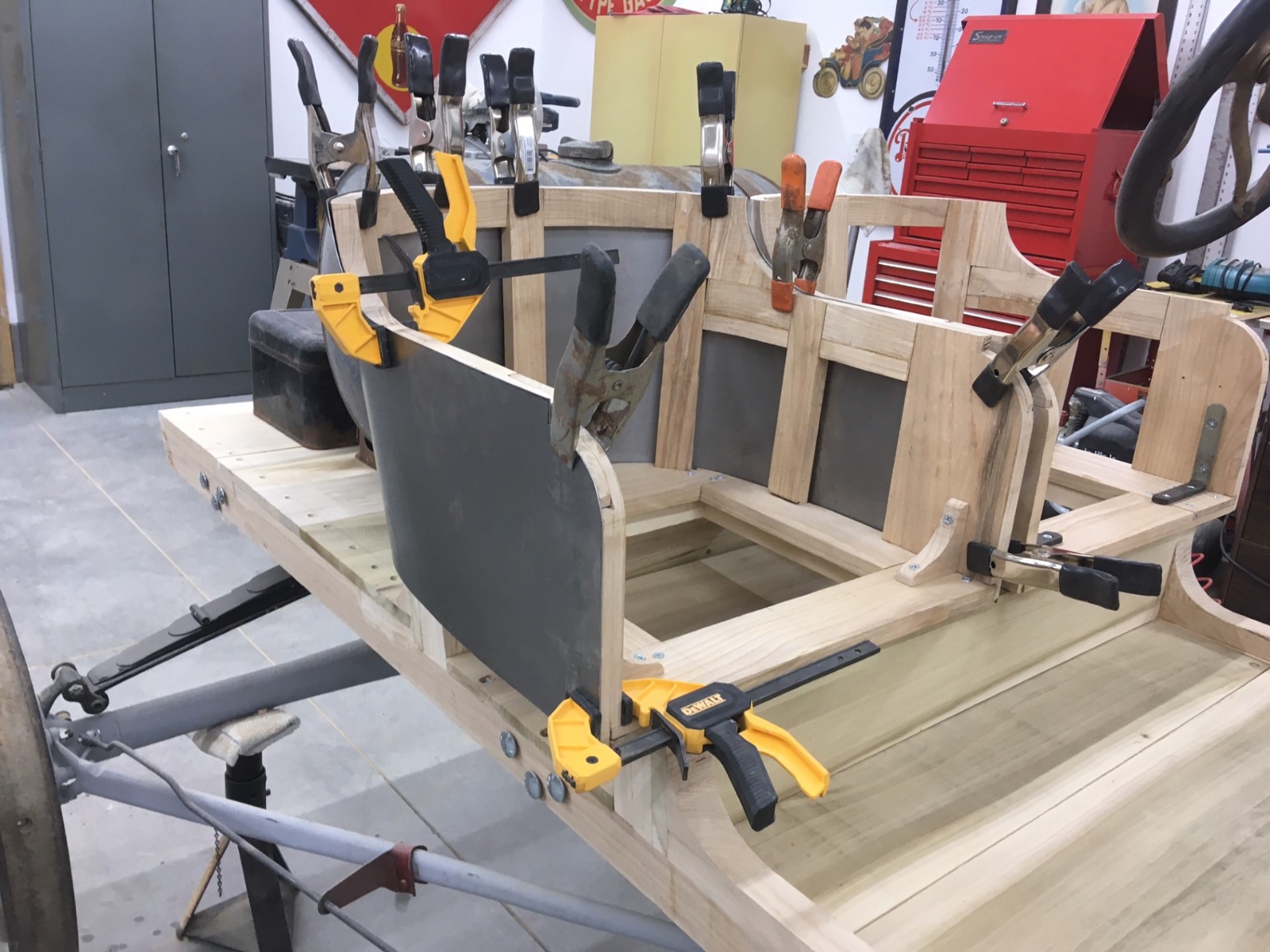

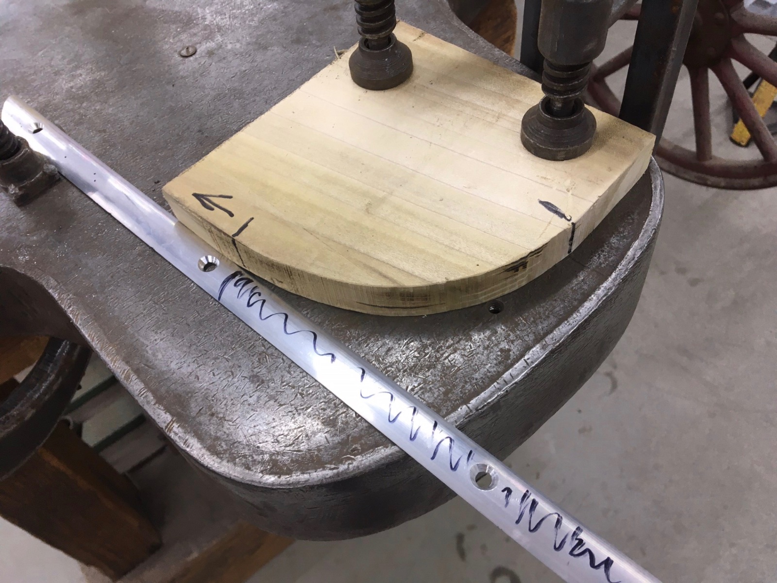

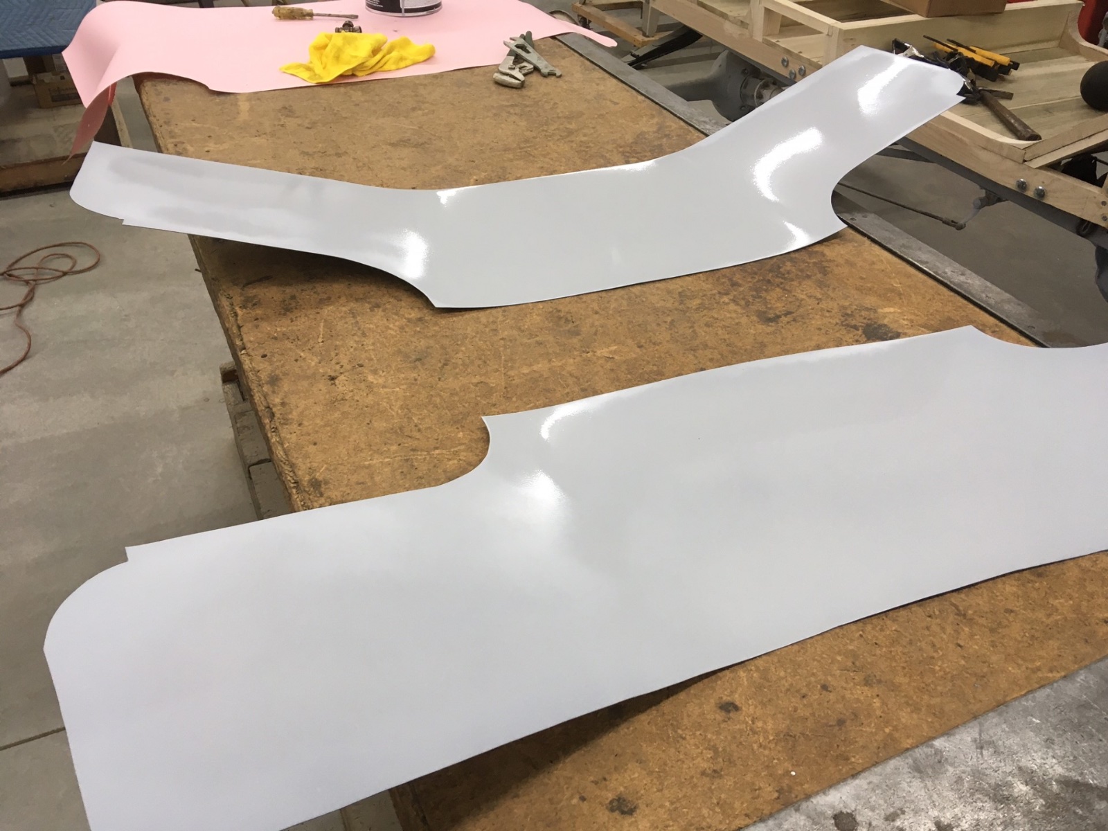

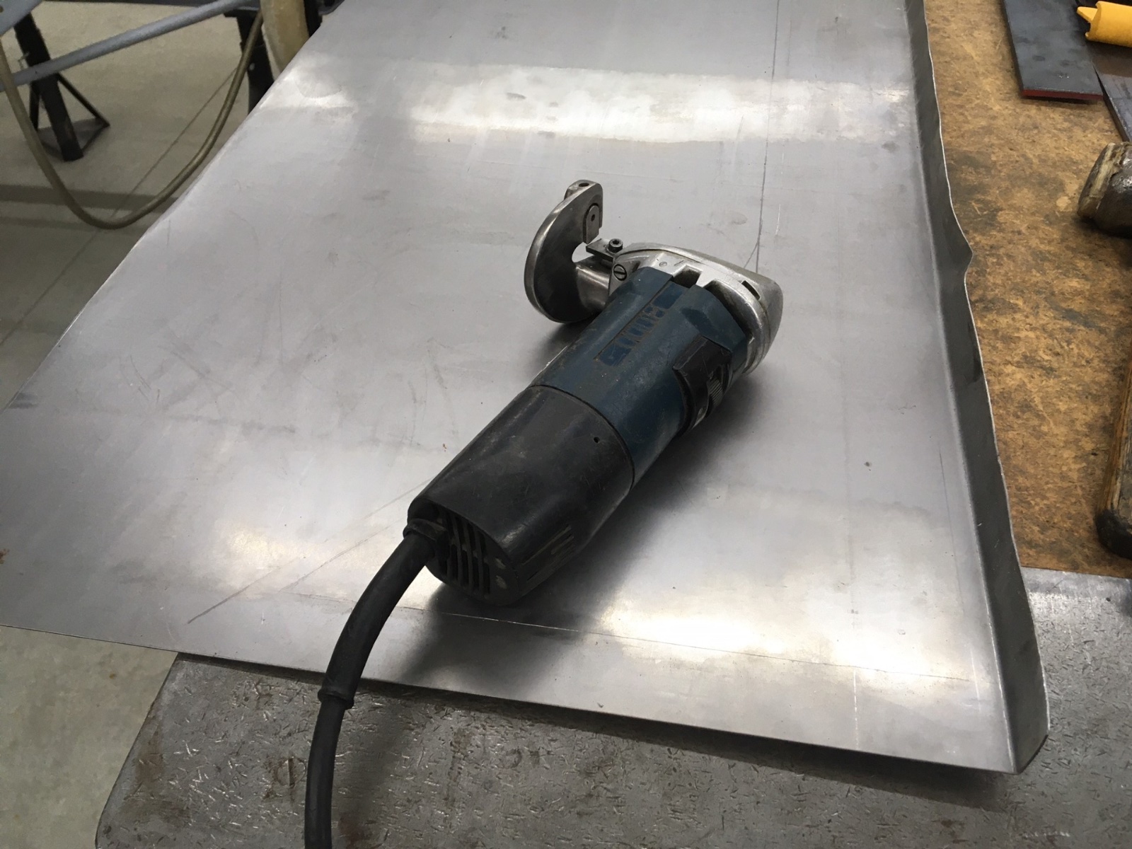

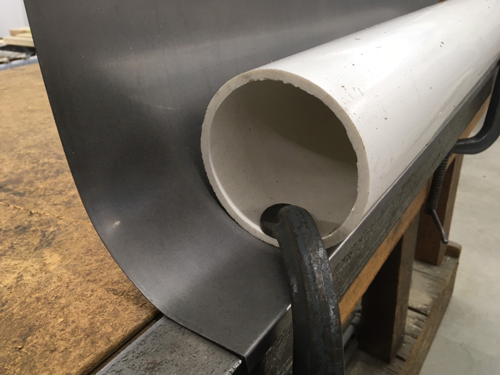

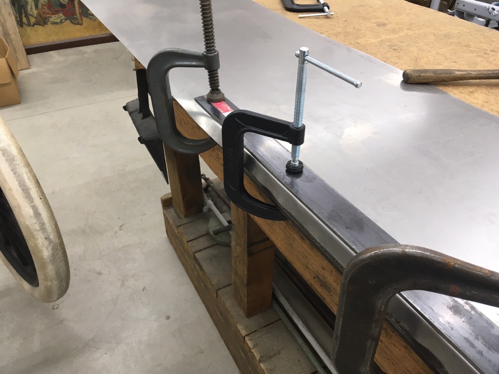

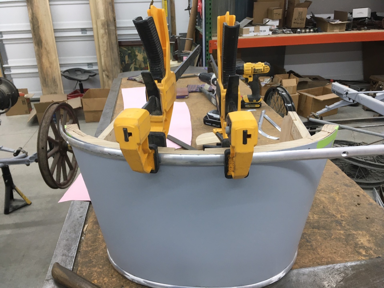

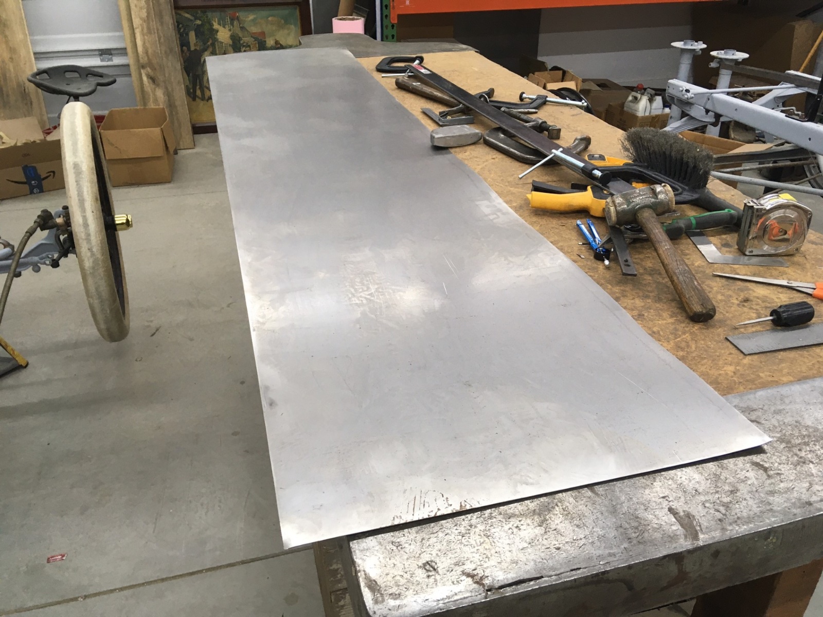

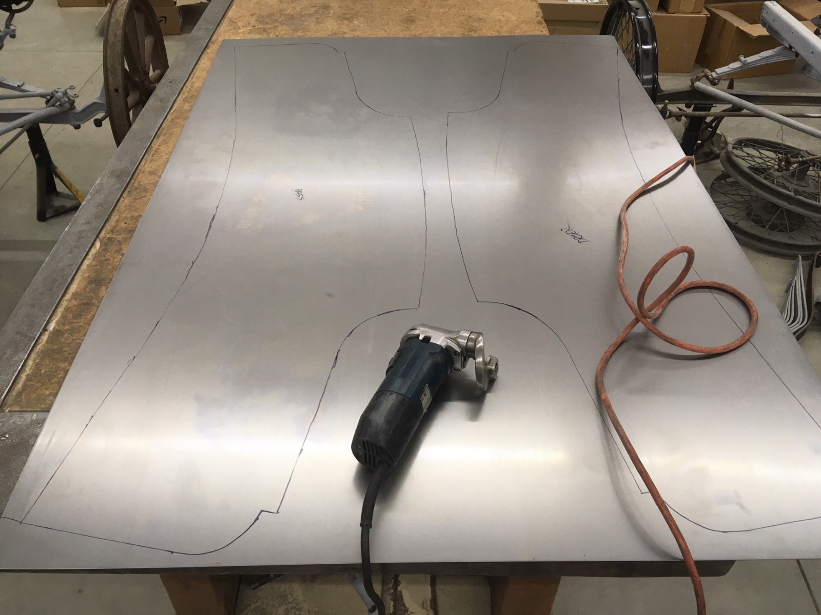

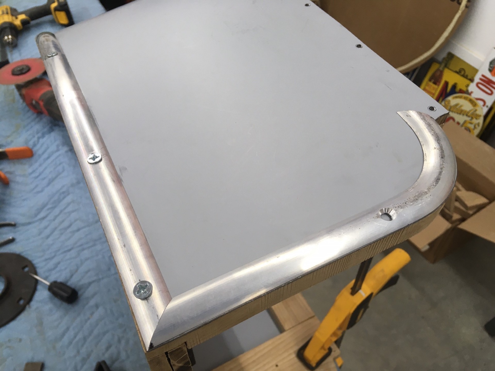

Post by Dollisdad » Wed Feb 21, 2024 6:55 pm

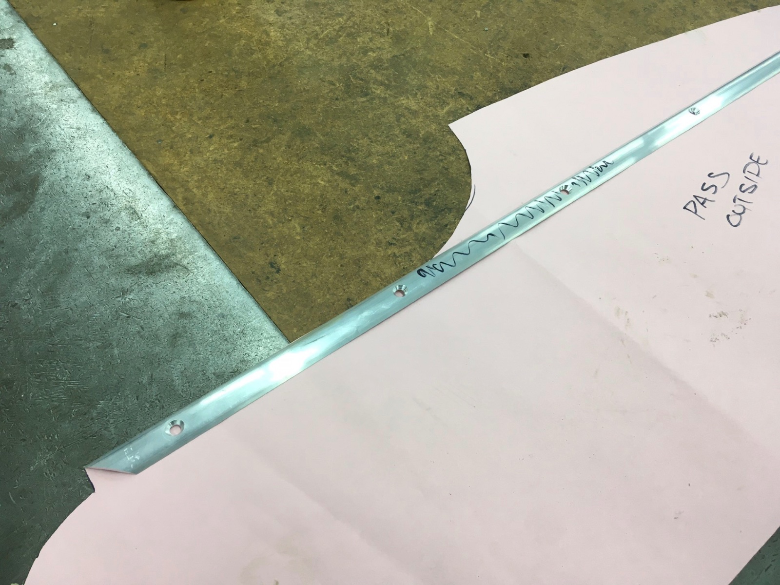

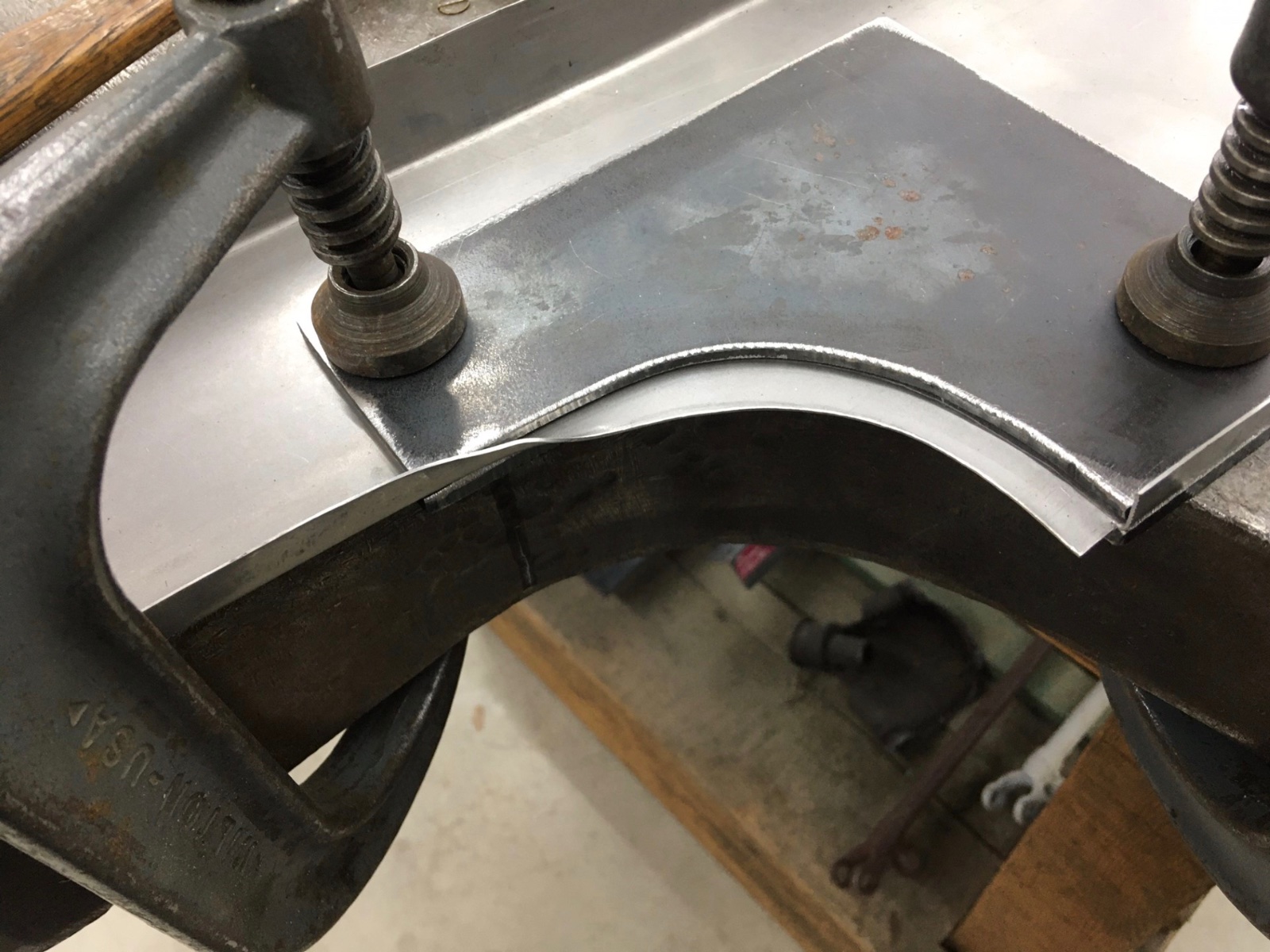

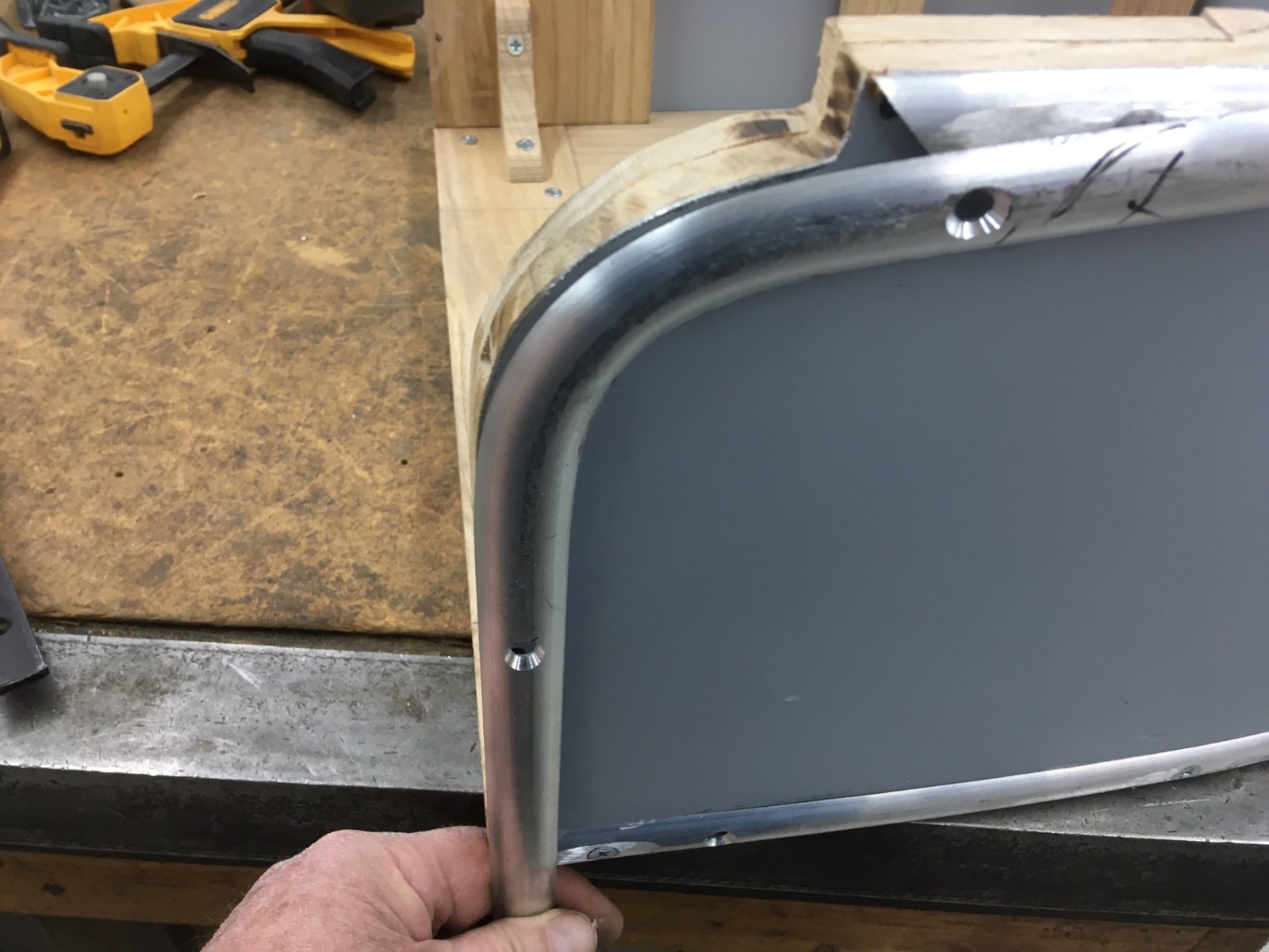

Seat frames done

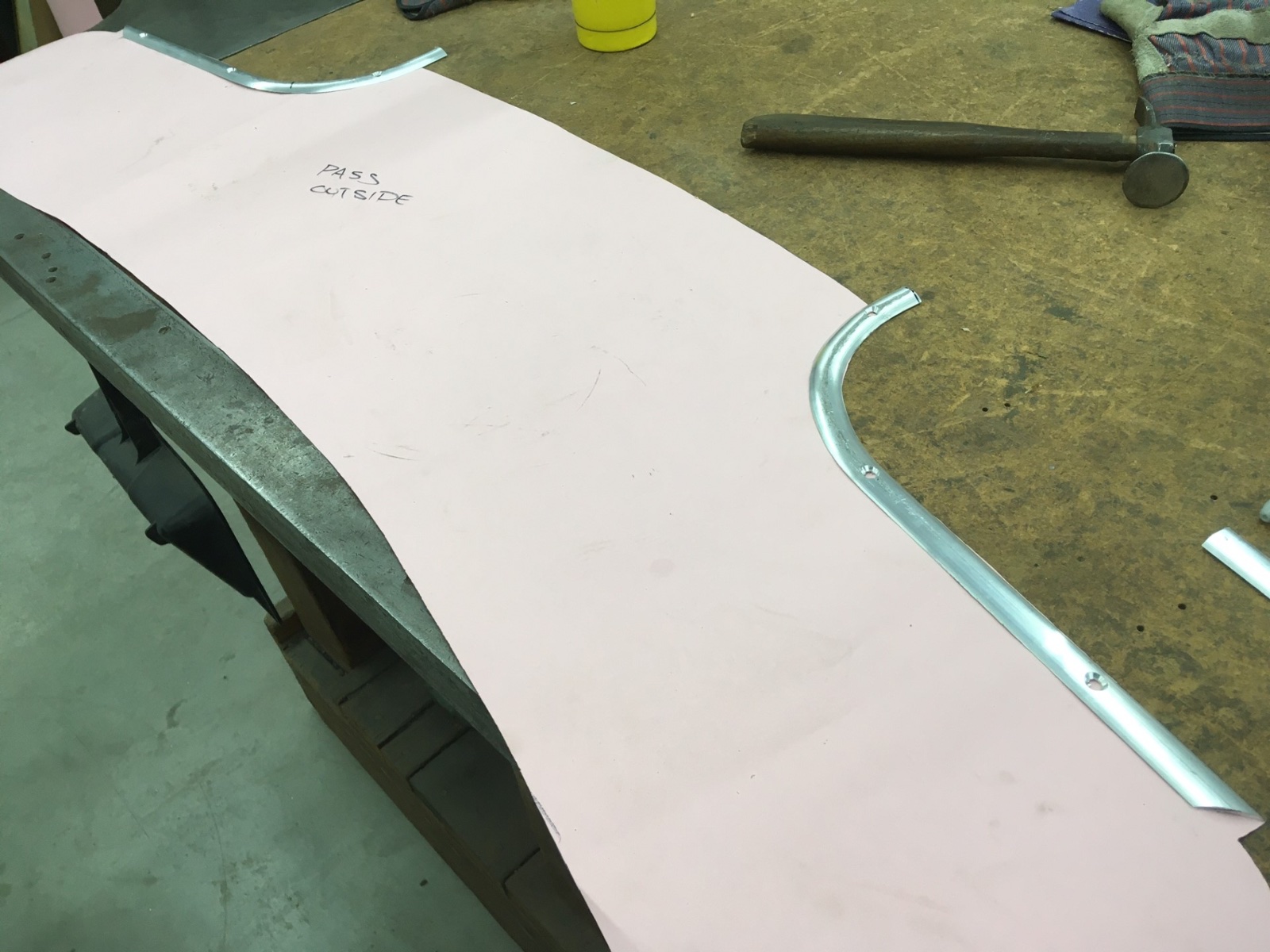

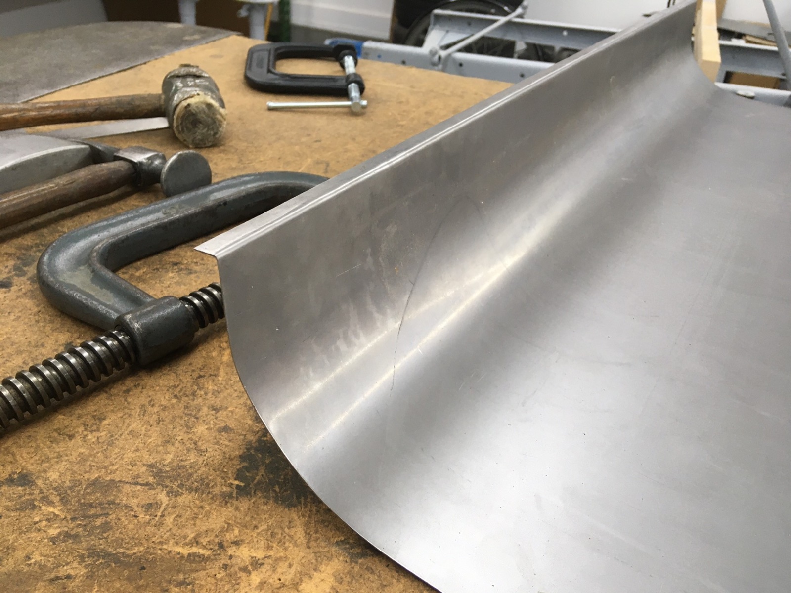

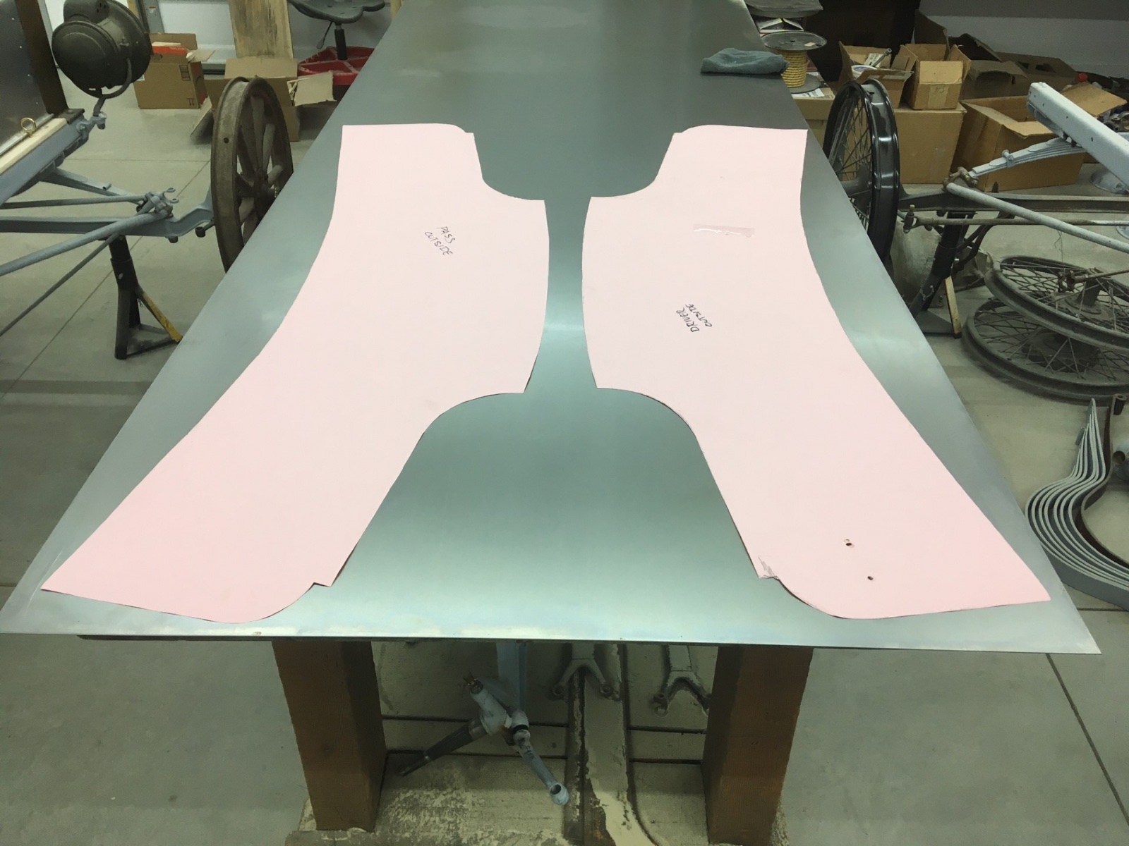

Pulled patterns and transferred to sheet

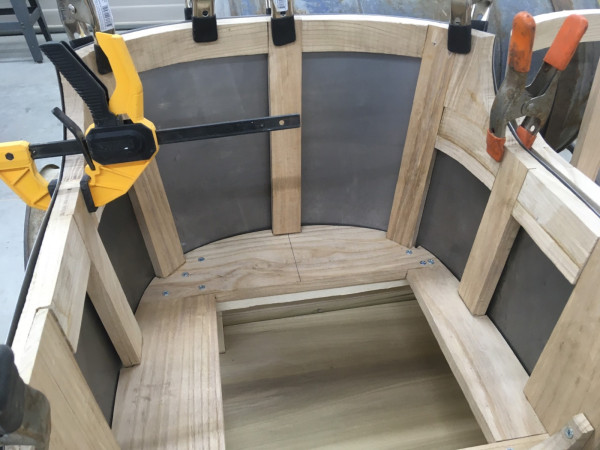

Cut out skins adding 1/16” to allow for misalignment on my part,

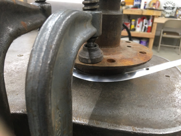

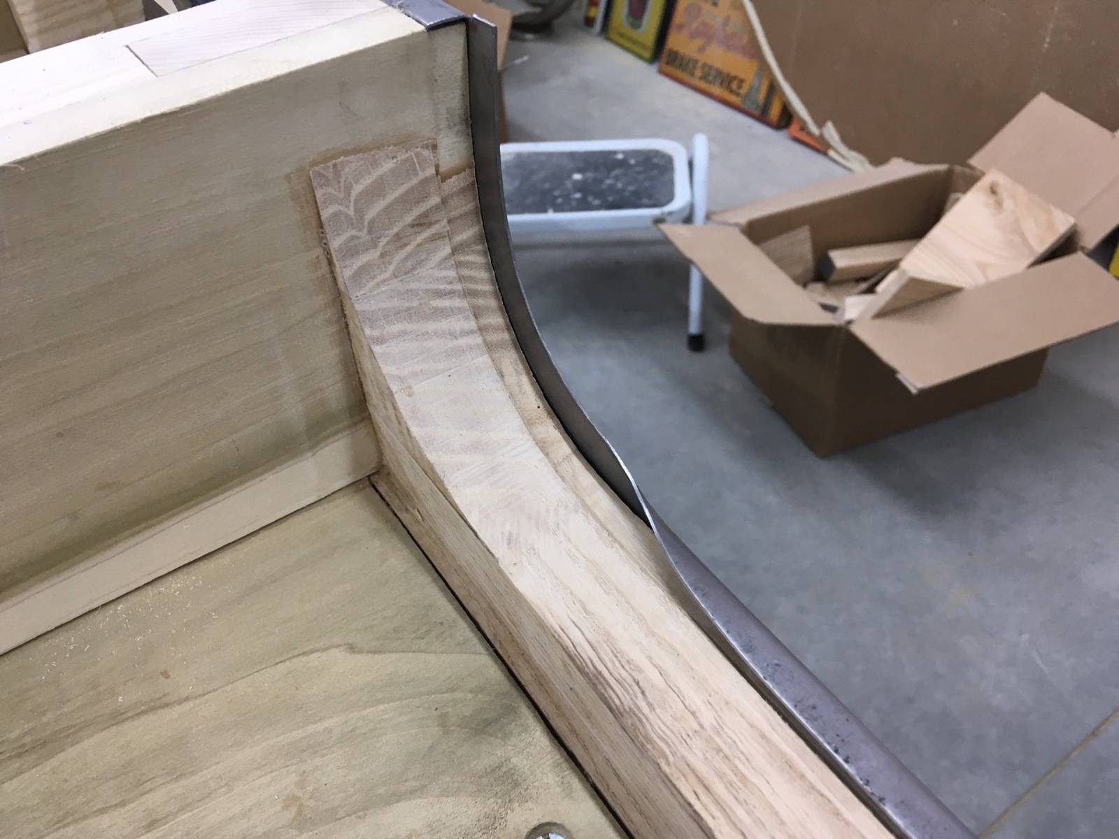

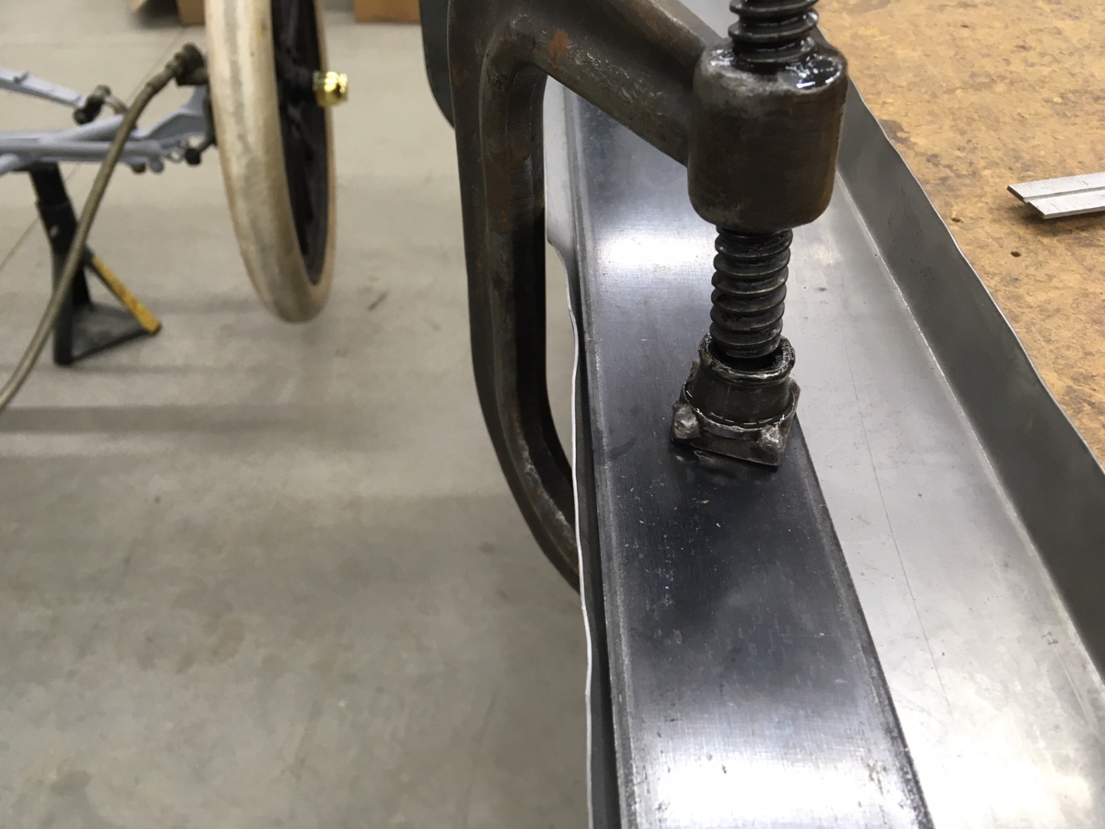

Posts: 3850
Re: You tell me

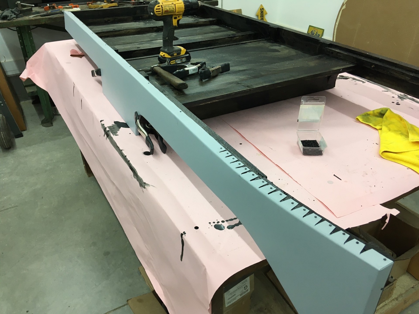

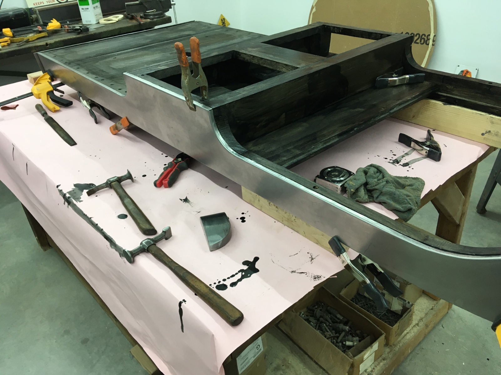

Post by Dollisdad » Wed Feb 21, 2024 7:01 pm
Clamped skin to the frame on one end and pulled it around and clamped as it made contact. Pretty happy with the trial fit. Material is 20 ga. cr.
Posts: 4408
Re: You tell me
Post by Wayne Sheldon » Wed Feb 21, 2024 8:40 pm
Very nice workmanship! Going to look wonderful.
Joe Bell
Posts: 1205
First Name: Joe
Last Name: Bell
Location: Tiffin Ohio
Re: You tell me
Post by Joe Bell » Wed Feb 21, 2024 9:50 pm

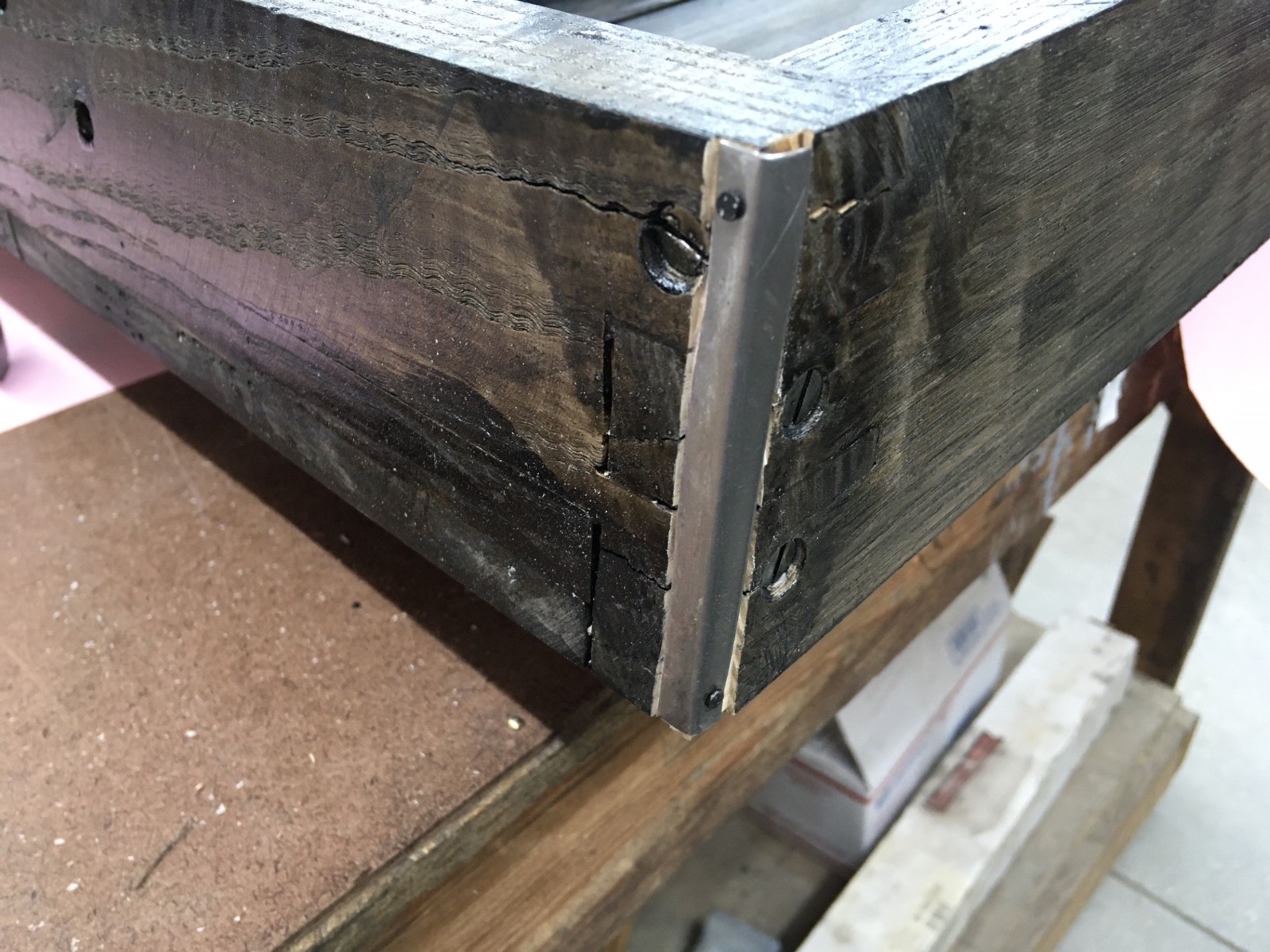

Looks better than the last time i saw it! Nice work on the sheetmetal, who did it? just joking!

Post by Art M » Wed Feb 21, 2024 10:18 pm
I really like your choice of the body design. I always wonder how seats like those are fabricated ever since I saw Tim Wrenns former 1912 pickup truck.
Very nice design snd work. I'm anxious to see it went complete and on a tour.

Beautiful woodwork. Poplar?
Posts: 3850
Re: You tell me
Post by Dollisdad » Thu Feb 22, 2024 11:50 am
Jim, all the floorboards are poplar. The deck and seat skeletons are ash. Here in Ohio, on Facebook marketplace there are quite a few people who process and sell rough cut lumber off their own land or others. So I’ve been buying 6/4, 5/4, and 4/4 rough material, so I can plane it to my needs. Ash is getting harder to find due to the Emerald ash borer which has destroyed millions of ash trees. You can buy green if you have the time to air dry and save money. Otherwise kiln or aged works best.

So here’s what I use to treat the sheetmetal, to seal the sheetmetal, to nail the skin to the frame and screw the moldings on.
Here’s the skins drying.
Posts: 3850
Re: You tell me
Post by Dollisdad » Thu Feb 29, 2024 8:42 pm
I drill two holes at the center bottom and countersink them to better sink the nail heads. Then center the skin best I can and proceed to nail the skin on.
The left side came out pretty good.
The right side not so good. My misalignment.
So I had to grind the sheetmetal down to the wood. That’s why I oversize the skin.
Posts: 3850
Re: You tell me
Post by Dollisdad » Thu Feb 29, 2024 9:05 pm
Then I put the moulding around the bottom after I anneal the rear portion of the moulding.
And around the top.
Then form the front corners around a front wheel hub.
Takes around 4-5 times annealing to get it to form. It will buckle and you have to tap it flat between annealings, but it comes out flat in the end.
Posts: 3850
Re: You tell me
Post by Dollisdad » Thu Feb 29, 2024 9:18 pm
And fits pretty good.
Then bent the up swings. I use the paper pattern I pulled for the skin as a template. I made a wood buck to bend them around as I could not find anything the right shape. You see where I have scribbled on the moulding with a sharpe. That is the area I want to anneal. So using a hand held torch I evenly heat that area until the markings disappear. Then it is ready to bend. Like I said it will take 4-5 times to complete the curve.
Posts: 3850
Re: You tell me
Post by Dollisdad » Thu Feb 29, 2024 9:36 pm
This is what I use to anneal.
Ready to cut the angle.
Almost done.
What was leftover from 24ft. of moulding.

Beautiful workmanship! And nice tutorial.

Post by Dollisdad » Thu Mar 21, 2024 8:55 pm
So back to work. Got the wheels painted(with a brush.
Then got the tires mounted.
So time to skin the body. I start by routing the edges where I want the sheet metal level with the wood.
Posts: 3850
Re: You tell me
Post by Dollisdad » Thu Mar 21, 2024 9:06 pm
Cut the blank for the side.
Since I don’t have a 8’ brake at home, I sandwich a 1” flange between two 3/16” strips and knock down with a rawhide hammer, checking to see it is approx. 7 degrees short of 90.
Then clamp it to the woodwork.
Next I scribe the edge of the woodwork.
Posts: 3850
Re: You tell me
Post by Dollisdad » Thu Mar 21, 2024 9:19 pm
Then I add 3/8” to the scribe lines.
I use an electric hand shear to cut out the part.
Using the strips I knock the straight stretches up with the rawhide and then straighten the edge with a steel face hammer and dollie.

Post by Dollisdad » Thu Mar 21, 2024 9:28 pm
I pie cut the bottom so it will sweep inward at the front and bend the end cap.
Next I test fit the panels on the skeleton.

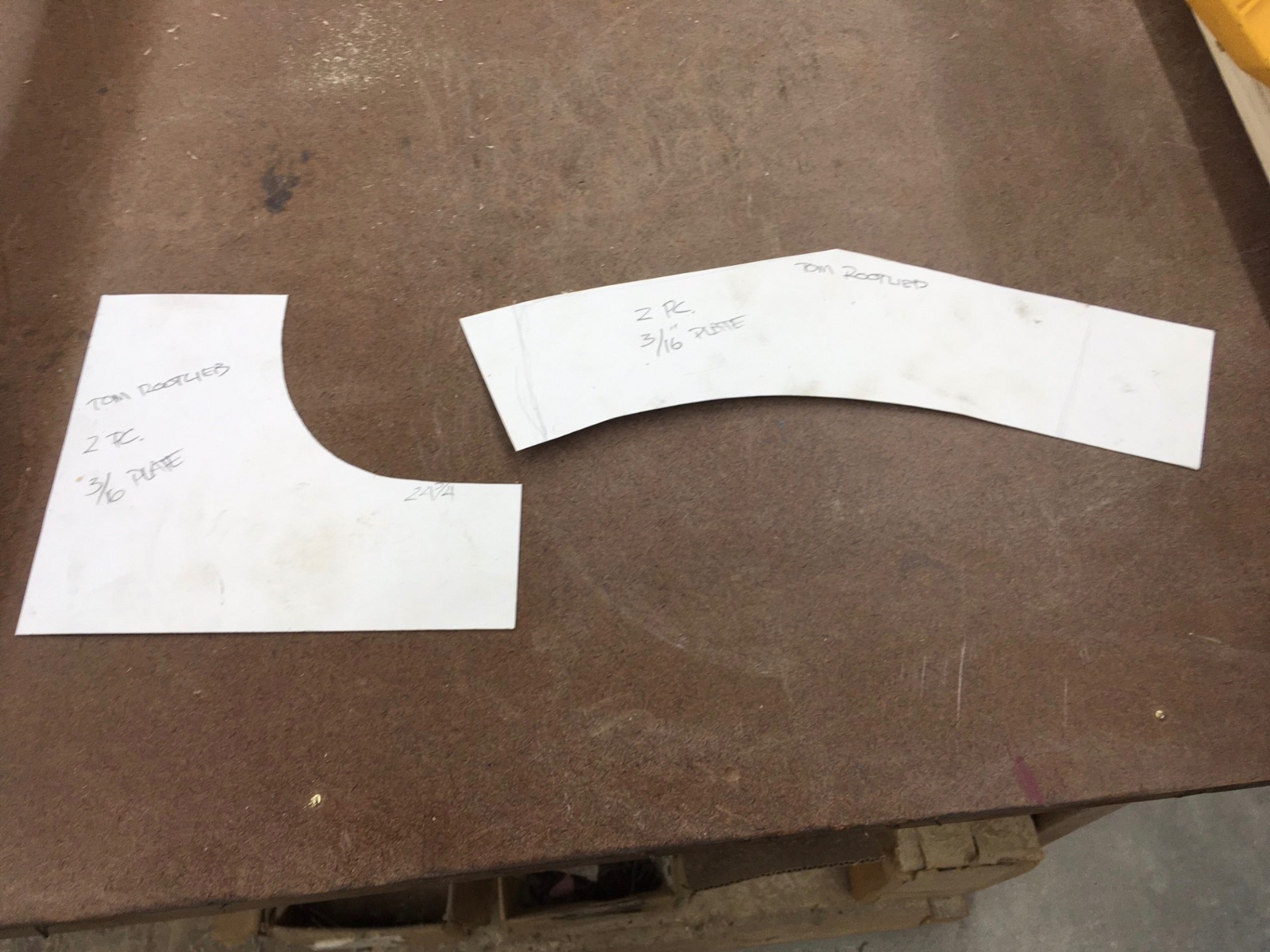

Today I took these patterns down to my steel shop and they are going to plasma cut me some 3/16 plates so I can knock up the seat riser curves and the floorboard riser sweeps. I will also pickup a piece of pipe to shape the radius for the rear deck to seat riser. Little by little.

Post by Dollisdad » Sat Mar 30, 2024 7:00 pm
Got the tail panel made.
Next knocked down a 3/8” flange and clamped a 4” pvc behind it and pulled the sheetmetal around it to give it the upsweep.
And check rough fit.
Posts: 3850
Re: You tell me
Post by Dollisdad » Sat Mar 30, 2024 7:05 pm
Took the sheetmetal off and sealing the woodwork with black lacquer.
Now waiting for plates from the steel guys.

Ok, well I got the corner plates finally. Clamp them in place and knock the material up.
Then fit the finished panels.
Posts: 3850
Re: You tell me
Post by Dollisdad » Tue Apr 09, 2024 7:22 pm
Then acid treat and prime the panels.
I routed the rear corners and inserted small corner shields to back up when I weld the corners shut.
Then start to nail panels on starting with the bottom.
Posts: 3850
Re: You tell me
Post by Dollisdad » Tue Apr 09, 2024 7:34 pm
Then do the topside.
When I put the rear deck top piece on I shoot some liquid nails under it to kill any noise that may arise from rpm vibration
ThenI bolt the tank down to press the skin to the framework. I will leave this now fora few days to make sure the bond has cured.
Posts: 4408
Re: You tell me
Post by Wayne Sheldon » Tue Apr 09, 2024 9:29 pm
Is that the gasoline tank you are going to use there? Just curious, it would look great!
Wonderful, beautiful, work you do!
Thank you for sharing it here.

Post by Dollisdad » Fri Apr 12, 2024 11:16 pm
Thanks for the comments. Installed the inbody mounting brackets and slid the deck back on the chassis. I must have mixed the brackets up, as some didn’t want to line up easily so I had to rework them All the 3 hole bracket bolts had to have the heads bent to flush fit the side of the body.
Welded up the rear corners, cut the tank opening and now it’s ready to make the trim pieces.

Post by Dollisdad » Tue Apr 16, 2024 11:08 am
On to trim. Cut out all the blanks.
Glue up the blocks for end sweeps.
Cut and fit up.
Posts: 3850
Re: You tell me
Post by Dollisdad » Tue Apr 16, 2024 11:13 am
Fitting sweeps.
Fitting pieces together.
Trimmed and fit.
Hope to finish today.

Post by Dollisdad » Wed Apr 17, 2024 9:23 pm
Well, I think that the fabrication is pretty much done (seat bottom doors still to come). Still some work on the front and rear suspension to adjust the ride height and steering connections. I’m going to try my hand at upholstery and I’ll take pics, good or bad and share them later. But for now here is a look at the final vision that you guys helped steer me to. Thanks for the words of encouragement and I hope you learned something that can help you on your project.
Posts: 3850
Re: You tell me
Post by Dollisdad » Wed Apr 17, 2024 9:24 pm
Posts: 3850
Re: You tell me
Post by Dollisdad » Wed Apr 17, 2024 9:25 pm
