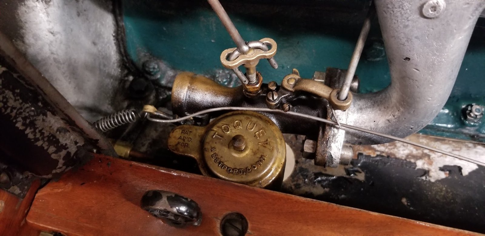

Now, my 1914 Model T touring have an aftermarket carburetor - a Toquet - which I am very happy for and where the idle is really smooth and slow.
