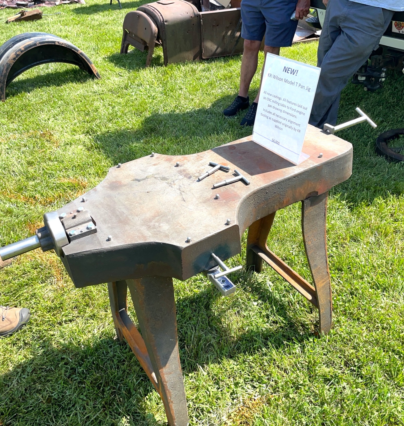

You guys do know that brand new pan jigs are being made. They were for sale at Luray. Look just like the original ones. Dan

Dan, I did NOT know that new pan jigs were being made and sold. Can you provide me with any more details? I would be interested after all I went through to find someone who had a jig. And, I have two Model T's.....and some friends with Model T's.

Find latest issue of International magazine, there is an ad in it.
$6000.00 + shipping me thinks. They look great, just like my original. Dan
Here is the new pan jig at Luray Swap meet. All new casting of heavy iron base, and top, made to spec. Includes all the fixtures.
Contact Greg Stewart. (Five1Eight) 424-SevenZeroEightSix (NY)

YIKES!! Those jigs are not for every garage, to be sure!

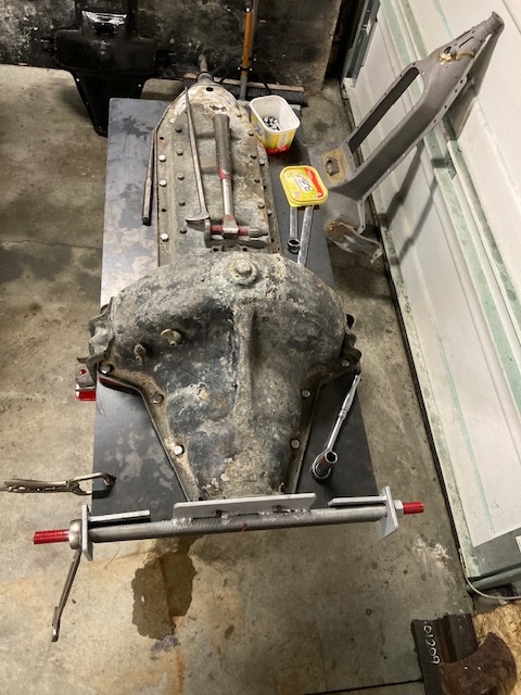

I built my own pan jig for less than $500, works fantastic, I drilled every hole, so I can bolt easily in place, tap all around with a hammer and leave sit in place overnight.

Post by speedytinc » Sat Sep 09, 2023 1:05 pm
Very nice.
How thick is the plate?
Approximate weight?

Post by havnfun » Sat Sep 09, 2023 1:09 pm
The plate is two 1/2 inch thick plates bolted together, Heavy very heavy, I use a mini skidster to move it, or disassemble and move. Each plate is heavy around 100lbs my guess and base is another couple hundred lbs.
Here are couple pictures of straightening

Re: pan straightening/support question
Post by havnfun » Sat Sep 09, 2023 1:14 pm
Here is a 1913 pan being straightened

Post by BobUkPipedream » Sun Sep 17, 2023 5:41 pm
I hesitate to post again… I don’t think the way I did things below is shady or dodgy…
So I did not have access to a pan jig. There may be a jig in the UK, but I could not find one. So I started by hammering the pan holes back to straight with a dolly as people over tighten the pan bolts and that makes it hard to sight things up. Then I sighted up the pan by eye and could see it was twisted and also a banana shape. So I bent it, hammered edges and such until it looked good by eye, then I offered it up to the block which was by then nose down on my homemade engine assembly stand. I had already got the runout on the output shaft down to 3 thou or so (Mike Bender’s excellent videos on youtube say 6 thou is acceptable). I dry assembled everything with gaskets in place and then tried the fourth main and much to my shock it slipped in place and lined up exactly and I mean exactly. It may have been luck (I was due some), but sighting it up by eye did seem to be quite easy and repeatable. I then discovered on final assembly with sealant that the fourth main was still absolutely spot on, however it needed shims under the flange on the pan side to make it square to the shaft. Some people may have not noticed it, but I felt the engine tighten up. I used I think 10 thou shims under the flange and it went very smooth. I used Sikaflex 221 polyurethane sealant adhesive on the pan to fourth main and silicone on the hogshead to fourth main half so that it will be easy to remove the hogshead in the future. Sikaflex can be a little too good at sticking stuff together, but that kept the fourth main firmly in place when I put the engine in.
The way I see it (which may be wrong and people may shoot me down in flames) is that pan alignment all comes down to how that fourth main fits when the engine is nose down. If it fits, then I believe that is all that matters, but I do wonder if other people worry about the fourth main flange as it pulls down on to the flange of the pan and hogshead. I suppose the Babbitt would wear but that would mean excess clearance in the Babbitt. Perhaps I worry over nothing, but I feel a lot better knowing that the shaft is running true and cantered in that fourth main.
