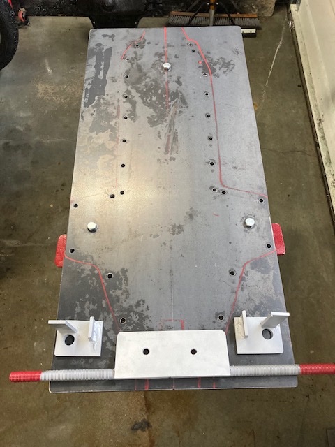

I built my own pan jig for less than $500, works fantastic, I drilled every hole, so I can bolt easily in place, tap all around with a hammer and leave sit in place overnight.

- Posts: 4965
Re: pan straightening/support question
Very nice.
How thick is the plate?
Approximate weight?
Approximate weight?

The plate is two 1/2 inch thick plates bolted together, Heavy very heavy, I use a mini skidster to move it, or disassemble and move. Each plate is heavy around 100lbs my guess and base is another couple hundred lbs.
Here are couple pictures of straightening
Here is a 1913 pan being straightened

That looks really substantial!  There are a couple of clubs close to me here that I’m looking to research to find a fit. Perhaps one will have a device of this kind.
