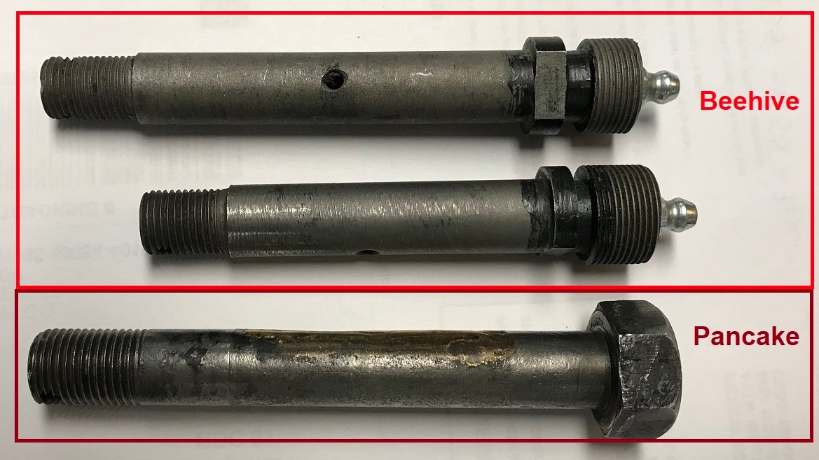

I have repro's on my Beehive set plus I kept the worn originals. I just have the worn originals for the pancake style looking for new ones for them. I can add some photos later (stored away). The interesting part of the bolts is that they have a larger head size than today's' bolt size would have.
Found this in 2017 Lang's Catalog that I down loaded

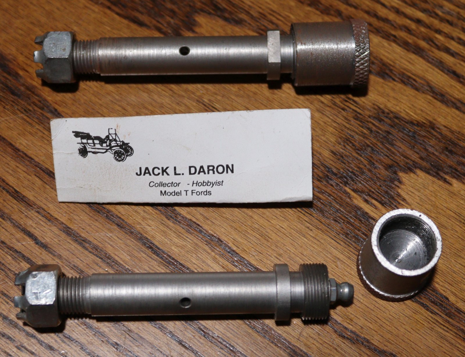

I have a brand new set of Jack Daron's Hassler front bolts that I purchased from Jack years ago that I no longer have need for. I would let them go for $110 plus small flat rate shipping in the U.S.These have been spoken for, Thanks David!
Email me at the following address if interested.
Last edited by Jay In Northern Ca. on Wed Sep 20, 2023 9:31 pm, edited 2 times in total.

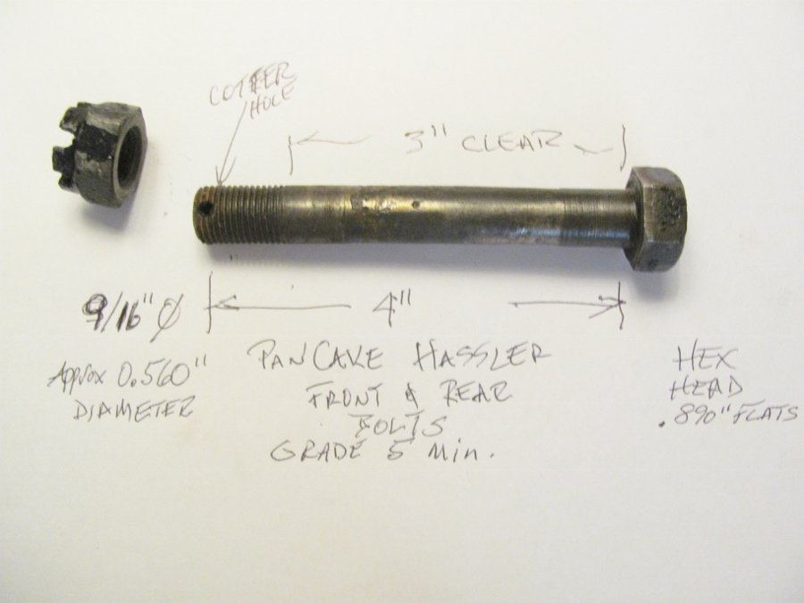

Also consider making bolts for the Pancake style. The head size is needed to fit into the hex recess in the Hassler arm. I can use 4 bolts for the Pancake style

The pan cake style bolt looks to be the same as what is on my Dodge Brothers set. The one tag that is still present on them, is the round style which I think is contemporary with the pan cake set. Mine still use the beehive springs so guess that using that style bolt made manufacturing easier.

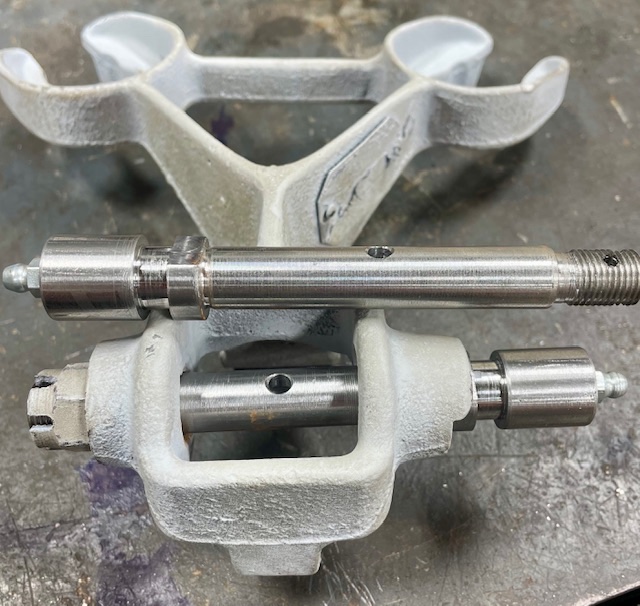

Post by Afrazer » Fri Nov 10, 2023 8:05 am
Okay update time. After thinking and talking we came up with a material with out heat treat that has a hardness of about 35 through out deep. The original bolts are only case hardened to about 60 at the hardest reading I could get. Don’t know how it will work longevity wise but I’ll run a brass bushing in the spring perch and see how it goes when the car I’m building gets on the road.

Post by Mark Gregush » Fri Nov 10, 2023 1:10 pm
Are you going to add a groove where the grease comes out along the shank. Looking good!

Post by Afrazer » Fri Nov 10, 2023 3:32 pm
That’s a good idea Mark certainly can’t hurt anything
