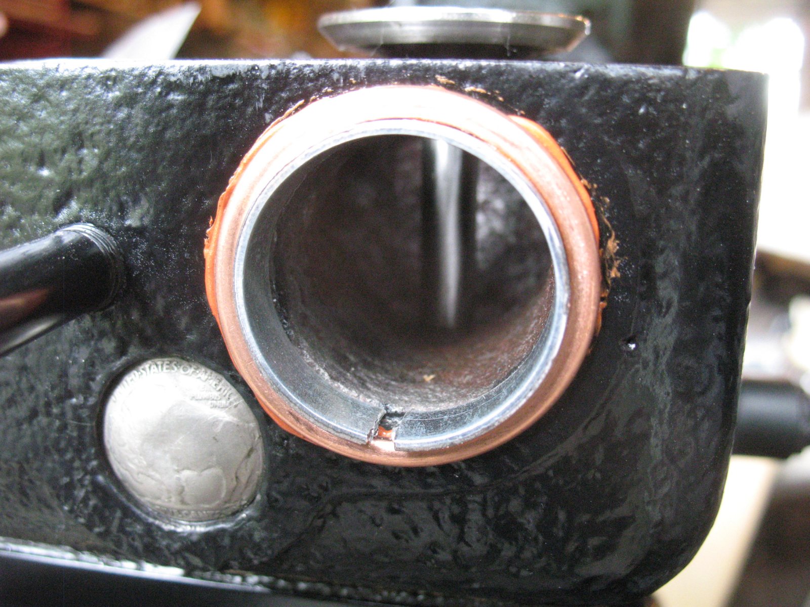

The stock gaskets and rings keep the exhaust manifold straight, as Larry says, and the last time I checked they were less than half the price of the copper one-piece gaskets.
If your block is pitted like this one you can add a little hi-temp RTV to help the gasket seal.

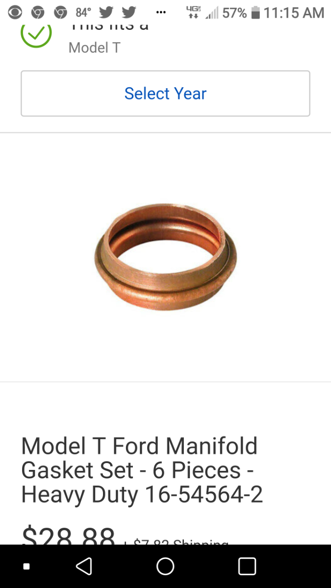

How about this?

How about this?
They're fine, but look at the price. More than three times the cost of the stock parts.

Preston...despite the high cost, in my not-so-humble opinion I believe what you pictured above are the best, hands down. I have 'em on all my T's, past and present! No problems with these kind!

Tim and Preston, those one piece copper gaskets must be good. They are made in Australia! They are far cheaper here. If you check on line at Fuel Tank and Radiator Services, you may find it cheaper to buy them directly, even with the added postage. You could probably get three or four sets for the same postage cost. I love them!
Hope this helps.
