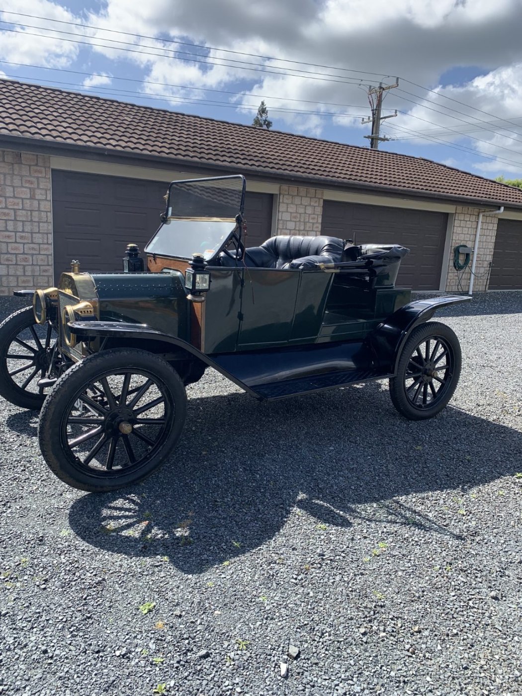

Yes Wayne thats a mother in law seat.
Havent seen it in person yet, waiting on a transporter that wont unload it on the way. Plenty are keen but they unload the vehicles at each main city to rearrange their loads. I'm not having that.
