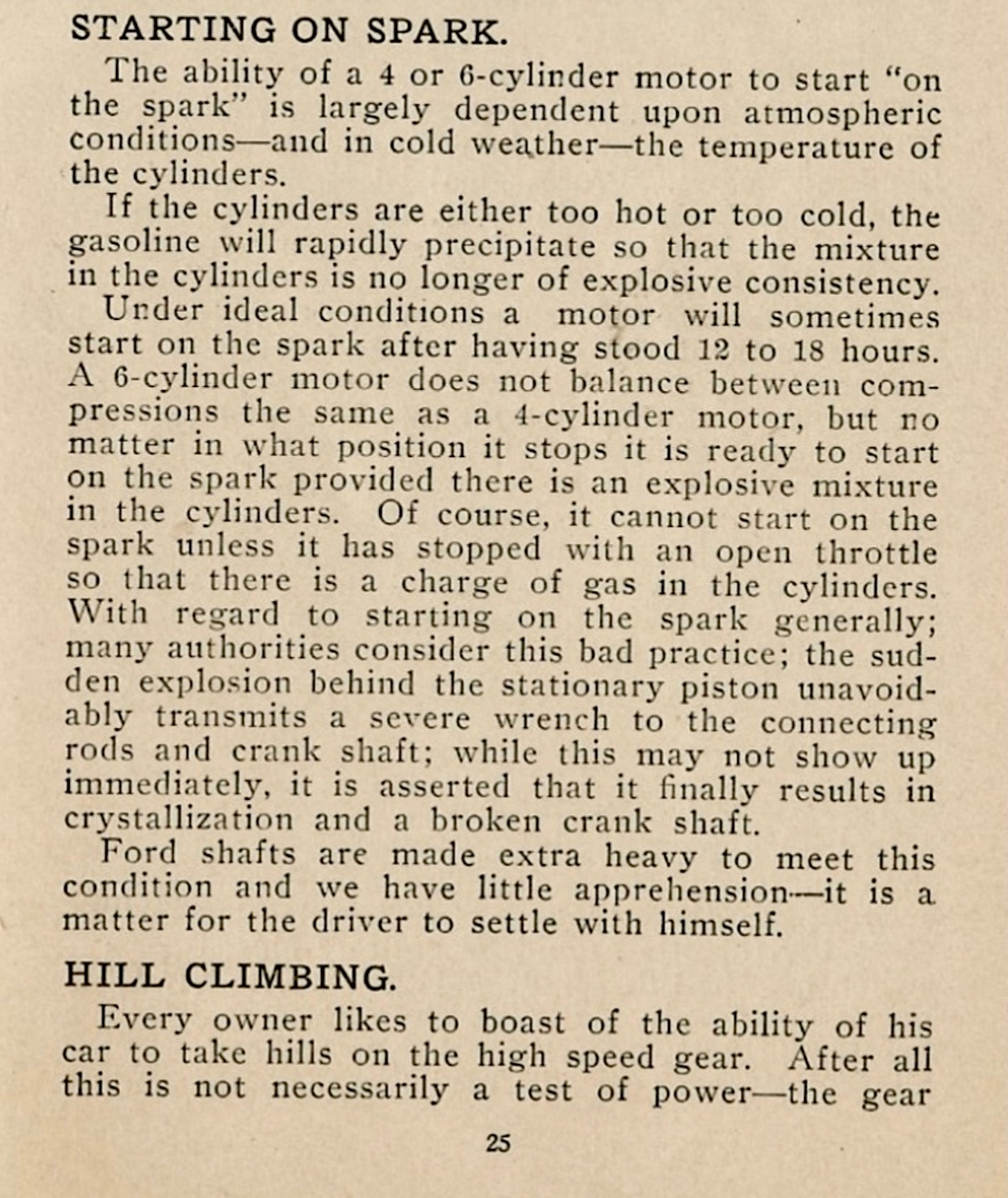

Post by Rob » Wed Oct 11, 2023 11:21 am
Maybe instead of “free start” it should be referred to as Ford Motor Co. did, “starting on the spark.” I’ve had motors that did, and others that didn’t, sometimes for no apparent reason. I agree, a tight engine may not work. On our Model B (1905), it started on the spark every time, but didn’t have much top end. We found the valve timing was off one notch. Now it runs up to speed, but no more easy free starts. However, with a few turns of the motor (priming) it “starts on the spark” almost every time.
1907 Ford “K” operators manual:

Post by John kuehn » Wed Oct 11, 2023 1:37 pm
Thanks Rob for the information about starting on the spark or as it’s come to be known today as a free start!
I’ve been around and own Model T’s at least 50 years. My 24 Coupe will occasionally start with a warm engine as my other 2 cars will when turning the key to battery and starting
I never heard the free start term until reading about it on this forum a few years ago.
I seem to remember reading about the engine starting just by turning the key on in a Model T book or manual several years ago. I wonder if it was ever mentioned in a Model T owners manual or official publication from Ford about Model T’s. Maybe somebody can point it out where it was used.
In some earlier forum posts over 15 years old the term free start wasn’t used but the compression start term was what the people used was fairy common.

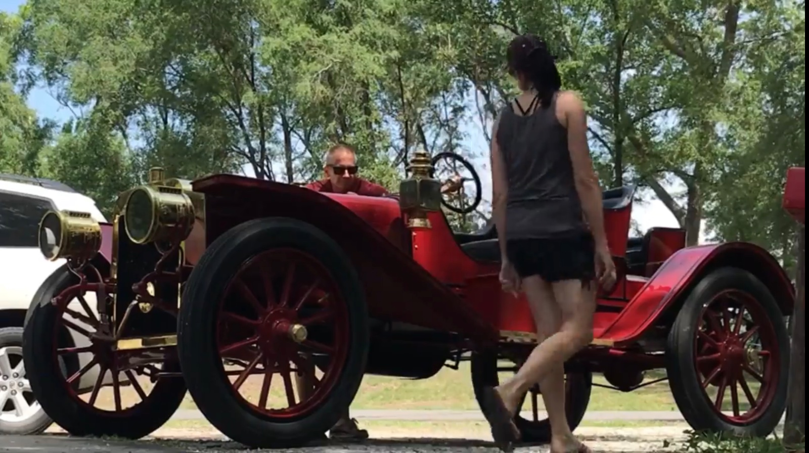

Post by Rob » Wed Oct 11, 2023 3:31 pm
Rich, sometimes I take it another step, and slowly retard the spark until the engine pops, immediately advancing the lever. If I catch it right, i get a good start on spark, and the advance helps it keep running. My former K touring was great at free starts, especially with a warm engine. The K roadster has a fresh rebuild and while it will “pop,” starts on spark are not as frequent. I think it’s just still too tight.
Here’s a time when we had 10 “starts on the spark.” Not sure if they qualify as “free starts.” I’m not doing anything except turning on the switch, but the engine was warm.
Not a T but it is a Ford……
https://www.dropbox.com/s/xd8odrb8ybb67 ... s.mov?dl=0
