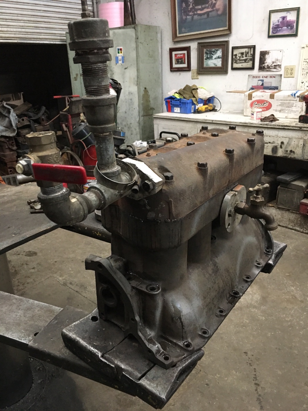

Re: water in oil? how to pressure block?
Here is my pressure test setup. Whole thing is filled with water and 25 psi is delivered to the pressure dome on top. Then watch for leaks.

I think that is just the absolute neatest thing! I love seeing stuff like this.Erik Barrett wrote: ↑Wed Oct 11, 2023 11:00 pmHere is my pressure test setup. Whole thing is filled with water and 25 psi is delivered to the pressure dome on top. Then watch for leaks.
