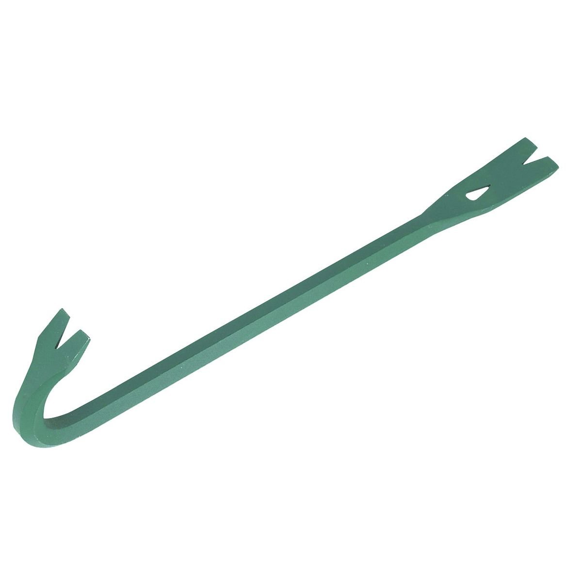

Re: How to avoid a broken transmission drum
Dont use a crow bar between the drums & HH.
Especially when its still bolted together.

- Posts: 5268
You remove ALL the bolts.
Pry up on the HH between the pan & cover.
If the HH is glued together, use a utility knife blade to cut between the crank case & HH. NEVER pry 0r use a puller on drum edges.
Treat them with respect & fragility.
No need to break the drums that have survived 100 years without already being un-serviceable from web cracks.
Carelessness will cost an unnecessary $1000 for new drums.

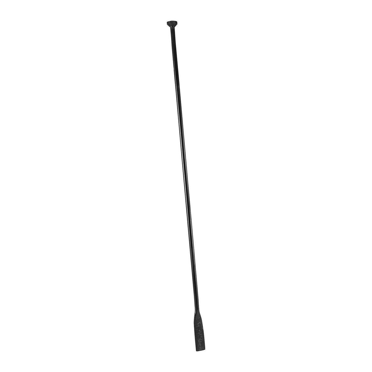

- Posts: 7297
What do you guys call a crow bar? Often police reports here refer to the bad guys coming equipped, with a crow bar. A crow bar is along, straight, heavy bar with a blunt chisel point on one end and a stout round head on the other. They are invaluable tools when digging post holes in hard ground, and for tamping down rocks around a post being installed. I have my dad's home made one, reputedly made from two TT driveshafts. I am sure the robbers going equipped are toting a pinch bar. This is about 30" long, with a bent claw end like a roofer's hammer and an angled chisel end on the other.
- Posts: 1685
- First Name: Dennis
- Last Name: Seth
- Location: Jefferson Ohio
Allen, a crowbar in the states is a tool used for prying in the construction trades.
Gen3AntiqueAuto
Topic author - Posts: 418
- Joined: Mon Aug 22, 2022 12:36 pm
- Last Name: Foye
- * REQUIRED* Type and Year of Model Ts owned: 27 Fordor, 15 speedster (2), 23 touring, 26 fordor, 25 TT
- Location: Middleborough MA
Still fairly confident no crow bars were harmed in the making of the video I posted at the top of this thread.
Gen III Antique Auto - we do Model T Ford Restorations
You can have everything in life you want, if you will just help other people get what they want -Zig Z.
https://www.youtube.com/channel/UCeROBg ... pB-KImprjw
- Posts: 7297
I suspected that Dennis. Now, what do you call the long bar I described?
- Posts: 4691
Post hole digging and tamping bar or something close to that. Depends on who sells them.
Here’s one from Harbour freight tools about 69” long. It’s a discount tool seller.
I have one my Grandfather made from a wagon axle and another from a T drive shaft. I’ve cleaned out lots of post holes on our farm with those two!
