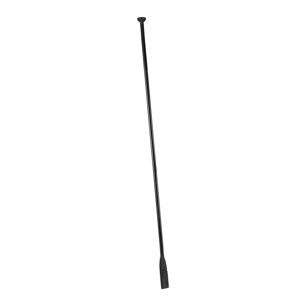

What do you guys call a crow bar? Often police reports here refer to the bad guys coming equipped, with a crow bar. A crow bar is along, straight, heavy bar with a blunt chisel point on one end and a stout round head on the other. They are invaluable tools when digging post holes in hard ground, and for tamping down rocks around a post being installed. I have my dad's home made one, reputedly made from two TT driveshafts. I am sure the robbers going equipped are toting a pinch bar. This is about 30" long, with a bent claw end like a roofer's hammer and an angled chisel end on the other.

Allen, a crowbar in the states is a tool used for prying in the construction trades.

I suspected that Dennis. Now, what do you call the long bar I described?

Post hole digging and tamping bar or something close to that. Depends on who sells them.
Here’s one from Harbour freight tools about 69” long. It’s a discount tool seller.
I have one my Grandfather made from a wagon axle and another from a T drive shaft. I’ve cleaned out lots of post holes on our farm with those two!
