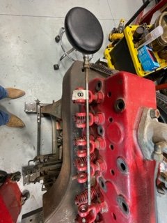

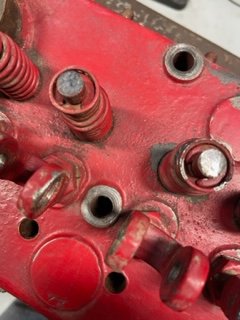

I picked up another project. I think it's project #6093 on my list. The head is the first mystery I'm trying to solve so I thought I would post some pictures and see if anyone knows. It has been suggested that it was for a marine engine which could be possible but I believe this head was sold with accessories or as a package for street use.
Port is really well divided
Cross flow head
Cross flow head
individual rocker arms stands

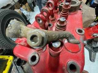

Rocker arm and some pictures of water heated manifold

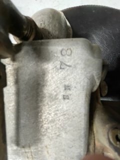

Intake serial # 78
Intake serial # 78
rocker arm part #33512

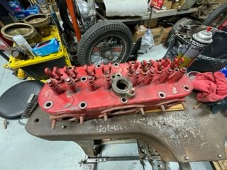

Exhaust system/ push rods/ Beehive valve springs
horseshoe clip holding valve spring retainer in place
push rod end
push rod end
push rod
push rod

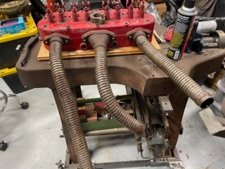

Cast iron piece flex tube fasten to, nice casting
Exhaust manifold cast head with flex pipe
