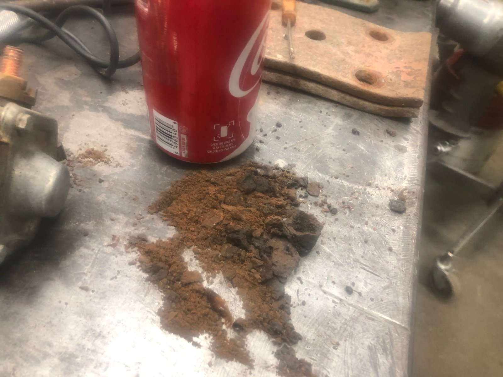

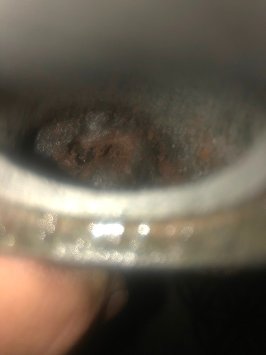

Post by Art Ebeling » Mon Dec 11, 2023 8:47 am
I had a similar no start problem with my 1911 that had sat apart for years. R.V. Anderson told me to check for a restriction in the intake manifold. I could not believe what came from way up in the manifold that could not be seen from either end. This manifold had even been to a machine shop to be machined with the exhaust manifold. I started poking a wire up thru it and it was completely blocked with insect debris. Art

Re: My 15 won't start
Post by Jerry VanOoteghem » Mon Dec 11, 2023 9:38 am
Have you tried giving it a shot of starting fluid? Not as a fix of course, but to see if you can get any fire at all.
And yes, check the inside of your intake manifold as Art suggests. I had manifold trouble myself many years ago, (a huge hunk of casting flash inside the NOS manifold).

Stuck a wire up in the intake and no critters fell out, I have been visited by the mud wasps before so I'm aware of that one, wasn't paying attention to a Chevy small block I fired up after a long rest and had to pull the heads after the mud nests went down the intake and into the combustion chamber. Think I'll pull the manifolds today, just for fun :D
Thinking it's going to take some dragging around the yard to get it going...
