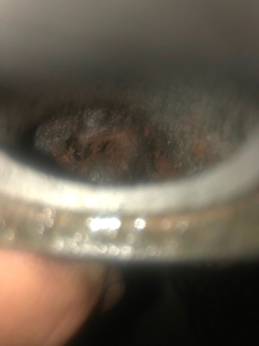

I had a similar no start problem with my 1911 that had sat apart for years. R.V. Anderson told me to check for a restriction in the intake manifold. I could not believe what came from way up in the manifold that could not be seen from either end. This manifold had even been to a machine shop to be machined with the exhaust manifold. I started poking a wire up thru it and it was completely blocked with insect debris. Art

And yes, check the inside of your intake manifold as Art suggests. I had manifold trouble myself many years ago, (a huge hunk of casting flash inside the NOS manifold).

Still trying. Measured the piston to deck height when the intake begins to open, 1/16" per the book. Tried some starting fluid in the intake and direct into the cylinders, barely a puff. cleaned the plugs although I know they work from watching the spark. At least it cranks over better now with all the pulls. :cry:
Tried that Jerry
Stuck a wire up in the intake and no critters fell out, I have been visited by the mud wasps before so I'm aware of that one, wasn't paying attention to a Chevy small block I fired up after a long rest and had to pull the heads after the mud nests went down the intake and into the combustion chamber. Think I'll pull the manifolds today, just for fun :D
Thinking it's going to take some dragging around the yard to get it going...
