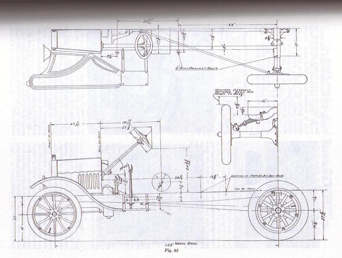

I’m looking to build a very simple express open top body. Anyone have any pictures or measurements they would be willing to share? Especially on how the body attaches to the frame. Thank you

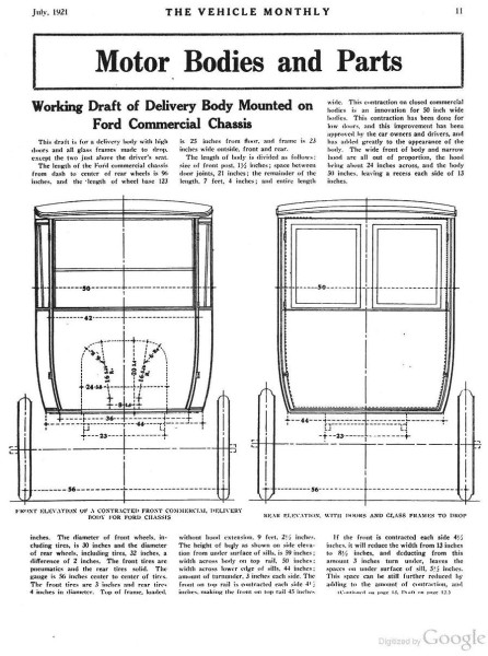

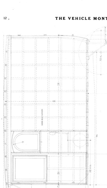

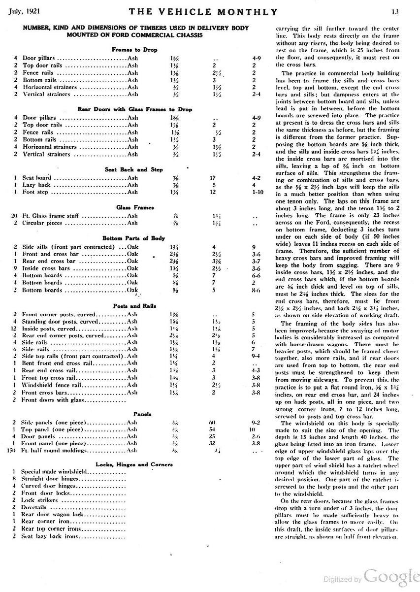

For giggles and what not, remember that pre-1923 Fords ( and some others) depended on their bodies to be of a wooden frame and metal covering. Meaning that the business depended on coach builders familiar with wood frame construction.
Suggest a read or at least a view of the following literature.
