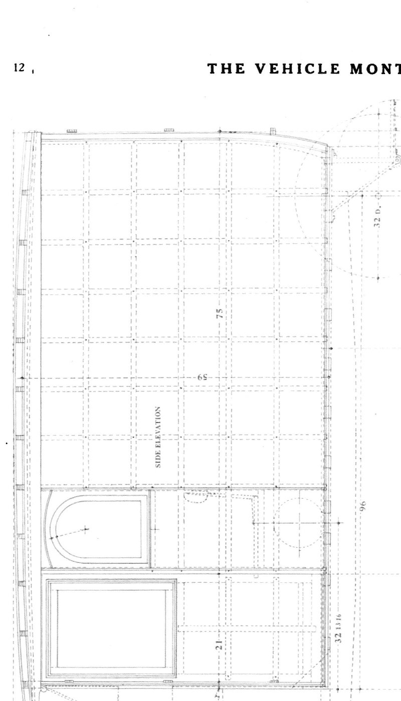

I’m looking to build a very simple express open top body. Anyone have any pictures or measurements they would be willing to share? Especially on how the body attaches to the frame. Thank you

I got the express pickup plans from Wagon works and I did modify slightly a couple details.I was not experienced on working with plans and it was a learning experience.

Wagon Works Plans from Iowa are the best deal in town. The plans give you all the framing dimensions. You will then customize them as you move through the build. Fun project.

For giggles and what not, remember that pre-1923 Fords ( and some others) depended on their bodies to be of a wooden frame and metal covering. Meaning that the business depended on coach builders familiar with wood frame construction.
Suggest a read or at least a view of the following literature.

1923orange wrote:
Sun Dec 31, 2023 4:01 pm
