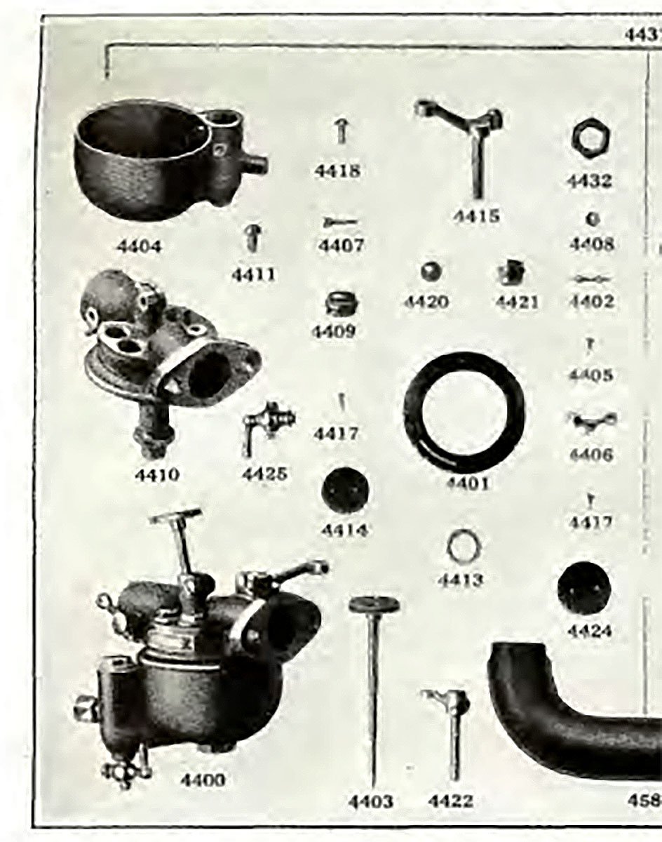

But taking it apart for renovation, it seems I'm missing some parts and browsing the vendors catalogs I se not many kits for restoring Kingston Y carburators. L, L2 and L4, but not Y. However, reading various forum posts maybe I can use some of the parts for these newer Kingstons? What is missing here in the threaded hole? The threaded hole to the right? Can I use a later float? I do not think this is ethanol proof

A bowl drain valve fits into the threaded hole near the gas inlet. The float pictured looks like the correct style, but check that the pivot point is in the right place. It might just be camera angle, but the bowl body looks more elongated than other Kingston 4 ball carburetors.

Re: What am I missing here - Kingston Y 4-ball
Does this help? Look at page 42; http://www.cimorelli.com/mtdl/1914/default.htm

Mark, thanks, but that link just leads to a page with a lot of 1914 Ford literature. Which ofthe documents do you have in mind?Mark Gregush wrote: ↑Tue Oct 03, 2023 11:02 amDoes this help? Look at page 42; http://www.cimorelli.com/mtdl/1914/default.htm

Thanks Mark! Very usefull.
I also found this post in the Classified forum with pictures. I draining petcock it is that are missing.

Sorry, I thought the link would take you to the parts book I was looking at. Anyway, great source of information on Model Ts. If you click on BACK TO START, it will take you to the main library.

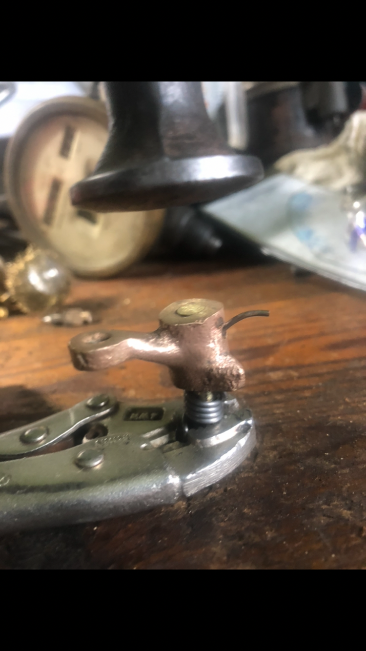

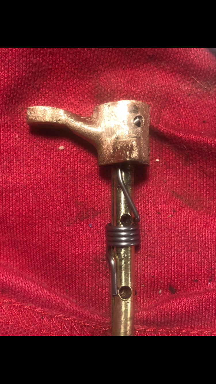

Here is how you can make a choke spring from an NH choke spring when you get that far.
