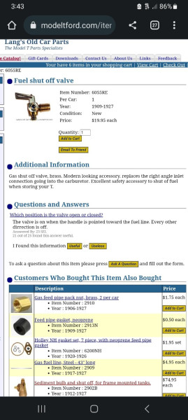

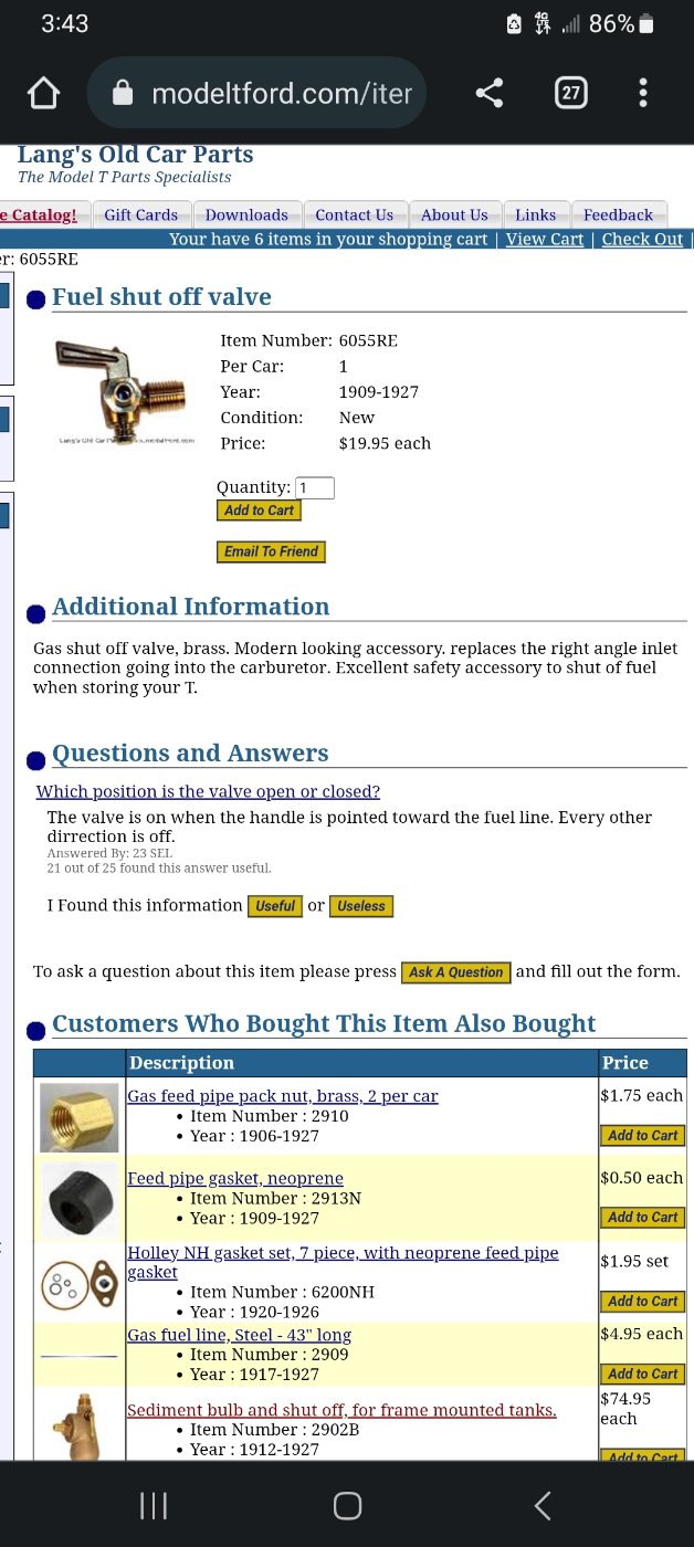

Topic author - Posts: 902
- First Name: Austin
- Last Name: Farmer
- Location: N.W. Illinois
Re: New vs old gas shut off valves
This is what i ordered.
- Posts: 5599
That style works just fine IF you take the time to lift the handle up just a smidge BEFORE turning. It's alot better than some of the cobbled up plumbing store hardware I've seen installed !
