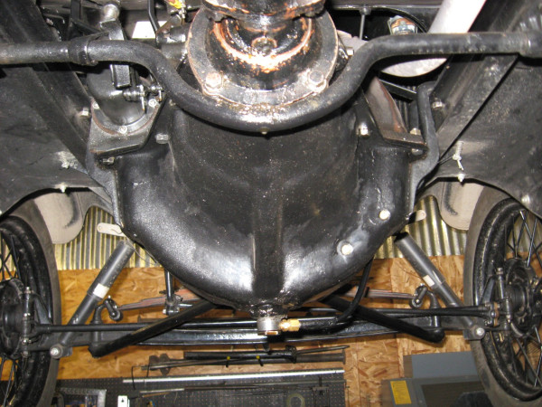

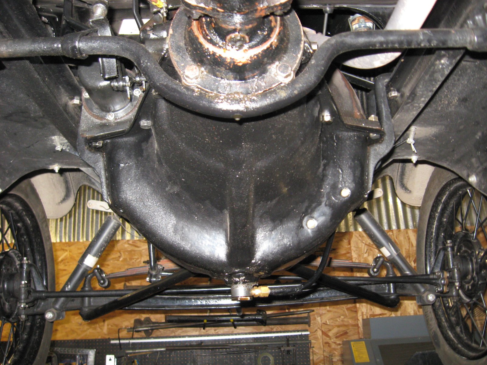

looking for information on putting modern shocks on a model t. what shocks and how to mount.philip

thanks mark i found that one there is one somewhere that shows the fronts

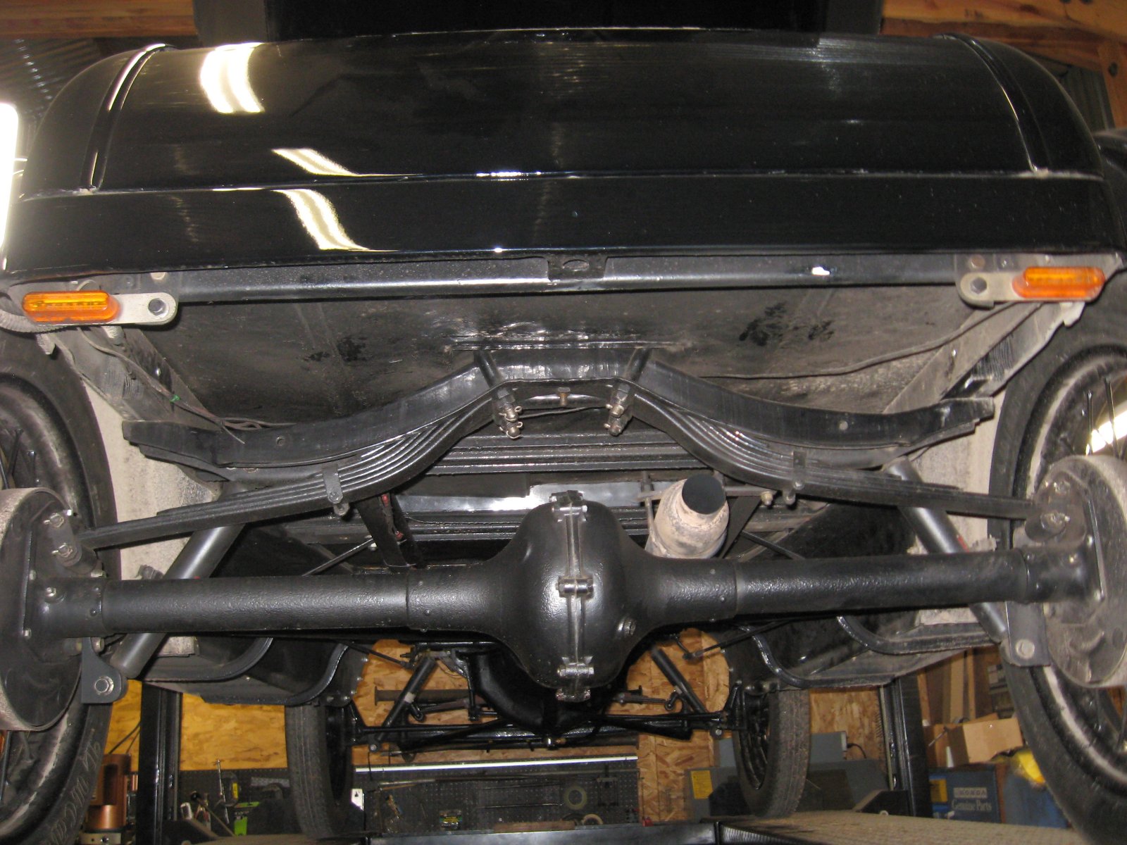

My method is using 1965 & earlier VW shocks front & rear.They work very well as Tom says the rear make the big difference.

bill can you give me a picture of the mounts?

Philip, The ones I have seen on the NW Montana 500 racers where smaller VW type and attached directly to the differential tube. They were Much less offensive looking than some others but not Model T era for sure. If you can find a picture of Tom's I would copy his idea and could easily be home built.
