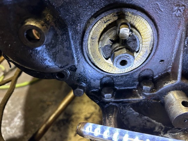

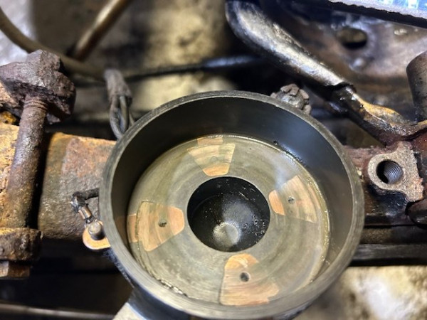

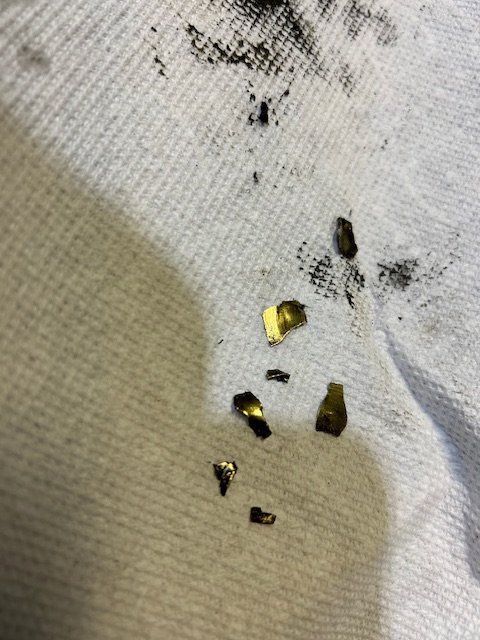

Since I have the radiator off I'm checking over stuff as it is exposed. Tonight I pulled the timer cover off and cleaned it out. I'm glad I did as I found some brass flakes in there. After I looked at the commutator shield it was pretty obvious where they came from. The timer cap seems to be OK. Is this normal wear, or is there something abnormal happening?

Your timer is a New Day and one of the best aftermarket timers for a T. The original was a roller style timer. Since you have the radiator off now would be the time to install a modern press in seal that replaces the felt. It’s right behind the brass shield.
Using the brass shield with the New Day timer usually results in your issue.
The brush on the camshaft rubs against the shield and eventually rubs a hole in it and starts to peel away the brass. The modern seal is widely used in Model T’s and works well. You won’t need the brass shield with the modern seal.

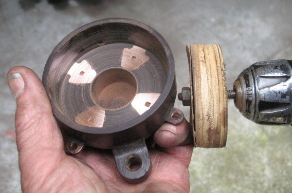

I also second the sentiment above, clean the timer. This is a photo from a past post (I believe from Steve Jelf) on how to clean/sand/reface the New Day Timer, link to the original thread, https://www.mtfca.com/phpBB3/viewtopic. ... ng#p103066
New day sanding.JPG (48.06 KiB) Viewed 2148 times
I had made mine out of a scrap piece of aluminum plate/sheet that was about 1/4" thick and I use double-sided tape to hold the sand paper in place. It works really well.
