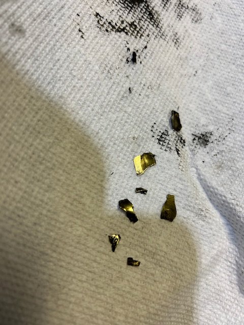

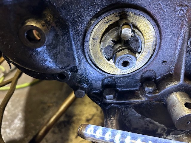

Since I have the radiator off I'm checking over stuff as it is exposed. Tonight I pulled the timer cover off and cleaned it out. I'm glad I did as I found some brass flakes in there. After I looked at the commutator shield it was pretty obvious where they came from. The timer cap seems to be OK. Is this normal wear, or is there something abnormal happening?

Your timer is a New Day and one of the best aftermarket timers for a T. The original was a roller style timer. Since you have the radiator off now would be the time to install a modern press in seal that replaces the felt. It’s right behind the brass shield.
Using the brass shield with the New Day timer usually results in your issue.
The brush on the camshaft rubs against the shield and eventually rubs a hole in it and starts to peel away the brass. The modern seal is widely used in Model T’s and works well. You won’t need the brass shield with the modern seal.
Lang’s sells the modern press in seal for around 5-6 dollars and well worth it. Go to their website to check it out and get their parts catalog while you’re at it. It’s a great help in learning about Model T parts.

Use some WD-40 to clean out the timer while you’re at it. Get the copper contacts clean.

I had the same thing happen to me quite a while ago, left me stopped on the side of the road. As stated above, I switched from the felt seal and brass shield to the modern seal and I have never had another problem since.
