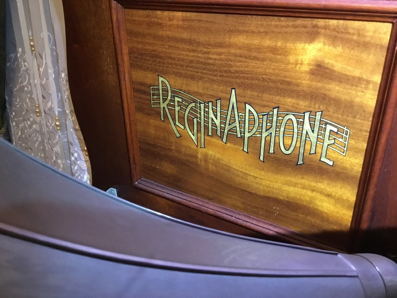

When I was restoring a Reginaphone music box, the lid required a varnish transfer decal. I messed up two before using the third to make a stencil that I used to paint on the design. I found varnish transfer decals to be very difficult (at least, for me) and I would rather paint the design on using a stencil made from one of the decals using adhesive backed paper and a sharp razor knife. Good luck. Jim Patrick

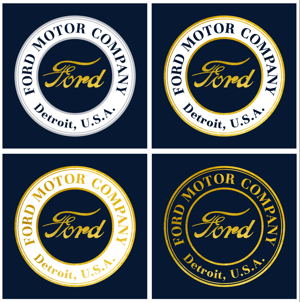

Here's the art work that I have for my decals. I made up 4 different variations. The Delivery car body will be Midnight blue with the french gray pin striping. Which one do you like?

Lower right.

I think the top left looks most "original", but like the gold bling the top right.

I like the top right.

The white in the bottom left has the best tone/feel to me. Others are too clean or modern white looking

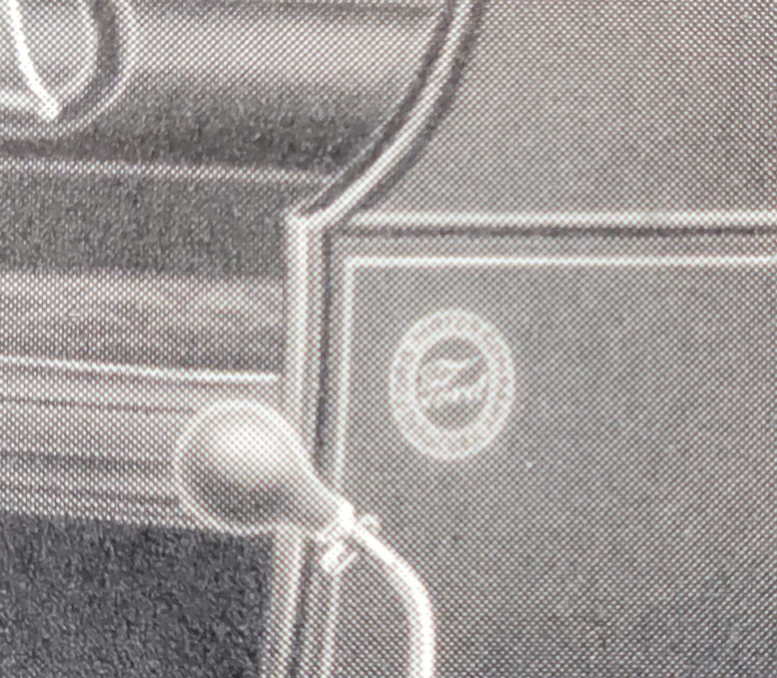

This link to Cimorelli's Digital Model T Library has several pamphlets about the delivery wagon https://www.cimorelli.com/mtdl/1912/default.htm The first set of boxed brochures have smaller images than the others. Doubt if the Brochure covers were the logo --

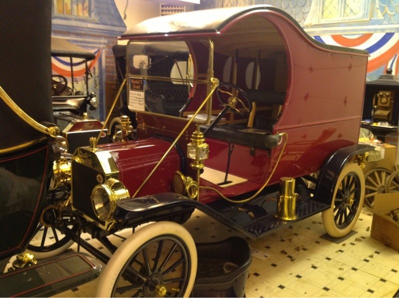

I have a picture of Craig Beek's Pie Wagon & close up of the decal. Light reflection & the individual computer's may cause shade differences. Having said that I am unsure if the inner ring is black or dark brown. Will have too ask - his & John R's differ slightly. Craig has some shoulder issues right now but he and I will be down at his museum in a week or two I I will take better pictures especially to determine if the FORD script is subdued or bright. I do know that he had a professional water slide decal maker make them.

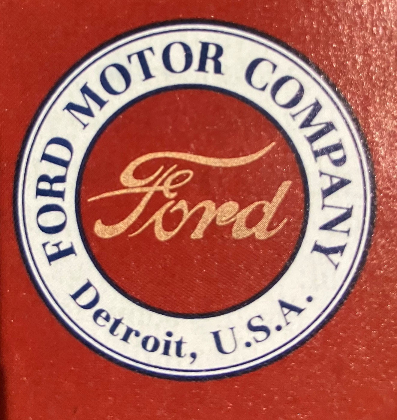

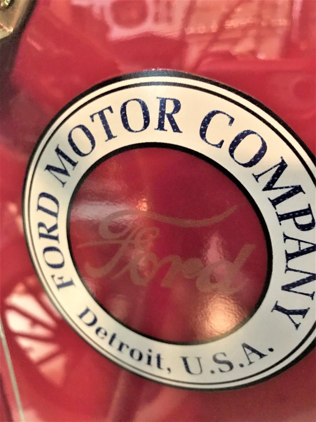

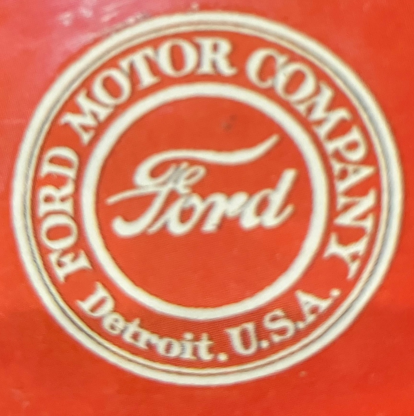

Here’s John Regan’s close up followed by Bill Brommer’s
Notice that Bill did a font that looks like the ones from the brochures. Also differences in the Ford Script. I had the hardest time finding a hi res Script for printing like the one John used so I basically had to trace it and redraw it

I think you touched upon the issue of correctness, the Font. I also think he used Bill's as the pattern he gave to the the artist who may have indicated the the other fonts were used at that time & why his are diffrent, but could be wrong. I called Craig but he is in therapy for a shoulder rebuild. I'll get back to you later this afternoon after my hip therapyTbird wrote: ↑Thu Feb 01, 2024 7:35 amFrank,

TRDxB2 wrote: ↑Thu Feb 01, 2024 11:43 amI think you touched upon the issue of correctness, the Font. Just got off the phone with Craig and he confirmed my memory. He started to use John's was said to be proprietary. Thre were more than one image. Craig the used Bill's and sent it off to a supplier that made decals for John Deere. The artist there said that the font on Bills (John's too) was a later period font so she used one that was in use at the time of the car manufacturer. Hence the difference.Tbird wrote: ↑Thu Feb 01, 2024 7:35 amFrank,
