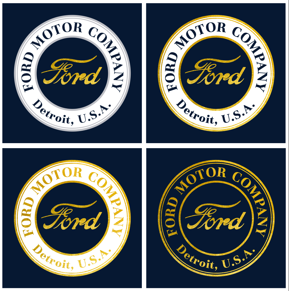

Post by Tbird » Wed Jan 31, 2024 2:02 pm
Here's the art work that I have for my decals. I made up 4 different variations. The Delivery car body will be Midnight blue with the french gray pin striping. Which one do you like?

Post by speedytinc » Wed Jan 31, 2024 2:16 pm
Lower right.

Post by KWTownsend » Wed Jan 31, 2024 11:02 pm
I think the top left looks most "original", but like the gold bling the top right.

Post by Mark Gregush » Thu Feb 01, 2024 12:49 am
I like the top right.

Post by RVA23T » Thu Feb 01, 2024 1:35 am
The white in the bottom left has the best tone/feel to me. Others are too clean or modern white looking

This link to Cimorelli's Digital Model T Library has several pamphlets about the delivery wagon https://www.cimorelli.com/mtdl/1912/default.htm
The first set of boxed brochures have smaller images than the others. Doubt if the Brochure covers were the logo
I have a picture of Craig Beek's Pie Wagon & close up of the decal. Light reflection & the individual computer's may cause shade differences. Having said that I am unsure if the inner ring is black or dark brown. Will have too ask - his & John R's differ slightly. Craig has some shoulder issues right now but he and I will be down at his museum in a week or two I I will take better pictures especially to determine if the FORD script is subdued or bright. I do know that he had a professional water slide decal maker make them.
