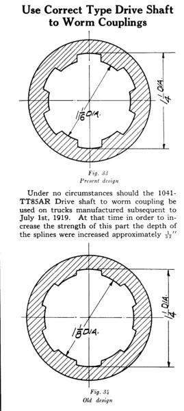

Here are specifics on the TT variations:
1920:
Then, by 1924, they realize the mis-match causes problems and tell you not to do it!
1924:
