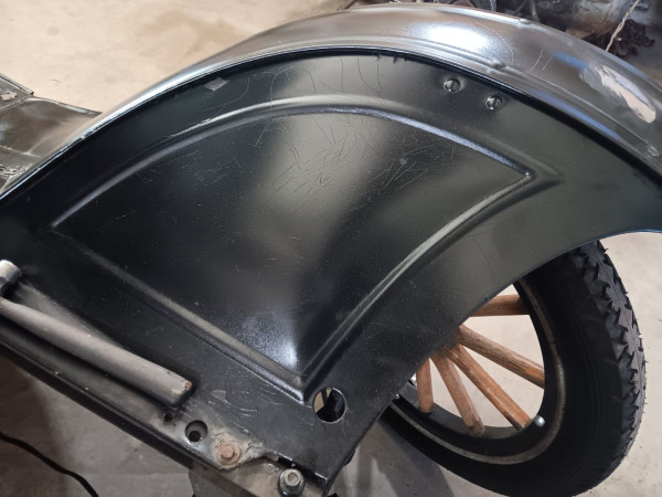

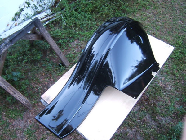

Yes. You can make such a paint job as nice as a professionally painted car. If you mask off all the glass, handles, radiator shell, and anywhere you don’t want to paint then get six or eight cans of Rustoleum Gloss black appliance Epoxy (from Home Depot). Wet sand the car to remove all old oxidation, imperfections, dirt, rough spots, cracks and to provide a smooth surface to get a good surface for the paint to adhere to. Spray on a fresh coat of paint to fill in the cracks and make it thick enough to provide protection to the body and allow for compounding without going through. Shake all the cans (a minute per can) to have them ready to spray when a can runs dry. Spray the paint on and continue spraying until the car is done. Try and spray a consistent thickness overall. Keep moving as you spray and only move to the next section when the previous section is a high gloss with no overspray or runs. When done. Let dry for a week before compounding. No need to wet sand unless dust or overspray has settled on the finish. Wet sand with 600 wet/dry sandpaper, but only enough to take out the flaw. Compound with Meguiar’s Rubbing Compound.
I am attaching 3 pictures of a fender I did with Rustoleum Gloss Black Appliance Epoxy. I used 2 cans on this fender and sprayed a constant flow of spray paint going back over the fender, re-wetting the overspray until it was reabsorbed into the wet paint. When I had a beautiful mirror finish with no overspray or runs. It went over so well, there was no need to wet sand or compound. This is how it looked after it dried. Be especially careful of runs on vertical surfaces such as doors and body panels. Horizontal surfaces can take more, but all surfaces will eventually run if you are too careful and get it too thick. Good luck.

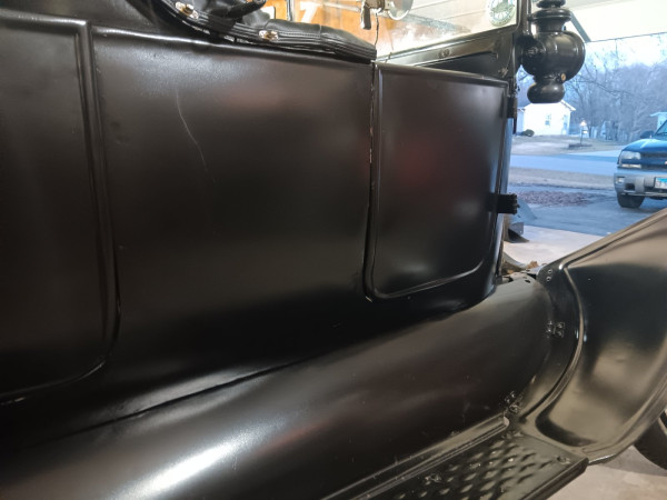

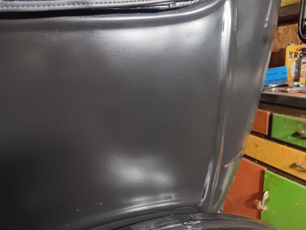

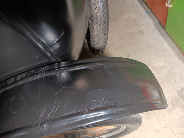

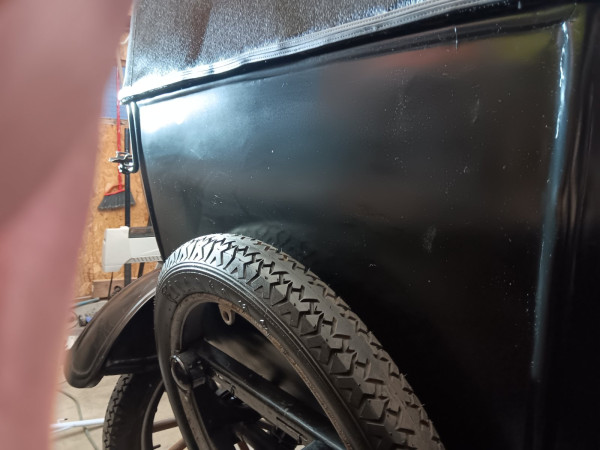

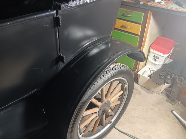

Here are a few pictures of the cracks and stuff that i was talking about. The paint has some 'orange peel' in it as well.
My goal is just make the car a little nicer, im not really all that worried with the cracks. If i do end up painting it someday, it will be red. The car used to be a fire cheifs car when it was new, there's stilll some red left under the radiator shroud, and is wearing through where the door latches are. It also has a hole right in the middle of the windshield that is used to mount a spotlight (which i do have) but i must admit, looks kinda out of place on a 'regular' black car. :lol: we also have a TT firetruck that is red, and if it was was painted like that I think that would be pretty neat!
I bought some of that meguiars compound, like in the image above, but it didn't help me much. The pictures were before i tried the compound.

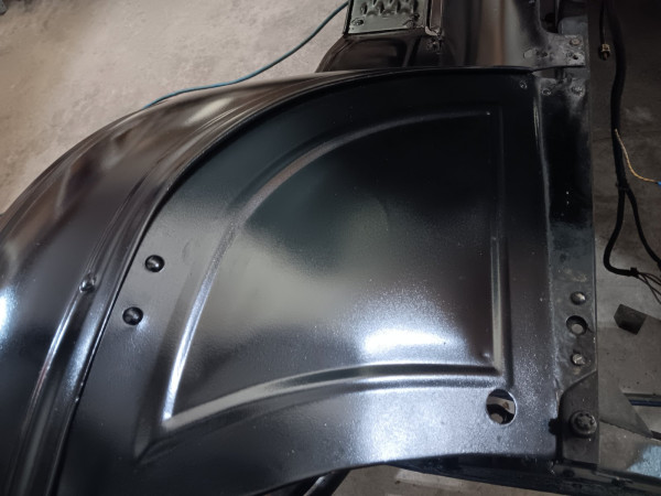

Post by 1925 Touring » Thu Feb 22, 2024 9:03 pm
More pictures

Re: Polishing up spray painted T?
Post by JohnM » Thu Feb 22, 2024 9:34 pm
It has a nice satin look. I wouldn't be ashamed of that at all!
Post by jiminbartow » Thu Feb 22, 2024 10:31 pm
That does look a lot like lacquer was painted on top of enamel, creating those cracks. Everything I suggested I still stand behind. Sand the finish to smooth the surface, mask off and paint with Gloss Black Appliance Epoxy. The difference will be stunning.

Posts: 7293
Post by Allan » Fri Feb 23, 2024 3:03 am
