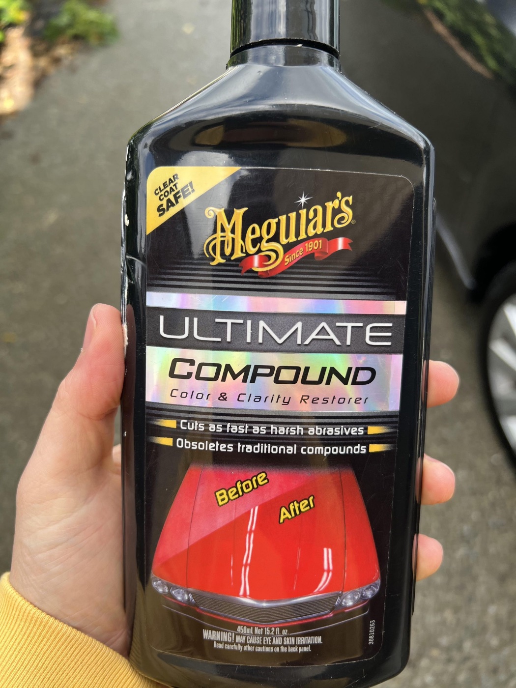

Steven, Austin said there were “a lot of cracks in the paint”, as well as scratches. For it to look decent and even professional, it would be best to wet sand those cracks and scratches out as much as possible and fill any left over remnants with a good coat of fresh paint then, when totally dry, wet sand smooth so as to bridge the cracks Since it was done improperly before, there are probably alot of impurities such as bugs and dirt that need to be addressed as well. Just compounding will not do the job properly. Speaking of which, I agree 3M products are very good, but in my 54 years of painting, I have never found a better compound than Meguiar’s. Their paste wax is fantastic as well. Jim Patrick
PS. Cracks are usually caused by applying the wrong type of paint over an underlying paint, such as applying lacquer over enamel. Lacquer is a hot paint that will melt the enamel…However, enamel can be applied over lacquer because lacquer is so hard and the enamel cannot soften the lacquer. Your paint is probably so old and cured out that this will not be an issue. I’m sure the Rustoleum Appliance Epoxy can go over any type of paint without getting a bad reaction, but it is always best to try a small area on top of a fender to make sure the old finish is compatible with the new.

Again I agree with Jim as to the quality of Meguiars. I have though since switched to Wizards, they have a fantastic polish called "Shine Master" and also a detailer spray called "Mist N Shine" which really works well and holds up great. Smells like bubble gum! :lol: They also have various "strengths" of scratch removers that I also swear by. Just one's choice really. Figured I'd throw that out there for discussion is all.

I was just keying off the "a little bit shinier" comment. Nothing other than a professional paint job could come close to what JIm has suggested with the Appliance Epoxy. I also use a lot of Meguiar's products and their all great.

I bought some of that meguiars compound, like in the image above, but it didn't help me much. The pictures were before i tried the compound.
