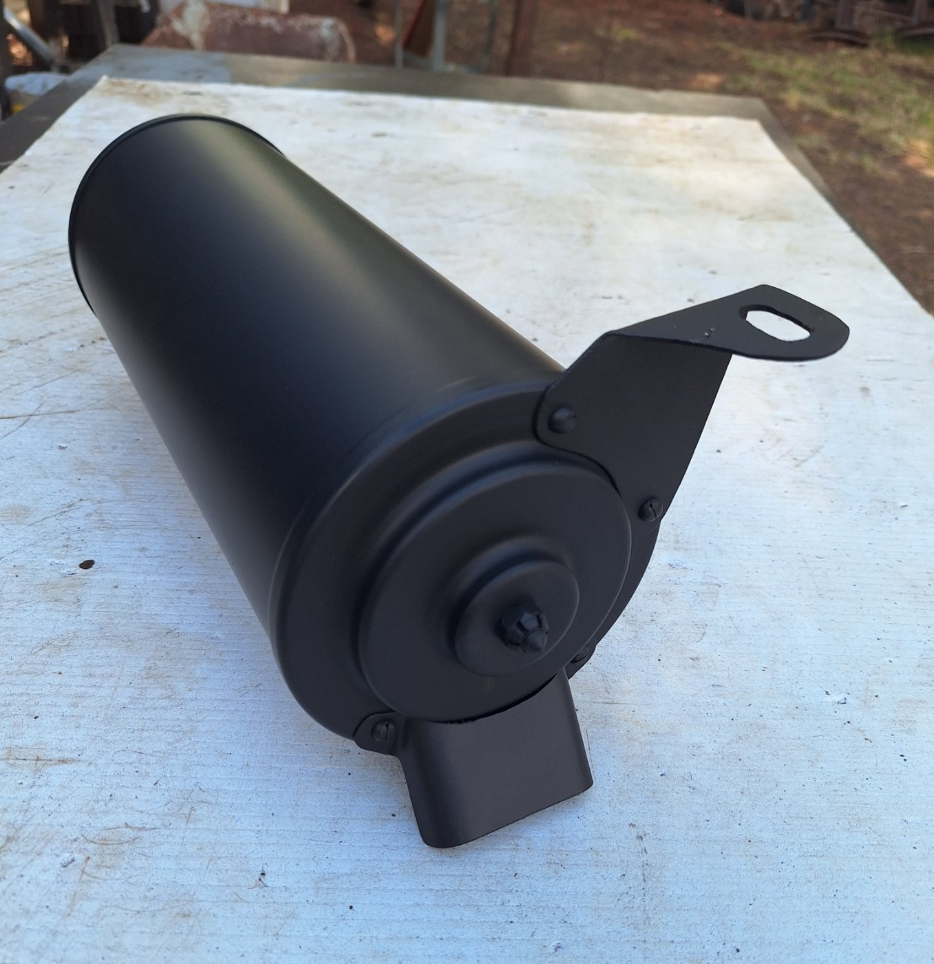

The later muffler was pressed steel with one mounting ear thus your late frame only had one factory hole !

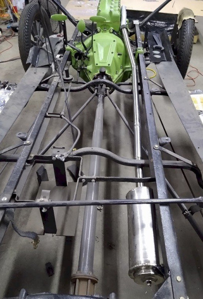

You didn't mention whether you measured the length of your exhaust pipe and what that measurement was, if you did. Chances are, you don't have the original 26-27 (long pipe that inserted through the front muffler end; went all the way to the back muffler end, and served as the smallest pipe or shell in the muffler). If by any stroke of luck, you had the original (long) pipe (which aren't being reproduced) it would be a shame and almost a criminal offense to cut even an inch off a very rare exhaust pipe. On the other hand, if you have a standard length pipe, have no inhibitions about cutting it and drilling a hole in your frame, if that is your intention. The cast iron muffler ends are heavy and add weight to the exhaust system. A much better choice of muffler would be the reproduction "late" T take-apart" muffler with pressed steel ends. it is almost a duplicate of the original 26-27 muffler, but the exhaust pipe doesn't slide all the way into the muffler, but only into a 'nipple' on the muffler front end. Most suppliers have them in their catalogs.

If Ford could make the original long pipe, I think Langs, Snyders, Chaffins should all band together and get them made correctly. I had 50 made a couple of years ago, and they weren't made the original way, but with my limited $$$ they were the best I could do. They sold fast!

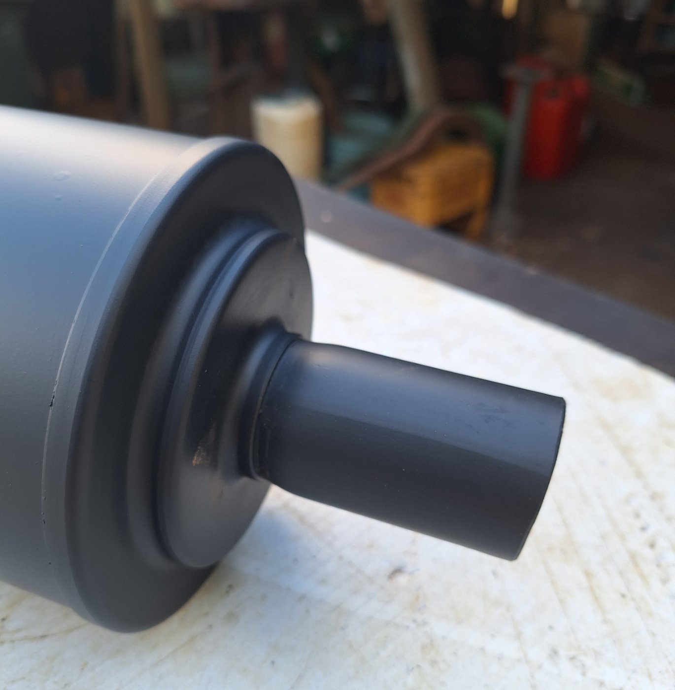

I make these Canadian spec mufflers with a deflector.
The small centre pipe is the same as the exhaust pipe. It is expanded at the front end to receive the exhaust pipe. This expansion is left long so the muffler is well supported, without a clamp.The front end piece of the muffler stops on the expanded end, just as it did on the raised ridge of the USA made exhaust pipes.
The Canadians stopped the front end of their mufflers by drilling the pipe and fitting a large split pin. There was a notch in the end piece to engage on the split pin.

I used stainless steel hand rail and a stainless steel paper towel dispenser from a rest room to weld up my own muffler and exhaust in the shape it should be for a late 26 coupe. It will outlive the car and me.
