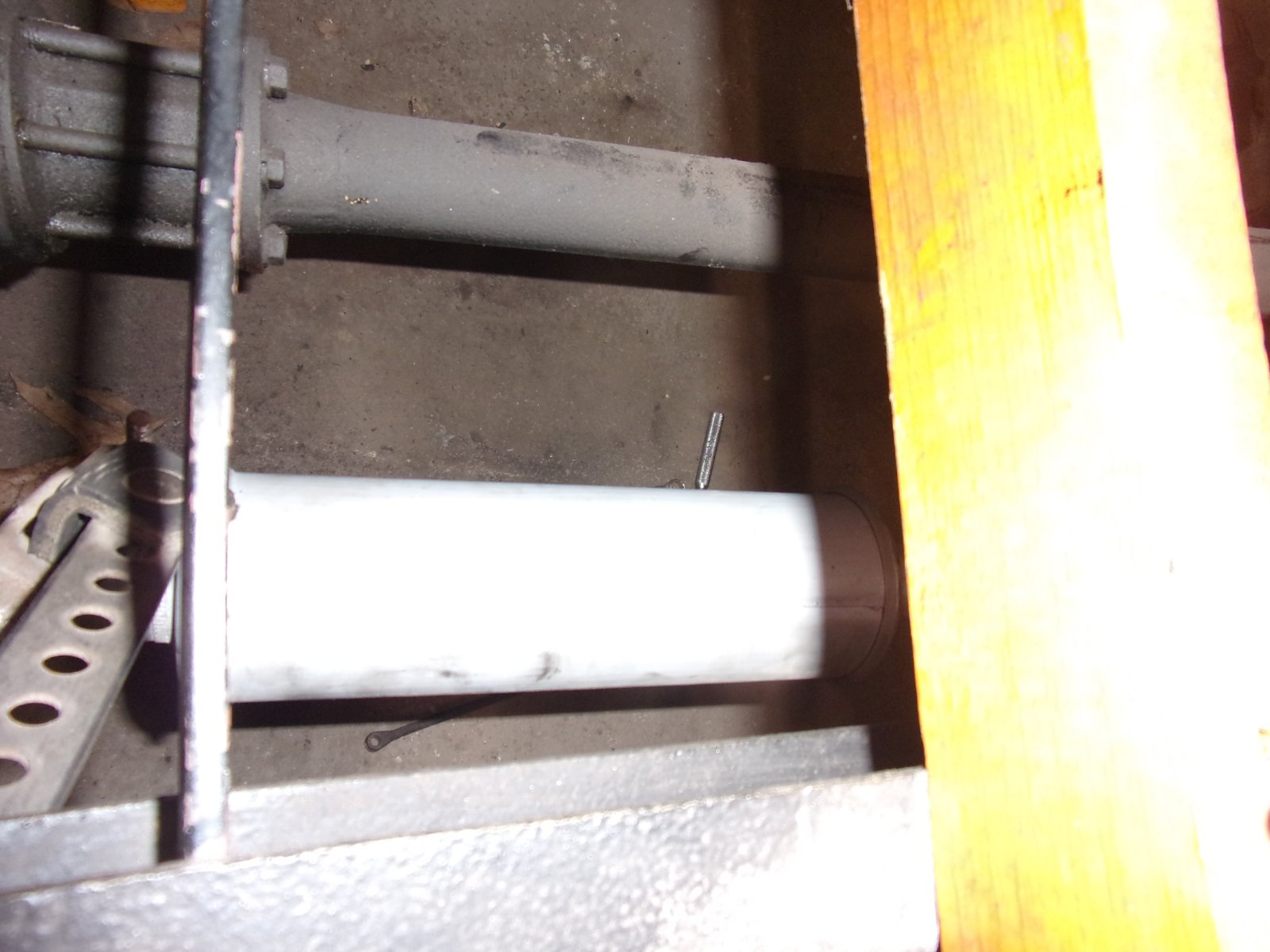

Bubba had a Bubba muffler on the 27 depot hack that was rotten, so off it came, the exhaust pipe and packing nut look good. So I pulled a cast iron muffler off the shelf and two nuts and bolts. Slip the cast iron muffler on and go to bolt up and only one bolt hole in frame. The lone hole almost fits the rear mount for the muffler, if I trim 1" off the exhaust pipe, I'll be good. But no front mounting hole and no feel that one was ever there and welded close for some reason.
So, I presumed the 26 27 car used a different muffler, but all the vendors show the same muffler from early theens through 27 .
Is there a hole somewhere I'm missing? Am I in the right location Before I hit the send button I went down and checked to make sure what I was feeling as the rear hole was not, in fact, the forward hole, but the rear hole is just forward of the rear crossmember, so it the rear hole. Where did my forward hole disappear to?
I can always drill. But, just fcurious what I'm not doing correctly.

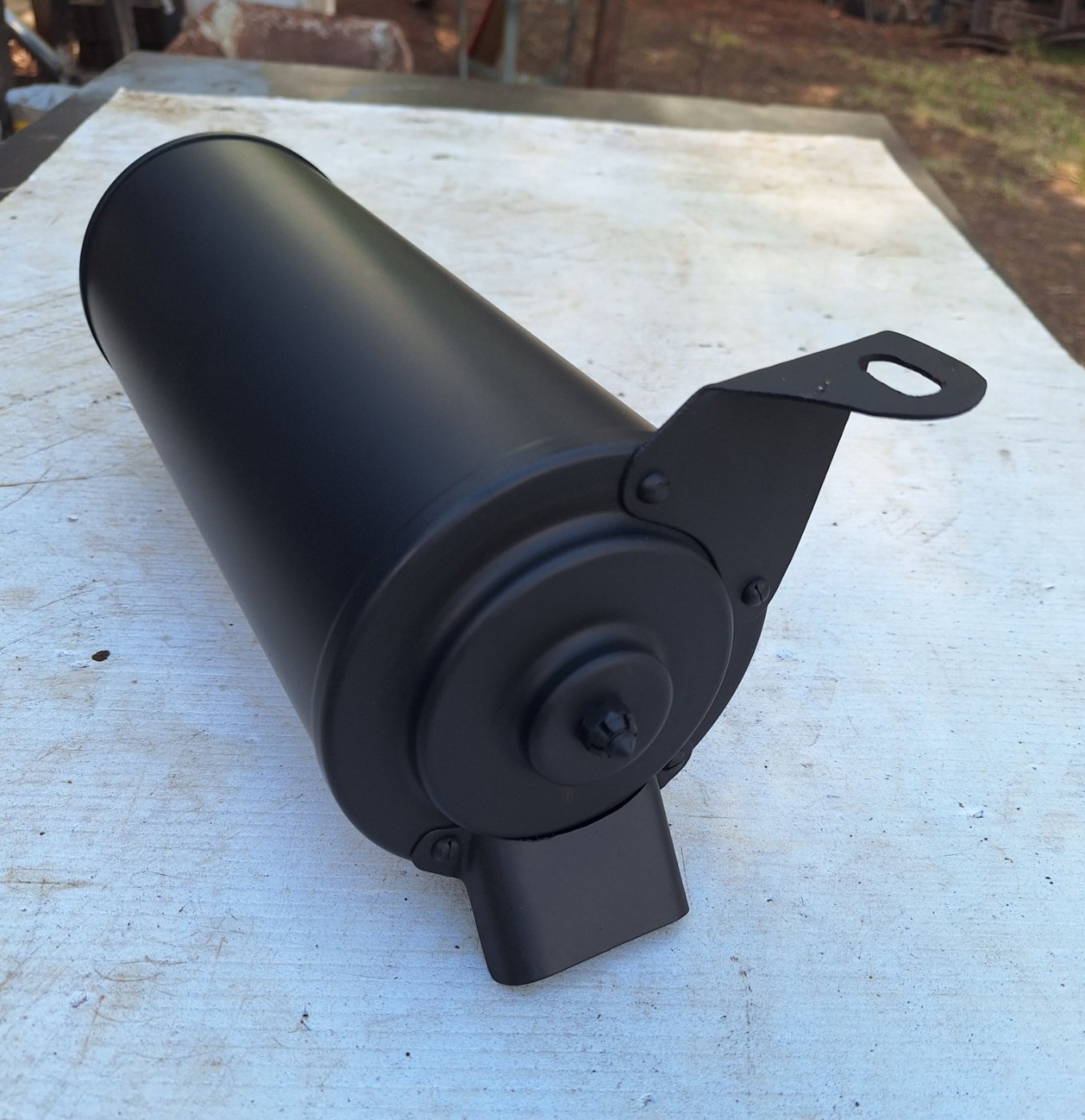

The later muffler was pressed steel with one mounting ear thus your late frame only had one factory hole !

Will the one rear mounting bolt hold up the muffler with two cast ends? Should I drill the second hole and install two bolts and castle nuts? Or obtain a newer fu muffler? This project will be a Model T salad, so I just want something that appears correct to the period and functions reasonably well.

Dont waste your time, get the right muffler.
- Posts: 7133
Re: Installing 27 muffler
The right muffler will need the right exhaust pipe. It was long enough to go clear through to the back of the muffler, so it did not have a slip joint at the front. Save your funds and drill the front hole.

I agree with Jeff. I don't like to drill holes in my Model T, but I do like having support at each each end of the muffler.

You didn't mention whether you measured the length of your exhaust pipe and what that measurement was, if you did. Chances are, you don't have the original 26-27 (long pipe that inserted through the front muffler end; went all the way to the back muffler end, and served as the smallest pipe or shell in the muffler). If by any stroke of luck, you had the original (long) pipe (which aren't being reproduced) it would be a shame and almost a criminal offense to cut even an inch off a very rare exhaust pipe. On the other hand, if you have a standard length pipe, have no inhibitions about cutting it and drilling a hole in your frame, if that is your intention. The cast iron muffler ends are heavy and add weight to the exhaust system. A much better choice of muffler would be the reproduction "late" T take-apart" muffler with pressed steel ends. it is almost a duplicate of the original 26-27 muffler, but the exhaust pipe doesn't slide all the way into the muffler, but only into a 'nipple' on the muffler front end. Most suppliers have them in their catalogs.

The Bubba muffler that was on the depot hack had a "standard" length exhaust pipe and then a muffler and then a 2 foot long tail pipe added. I took my cast iron muffler apart and cleaned up both innter tubes and it slips right on the exhaust pipe all the way to the inner pipes. I'm still about 1" long to get to the rear mounting hole in my frame, so I'm leaning twards cutting off 1" on the exhaust pipe, installing the cast iron muffler, blting up to the rear hole and using the front mounting leg on the muffler as a template, drilling a hole in the frame to secure it with two bolts and castle nuts and cotter pins, then tighten up my front packing nut and see how it sounds.

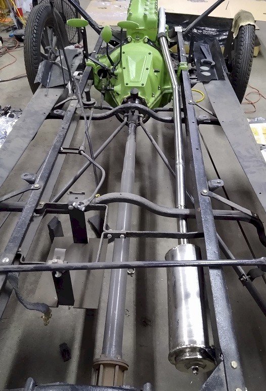

I used stainless steel hand rail and a stainless steel paper towel dispenser from a rest room to weld up my own muffler and exhaust in the shape it should be for a late 26 coupe. It will outlive the car and me.
