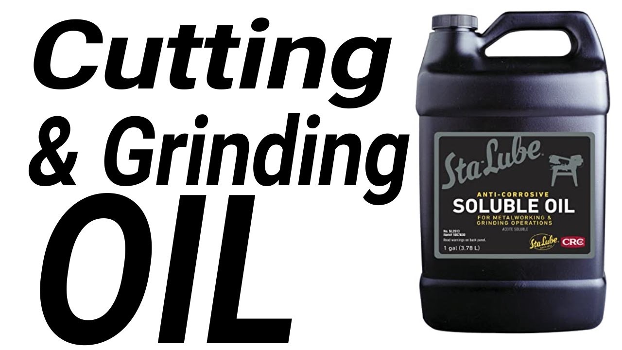

Mark Nunn
Posts: 1252
Last Name: Nunn
Location: Bennington, NE
Re: Reamer lubricant, water- or oil-based?
Post by Mark Nunn » Thu Feb 15, 2024 9:39 am
Soluble Oil is a chlorine-free, water miscible metalworking fluid designed to emulsify easily and form a long-lasting, stable emulsion when mixed with water
jiminbartow
Posts: 2437
Last Name: Patrick
Location: Bartow, FL
Post by jiminbartow » Thu Feb 15, 2024 9:51 am
Water soluble oil. Oil that mixes with water. Designed for providing lubricant and cooling properties to machine work that would overheat without it. Makes the lubricating oil thinner and allows it to go farther making the job more economical.
Just one example. There are all types of brands.
