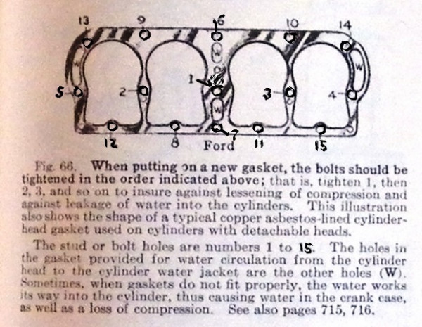

Post by DanTreace » Wed Feb 14, 2024 2:30 pm
After cleaning the block holes very well, to be sure they are free of carbon debris, then spray the gasket with Copper Gasket coat, or use a high metallic content alum. spray paint.
Most important is the sequence to torque to squeeze the laminated gasket for best sealing against leak. Must do 1, 2, 3, 4 and 5 first as the cylinder walls are the closest and the gasket is the narrowest there.
45 ft/lbs is safe bet to prevent a sheared off used head bolt, better to use new head bolts.

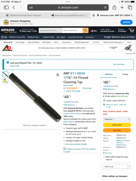

Post by Jim11787 » Fri May 03, 2024 4:52 pm
This is what I bought to clean head bolt holes. Going to replace head in next 2 weeks.
