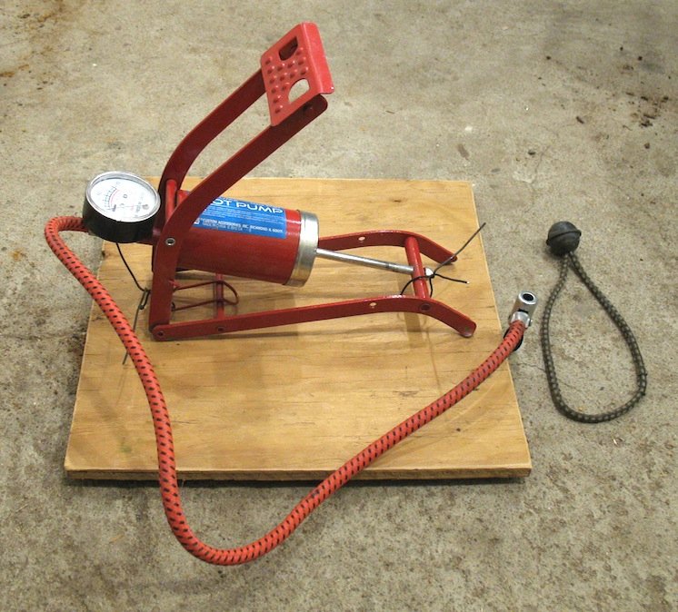

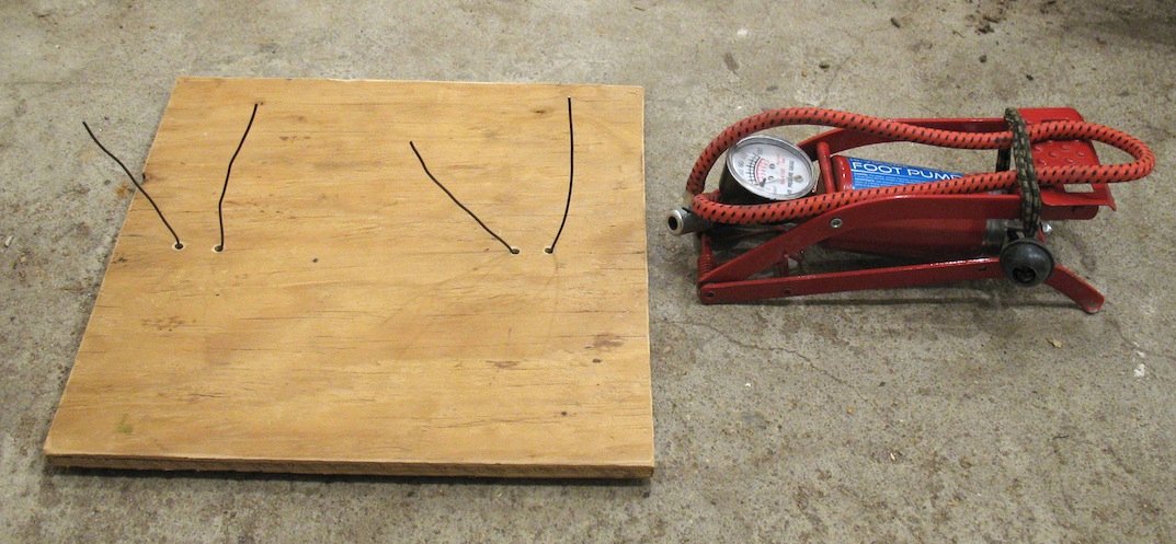

Speaking of Royce, it was his suggestion that led me to the bicycle foot pump I carry. I was dubious, but found it surprisingly efficient.
I wire it to a piece of plywood to keep it upright on uneven ground.

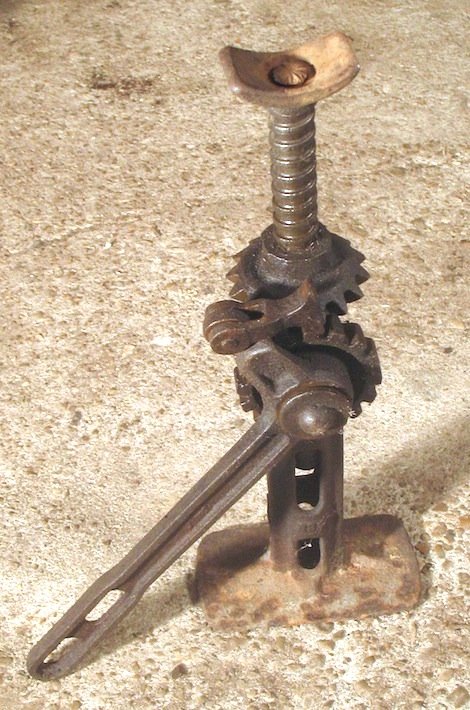

My running board tool box contains a standard Ford screw jack which I've had to use more than once. It's fine. I also carry a piece of 2 x 8 board to put under it.

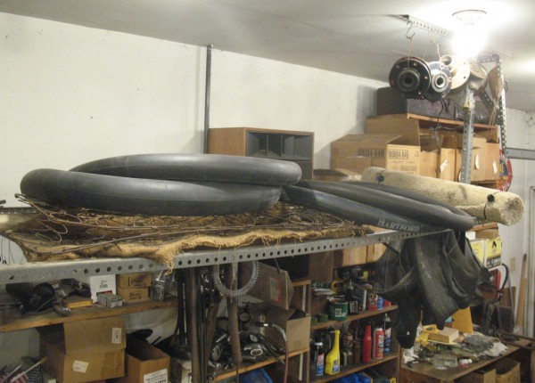

Thanks to all. Another question, how do you store tubes " correctly " ?
- Posts: 7411
Re: Newbie question: how to change a tire on the road?
Put in just enough air to keep them round.
