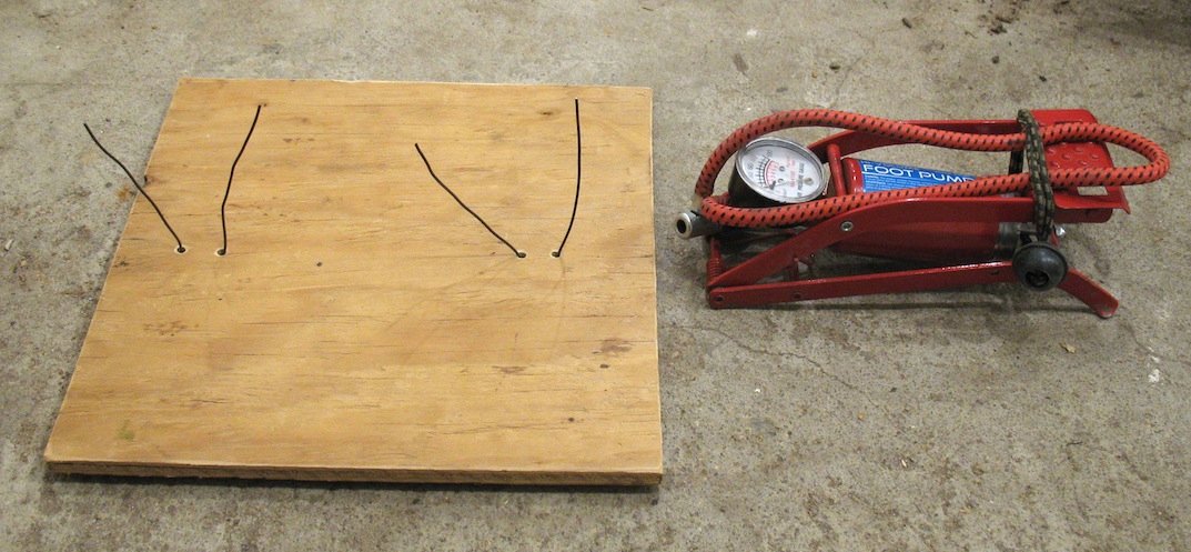

Speaking of Royce, it was his suggestion that led me to the bicycle foot pump I carry. I was dubious, but found it surprisingly efficient.
I wire it to a piece of plywood to keep it upright on uneven ground.

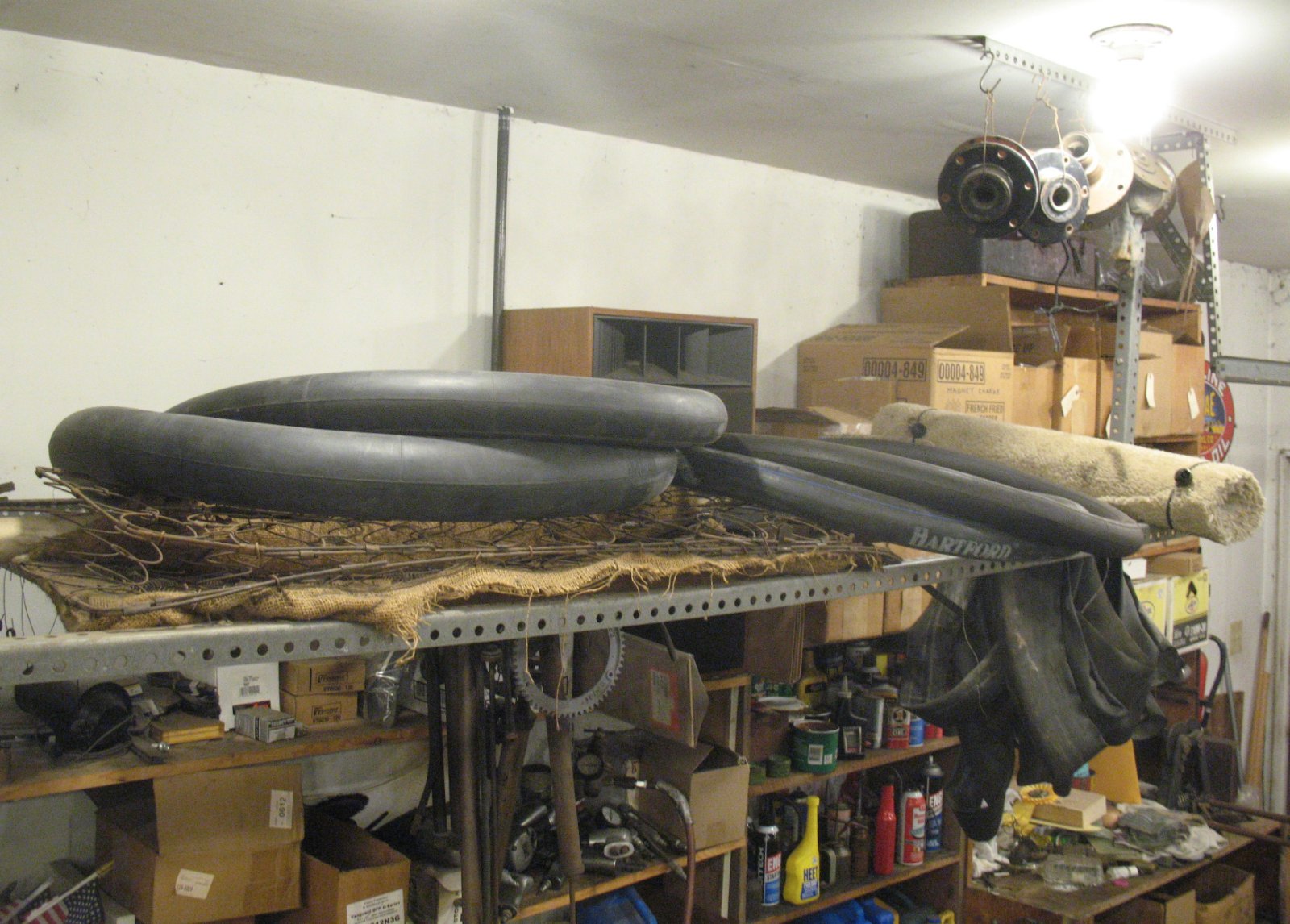

Thanks to all. Another question, how do you store tubes " correctly " ?
- Posts: 7350
Re: Newbie question: how to change a tire on the road?
Put in just enough air to keep them round.
