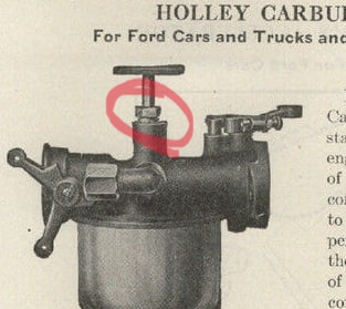

We need to know which carb you have, but I'm gonna go with a Holly NH.
Have you tried to tighten the "packing" nut for the needle highlighted in the attached picture? Usually once you get an NH adjusted it does not need to be adjusted with any frequency that you require you to leave the needle nut loose. Like Allen said!
