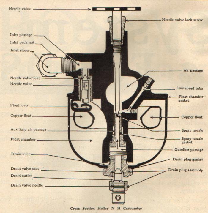

So I have my moms 1924 model T, it was taken apart over 40 years ago to be restored and repainted. Long story short it never got restored, she came home one afternoon only to find it in parts and pieces sitting in her drive way. Somewhere and time many years ago I told her I would like to have it. Well I have had it for about 20 of those 40 years with the normal everyday thing that come up family has always come first for us. Last year I finally was able to build a shop and the Model T was put inside. During this time mom said she would like to ride in it again. Over the last year I have focused on getting it put back together to make moms wish happen. What a large jigsaw puzzle did I take on. The car is about 90% completed but I have stumbled on a few things that we haven't found on youtube. One being the carburetor. When the car is running the mixture adjustment rod vibrates around and will not stay set So it makes it difficult to keep the car running. This weekend I was working on the car and after getting the carb/mixture set I placed a piece of tape across the rod on the fire wall to keep it from moving. I know this is not what ford intended any suggestion on how to make this correct. Or do I need to get a rebuilt carb?

The brass nut on the top of the carburettor through which the mixture control needle passes is split underneath, so that if you tighten the nut, there is friction applied to stop it turning freely.

We need to know which carb you have, but I'm gonna go with a Holly NH.
Have you tried to tighten the "packing" nut for the needle highlighted in the attached picture? Usually once you get an NH adjusted it does not need to be adjusted with any frequency that you require you to leave the needle nut loose.

As posted above the brass nut needs to be tightened up a bit. That’s a good start to figure things out. If you don’t already have one it’s a good idea to but the Ford Service Manual. There is a wealth of information for Model T’s. Good luck.

Thanks for all the information. Went out to the shop Saturday and made a slight adjustment maybe an 1/8 of a turn and that did the trick. Later that afternoon I took it for its first drive in 40 years. What an experience. Without all of the recommendations I was ready to buy another carb. Thanks again.
