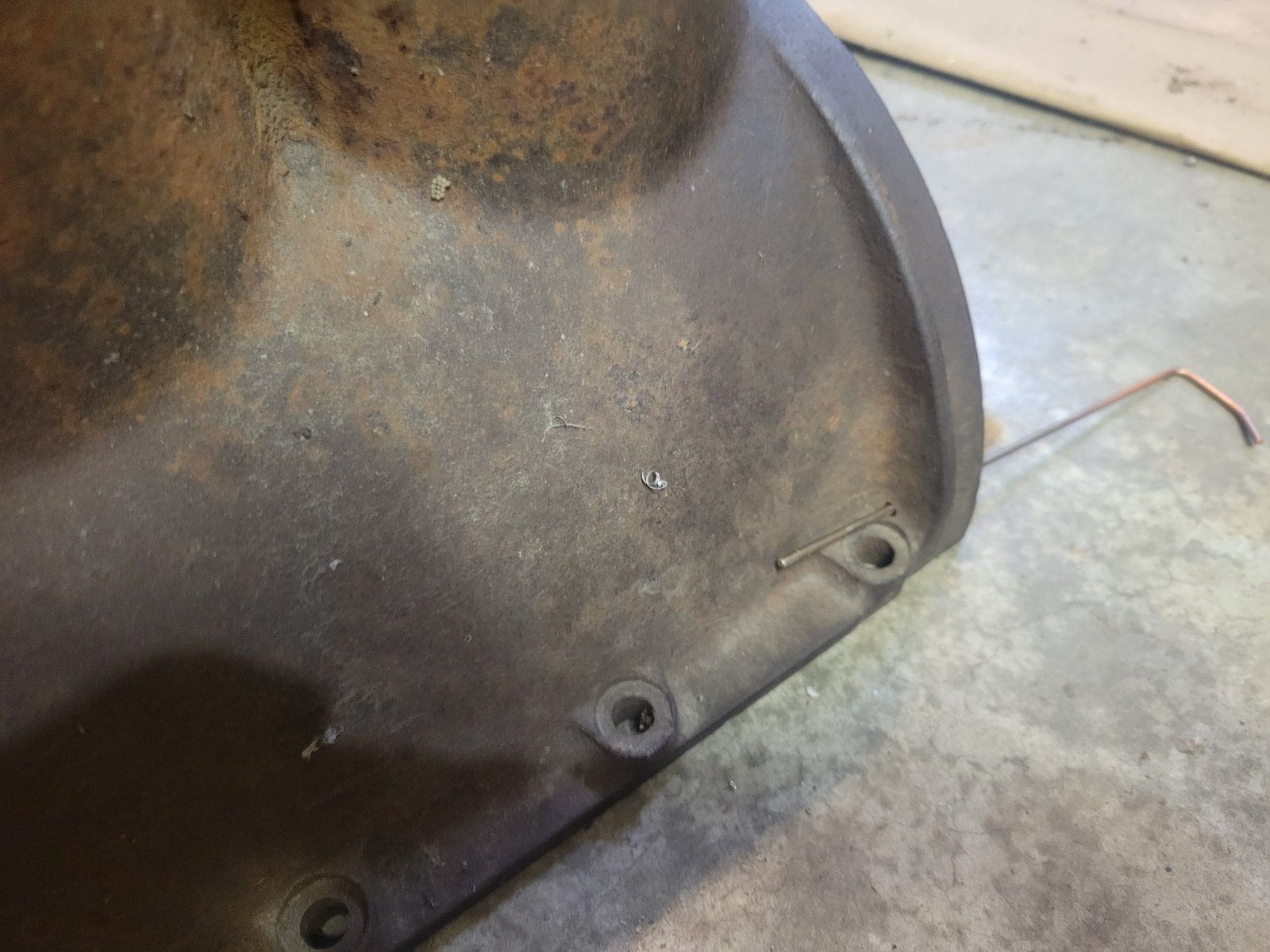

Will, right next to the area you described is the spot where sometimes the bottom bolts that mount the mag ring are open to the inside. If you don't have a field coil that maybe your problem. Permanent fix is pull the motor and install a bolt. Quick fix is clean the hole from the outside and fill with silicon.

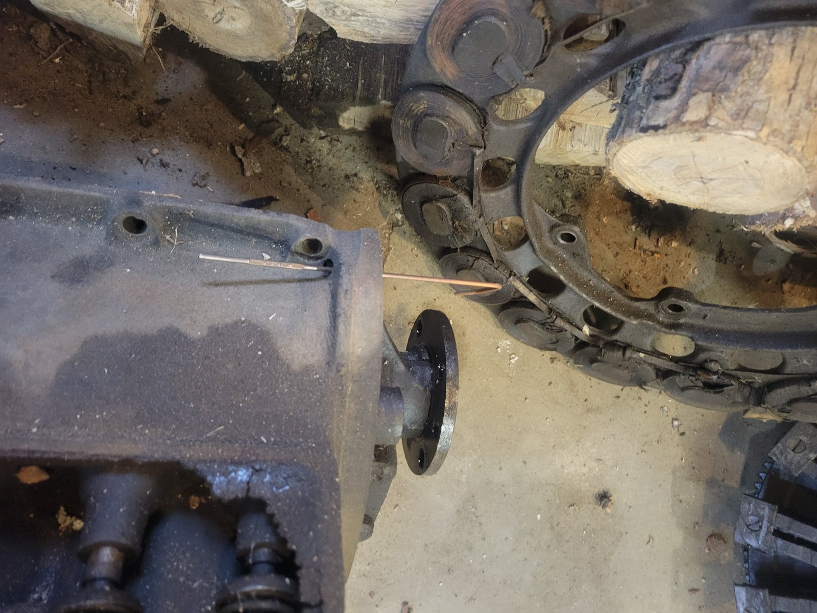

This could be your problem.got10carz wrote: ↑Tue Mar 05, 2024 1:12 pmWill, right next to the area you described is the spot where sometimes the bottom bolts that mount the mag ring are open to the inside. If you don't have a field coil that maybe your problem. Permanent fix is pull the motor and install a bolt. Quick fix is clean the hole from the outside and fill with silicon.
You need to clean & dry up the area to determine the EXACT point(s) of leakage.
The spot where the top back of the motor mates with the hogs head is a typical leak spot especially in the corners due to the "felt" or whatever seal slips out of place during the HH install.
A good, permanent fix is to use a shop vac to suck into the void some ultra black silicone.
Procedure as follows. If your motor has a single valve door, seal around the throttle rod @ both sides of the block with rags.
Place the shop vac hose in the oil fill. While running the vac, spray some brake clean in the suspected area, The brake clean will suck thru the void & clean it. Apply some ultra black onto the spot. Allow some to be sucked in. Stop the vac. Let the silicone set over night. Run the motor the next day.
If there is still some leakage, repeat the process.

In a case like the one in Steve's picture, it looks like you could make a plug by cutting a bolt of the proper thread and cutting a screwdriver slot in it and putting some sealer around the threads and screw it in far enough to clear the nut for the crankcase bolt. That would make a permanent seal without having to pull the engine.

Will
Topic author - Posts: 192
- Joined: Wed Jan 09, 2019 5:58 pm
- First Name: Will
- Last Name: Copeland
- * REQUIRED* Type and Year of Model Ts owned: 1915, 1919, 1923 TT
- Location: Melbourne Florida
Re: Oil usage
I think I got it fixed. I used the vacuum idea that John mentioned and it seems to be working just fine. Thank you john for the idea. The only difference is instead of silicone I used a sealer that is used for aviation purposes. I have found it works much better that silicone's on just about everything. Of course it costs more. If anyone is interested its made by Permatex and called Permatex Aviation. I use it a lot for marine applications. Its a bit of a sticky mess to use and is non hardening so it stays a sticky mess but you only use a little on joining metals. Thank you everyone for your help.
As Tom Sellick told Marston in the movie Quigley Down Under, I told you I dont have much use for handguns, I never said I didn't know how to use them!
- Posts: 5273
Re: Oil usage
I have/use aviation permatex for other applications, like fuel line fittings.Will wrote: ↑Wed Mar 06, 2024 1:21 pmI think I got it fixed. I used the vacuum idea that John mentioned and it seems to be working just fine. Thank you john for the idea. The only difference is instead of silicone I used a sealer that is used for aviation purposes. I have found it works much better that silicone's on just about everything. Of course it costs more. If anyone is interested its made by Permatex and called Permatex Aviation. I use it a lot for marine applications. Its a bit of a sticky mess to use and is non hardening so it stays a sticky mess but you only use a little on joining metals. Thank you everyone for your help.
I dont think it is as well suited as a void filler.
Glad you have your leak under control.
Will
- First Name: Will
Re: Oil usage
John, Any other day I would be in 100% agreement with you. Giving the Model T engine is a non pressurized system I think it should work out. I drove the T ten miles yesterday with not so much as a drip. When I go the the show Saturday I will stop every few miles and check. I will still bring a gallon of oil with me just in case. It will be around 120 miles round trip. This would be the furthest away show the I've ever attended. I would not be going to this show if they hadn't come to my door and personally requested my car. Plus it supports a cause that my wife and I support. I will let everyone know how it works out. Again, Thanks for the idea.
