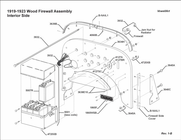

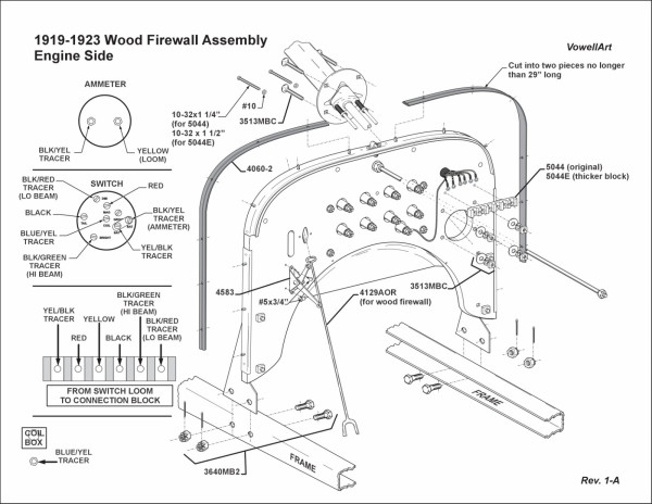

Running out of assemblies to do, so I thought I'd start in on putting the car chassis together assemblies, of course starting with mine (it's the one I know the best). Sooo, I'm starting with the Wood Firewall and since my car is a 22 and it is my understanding that the Low Cowl Wood Firewall ran clear through 23. Now, there are some 23's that have a metal Firewall, but as I understand it they were replacements for the wood ones that were discontinued in the 23 model year. Doesn't mean I'm not going to draw both the metal replacement Low Cowl Firewall and the metal High Cowl Firewall too, but first I thought I'd do all the wood ones and then get to the more "modern" ones. Funny place to start I suppose, starting with the end years, but I've got to finish up the 17-18 non starter firewall assembly as well as the 15-16's firewall assembly. And there I'm kind of running aground. So, if anybody could send me some pictures of 1914 thru 1909 Firewalls, that would be very helpful and much appreciated.
I thought since I had the engine side I might as well put in a reference to where the Switch Loom goes from and to where it connects to the Connection Block. Now some of you might wonder why the engine compartment loom isn't shown, welll, that's because there's no Engine in this drawing. When I drop the engine into this part of the frame drawing, I'll include that loom and where all the little wires go. I am approaching this very much like we're putting a running Chassis together, this seemed to me to be the only logical approach, which also means I've got to do a Frame drawing too. I've got quite a few drawings in various stages of completion, usually waiting for further information from somebody and then there is those blasted "Round-2-Its" which seem to be rarer than hens teeth....but I'll get there ;) ....eventually. :lol:
Fun never quits!

Martynn, a couple of things I noticed are at variance with what I know of Canadian cars, which may be different to US production. In the cabin side drawing you show the firewall to frame brackets having square holes to accept the square under the head of the bolts. On the original old car I am working on at the moment, the bolts go in the other way round. They have a larger than usual head. This head is set into a relief in the wooden firewall so the firewall can sit flush against the body. The brackets are on the front side of the firewall. The holes in the brackets are round, not square.
From the engine side, there is a half circle relief in the firewall where the rain gutter terminates to accommodate the hood side panel hinge pins.
Both the steering column flange nuts and the frame to firewall bracket nuts are hex rather than square. Here in Australia, Whitworth nuts fit, but they are a little bigger in the hex. I had to order UNC nuts to get the correct 1/2"across the flats.
Hope this helps,

What Allan said. I had to fight with one of those firewall mounting bolts when the darn thing just spun in the firewall. The square nut was a bit buggered up and the nut would not come off, not a fun time to be sure.
The '19 and early-20 wood firewall had the square cutout mounted on the firewall and a single wire running from the cutout through a hole to the top right (looking from the front to the back of the car) of the slots for the idle and choke, some have shown it above the slots. Later the cutout was moved to the generator (still square a cutout) with a single wire running from it through the same hole mentioned earlier.
The terminal block was also a 5-terminal block, with there being 2 different versions, the earlier one being thicker and having rounded ends and the later being the more common squared off end terminal block, running until about 1921. I have attached some links to threads from the old Forum that show some of these features:

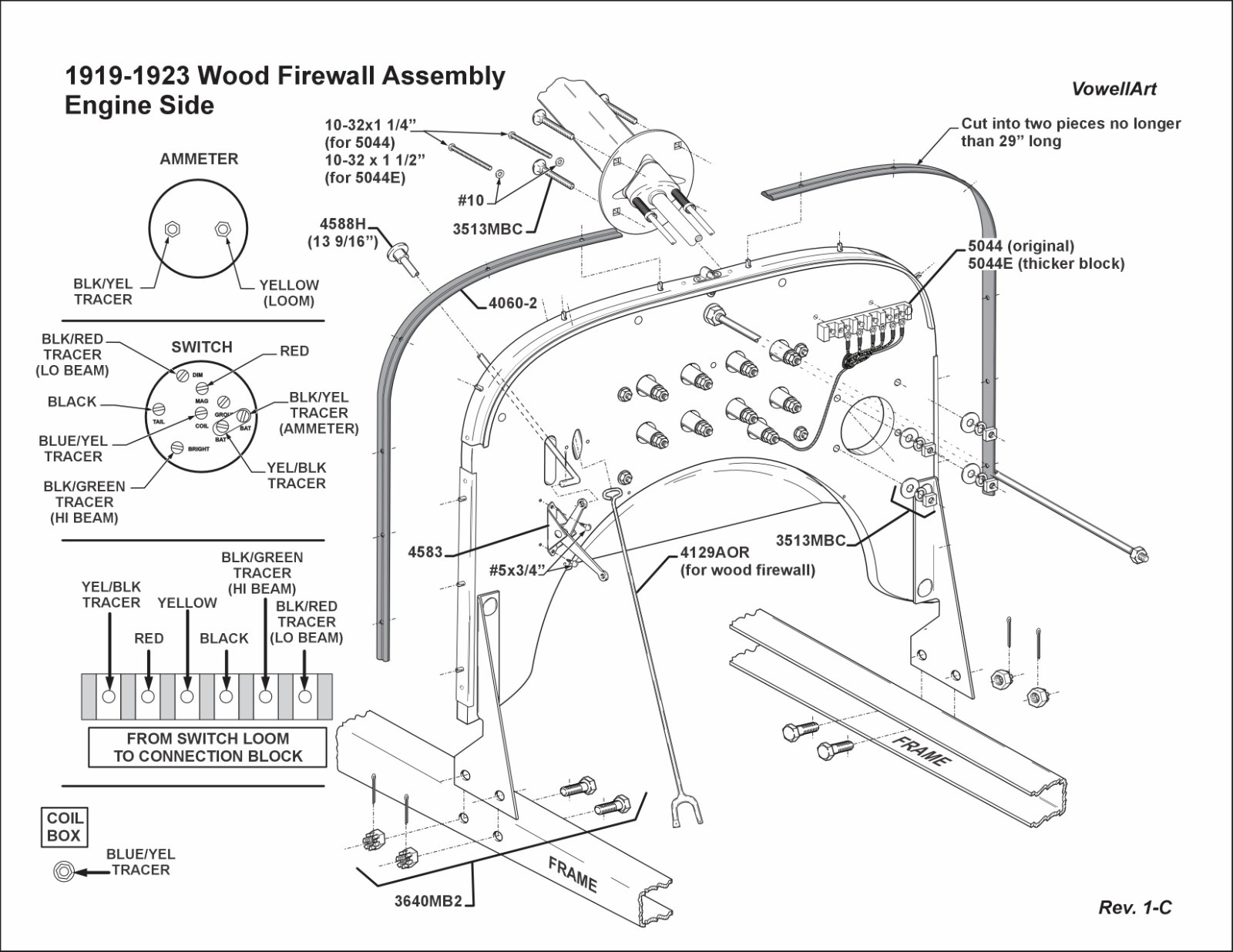

Ok, made some changes, you're right the Firewall brackets should be on the engine side and not on the interior side. Don Lang caught it and I couldn't believe I missed it entirely, anyhoo, also forgot to add the Dash Choke Rod and had to change where the Dash Wiring Loom comes through the Firewall...it's one of those times where the fun truly never quits.

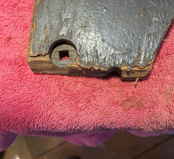

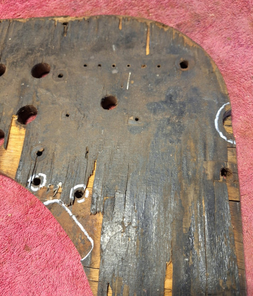

Martynn here are a couple of photos of some details from an original firewall from a 1922 Canadian RHD car.
Notice the chamfer and two mounting holes to accommodate a magneto horn, not used on this car. Note the relief on the side for the hinge on the hood. This is between the rain gutter piece a d the tacked-on side flashings.
The second photo shows the relieved firewall mounting bolt hole.
I do not know if these details apply to US production.

Small correction to some lines that were in the wrong place and or not completed.
I haven't gotten round to the metal Firewalls yet, concentrating on all the wood ones first (and there are a bunch of those). But I can if I had pictures of one. The Low Cowl Metal Firewalls of 1923 are a might different in their hardware from the woods one. That said, if anybody has a nice clean 1923 Low Cowl Metal Firewall I'd like to see pictures of it so I can draw it. I need a full front, back, side and top. And since you were mentioning the Spacers, I need pictures of those too. ;)
