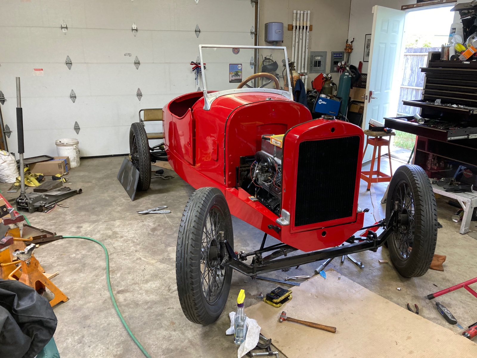

Finally some progress. Motor running just need everything else. Sorry for the mess.
Andy

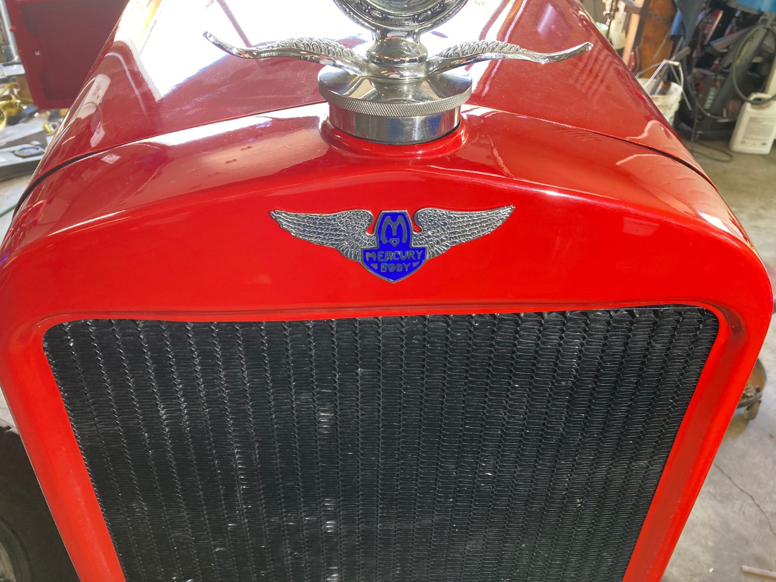

How about a recent picture of that beautiful Mercury body Andy? Does that ferocious red add horsepower?

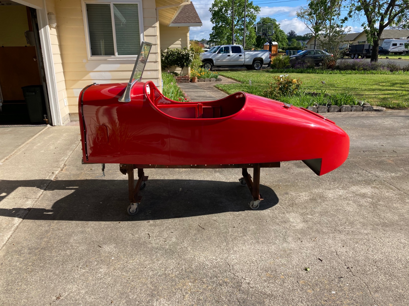

Steven, the body is currently covered for safe keeping while I finish the chassis. Here’s a photo of the body mocked up on the bare chassis.
The red paint adds about 13%.
Andy

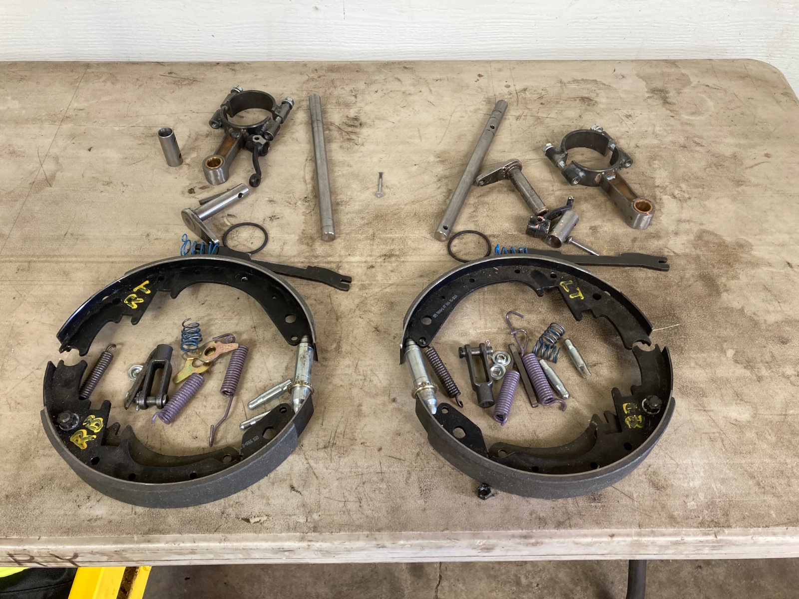

Post by AndyClary » Sun Mar 24, 2024 10:29 pm
Now that the motor runs I have to remember where all this brake stuff went.
Andy

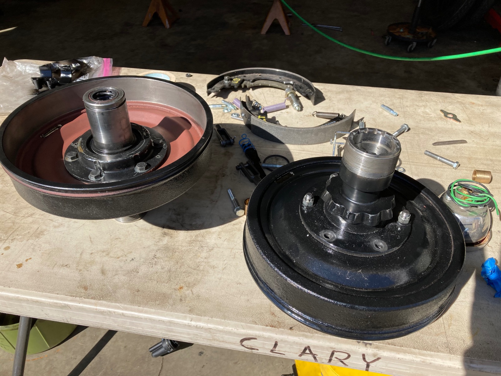

Post by AndyClary » Tue Mar 26, 2024 6:37 pm

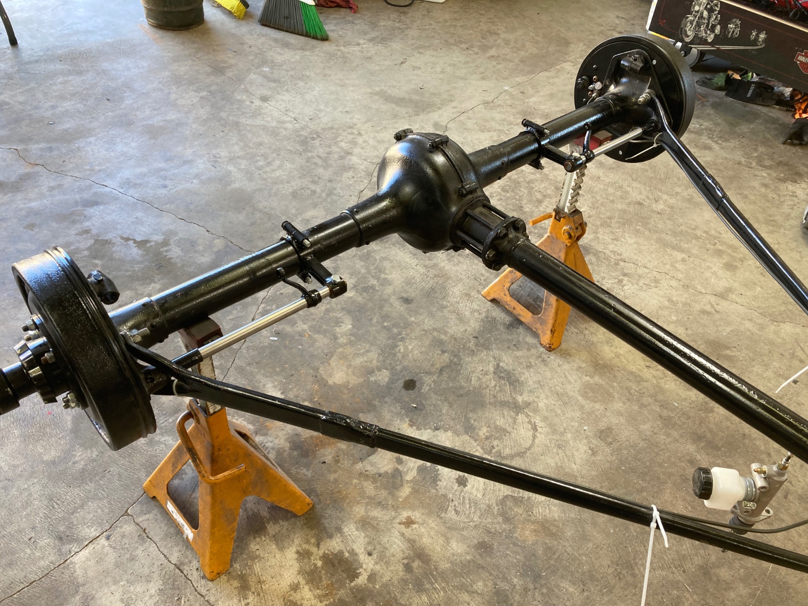

Here is a mostly assembled brake and a shot of the cast drum sandwiched between a McEachern safety hub and a Pharis buffalo hub. I got the brakes from Dan McEachern, he makes the required modifications to work with a large drum rear axle.
Andy

Post by Craig Leach » Tue Mar 26, 2024 10:40 pm
Yes now I recognize those, not having the other parts threw me off. Thanks.

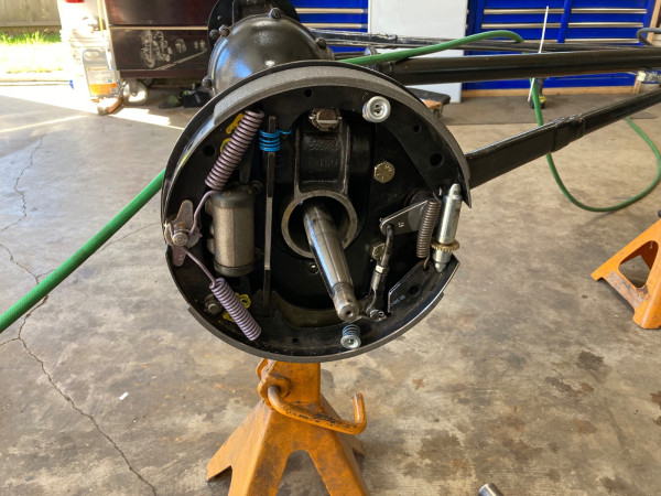

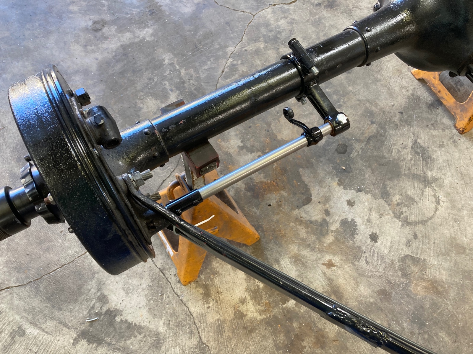

Post by AndyClary » Tue Apr 02, 2024 7:13 pm
Finally got around to finishing the brakes, still have to bleed them but I think it will be easier with the master cylinder mounted. Finished moving the brake levers inboard. Wanted to keep stuff passing through the skirts to a minimum and I hate brake rod rattle
Andy

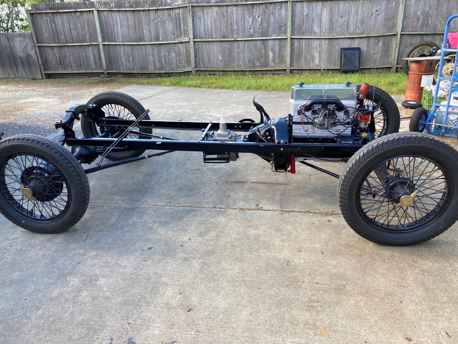

Post by AndyClary » Fri Apr 26, 2024 7:12 pm
We’ll I made it through all the little chassis details I had to get done before installing the body. I may have gotten carried away because nothing on this car is a bolt on. But, here it is half clothed.
Andy

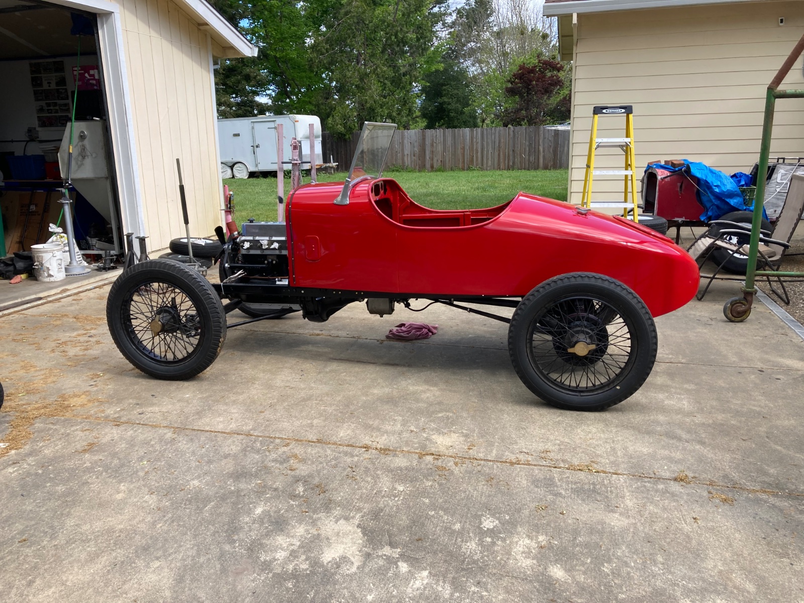

Post by AndyClary » Sat May 04, 2024 7:15 pm

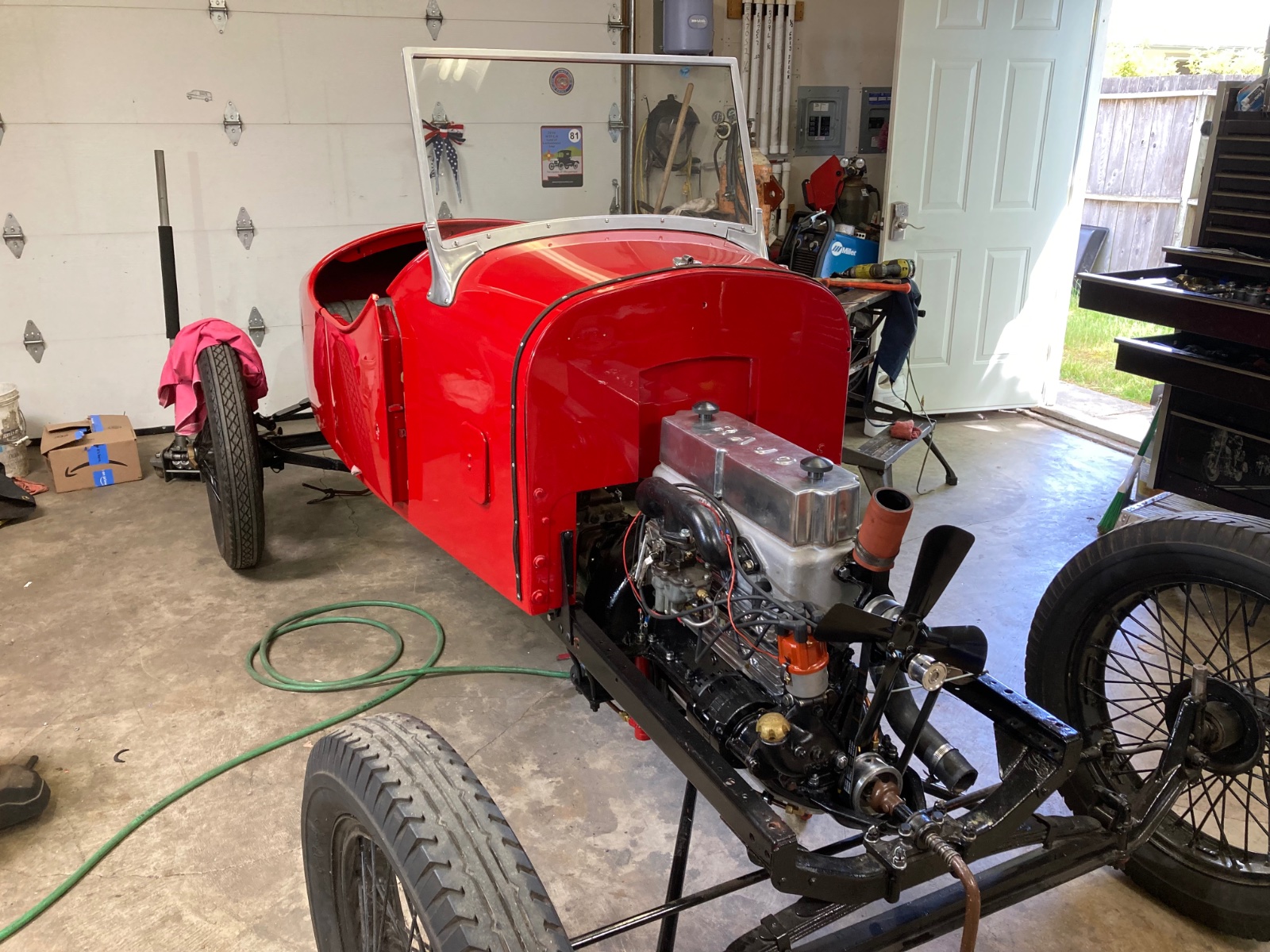

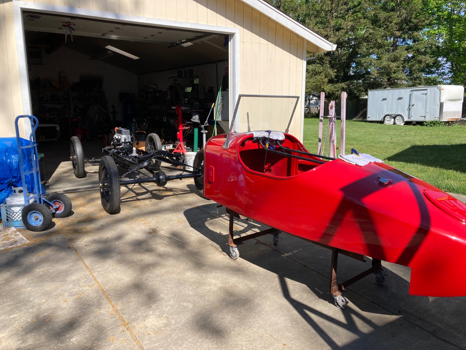

Got quite a bit done this week. I have to get the hood on yet and a couple body mounts redone. I moved the body back so the #4 exhaust tube would clear the firewall. Beyond that I’m down to fuel system, exhaust and electrical. If I can get two of those done this week I’ll be in good shape.
Andy

Post by Stephen1915 » Tue May 14, 2024 2:41 pm
Andy, what are the drums and shoes from? Thanks!
AndyClary
Posts: 913
First Name: Andrew
Last Name: Clary
Location: Usa
Re: Mercury Update
Post by AndyClary » Tue May 14, 2024 5:31 pm
Dan McEachern makes the brake kit. We’ll thought out, requires large drum rear axle.

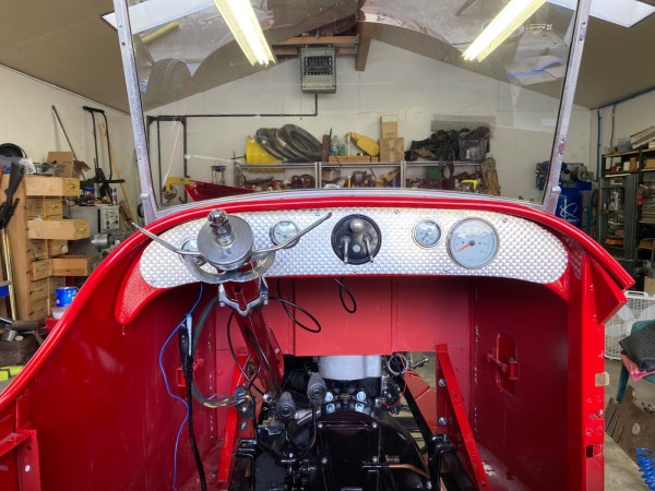

Post by AndyClary » Thu May 16, 2024 9:30 pm

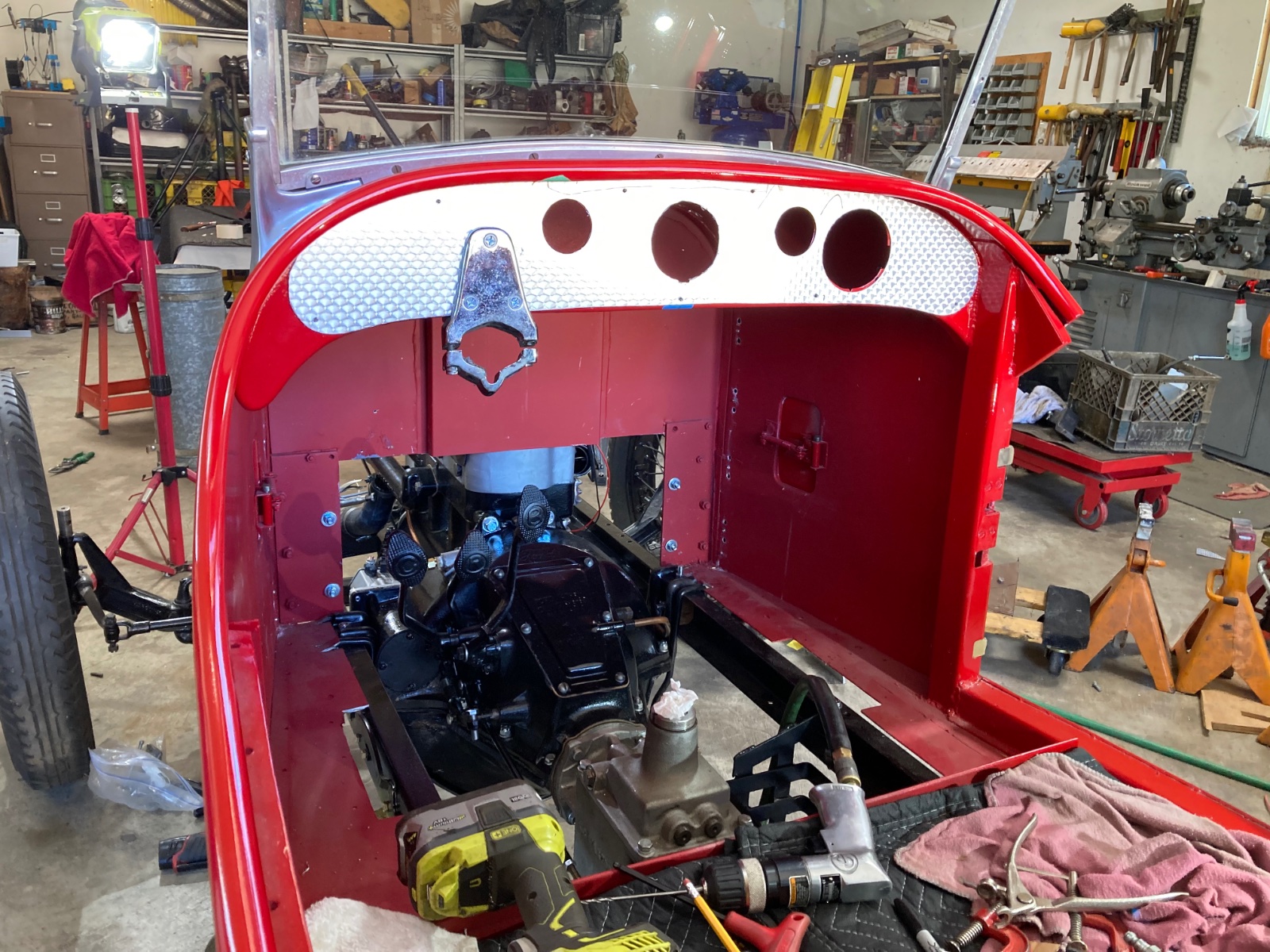

Finally did something that shows, got the gauges in and the dash is done. Unfortunately I discovered that none of the old floorboards will work now so I get to build new ones. Floors are always a pain in the a$$.
Andy

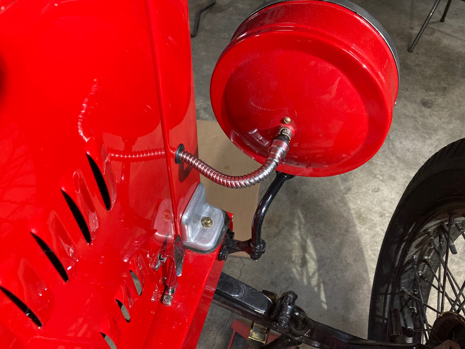

Post by AndyClary » Tue May 21, 2024 11:08 am
And sometimes you have to steal something from the Model A guys. I turned the headlight thimble down to fit into the Model A ferrule. They’re just long enough.
