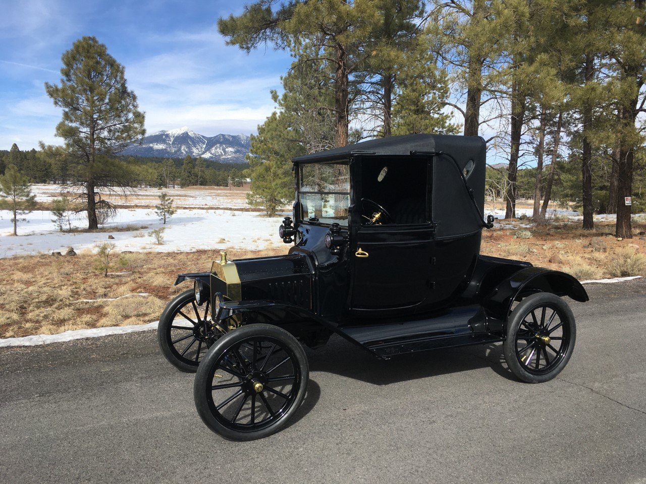

I have a 1917 and a 1918 coupelet, and the window frame is unique in that the bottom of the frame has a channel that has the capability of holding the window up. The channel goes over the "blade" attached to the bottom of the door window and quarter window. Are you missing the window frames? Russ Furstnow

I know of no "window channel" that was used on any coupelets from 1915-1919. The window rode in the wood channel of the doors and had some "anti" rattle rollers when the window was up. I hope this helps, Russ Furstnow
