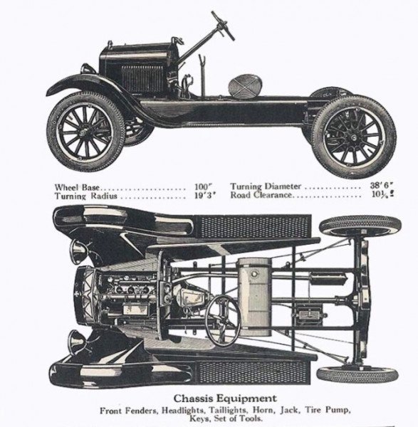

I believe the pre-1926 gas tank mounting holes on the frame remained into the 1926-27 models. I see them on my two 1926-27 frames. Remember, Ford still offered a chassis, as shown in the picture below.
Factory Chassis.jpeg (71.75 KiB) Viewed 1268 times

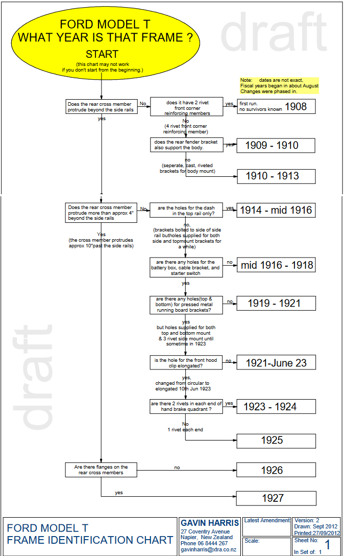

Frame flow chart (to read it better either down load the PDF (save it too) or click on the image & then the + )
https://www.mtfca.com/discus/messages/8 ... 873486.pdf
From the MTFCA Encyclopedia
