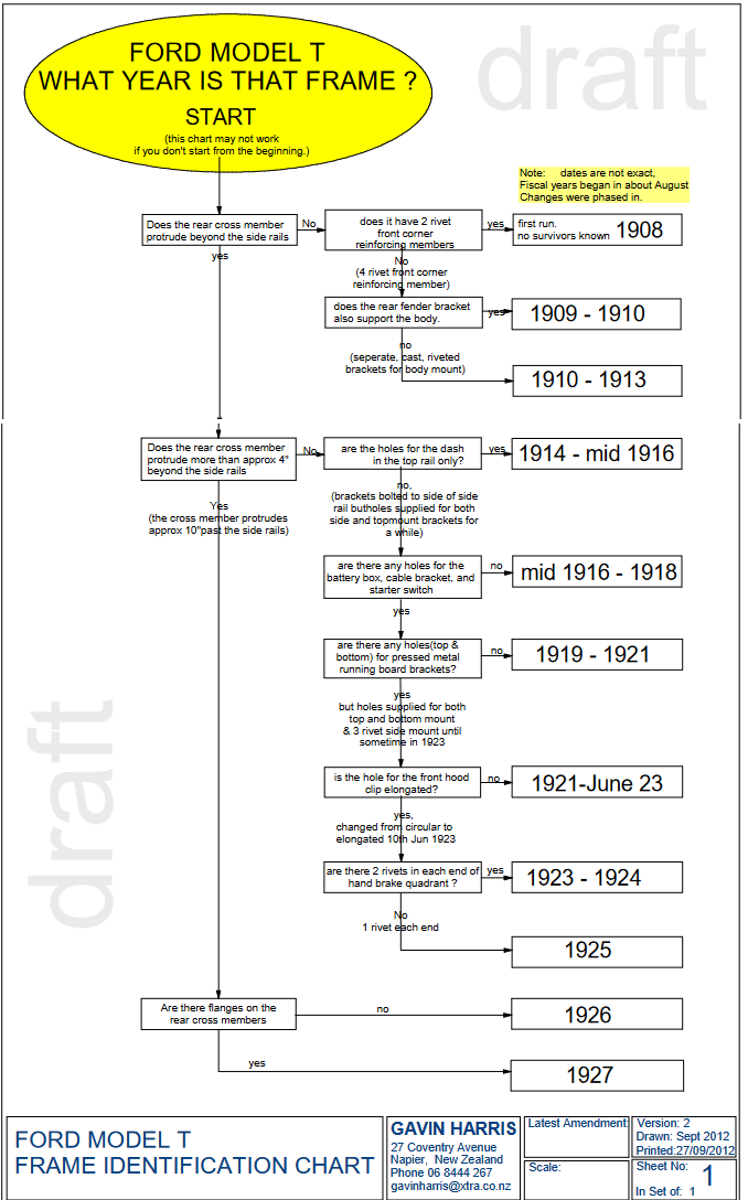

Frame flow chart (to read it better either down load the PDF (save it too) or click on the image & then the + )
https://www.mtfca.com/discus/messages/8 ... 873486.pdf ---
From the MTFCA Encyclopedia
Frame Manufacturers

Thanks for all the great info. It appears that I have a 26/27 frame, although the tank and brackets are round, that is what was on the depot hack when I got it and I will frame my ambulance body around it.
Thanks for confirming.
