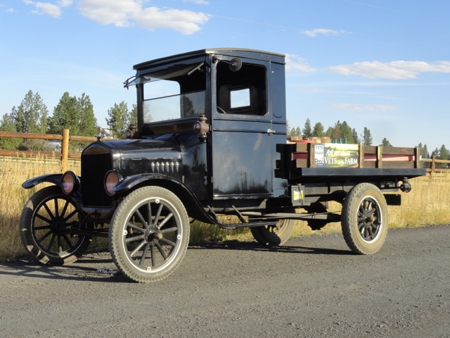

Re: What is top speed on TT truck?
I think 13-18 mph is about right for stock...maybe 22 wound out.
I have a High Speed gear swap planned and a warford waiting for mine. With my rebuilt, not so stock motor...I should be able to keep up at 55+.

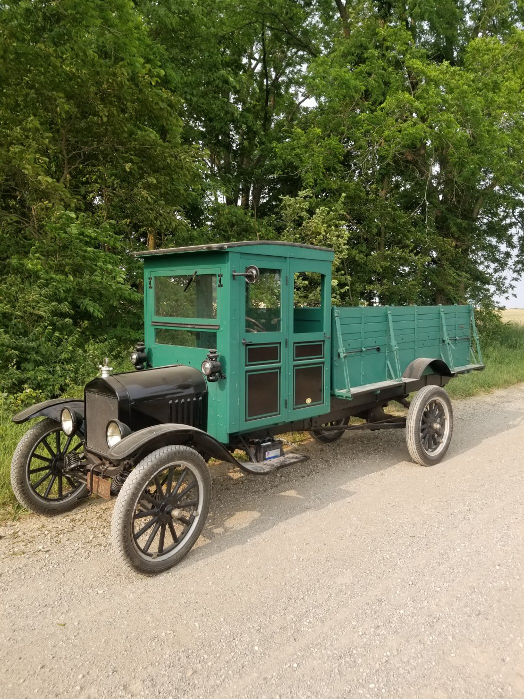

My 23 TT has chicago 3 speed and high speed gear set in rear axle with a very stock engine. I had it to 42mph on a flat run once just to see what it could do. And only once.

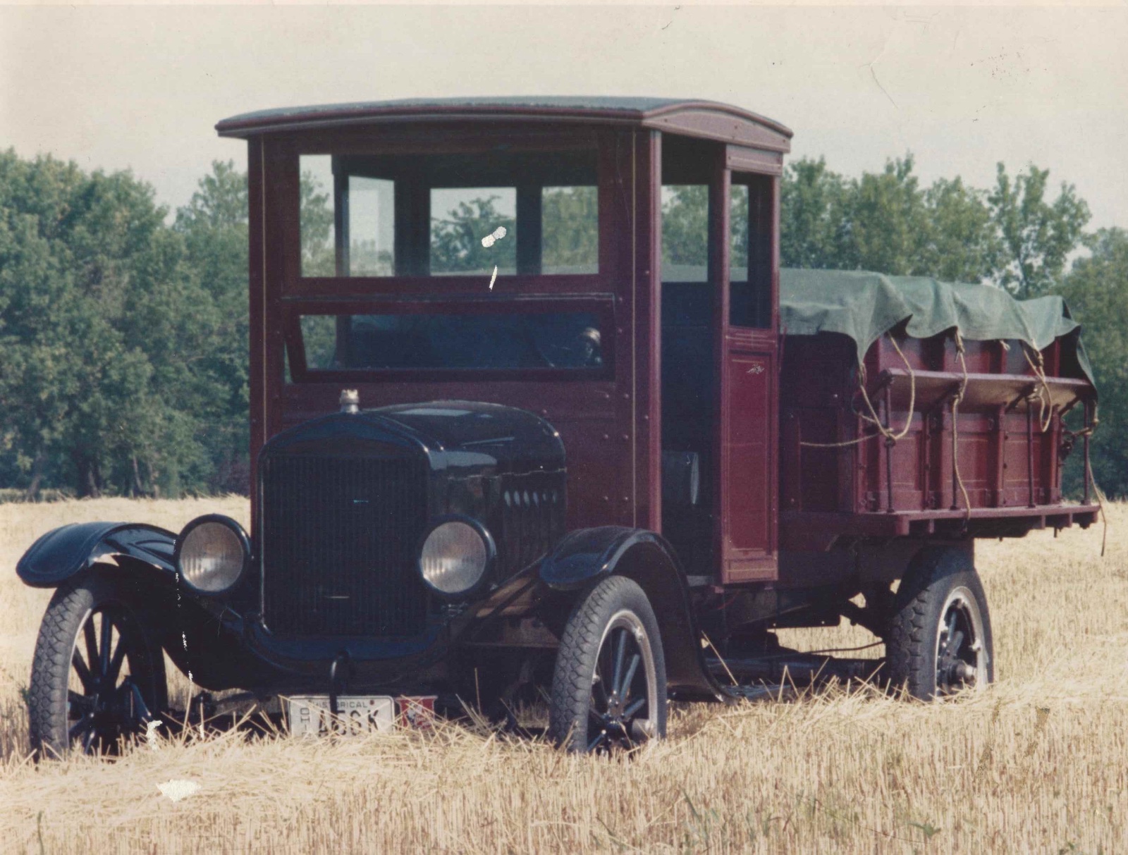

I’ve owned my 1924 TT farm grain truck since 1968. It is a stock TT with the addition of a Ruckstell two speed rear axle. When I took possession of it it had the 7-1 rear axle gears, and it was slow. The 18 mph others have mentioned is about right. In 1973 I found and installed the optional Ford 5 1/6 to 1 high speed rear axle gears. It made a big difference in the performance of the truck, and it’s cruising speed increased to 24 mph. Still, that’s pretty marginal on today’s roads which are dominated by drivers who do not understand the speed limitations of a TT.
Respectfully Submitted,
Trent Boggess

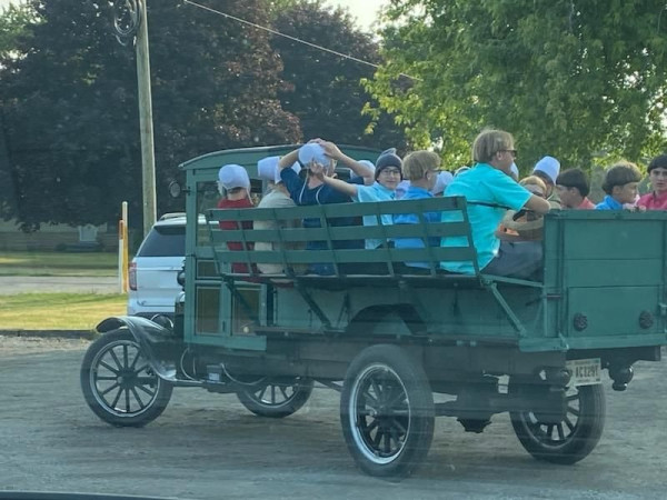

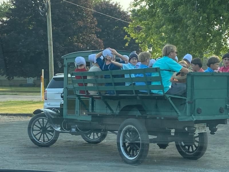

25 to 28 is a nice cruzing speed in mine. I had 28 friends in it going for icecream and 20 mph was a comfortable speed even with hills.

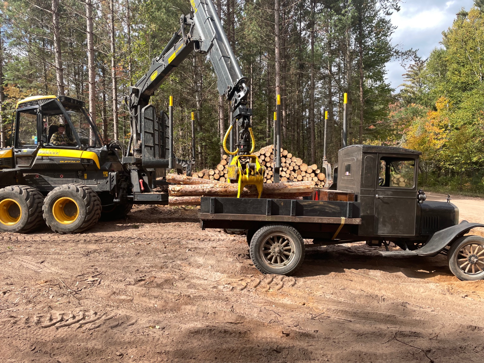

The TIME MACHINE has a high speed rear end and a TwinHigh Hi-Lo auxilliary transmission with 33% overdrive. I can cruise all day at 30-32. I have had it easily hit 42 on a looong slight downhill grade on an empty back highway.
BUSHMIKE
- Posts: 356
- Joined: Tue Nov 01, 2022 6:46 am
- First Name: Mike
- Last Name: Cushway
- * REQUIRED* Type and Year of Model Ts owned: 1925 TT, 1926 TT, 1926 TT
- Location: Trout Creek, MI
Other than the TwinHigh, my TT engine and driveline are stock.

This is what I'm aiming for with mine..Burger in Spokane wrote: ↑Sat Apr 06, 2024 12:36 amJust saw this thread ....
My TT came to me as a standard "farm gears" sort of truck, shaking itself apart
in the high teens range.
An engine rebuild with a careful balance, C-race cam, Z-Head, Scat crank, and
a high flow carb (have used several), and express gears out back have given me
run-out-of-power top speed of right about 50, and comfortable cruising at 35-40
all day long. I have a Lincoln 3-speed that should give me 30% gearing, which the
math says will make a top speed around 65.
Making speed is one thing. Stopping a TT at those speeds in an emergency is another !

The TT on the hill at Long Beach was mine at the time. It had a Langbein auxiliary Transmission. Originally it was a 2:1 under. During restoration and rebuild of the gear box I flipped the gear set internally making it 2:1 over. I squeezed 8:00x20 tires onto the rear rims. I could go down the road 40mph with ease. It had auxiliary outside brakes. I sold it in 1969. I often wonder who has it now."There used to be a Ton Truck that liked to run in the "Long Beach Model T Club's Signal Hill Climb"
It was never the fastest vehicle up the hill. See photo of a C-cab on the hill at: https://www.lb908.com/post/long-beach-m ... hill-climb
