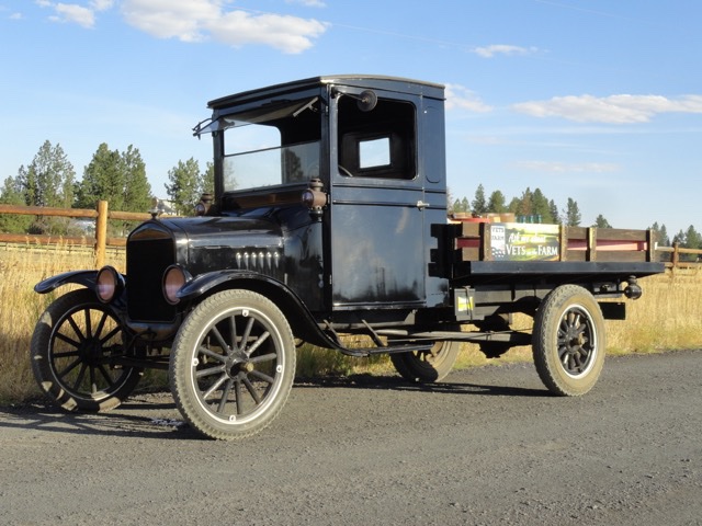

Burger in Spokane wrote:
Sat Apr 06, 2024 12:36 am
Just saw this thread ....
My TT came to me as a standard "farm gears" sort of truck, shaking itself apart
in the high teens range.
An engine rebuild with a careful balance, C-race cam, Z-Head, Scat crank, and
a high flow carb (have used several), and express gears out back have given me
run-out-of-power top speed of right about 50, and comfortable cruising at 35-40
all day long. I have a Lincoln 3-speed that should give me 30% gearing, which the
math says will make a top speed around 65.
Making speed is one thing. Stopping a TT at those speeds in an emergency is another !💥

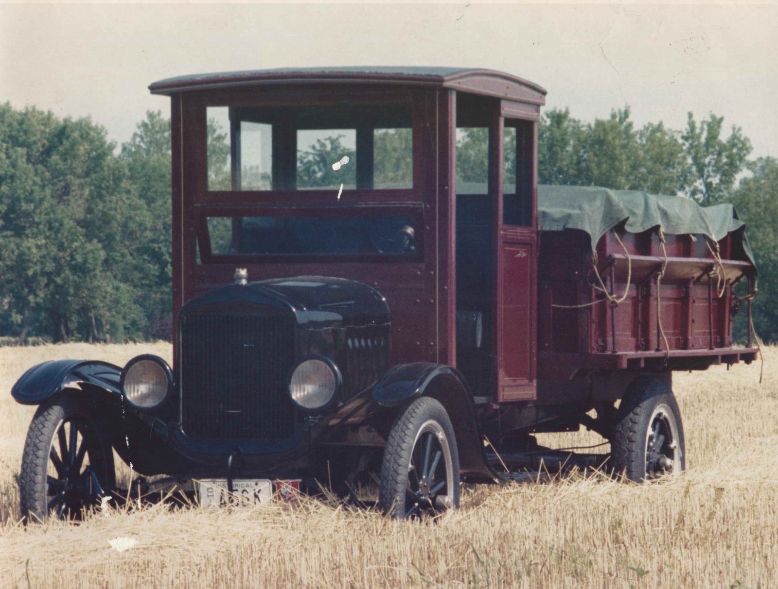

"There used to be a Ton Truck that liked to run in the "Long Beach Model T Club's Signal Hill Climb"
It was never the fastest vehicle up the hill. See photo of a C-cab on the hill at: https://www.lb908.com/post/long-beach-m ... hill-climb
The TT on the hill at Long Beach was mine at the time. It had a Langbein auxiliary Transmission. Originally it was a 2:1 under. During restoration and rebuild of the gear box I flipped the gear set internally making it 2:1 over. I squeezed 8:00x20 tires onto the rear rims. I could go down the road 40mph with ease. It had auxiliary outside brakes. I sold it in 1969. I often wonder who has it now.
