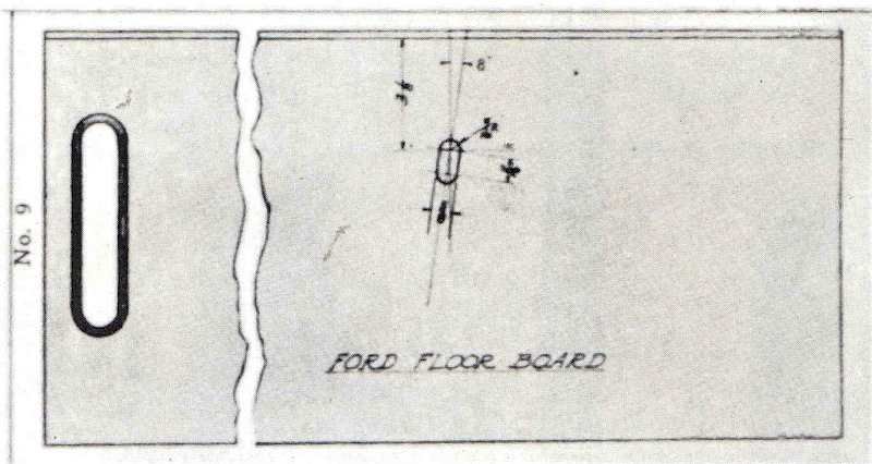

So I picked up a Ruckstell axle this weekend to put in my car, and it seems to be good enough to just throw in once I give it a quick service, but I just realized that I need to cut a hole in my floor for the shifter, and it looks like it might be a bit annoying to measure for. Just wondering if there was a pattern or measurements already out there I can use to cut the hole in the right spot

Here you go. I used this on my '24 and it worked perfectly. Note that the hole is cut at an angle, not straight for-and-aft.

Depends on the location of the shifter and the year and body style of the car. One way would be to get some stiff cardboard and cut half to fit behind the shifter with the hole cut out to fit the shifter. You will need to move the shifter all the way forward as it would be in high range and all the way back as it would be in low range. Then cut the hole in the wood to allow the lever to move all the way in each direction. The mat is easier because all you need to do is make a slit going front to back and it will cover the hole in the floorboard. At least that's the way I did two of mine. The third one had the Ruckstell when I bought it.

Ah, good point. I've got a '26 coupe and the normal Ruckstell shifter on the back of the trans if anyone has a template for that, but otherwise I'll use the cardboard. Been long enough since I needed to do something like this I forgot about CAD (cardboard aided design)!

Id personally be leery about using a pattern. I suspect some year or body style floorboards may be different. Also different style shifters and varying lengths of rods connecting the shifter to the shift lock may require placing th hole in a dfferent spot. Best way IMHO is assemble the shifter and take measurements.

Not all Ruckstell hardware is the same, even it it's made by Ruckstell!. Make your own pattern, and when locating your final layout, use the same reference point at all times. Also, there was never a metal plate to go around the shift lever. When Eaton took over, they made a much better set up.
