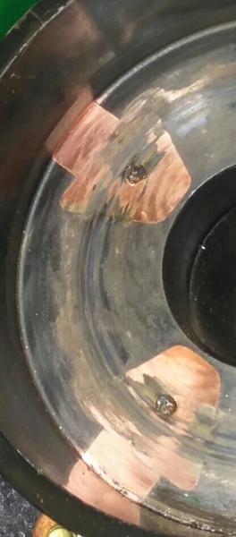

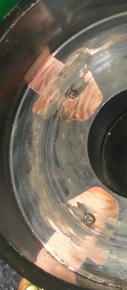

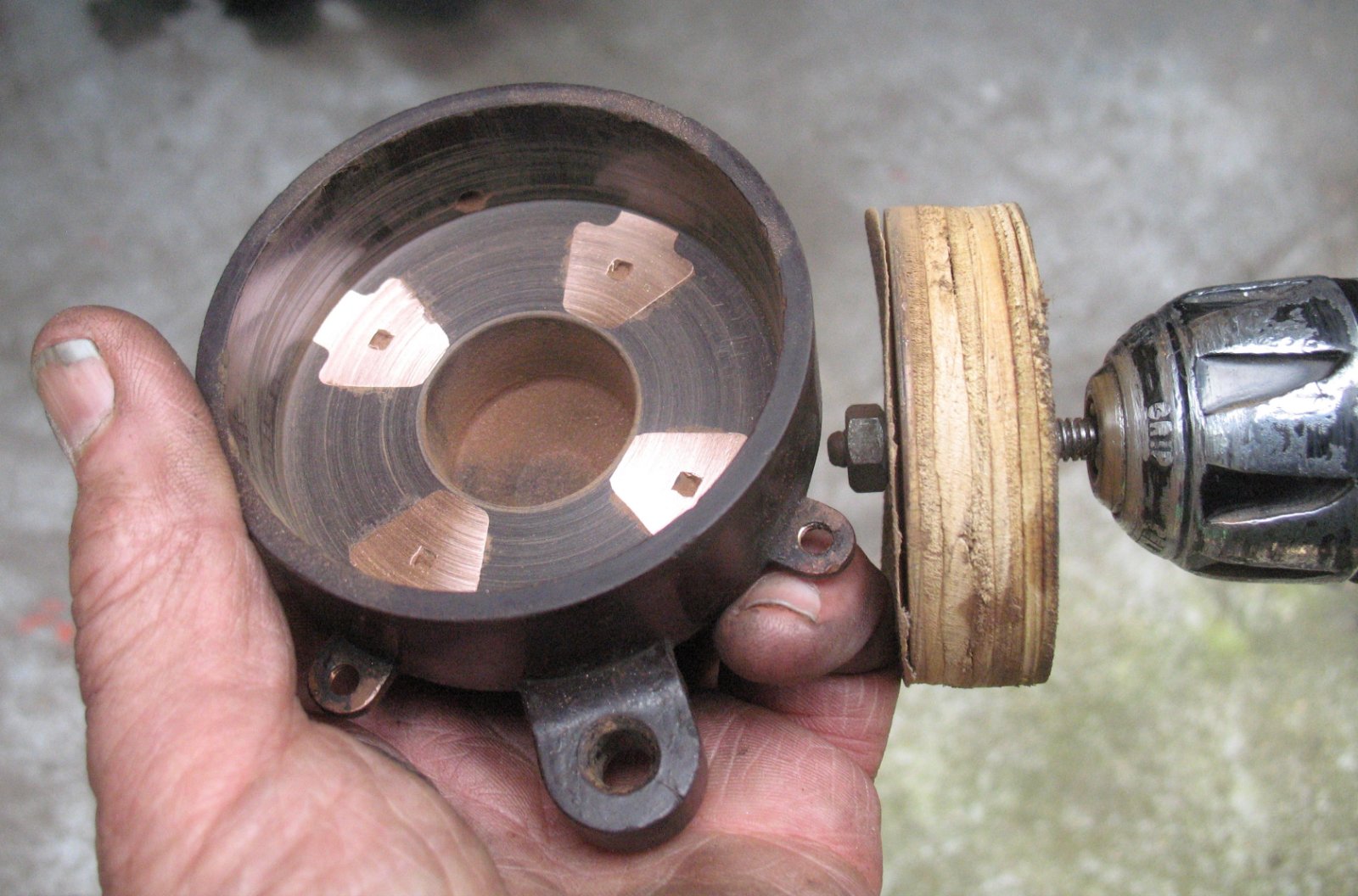

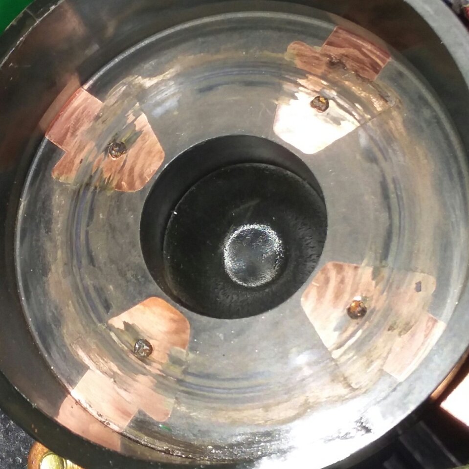

Your New Day repop looks like Hell. You want not only to clean out the nasty-looking stuff, but also flatten it down enough to remove the divots. That may not cure the skip, but a bad timer can do it. It's hard to believe that has only 400 miles on it. Makes me wonder if there's something seriously wrong with the brush.
Even an original New Day can require a makeover.

Well, there's your problem! What Steve said.
This method works reasonably well Adjusting all 4 coils for the same average electrical current IF ALL 4 coils are EXACTLY the same electrically and mechanically.
Once you get your timer woes fixed, get your coils properly adjusted for equal and consistent firing Time using an ECCT to enjoy optimal engine ignition Timing performance.
A Novice with the correct tool can achieve results a seasoned expert can only hope to impervising with tools designed for another purpose. The ECCT directly measures the time a coil takes to fire spark with 0.000020 second accuracy. All other coil test tools measure average coil current (Amperes) flowing in the coil while firing hundreds of sparks. Amperes is Not time to fire spark! It's just an I direct approximation of how long each coil takes to fire spark.Coils checked by my over qualified and expert friend today on a Robo Strobe.

Steve's comment about brush condition made me look at the picture closer. The brush surface looks like it's far from being smooth based on the scraping on the timer contacts and plastic.

Looks like the timer body plastic has melted & redeposited on your contacts or some kind of lube was used like Vaseline.
I am betting this is one of them soft repop timers. Original & the better repop new days don't do this.

The wear pattern inside that new day timer kind of indicates to me at least that the timing cover needs to be centered onto the camshaft. The wear pattern offset of a circle will give erratic spark plug firing.

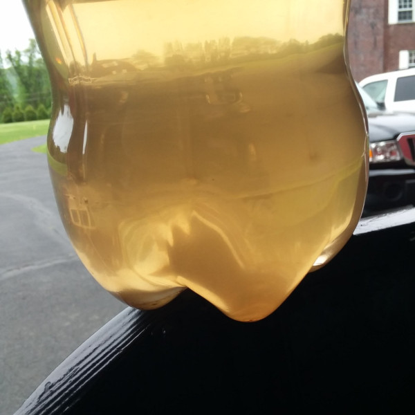

Foggy fuel isn't helping any either.

Gert the timer problem straightened out and the coils adjusted, then drain all the fuel and replace with fresh. I'd add 6 ounces of MMO and 1/2 pint of B-12 Chemtool to the fres, full tank of gas and go for a drive on the road at moderate speeds. Stale fuel can gum valve stems and cause sticking among other problems. My dad bought a new lawn mower at a Fall sale. The following Spring, he put gas he had saved over the winter in it. It ran for about 5 minutes until it stopped with a stuck intake valve. I had considerable difficulty getting the valves unstuck and the tar-like deposits removed from the valve stems and combustion chamber.

About stale gasoline:
From what I've seen and read, all ethanol gas does not decay at the same rate. Weather conditions and how it is stored can make a big difference, and some gas goes stale a lot quicker than other gas. Hot, humid weather may be the worst. But high elevation may encourage evaporation of "co-solvents" and other more volatile blend fractions, and lead to decay, hydration, and separation.

Issues all resolved... water in gas and a New Day having a "bad day." Drained the gas and refilled with fresh fuel, and I refaced the timer to clean up that mess. Car's running great again. I also regapped plugs, checked out the NH carb, and had my coils tested.
Evidently I made the mistake of putting the car away for winter without taping up the vent, and not giving the gas tank a healthy glug of MMO.
I've always done that and have never had a problem until now..... multiple lessons learned here, and with lots of kind help from friends both on the forum and off. Many thanks!
Happy motoring!
