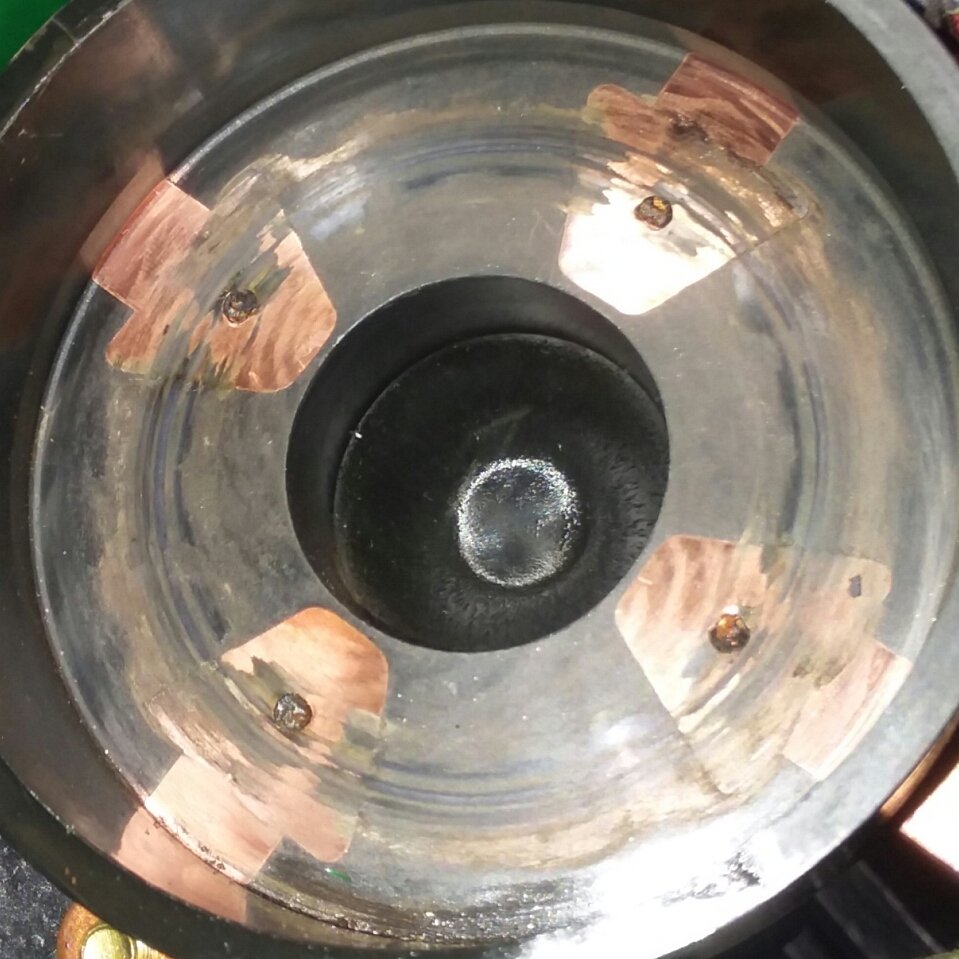

Post by Professor Fate » Tue May 14, 2024 8:25 pm
New Day having a bad day.
Dirty.
Last edited by Professor Fate on Tue May 14, 2024 8:35 pm, edited 1 time in total.

Post by Professor Fate » Tue May 14, 2024 8:30 pm
Coils checked by my over qualified and expert friend today on a Robo Strobe.
I have new plugs to swap, and a new NEW DAY TIMER to install. If. If that dosent fix it, then I'm also going to swap the NH out for a good rebuild. Draining the fuel tank is also a thought

Post by RajoRacer » Tue May 14, 2024 8:41 pm
Is that the timer that was on the car ??????????? That could definitely cause a "SKIP" !!!

Was and still is on the car. Only has 400 miles on it.
I used some 400 and 600 sandpaper to clean it up along with brake cleaner. Still runs like crap.

Your New Day repop looks like Hell. You want not only to clean out the nasty-looking stuff, but also flatten it down enough to remove the divots. That may not cure the skip, but a bad timer can do it. It's hard to believe that has only 400 miles on it. Makes me wonder if there's something seriously wrong with the brush.

Well, there's your problem! What Steve said.

Steve's comment about brush condition made me look at the picture closer. The brush surface looks like it's far from being smooth based on the scraping on the timer contacts and plastic.

Looks like the timer body plastic has melted & redeposited on your contacts or some kind of lube was used like Vaseline.
I am betting this is one of them soft repop timers. Original & the better repop new days don't do this.

Improperly adjusted coils will destroy a New Day timer VERY quickly. Even one badly adjusted coil will cause damage
New Day timers should never be oiled or greased. Oil leaking into a New Day timer will cause trouble.

Dan - can you post a photo of the front of that timer ? John might be on to something !

The wear pattern inside that new day timer kind of indicates to me at least that the timing cover needs to be centered onto the camshaft. The wear pattern offset of a circle will give erratic spark plug firing.

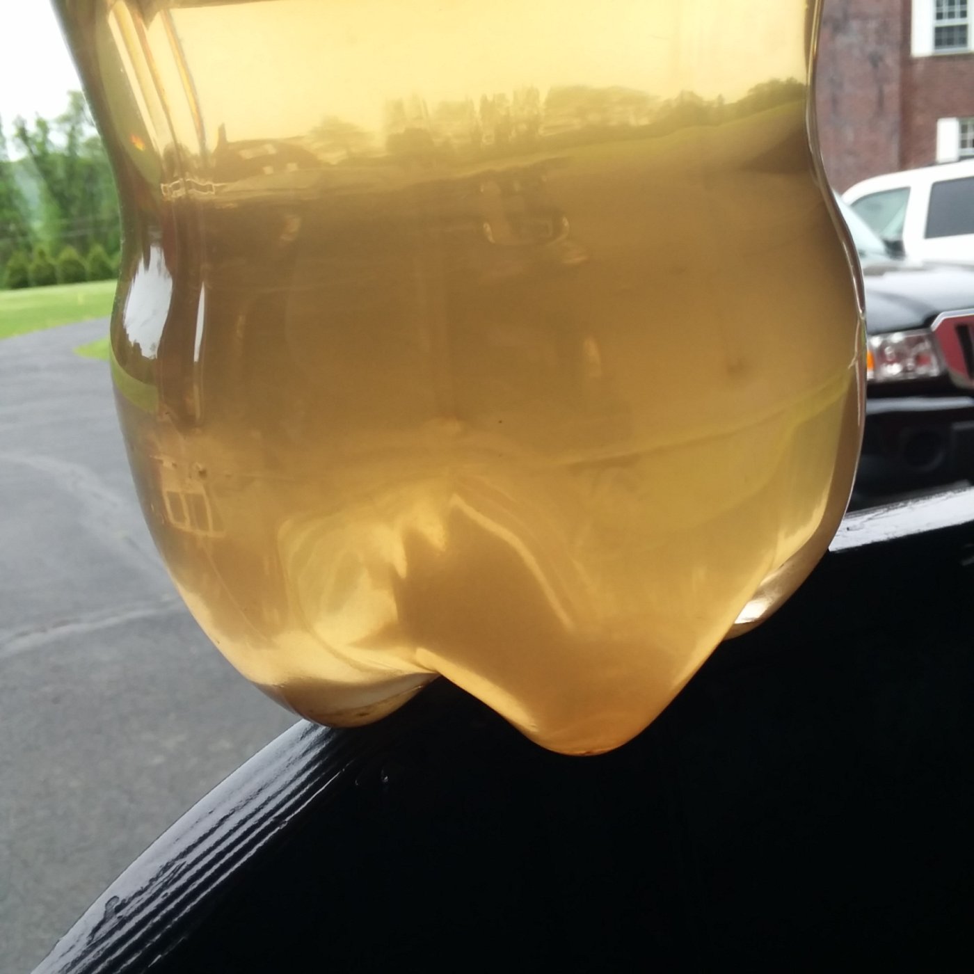

Foggy fuel isn't helping any either.
More work to be done tomorrow.....
Checked a bunch of things today. Will start it tomorrow after more work.

Gert the timer problem straightened out and the coils adjusted, then drain all the fuel and replace with fresh. I'd add 6 ounces of MMO and 1/2 pint of B-12 Chemtool to the fres, full tank of gas and go for a drive on the road at moderate speeds. Stale fuel can gum valve stems and cause sticking among other problems. My dad bought a new lawn mower at a Fall sale. The following Spring, he put gas he had saved over the winter in it. It ran for about 5 minutes until it stopped with a stuck intake valve. I had considerable difficulty getting the valves unstuck and the tar-like deposits removed from the valve stems and combustion chamber.

Issues all resolved... water in gas and a New Day having a "bad day." Drained the gas and refilled with fresh fuel, and I refaced the timer to clean up that mess. Car's running great again. I also regapped plugs, checked out the NH carb, and had my coils tested.
Evidently I made the mistake of putting the car away for winter without taping up the vent, and not giving the gas tank a healthy glug of MMO.
I've always done that and have never had a problem until now..... multiple lessons learned here, and with lots of kind help from friends both on the forum and off. Many thanks!
