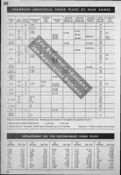

The heat range is probably different. Here is a Champion cross reference chart that includes their 1/2 inch pipe thread plugs, but doesn't show where the X falls in the heat range list.

Manuel
- Posts: 10
- Joined: Mon Jan 07, 2019 3:38 am
- First Name: Manuel
- Last Name: Voyages
- Location: Australia
Re: Champion X and Champion 31: What's the Difference?
Never heard of 3/4 and 1 1/8 pipe thread plugs. I think I am reading the chart right (It is a little blurry on my screen)
Any idea what engines used them?
Manuel in Oz

- Posts: 2550
- Last Name: Strange
- Location: Hillsboro, MO
- Board Member Since: 2013
Not precisely on topic, but it's been a while since these were posted. The HCCA was handing out large size hardcopies of these a few years ago at Hershey.

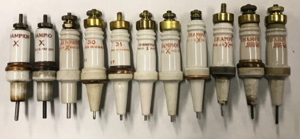

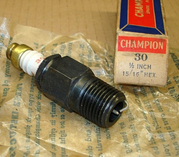

Roger Byrne
- Posts: 79
- Joined: Sun Jan 06, 2019 7:48 pm
- First Name: Roger
- Last Name: Byrne
- * REQUIRED* Type and Year of Model Ts owned: 1911 Torpedo Open Runabout, 1914 Touring, 1921 Coupe, 1912 Speedster (in progress) 1927 Touring
- Location: Racine, MN
I posted a question about a Champion #30 a while back. I'm not sure what a #31 is, but below is what a #30 looks like. The electrode length past the end of the insulator is the same length as the old style Brass Top X's that I checked. I'd guess they would be the same heat range as the X. I've installed a set of them in one of my T's. They don't protrude as far into the combustion chamber as an X, but they seem to work just fine with no problems.
