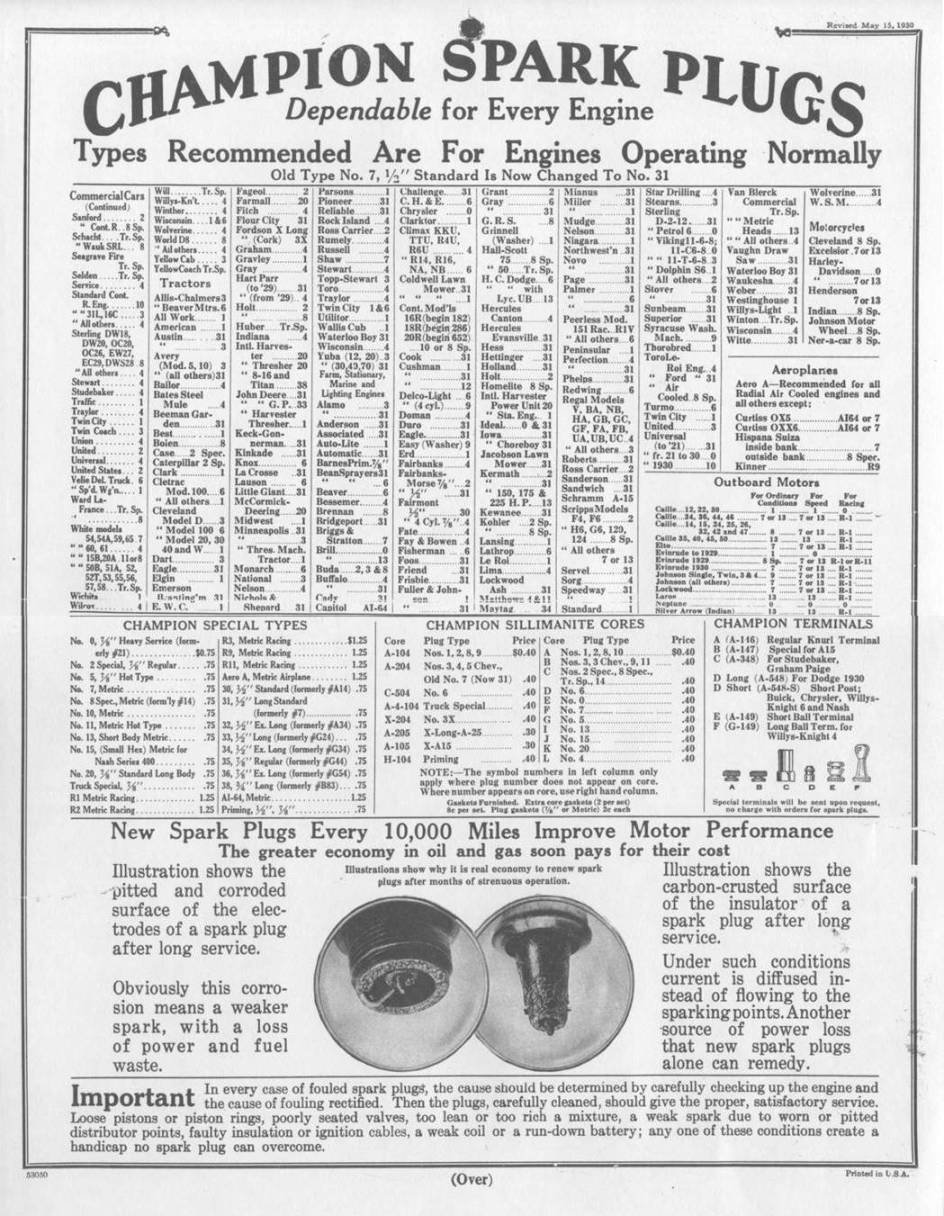

The heat range is probably different. Here is a Champion cross reference chart that includes their 1/2 inch pipe thread plugs, but doesn't show where the X falls in the heat range list.
Never heard of 3/4 and 1 1/8 pipe thread plugs. I think I am reading the chart right (It is a little blurry on my screen)
Any idea what engines used them?
Manuel in Oz

Some Tractors and a few stationary engines.

Not precisely on topic, but it's been a while since these were posted. The HCCA was handing out large size hardcopies of these a few years ago at Hershey.
