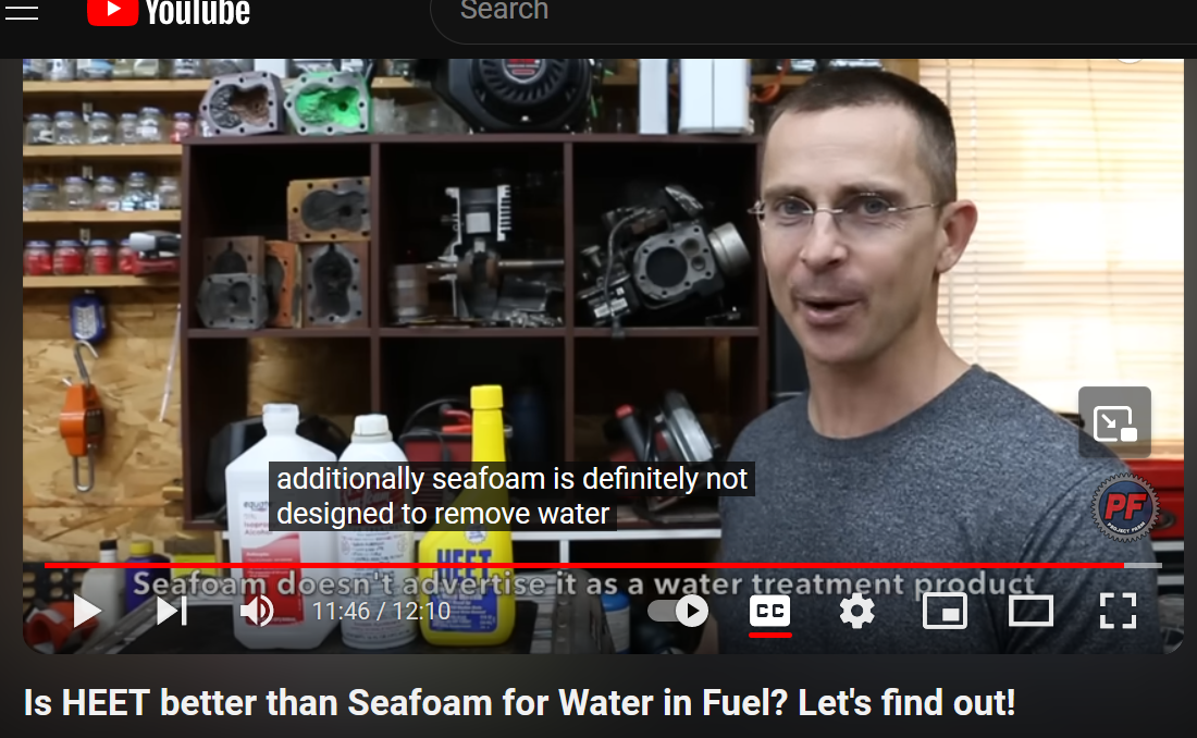

HEET
HEET contains methanol (not alcohol) which when combined with water it forms a homogeneous mixture (new product) and as a result of the chemical reaction a small amount of heat is released. So it will "remove" water in a sense.
https://www.goldeagle.com/product/heet- ... r-remover/
Found this very well controlled experiment about removing water so if you have the time https://www.youtube.com/watch?v=cC4hlcZz5DM
If not here's the conclusion
