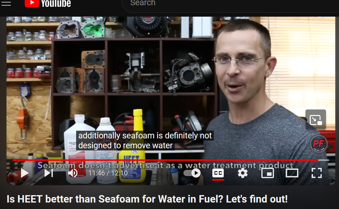

Found this very well controlled experiment about removing water so if you have the time https://www.youtube.com/watch?v=cC4hlcZz5DM
If not here's the conclusion
